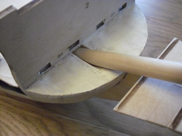

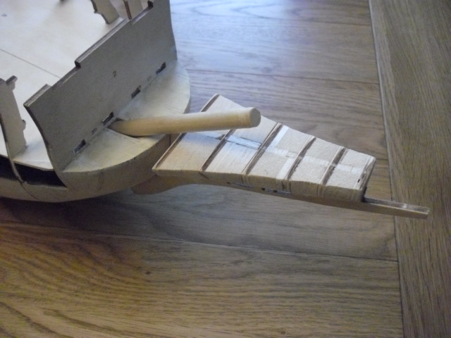

BOWSPRIT MODIFICATION

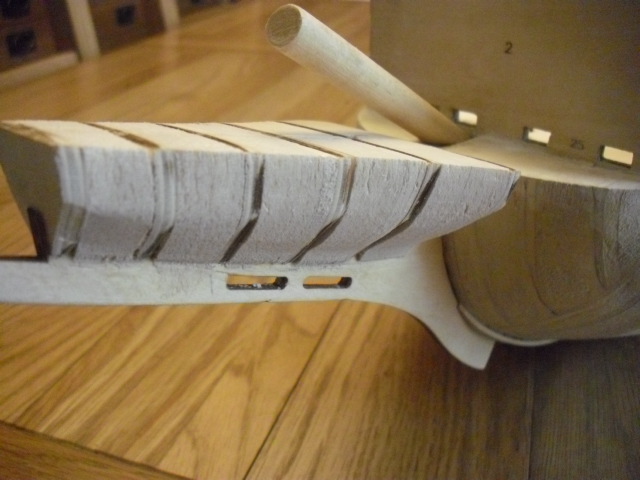

Well team that is all for now Questions and comments are welcomeBigGrin I will leave you with some photos with the stem in situ although dry fitted Kind regards Mike:-

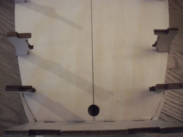

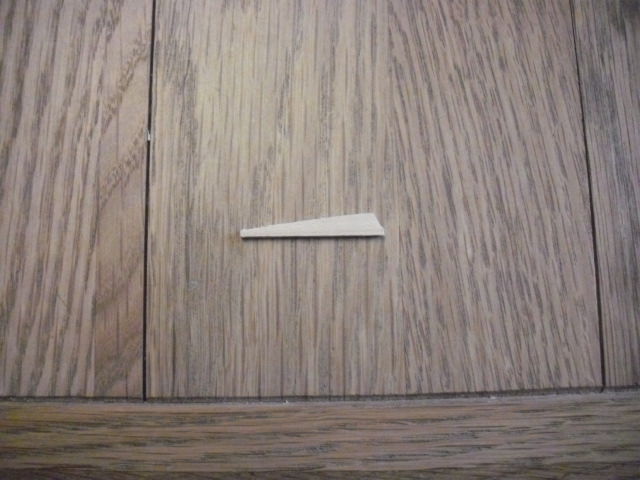

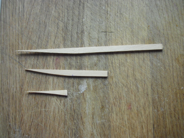

PREPARING FOR PLANKING
This is the Job if done properly is most rewarding because it pays you dividends in the finished planking.
The first task is to fill the gaps between the deck and the bow rib, this will help you with forming the plank for the bow curve (every little helps.

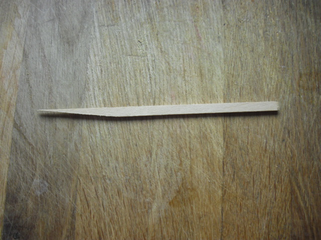

Measure and cut two wedges:-

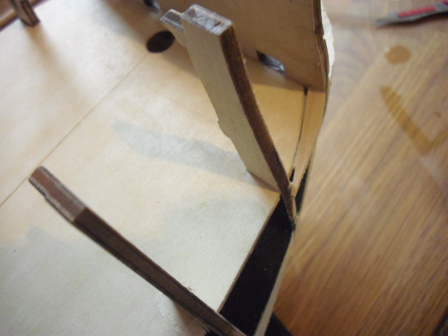

#549 Posted : 24 March 2013 13:06:36

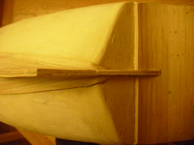

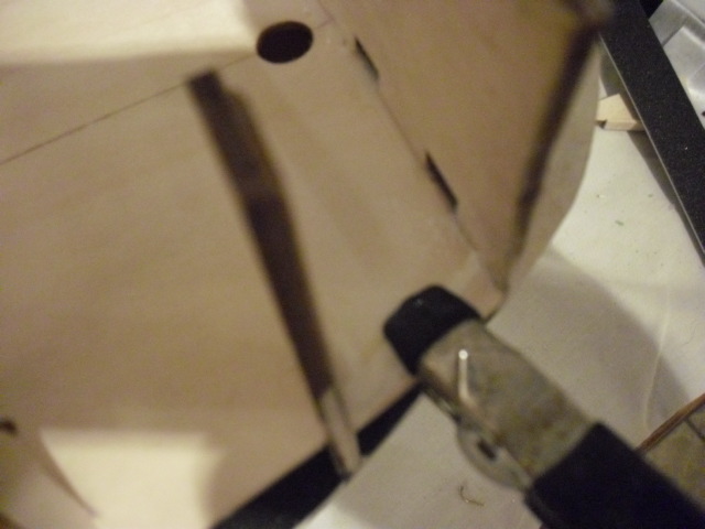

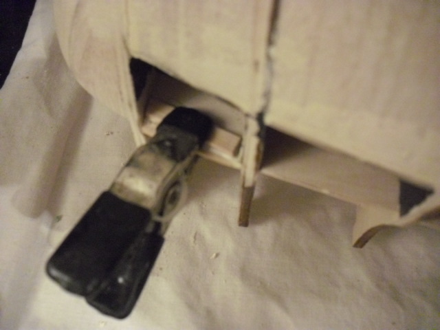

PREPARING THE PLANKING
Then fit the two wedges, using Aliphatic glue (please clamp to help the grab)fill the gaps with the natural Ronseal filler, then sand smooth, and also sand to follow the shape of the hull:-
Thats all for this sessionBigGrin Kind regards Mike

I'm very interested in your mod for the bowsprit, placing it starboard of the foremast. Lots of history behind that positioning. Thanks for the idea, although I am way off that point in the build due to joining in late.
#553 Posted : 25 March 2013 03:54:03
Hi David anything I can do to help you please callBigGrin Kind regards Mike

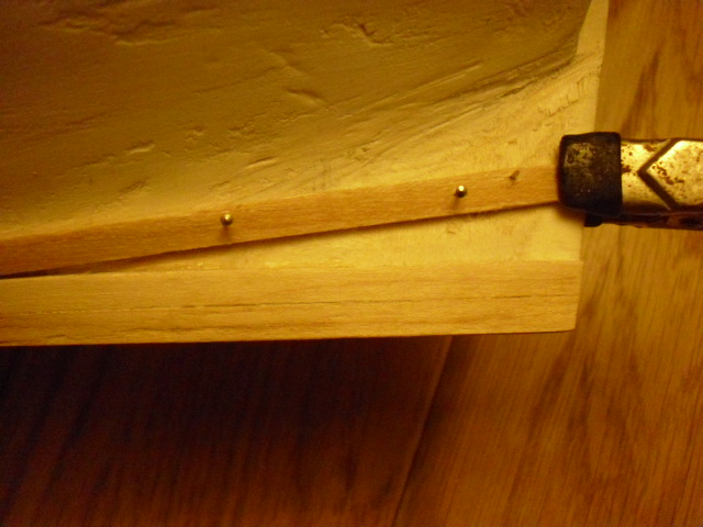

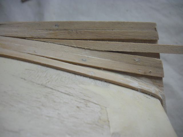

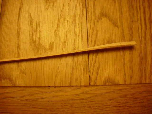

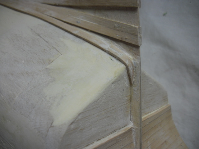

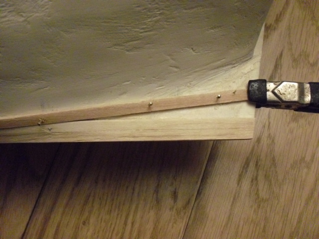

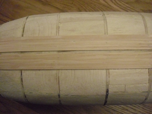

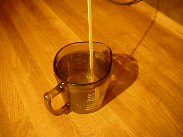

#556 Posted : 26 March 2013 18:33:59

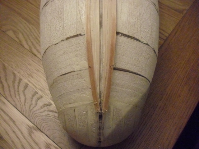

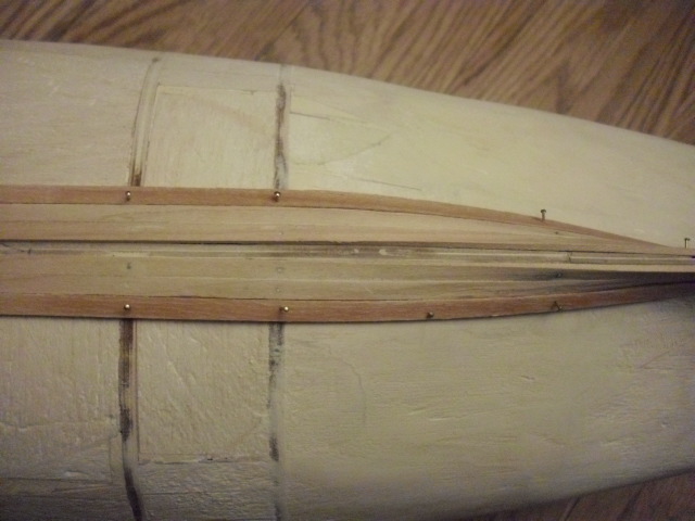

PLANKING FROM THE GARDBOARD PLANKS
I have now fitted 4 planks each side of the Gardboard planks (with the gardboard planks 5each side) plus I have fitted all the planks including droppers on the stern keel.
I have soaked the planks where I need curvature, and then fitted them to the ship (without adhesive)to dry in situ, then I cut and fitted.
The planks in the photos when they are dark, are wet, and then you will see when I have fitted them, I hope the photos tell the story:-

#557 Posted : 26 March 2013 18:43:51

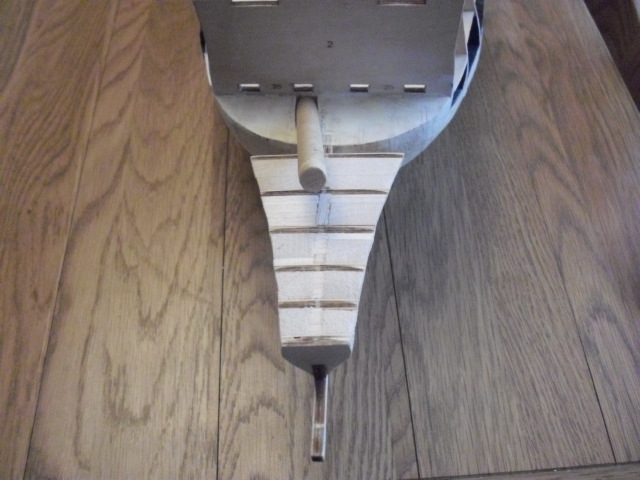

Now I will show you photos of the Keel stern:-
#558 Posted : 26 March 2013 18:53:03

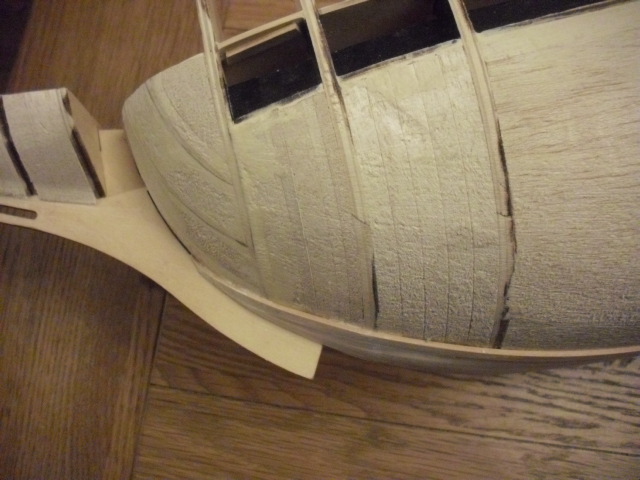

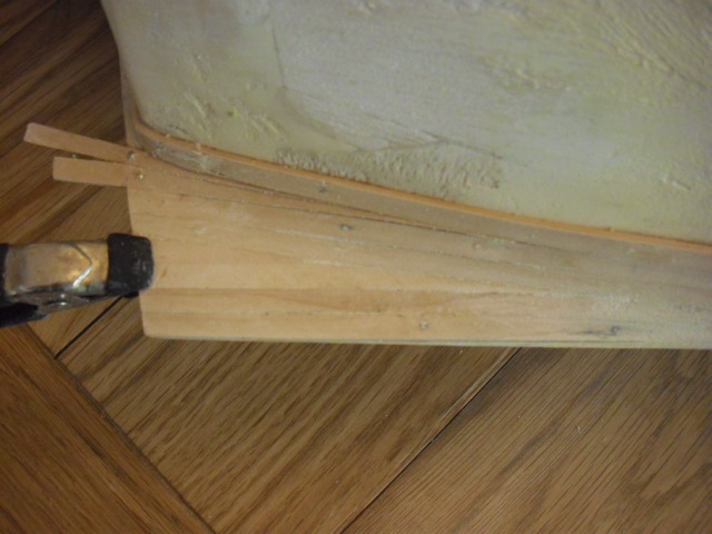

FITTING THE PLANKS FROM THE GARDBOARD
As the planks will have a second plank on them I have not been as critical as if this had been the only planking.
This is how the ship looks now, the gap down the keel is 4mm and I have test fitted the Stem and keel parts.
Thank you for looking inBigGrin Kind regards Mike
PS I am not using Bamboo planks, I have favoured Lime Wood
Also I have modified my rear stern that is why the plank curls over the stern.

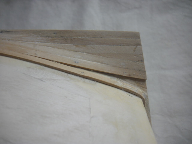

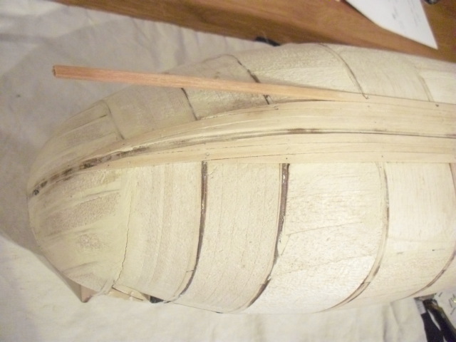

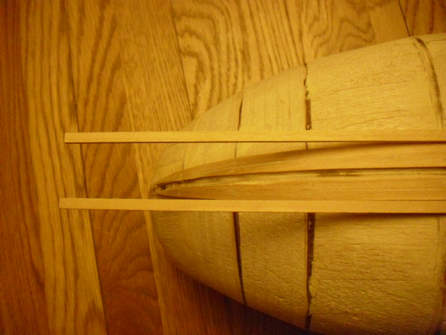

#559 Posted : 26 March 2013 19:40:56

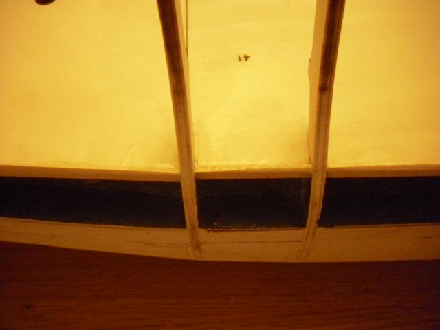

Hi MikeBigGrin ,

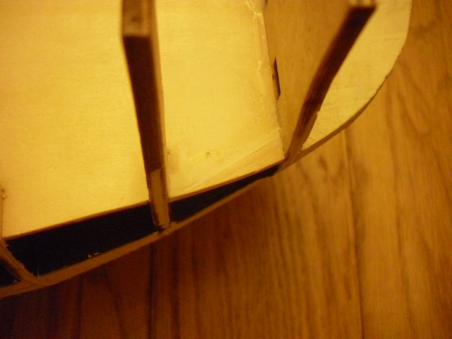

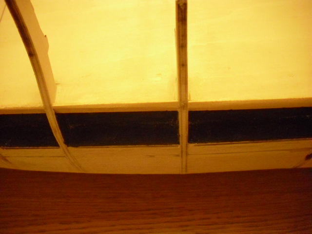

It`s delboy the inquisitive one LOL .Looking at your post #581 I see you are broadening the bow end of the second false deck and I can see why, but i have planked without the additional fillets and I also have a small gap the whole way down port and starboard sides of the second false deck to the row of planks next to them, so my question is, are you fairing your ribs back to the shape of the second false deck from bow to stern?
Hope that question makes sense, it does to me but I know what I`m trying to get overLOL .
#560 Posted : 26 March 2013 20:49:40
delboy271155 wrote:
Hi MikeBigGrin ,
Hi Derek, Thank you for a very good questionBigGrin I have faired the ribs but where I have had gaps I have filled them with planking and then faired them I hope that helpsBigGrin here are the photos of what I mean Kind regards Mike
