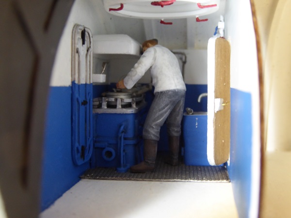

#544 Posted : 13 May 2021 17:26:41
The cook, keeping busy in the Galley. I'm very happy with the way he's positioned and looks to be engaged in 'pot management'!BigGrin Funny to think he came from a Revell Luftwaffe set as Ground Crew!LOL. Splash a bit of white on his tunic and viola, a U-boat master chef!Flapper

Fantastic level of detail, Phil.
I am totally gob smacked.
You'll be telling me next there are hand made peas in the saucepan? BigGrin BigGrin

How wide is that galley between the two bulkheads as it looks so realistic for such a small space.
I take it that you never messed the chef about on a sub as there`s nowhere to run to when he has a cleaver in his hand. LOL LOL LOL

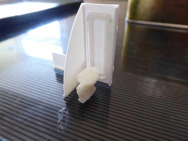

Thankyou for all the comments and i'm sure you'll have a chuckle at the updates i have for you this week.
So i started to build the WC with a hinged door, so you could still see the cook at work when it was opened.
The attached photo shows the basic shape made from 0.5mm thick acetal, with door cut-out and corresponding door.

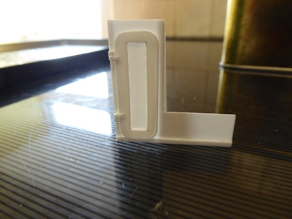

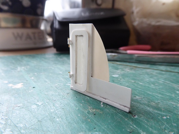

#551 Posted : 20 May 2021 06:59:25
Door in place, hinge pins not fitted at this point.
#552 Posted : 20 May 2021 07:00:42
Looking from the 'business' end LOL, showing the 3d printed toilet in place to give an idea of it's position.

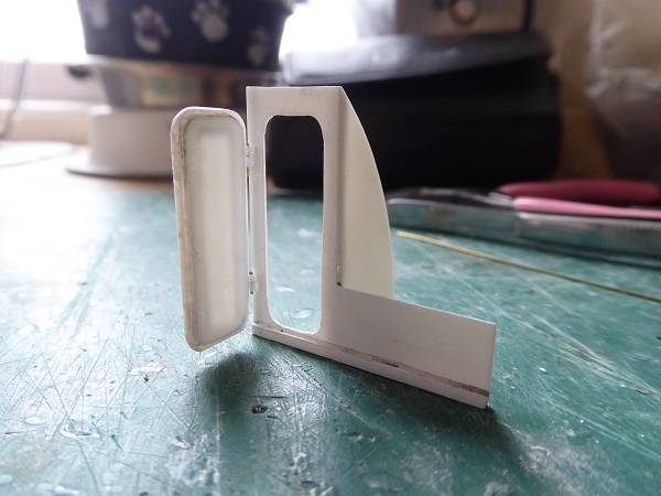

#553 Posted : 20 May 2021 07:01:31
Hinge pins made from 0.5mm diameter brass rod, fitted.
#554 Posted : 20 May 2021 07:03:10
Door opened.

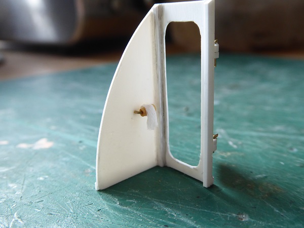

I then made a toilet roll holder from a small length [3mm] of wooden tooth pick, sanded to a smaller diameter [1mm], with a 0.5mm diameter hole drilled through its centre. I fitted a piece of bent brass wire through the hole to fix to the WC wall. I cut out a small piece of toilet paper, wrapped and glued it around the holder and sprayed it with a bit of matt acrylic varnish to hold it's shape and prevent it from falling apart over time.Flapper

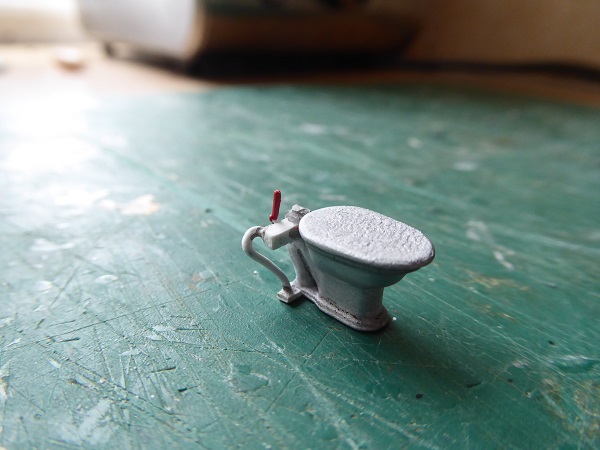

The next job was to paint the toilet and add the flushing valve. The toilets were made from stainless steel on submarines as opposed to porcelain and were flushed with pressurised sea water and the waste discharged into the sewage tank below.

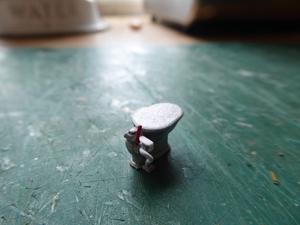

#557 Posted : 20 May 2021 07:13:53
Looking from another angle.

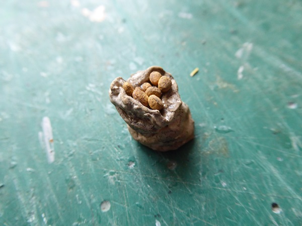

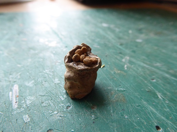

Next to the WC was the vegetable stores. So i bought a packet of after market sacks, made of plaster, which also came with a little packet of loose potatoes. Brilliant! I glued a few of the smaller potatoes into the top of the open sack i had earmarked to use.
Although i did feel that the sack and the potatoes could do with a bit more dirt. So rather than mix up a brownish wash, i used the real thing. Yes, i went into the garden, got a tablespoonful of soil, placed it on a saucer, dried it out in the microwave and with a damp brush, applied it over the sack and potatoes. LOL
#559 Posted : 20 May 2021 07:22:13
Looking from above.
#560 Posted : 20 May 2021 07:23:27
A quick mock-up showing the WC, toilet and sack of potatoes.
