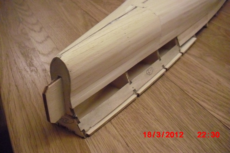

ISSUES 24,25,26, and 27

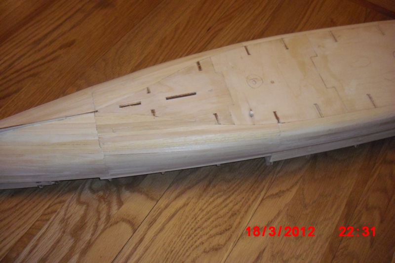

Hi Team I have now finished the work on these issues, to my satisfaction. The Hull is sanded and prepared for the second planking.
The first photos are of the Bow, you will see I used 5mm x 2mm planks around the tight curve, this has given a better shape and good fixing for the second planking, I checked with Hachette and the second planking is 5mm x 2mm.:-

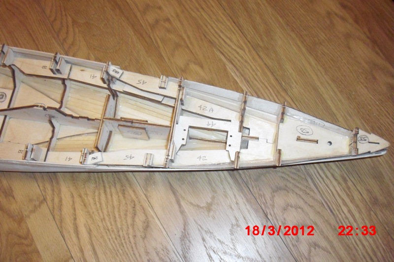

The next photos are of the stern, after planking I poured neat PVA adnesive in the Hull covering the inside of the planks, I will still use plasterers tape and epoxy adhesive before I fix the planks down:-

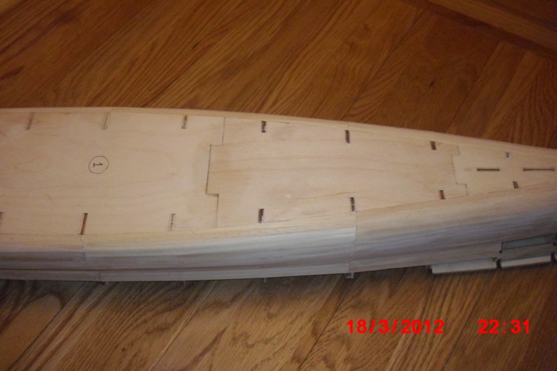

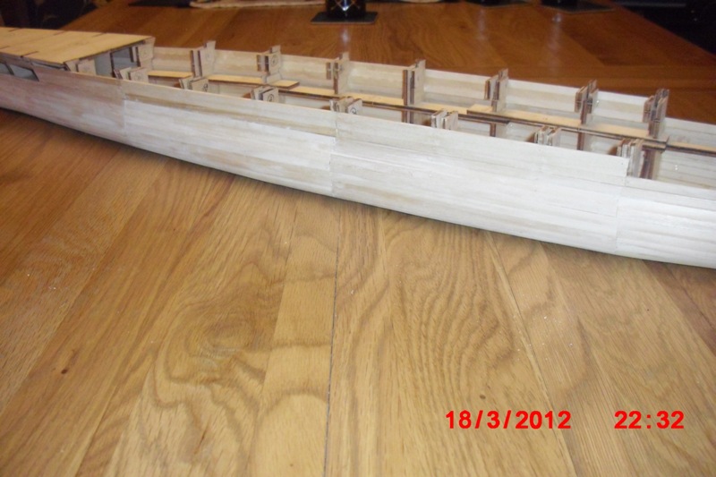

#545 Posted : 19 March 2012 00:15:59
ISSUES 24,25,26 and 27
The final photos are of the centre of the Hull, I have used 5mm x 2mm planks where the sides of the Hull meet the base, this has again given in my opinion a better shape.
Questions and comments are welcomeBigGrin Regards Mike

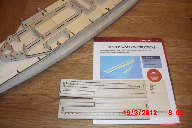

ISSUE 28
This is what we received this week (All to do with the Bow)BigGrin Regards Mike

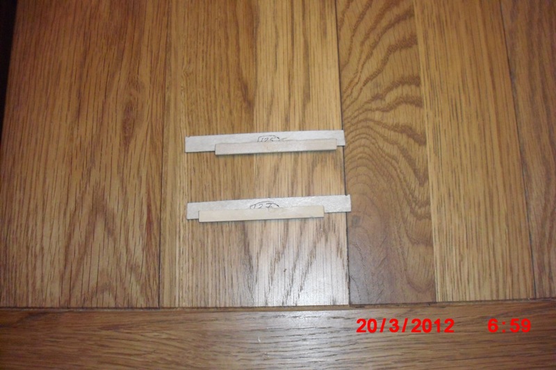

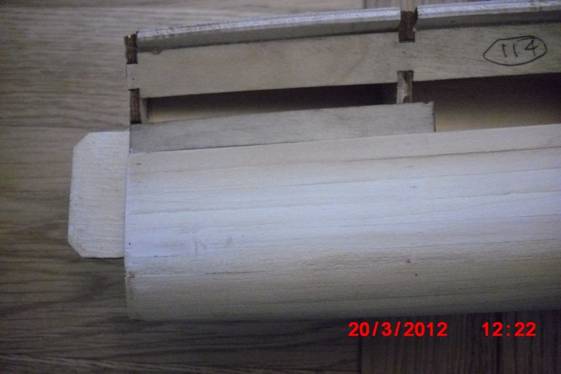

ISSUE 28
Hi Team, Just to give the heads up, fret 2993 contains parts 125 and 126, while fret 2994 contains parts 128 and 127. they look the same, but have different hole configuration. I cut out the parts and numbered them,and sanded the pieces:-

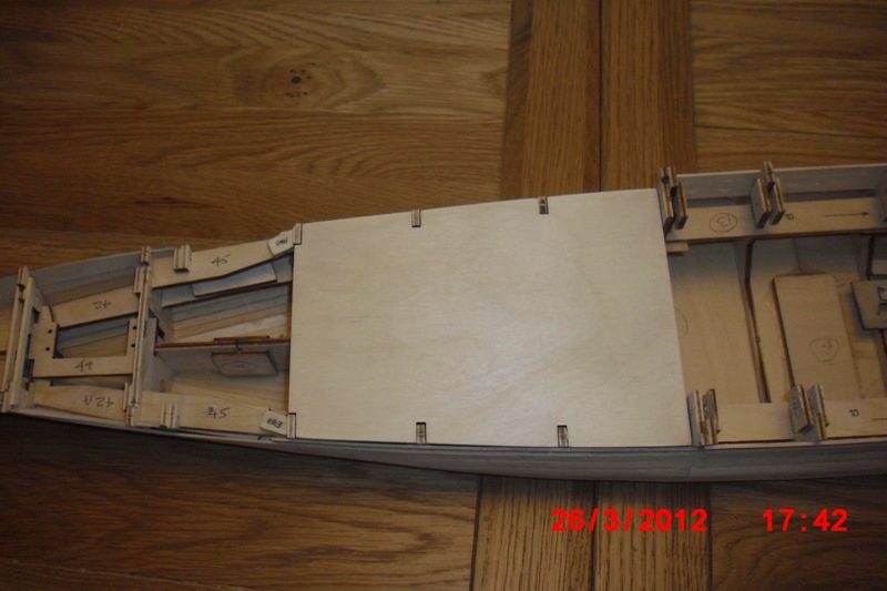

ISSUE 29
Before fitting the parts this week I thought it was worth taking some time looking how the decks will fit with these Bow and Stern parts we are receiving.
The first thing I did was sand to fit the two stern deck pieces, I then fitted extra supports for these deck pieces, here are the photos:-
I used 4 cut pieces of 5mm x 2mm planking, I am making a static model so these modifications will not interfer with any thing infact it will give a better fixing at the join of Deck pieces 104 and 105
