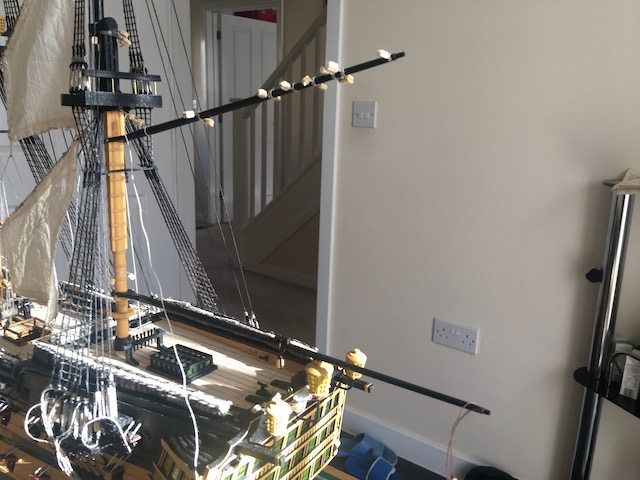

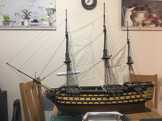

Issue 102 completed:
- All centre line stays fitted
After they were fitted I spent nearly the whole morning to re-tension all the stays and backstays to ensure that the masts are vertical.
To be honest I was struggling a lot, I couldn't get the stays between the main and fore masts set to a good tension (to bear the weight of the main topgallant sail), also keep the fore and main mast vertical and the jibbooms not inclining upwards.
At the end I had to remove (were fixed in previous issues) the two threads between the jibbooms and the fore mast because they were pulling the jibbooms up significantly.
Now, I got the mizzen mast nice vertical, the main topgallant mast leaning backwards a very tiny bit, and the fore topgallant mast leaning backwards a bit more than the main mast. Currently all the stays between the fore mast and the jibbooms are unfastened, so the bowsprit is straight. (continuation below...)
- Main topgallant staysail fitted. There was some uncertainty how the thread A & B should be fed through the brackets, but with Alan's (Gandale) help I managed to fit them.
Issue 103 started:
- A faulty sail again Cursing Cursing Cursing, this time the mizzen topgallant staysail ... When I had the other two faulty sails I didn't complain about this one, because I thought that the curve on the long side is normal. But now I see that the long edge should go to the stay, which is obviously a straight line LOL. Spare part requested from customer service.
- I'm skipping the rest of the issue for now to get all the stay tensions correct.

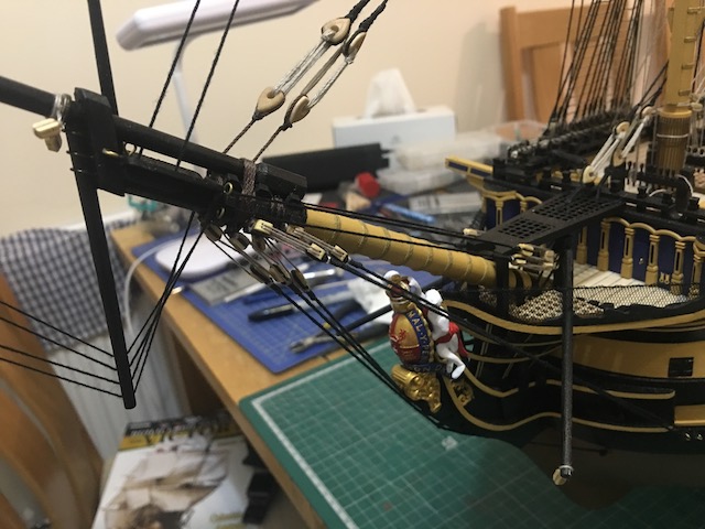

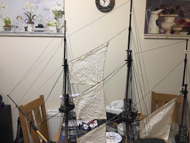

Issue 104 continued:
Today I made all the bobstays and martingales.
Then hoped for the best. :)
Started to tension them one by one, working from the bowsprit towards the tip of the flying jibboom, to make sure that the tension gradually increases on the jibbooms. I applied the tension on them, that at the end the jibbooms bended slightly downwards. Doing this I hoped that after refitting the stays between the jibbooms and the fore topgallant mast, the tension on them will pull the jibbooms back to straigth and the topgallant to vertical (from leaning backwards).
Another 1-2 hours of play with re-fitting and tensioning the stays brought the success end condition.
Not 100% perfect, because it seems that the mast is stronger than the jibbooms, but close enough.
At the end the main topgallant successfully pulled back to vertical, the fore topgallant leaning backwards only a tiny bit, also the flying jibboom inclining upwards a tiny bit, however they are not noticeable, if you're not aware of it. Cool Cool Cool
Done and dusted, all knots sealed. Phew... Laugh Laugh Laugh

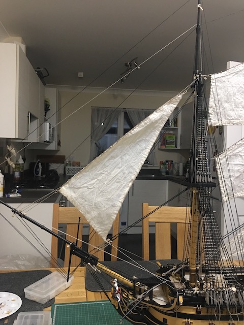

Back to Issue 103:

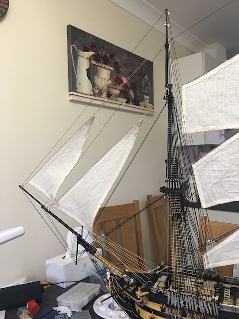

- Jib was rigged with threads.
Then the problems again...

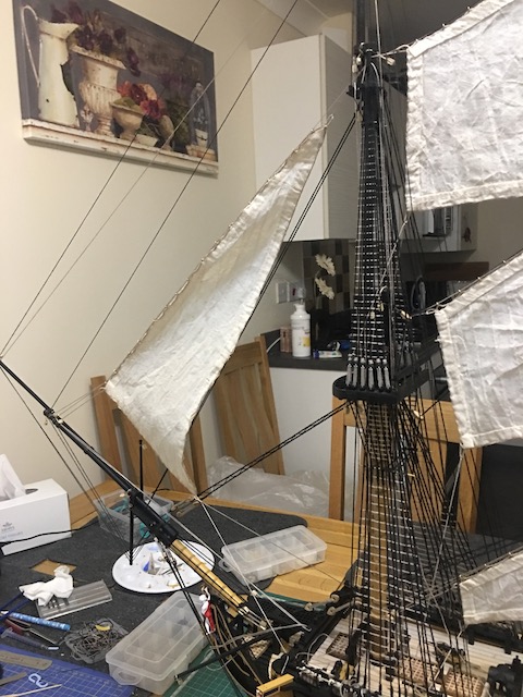

I'm not sure if it's only me, but looks like that the sails are not my best buddies... or I just have another weird shaped sail...
Fitted the jib to the stay, but it doesn't seem to hang as on the magazine pictures... the lower edge, I guess, should be more or less parallel with the jibboom, but it's far away from it.
Therefore if I try to fix threads D to the corner timberheads it makes big "wave" on the jib.
I though that I fitted the wrong edge to the stay but double checked the magazine pictures (showing to fit the A, B, C, D threads, also checking the sawing stripes on it), and I believe I hanged on the good way.
Any suggestions?
Happy building!
Laszlo

Issue 103 continued:
- fitting the mizzen topgallant staysail is parked for now because I'm waiting the replacement sails. They promised to receive it within 5-7 workdays.
- another try with the jib... I removed what I've done yesterday and I flipped it over to have the other long edge fitted to the stay. It looks much better, the short edge is nearly parallel to the jibboom. It still sagging a bit after the lower corner tied (even if there is no tension on those threads) but sagging less than yesterday, and the overall fit is much better.
- I fitted the flying jib on the same way, it flipped compared to the magazine. It also sagging a bit, but on an acceptable level, I suppose. Blushing
Maybe the pros here would call me an evil or sacrilegious because of flipping them over but it seems right for me. Cool

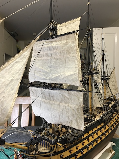

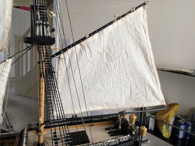

- mizzen booms fitted
- mizzen fitted and rigged

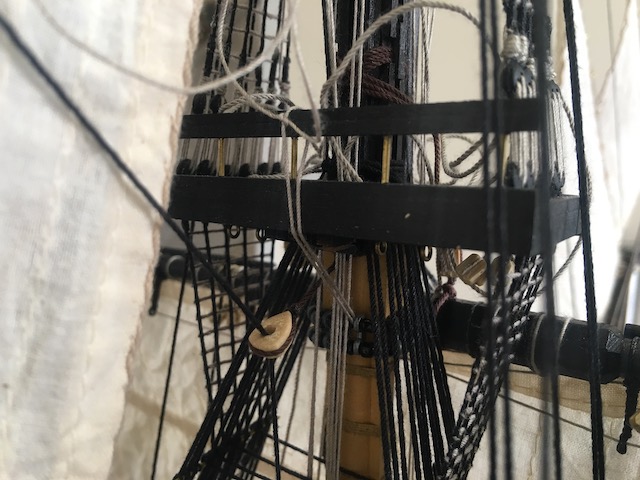

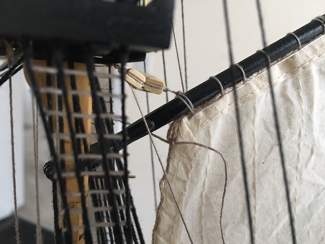

Question:
Will the little loop on the upper front corner be used later on, or shall I just tie it to front edge of the sail? (see close picture below)

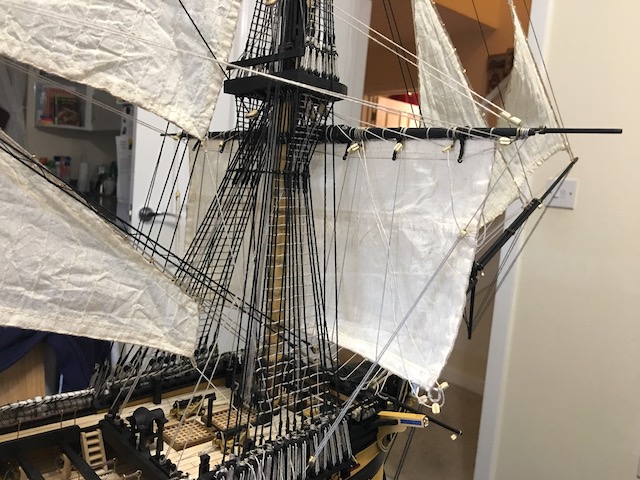

Issue 105 started/completed:
- fore sail fitted
- parrel added
- sail and yard rigged
Wow... that was a hard task, I spent two days to complete the fore sail. Blink
Hint: I was struggling with the parrel because while I tried to tie one end to the yard, it was keep falling down by its own weight. So I fixed it temporarily to the mast top to keep it in the correct height and central.
Happy building!

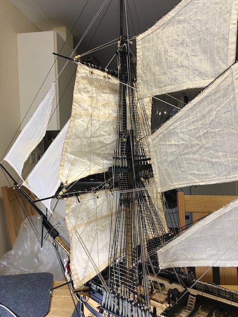

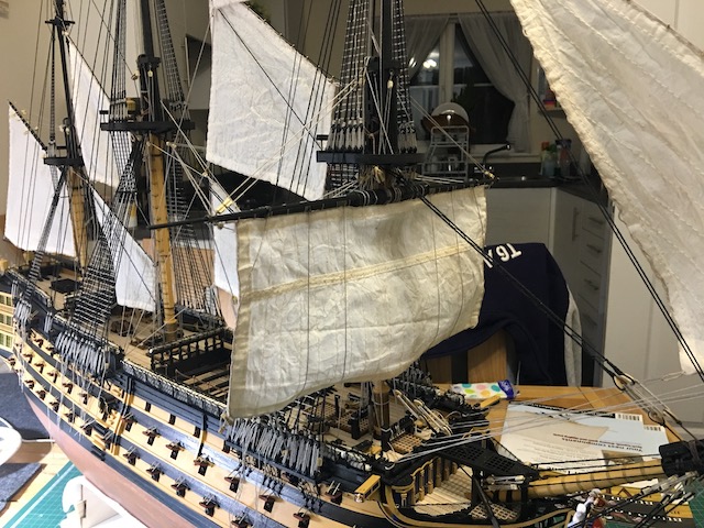

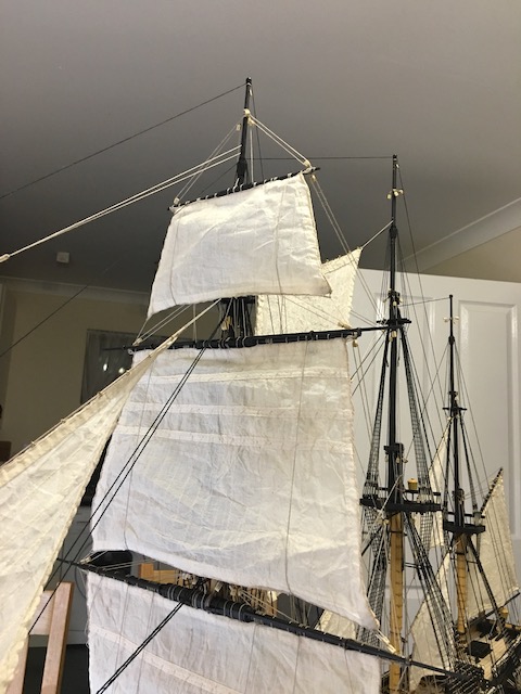

Another two days gone, another sail fitted. Cool
Issue 106 started/completed:
- fore topsail fitted
- parrel added
One of my biggest fear came true during the rigging... one of the pin on the cockpit pinrail snapped off.
I had one snapped already just by fitting them to the deck, now another one snapped during rigging.
I had to use quite a lot superglue to fix it back. Luckily I managed to do it.
I think the direction of the grains chosen wrong during the laser cutting of the part. It snaps with no force.
Hopefully no more snapping during further rigging, I will be also extra careful with tension of the threads fitting to these pins.

Issue 107 started:
- fore topgallant sail rigged and fitted

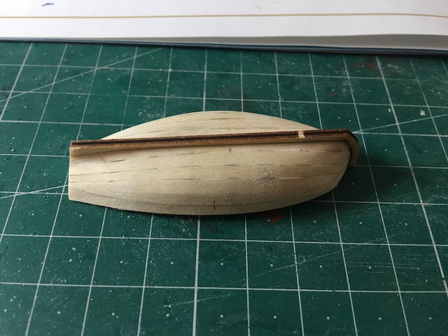

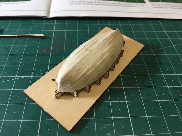

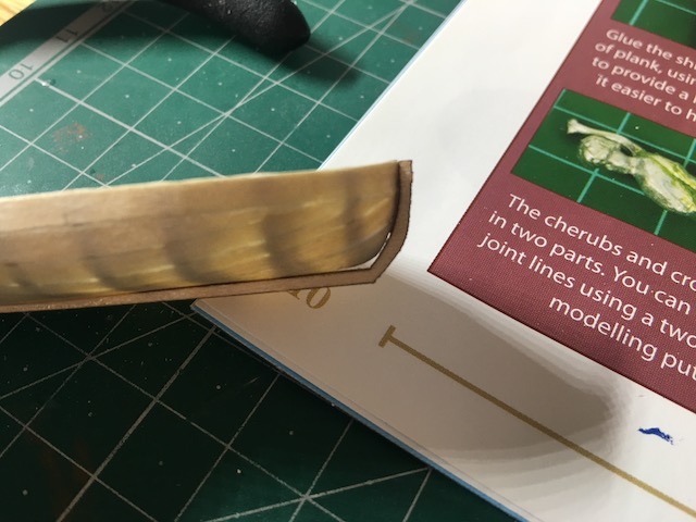

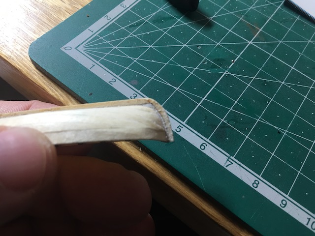

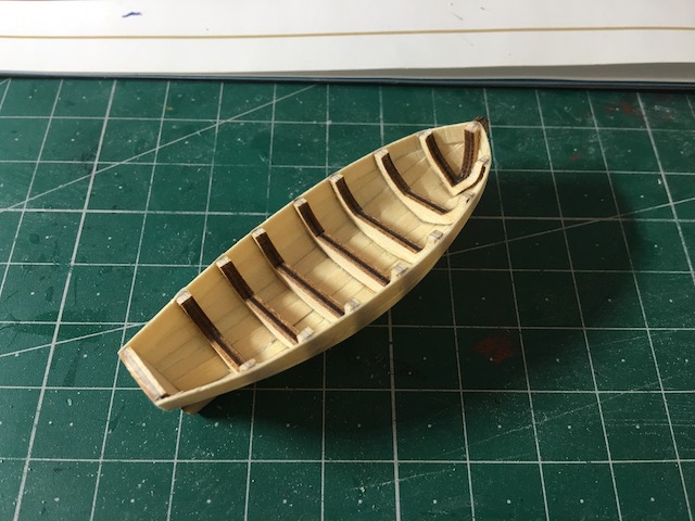

While waiting I started issue 109 with the 18-foot cutter:
- building frame assembled
- planking completed
- cutter removed from frame and sanded smooth
- keel fitted. I found a fairly big gap at the bow between the planking and the curve of the keel, so I filled it up with wood filler
I didn't complete the last few steps with the inner planks and the grating as I will paint the inside first yellow ochre.

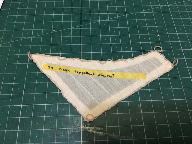

The replacement sail arrived early this week. BigGrin
Done the soaking in tea exactly as I done with the other sails... of course, Murphy's Law took effect... it ended up with a darker shade Cursing Cursing Cursing.
This sail must have a slightly different material, as I followed my previous soaking process precisely.
Anyhow... I tried to wash it through with cold water, hoping that it will get lighter.... unfortunately it didn't... Crying
Tonight I'll test fit onto the ship to see how much the difference is noticeable. If it's easy to see then I might will to soak it for clean water for a while, hoping that it will get lighter.
Have you got any other suggestion how to make it lighter?
