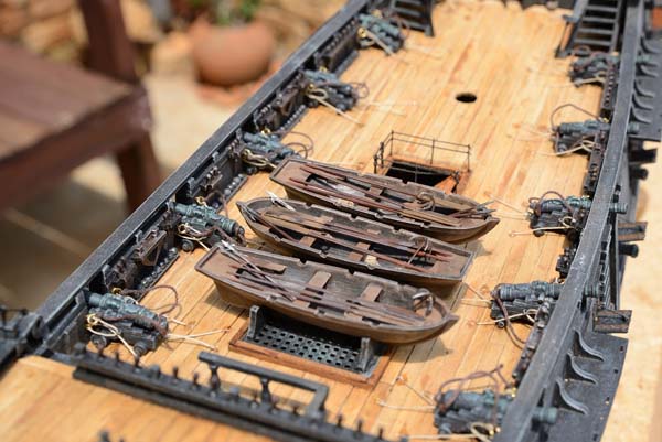

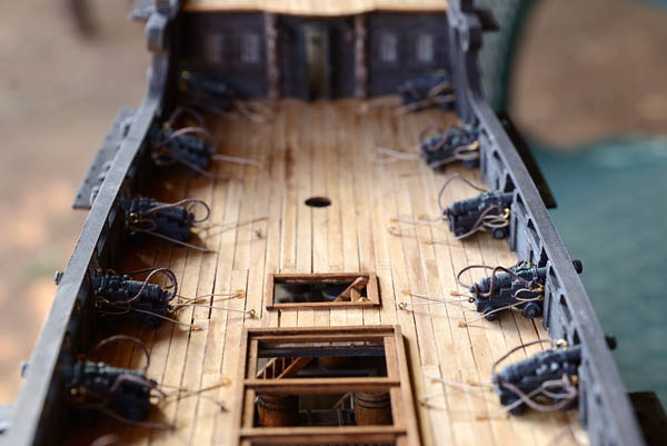

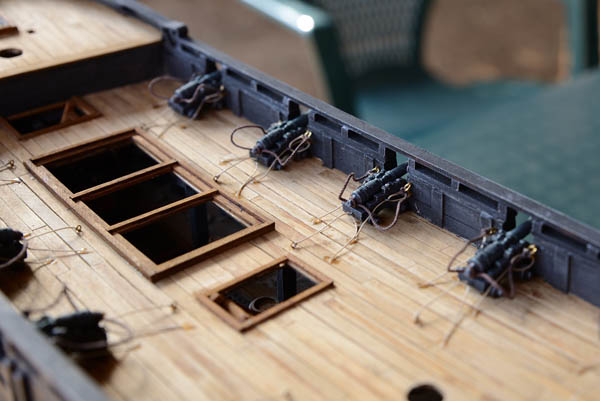

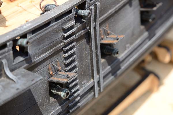

Hi All,
Had some more time on the Pearl this weekend BigGrin
Fitted & rigged the main deck guns, as with the guns on the deck below, I used my own interpretation on the rigging. I know it’s by not accurate or even correct, but I feel it looks better than the methods suggested in the instructions. Blushing
The thick thread around the back of the barrel is 0.8mm thread left over from my Victory and the remaining thread is what was supplied with the Pearl.
I also had some brass rings left over from my Victory.
I will add rope coils to the end of the ropes at a later stage.
After that I fitted the Caryatids to the gallery. The pins really helped secure them.
skyfire

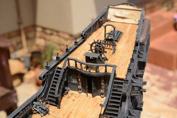

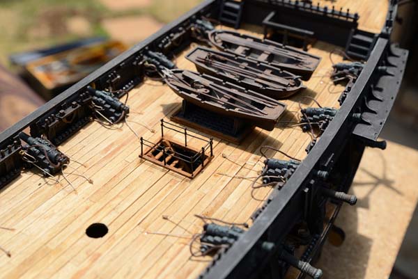

#552 Posted : 22 November 2019 13:27:27

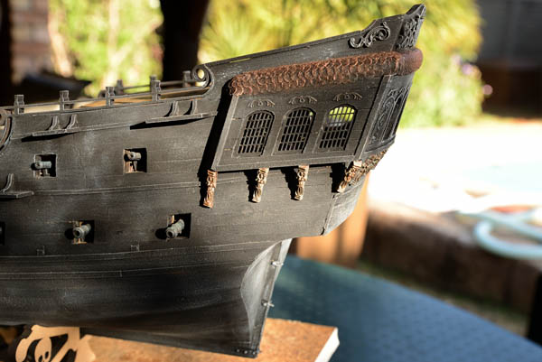

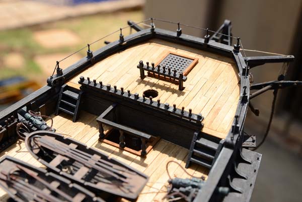

Hi All,

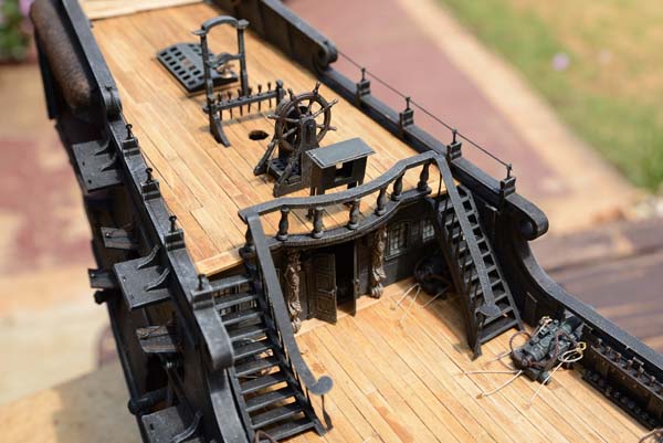

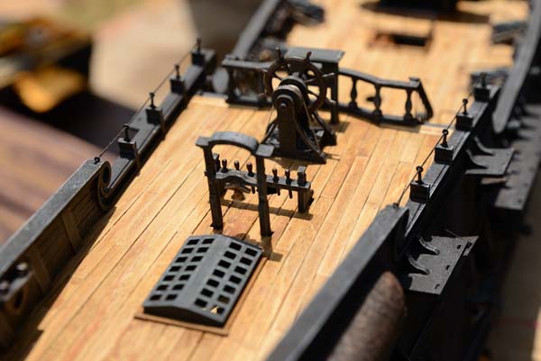

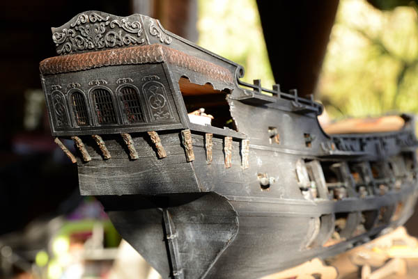

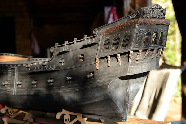

Almost wrapped up the hull assembly, I’ve still have to make the, stern lanterns, gun rope coils, barrels & crates, figures and the Figure Head. I’ll leave the figure head for last though – it just seems appropriate.
Added all the bits to the handrails, fitted all the deck items, wheel, launches etc. it seems that Hachette have really left us with an awful lot of work in issue 118 & 119.Cursing Cursing Cursing

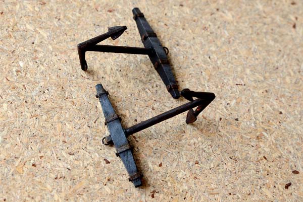

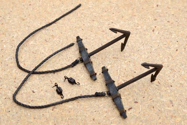

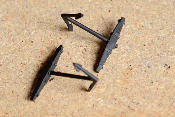

I made up the anchors. I have saved all the offcut pin heads from the Victory planking; some have found a home on the reinforcing bands on the anchors. They serve no real purpose except to add some detail. Once done, they were sprayed matt black followed by various grey dry brushes. I added some GW Typhus Corrosion followed by a GW Ryza Rust dry brushing.
I added a spare double block and basic rigging as in the Victory instructions. Note though, the block arrangement in the pics is incorrect. I changed it when I fitted it.
The gun port lids followed the same paint procedure. I drilled a 0.8mm hole for the thread. I also kept the off-cut hinges from the Victory’s gun ports. I glued them to the Pearls hull, with off-cut nail heads for detail. They also got the same rust treatment.
