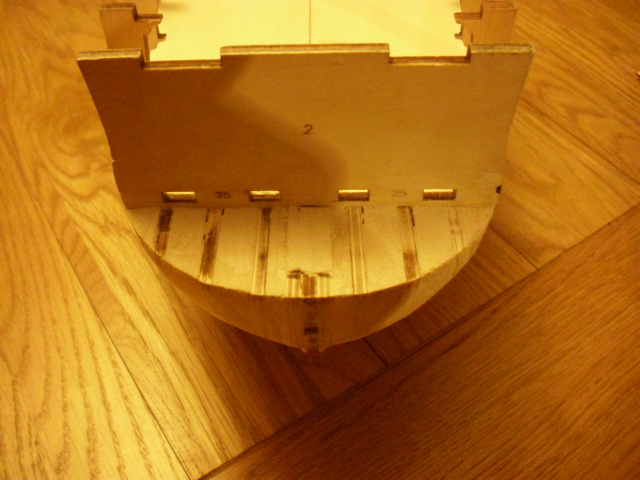

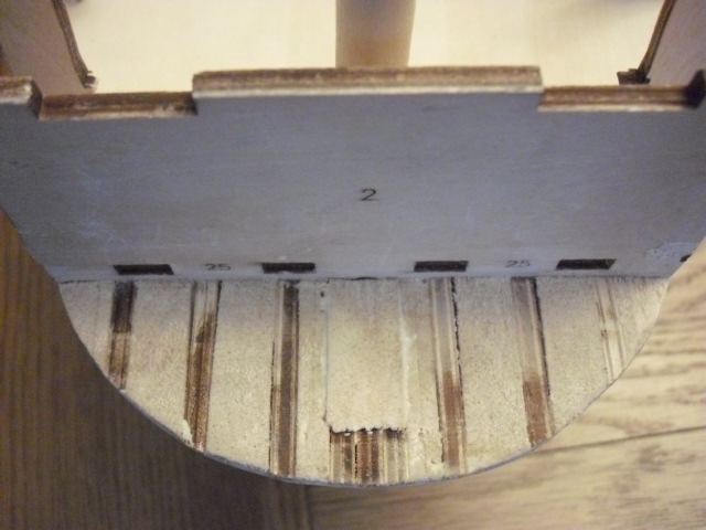

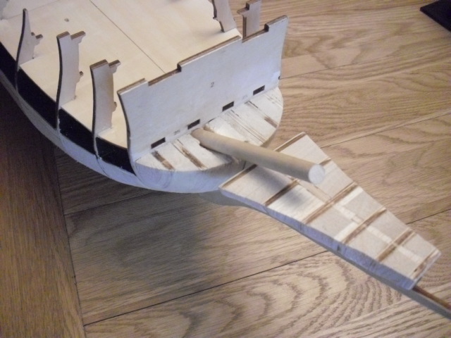

BOWSPRIT MODIFICATION
Hi Team, this is the Third modification I have done on this model, I must stress this is my interpretation of how I want my Ship to look, and is just what suits me.
In arriving at this Mod I looked at lots of ships of this era, all had a very forward fore Mast, and many had an offset Bowsprit (I believe because the mast would have been in the way of a Bowsprit fitted in the centre)
The San Fran 2 I am building shows again the fore mast way forward and the Bowsprit offset:-

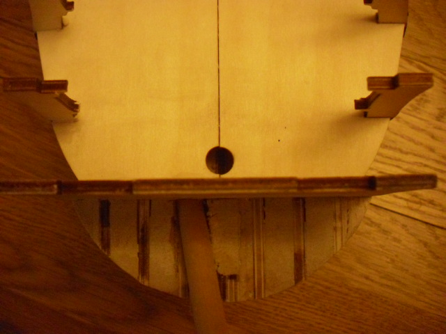

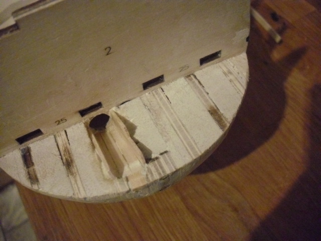

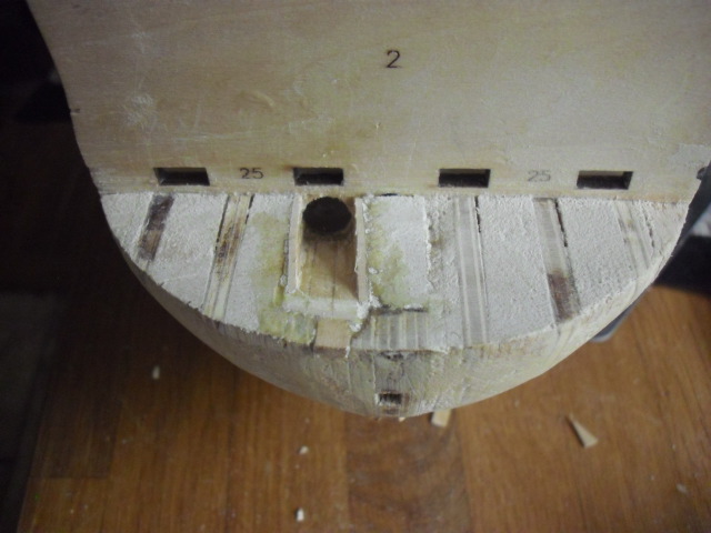

#530 Posted : 08 March 2013 18:00:40

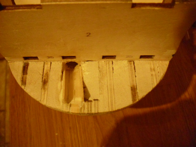

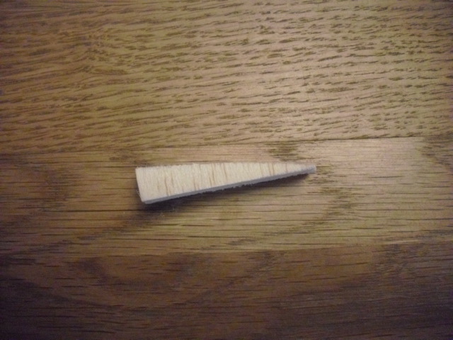

The first job was to cut a piece of dowal and glue it in the hole in rib 2, then because I have fitted balsa infills it was easy fo me to cut a wedge of balsa and glue it in the old slot:-

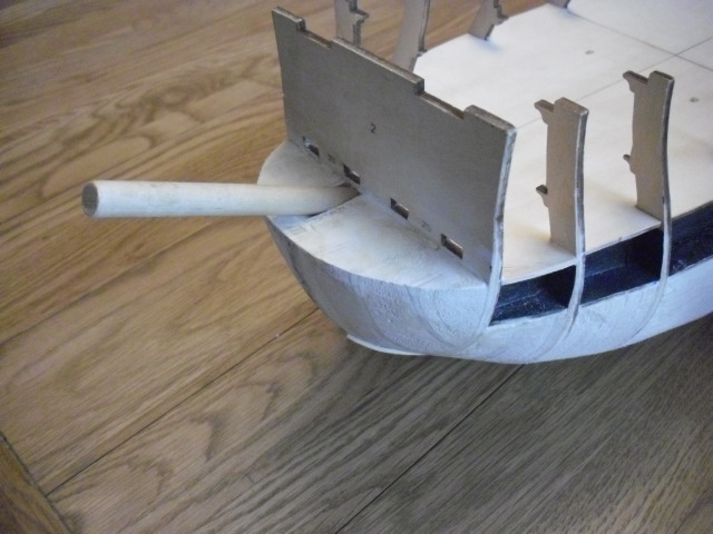

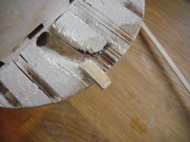

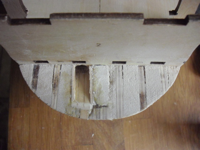

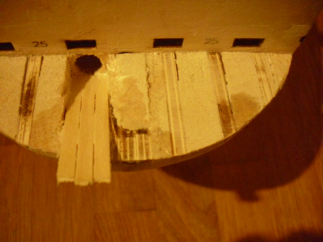

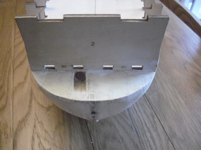

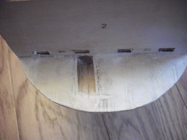

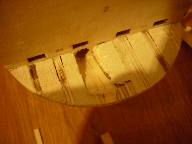

I then prepared the new slot, choosing a position on the starboard bow just to the right of the fore mast.
I used a black and becker power drill with a long woodworkin drill, and with the stem in place (dry fitted) I chose the angle that I felt was right for me and sympathetic to the ship.
Although the Bow sprit will be offset it will follow a centre line through the stem:-

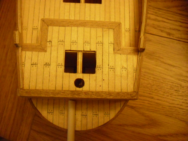

#532 Posted : 08 March 2013 18:16:45

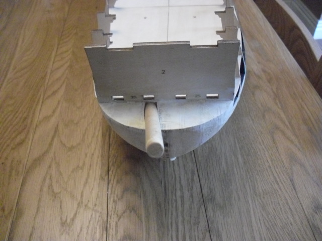

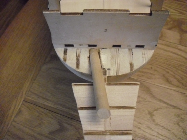

Well thats all for now I used very simple tools and methods to achieve this mod I will be doing some tidying up of the mod but I believe decking will be added to the Bow area and possibly some further structure work, Questions and comments are welcome, I will leave you with some final photos:- Kind regards Mike

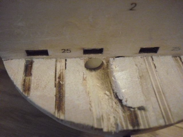

Hi Team well I have cleaned up the work, and set the angle of the Bowsprit, the photos will tell the final story you will see I have lined the opening with 1.5mm x 5mm limewood trimmed to size here goes:-
