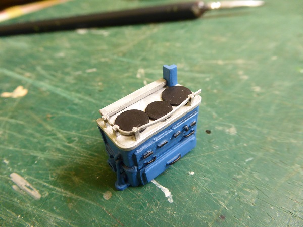

Cooker finished; painted, varnished and pin-washed. I'm very happy with the way this turned out!BigGrin
#524 Posted : 06 May 2021 19:05:27
Top/front view.

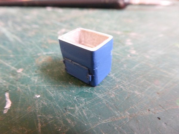

Sink completed with storage locker underneath.

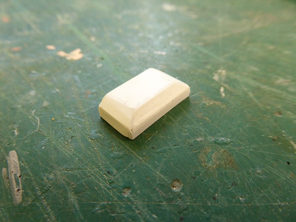

More scratch-building; this time, an extraction hood to be fitted above the cooker. Made from 0.5mm thick acetal sheet.

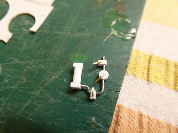

Valves and a hand pump for the dividing bulkhead above the sink area.

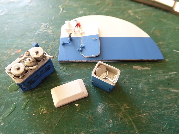

All the scratch-built items mentioned in this weeks post. I can't really fit them yet, as i still have to make the aft escape tower. If i were to fit these items first, then i would be left with no room to make the escape tower, so it's all a bit of a jigsaw. Once the tower is made, i can then start to fit the Galley out, working towards myself as i go.

The attached photo shows it prior to painting. Using a compass cutter and 0.5mm thick acetal sheet, i could make several discs of various diameters and glue them together to form the profile. The locking handles were formed from brass strip, bent to shape and the hand-wheel is an after market part.

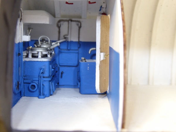

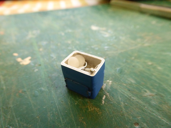

The attached photo shows the cooker and extraction hood fitted and a very small utensils box equipped with two ladles, situated by the bulkhead door, also fitted.
#538 Posted : 13 May 2021 17:19:07
The attached photo shows the dividing bulkhead and sink fitted.

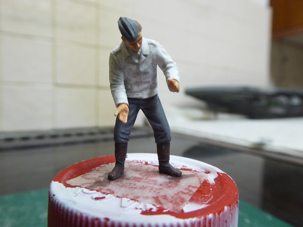

#540 Posted : 13 May 2021 17:21:17
The cook, in his chefs whites.
