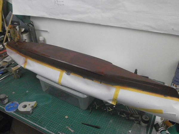

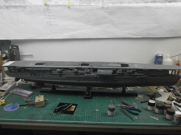

BigGrin Hi All
The Akagi hull masked up and two coats so far off Tamiya's Hull red which is the perfect match for JIN anti fowling red. The paint looks blotchy because its still wet LOL . More soon.
#522 Posted : 08 November 2015 01:15:05
Sweet, that's a lot of paint, I'm guessing you used rattle cans for ease
#523 Posted : 08 November 2015 02:03:56
BigGrin Hi Dave
No rattlers were used here just my trusty suction airbrush with the 22 cc glass pot it will cover the whole hull for the 1st heavy colour coat with some left over for the lighter 2nd coat. Which just leaves a light coat after that if needed.

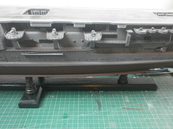

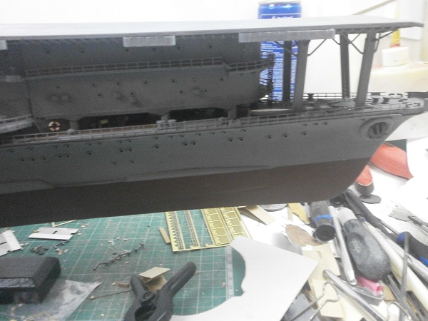

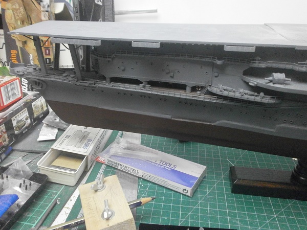

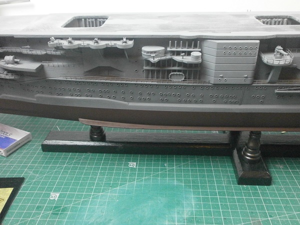

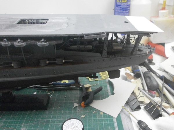

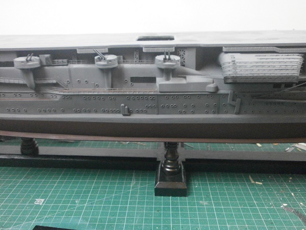

BigGrin Hi All

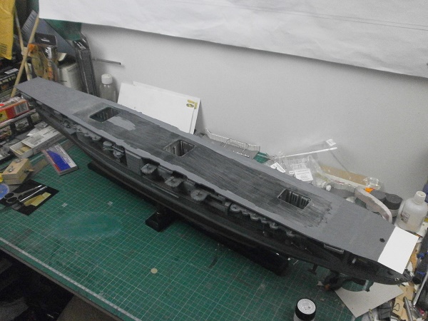

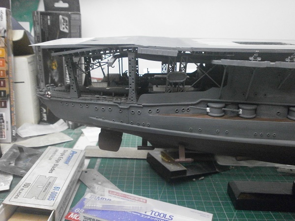

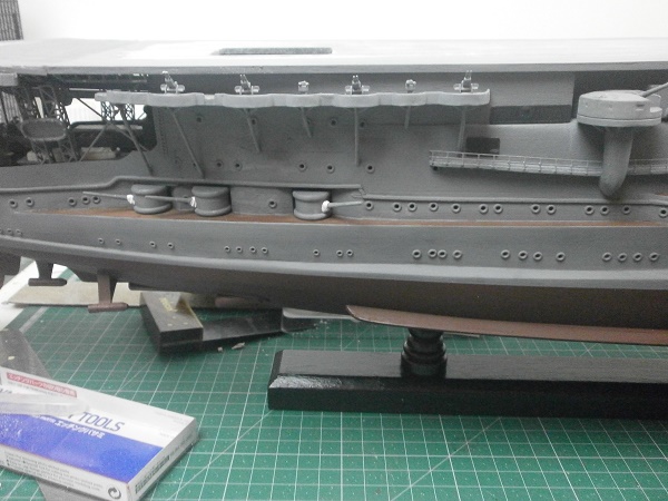

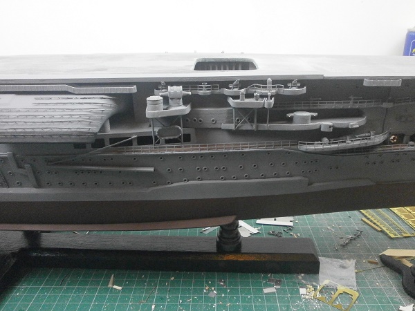

The two coats of hull red were fine so I then fixed the stand to the hull to minimise scratches/damage to the paint work,the rudders have also been added. Next the two girders and 4 fire hoses were added to the stern hangar roof and then the boats were added to the deck along with the two cranes and brace wires. The small boat was also added to the bow. Made the final adjustments to the rear flight deck and supports and glued it in place along with the final few runged ladders. This only leaves the wood store and boats to mount below the the flight deck. The flight deck edge has been painted ready for the wood deck border to be added, so planking is the next job. More soon.

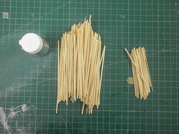

BigGrin Just a quick update, The planks have been cut ready to start the flight deck so time to crack on with it . The off cuts are saved to be used for the short pieces that may be needed.Cool

so the final assault then andy BigGrin what glue are you going to use on the deck planking? cheer`s phil
#536 Posted : 24 November 2015 18:10:39
BigGrin Hi Phil
The plastic deck has been well roughed up so aliphatic should grip ok but if that plan fails I have some laminating epoxy that will do the job as a last resort.
