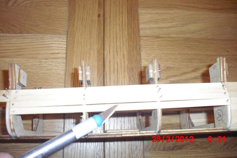

ISSUE 24, 25, and 26
This is the last photo for this tutorial, more to come tomorrow on another subject.
I am dissapointed this Partwork does not come with trenails or pins please buy a couple of packets before you start building.
ISSUE 24 comes with approx 40 planks but it tells you the issue contains 20 planks the extra are required later in the build, please store them away safelyBigGrin
I hope this has been useful to you, I will have completed the 3 issues by tomorrow,and I have found some strange things with this build which I will highlite to youBigGrin
Questions and comments welcomeBigGrin Regards MikeBigGrin

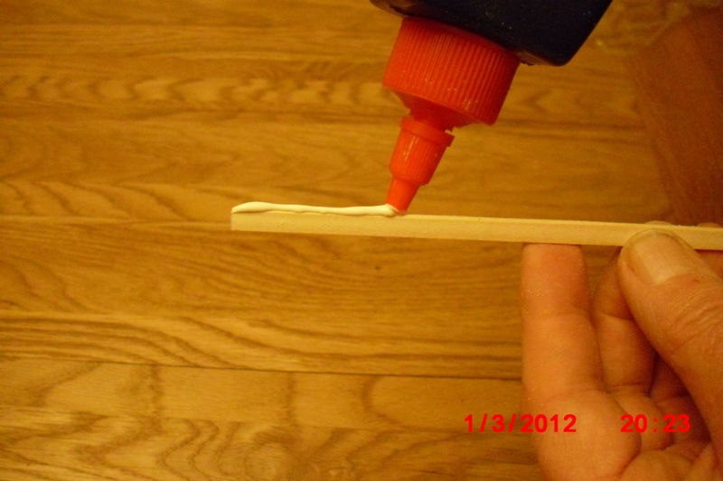

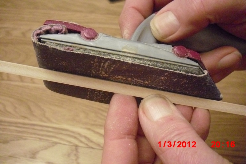

ISSUES 24,25 and 26
TAPER AND BEVEL PLANKS

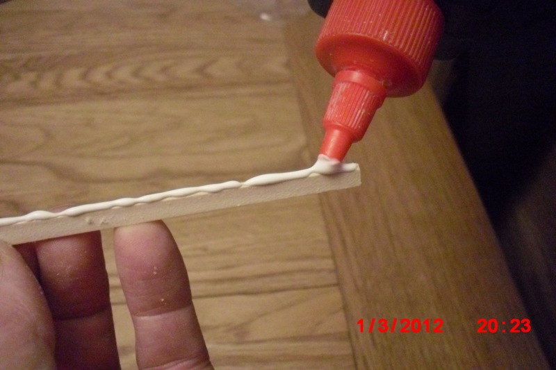

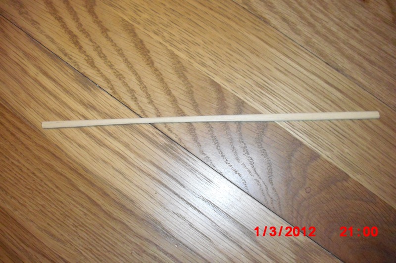

Hi Team I have compiled a series of photos to best explain this process:-
This first process is a bevel (sanding the edge of the plank so it butts up to the next plank)
First sand at an angle, then run some glue down the edge, then fix with pins up to the next plank (using EVO STIK weatherproof adhesive
--- Blue bottle )
Then wipe off excess adhesiveBigGrin Questions and comments welcomeBigGrin

Hi Sean, no worriesBigGrin In this case coat the inside with epoxy adhesive.
If you are making your build R/C, one of Mr T`s tips I picked up sometime ago is to use Plasterers webbing one side is self adhesive, with the epxy adhesive.BigGrin
In all my builds I bevel the plank and use adhesive between each plankBigGrin Regards MikeBigGrin

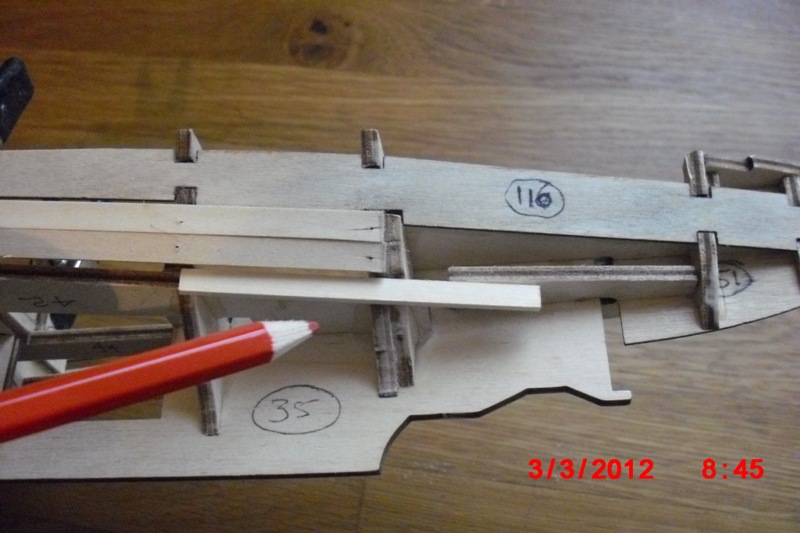

ISSUES 24, 25, and 26

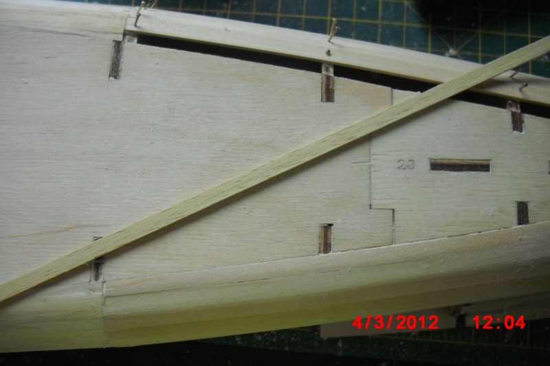

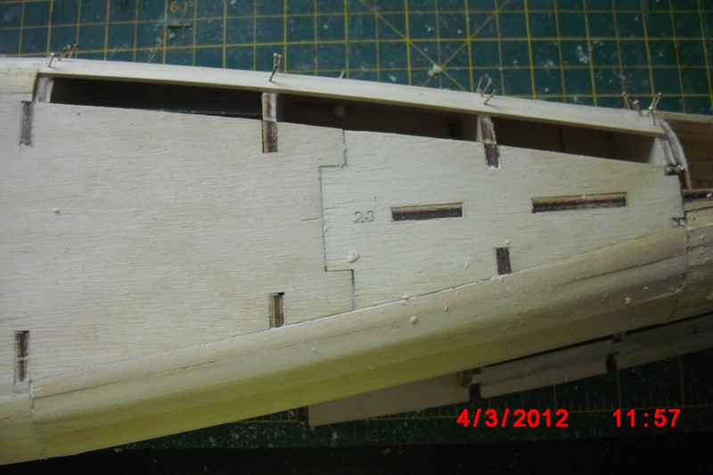

Hi Team I have found a potential problem, at the Stearn rib 39 and 40,I did not have firm rib to fix my planks too here are some photos to highlite the problem and how I overcame it:-
I identified the gap, fitted a 75mm length of 5mm x 2mm.
Then I shaped the piece and finaly fitted the plank.BigGrin (both sides have the same problem.
Questions and comments welcome Regards MikeBigGrin Cool

S2ksean
#531 Posted : 06 March 2012 20:50:39
Joined: 11/05/2011
Posts: 766
Points: 2,128
Location: Dagenham
I had the same problem a few weeks back mike. This is what I did
(ignore the glue it will come off) I used one piece and tapered both edges the cut it in half fitting it in the gap at an angle so the rib was flat. Just another idea although ours is properly the better of the two.
Sean

Hi Sean, I am really pleased you identified the problemBigGrinyour remedy to fix it was first classBigGrin if it works for you dont knock itBigGrin well done mate, regards MikeBigGrin ThumpUp

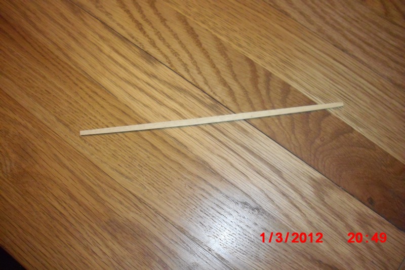

#537 Posted : 07 March 2012 13:52:52

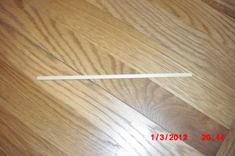

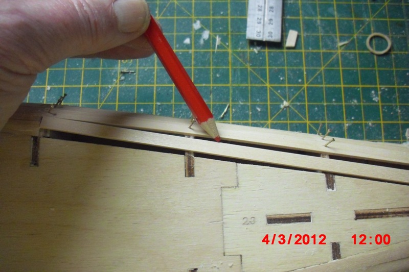

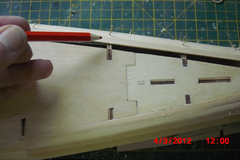

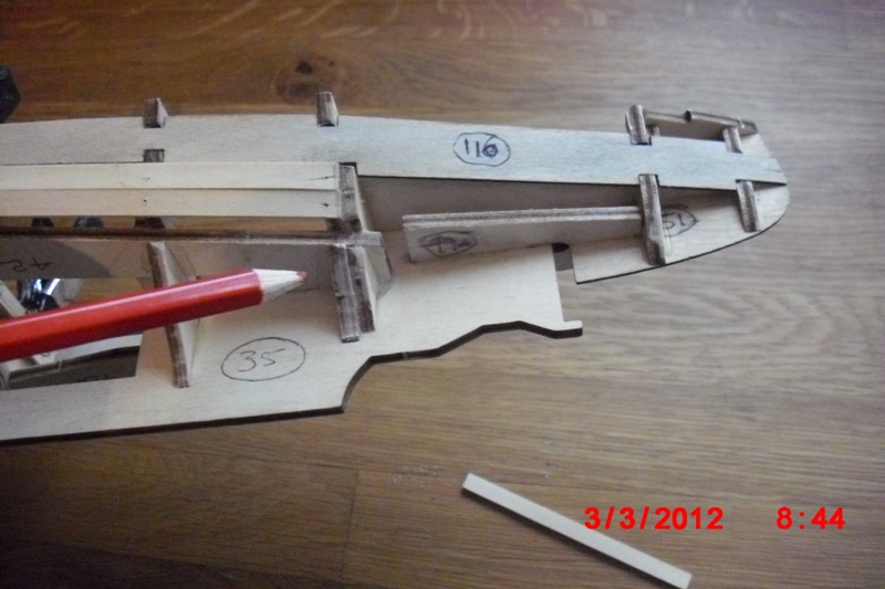

ISSUES 24 25 and 26
TAPERING THE PLANKS
Hi Team as promised a series of photos showing a method of tapering;-
In the two examples you can see what I have done to shape the planks to fit the space, you will also see I have also used 5mm x 2mm planks instead of the ones supplied, this has allowed me to get a better curve where requiredBigGrin

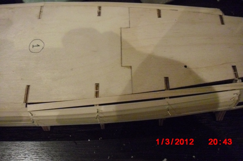

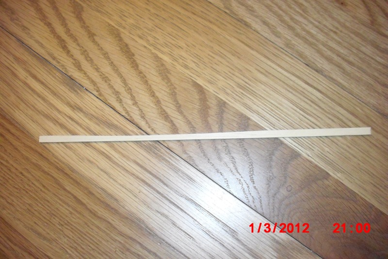

#540 Posted : 07 March 2012 18:22:09

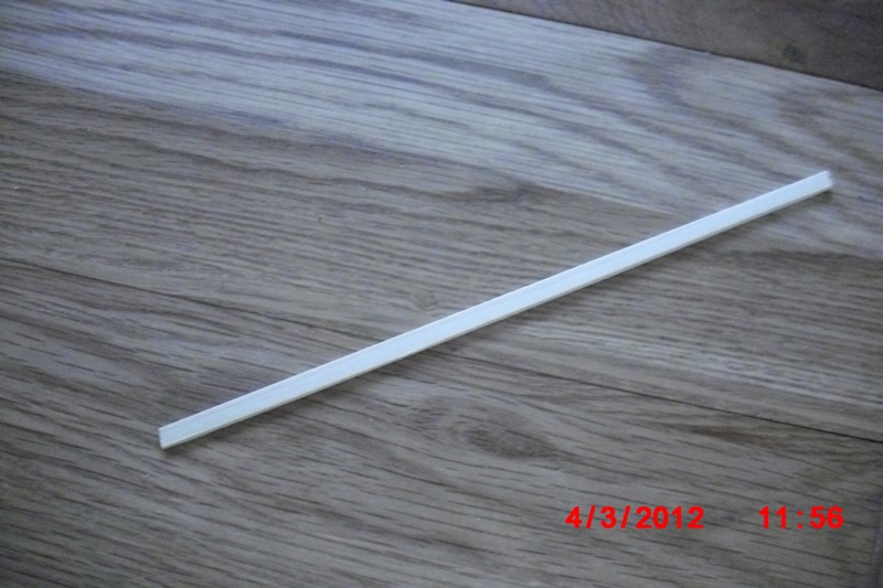

TAPERING THE PLANKS
Hi again here are some more photos:-
The last photo shows the small gaps that appeared, before fitting the planks I pinned this on just to show you,I then took it off tapered the ends of the plank, bevelled the edge and glued itBigGrin
