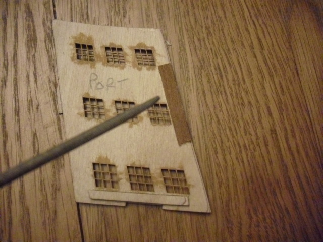

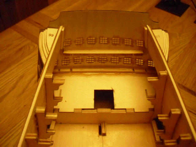

FITTING THE GALLERY SIDE PANELS
Now to the meat of the project.
I fitted a small fillet to the side panels (at the point where the hull shape goes in at the waist:-
#522 Posted : 18 March 2013 22:44:48

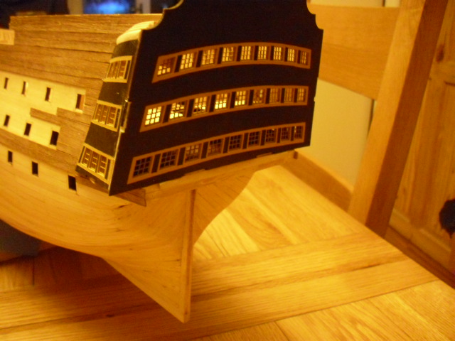

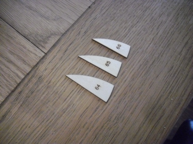

I prepared the tops of the Panels as supplied by De Ag and fitted them:-

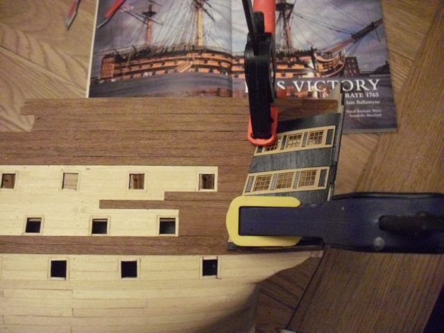

#523 Posted : 18 March 2013 22:47:19

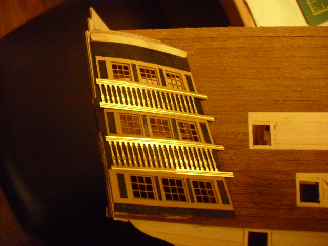

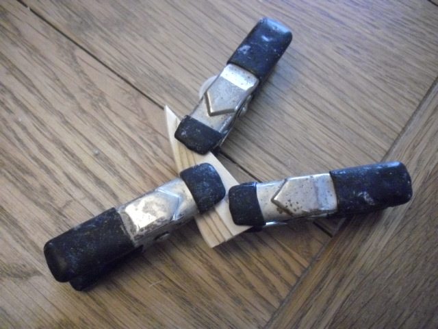

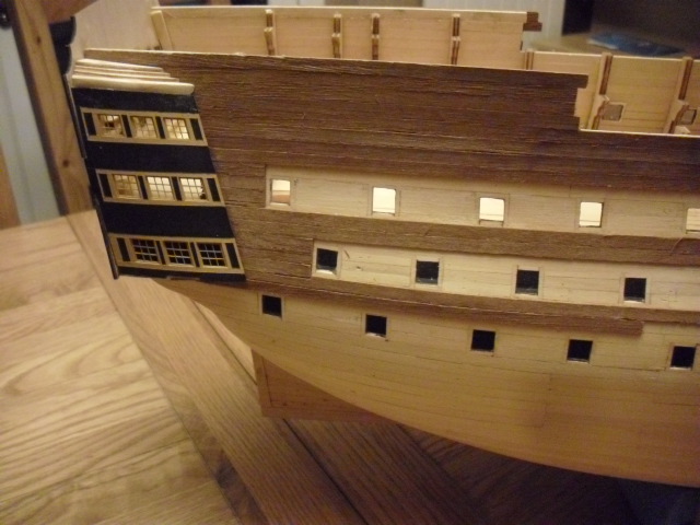

#524 Posted : 18 March 2013 22:53:24
FITTING THE SIDE GALLERY PANELS
The tops of the Panels are dry fitted because I have alot more work on my Victory to do before I fit them permanently.
Well thats all for this session, next time I will be fitting the Ballustrades in brass.
I will leave you with photos of this finished sessionBigGrin Kind regards
Mike

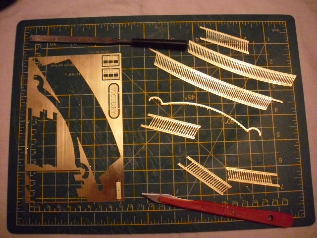

PREPARING THE GALLERY ENHANCEMENT BRASS ETCH

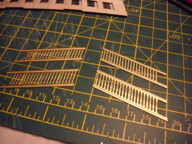

Hi again, the first job is to cut all the pieces from the brass fret, please use a sharp knife.
Then with a file take off the burrs where the parts have been attached to the Fret:-

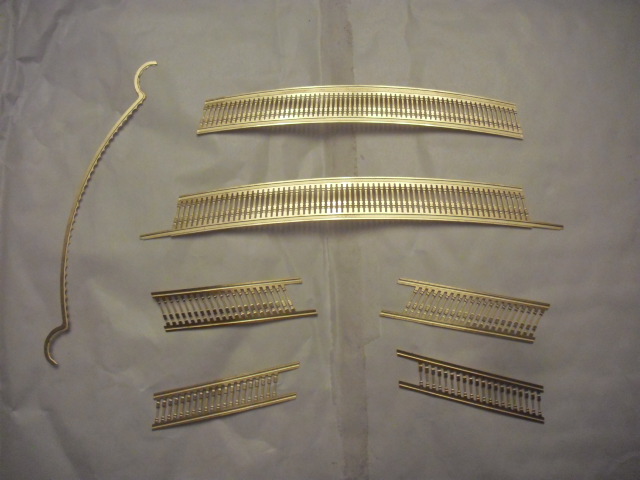

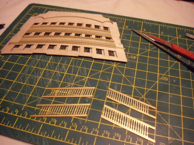

Here are the parts for the stern panel and side panels:-

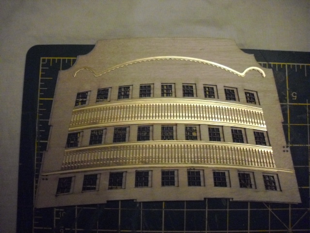

Next we offer the parts to the ship and in each case form the shape of the brass etch to the curve of the particular panel it is being fitted to, being careful not to overdo it:-
