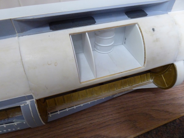

This photo shows the completed mast well looking from the other side.

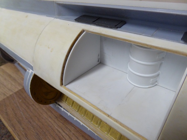

#531 Posted : 27 April 2017 07:30:04
Morning from 'The Dockyard'.
This weeks update will continue with fitting out No.3 Main Ballast Tank [MBT]including the Search Periscope mast well and all pipework.
The attached photo shows the completed mast well as described last week being test fitted into No.3 MBT.

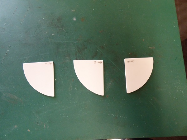

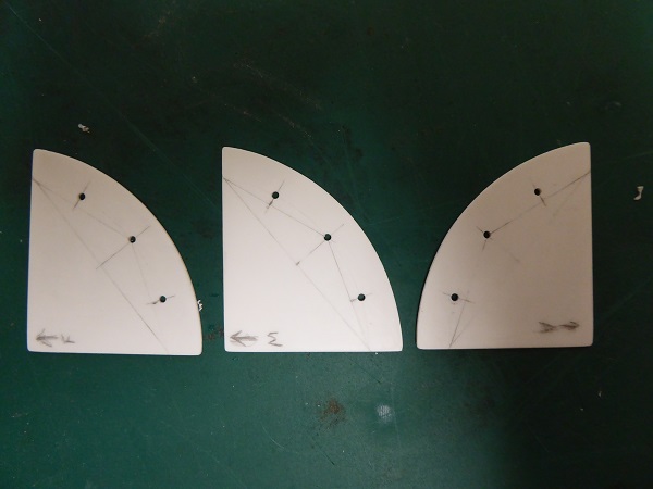

The next step was to fabricate three internal tank supports. I made these from 0.5mm thick plastic sheet. Marking out the correct radii i used a compass cutter to score and cut the plastic. This photo shows all three supports cut out.

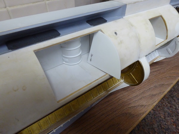

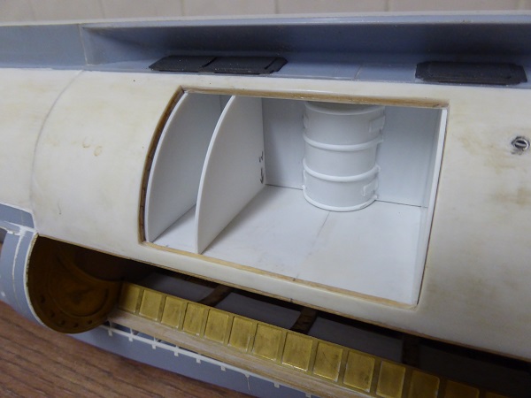

This photo shows the aft support about to be test fitted.
#534 Posted : 27 April 2017 07:37:58
The aft support in place. Again, just a dry fit.

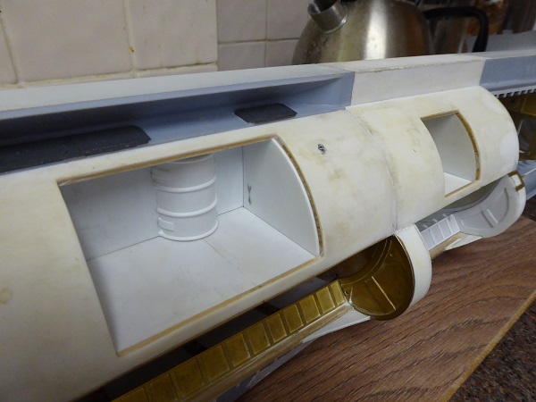

#535 Posted : 27 April 2017 07:39:14
The forward support dry fitted to check it aligns correctly.
#536 Posted : 27 April 2017 07:40:30

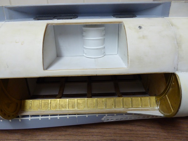

Finally the central support dry fitted in place, again to check for alignment.
#537 Posted : 27 April 2017 07:41:33
Another photo showing all three tank supports in place.
#538 Posted : 27 April 2017 07:45:10

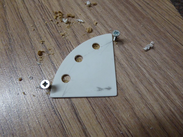

I then removed all three, marked out and drilled pilot holes. These will then be enlarged to form clearance holes. In real life these holes would allow various pipework to run through the tank and also reduce weight without compromising strength.

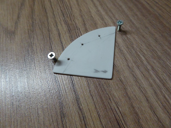

#539 Posted : 27 April 2017 07:47:27
To enlarge the holes I had to fabricate a jig to hold the pieces in place. Using an off-cut of laminate wood I fixed in two self tapping screws which the supports would butt against whilst drilling.
#540 Posted : 27 April 2017 07:49:29
This photo shows the pilot holes enlarged.
