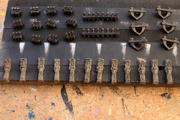

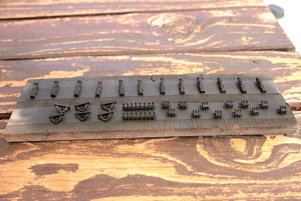

Just a short update today. I painted more of the clip-ons. I started with an etch primer followed by a basecoat of Tamiya Matt Black.
I followed the same recipe on the Caryatids that I used to paint the two statues flanking the door on the main deck; GW Balthasar Gold, GW Typhus Corrosion into the recesses, dry brushed GW Balthasar Gold, followed by a light dusting of Tamiya Neutral Grey XF53.

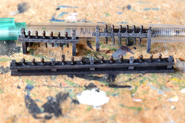

Again, to break up the black, I gave the belaying pins a light brown dry-brushing followed by a VERY light dusting with GW Eshin Grey.

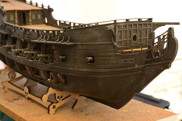

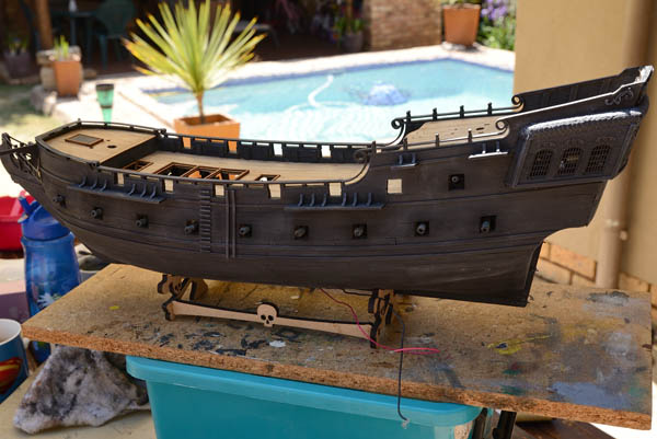

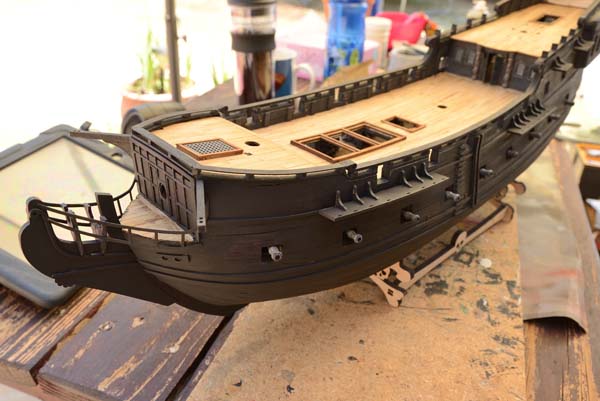

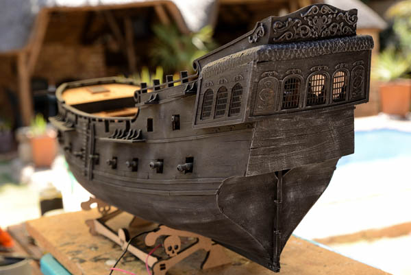

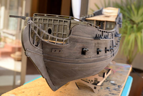

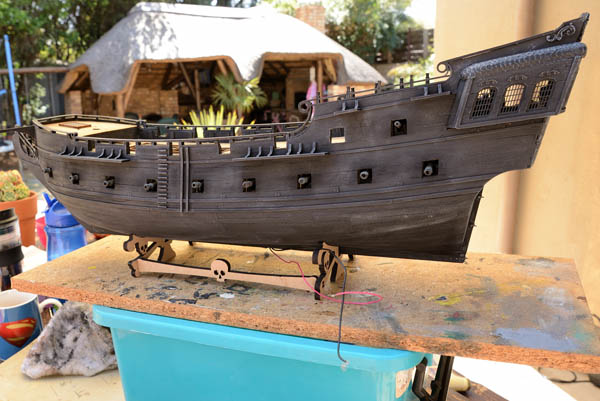

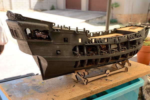

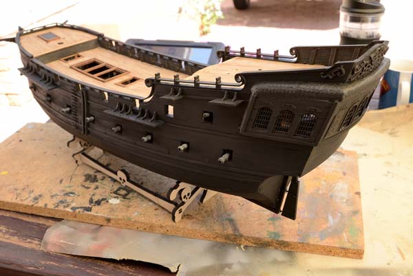

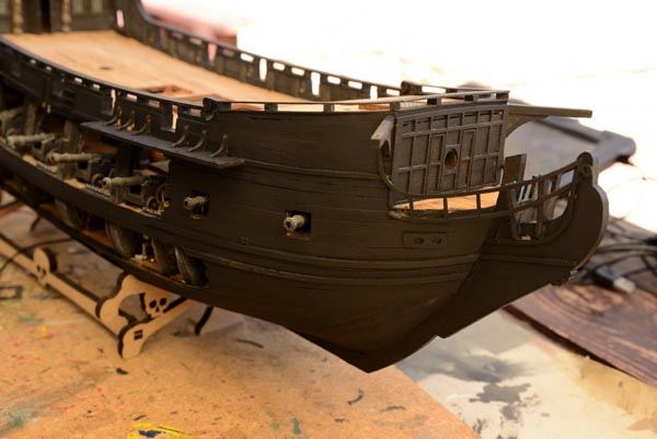

I have a decent update today. BigGrin

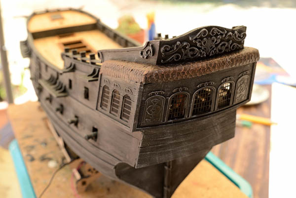

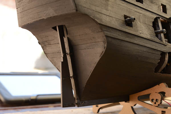

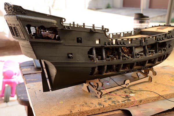

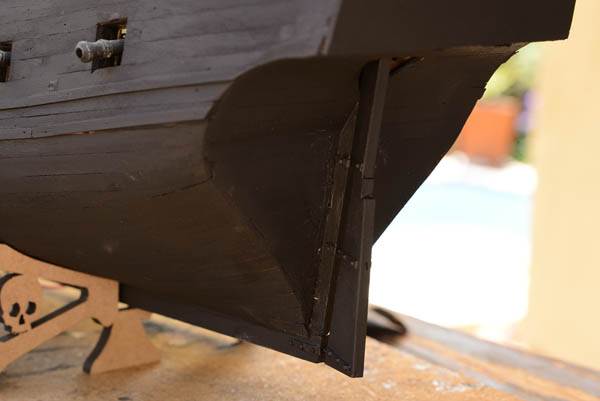

I started the main paint job!!! Basically, painted the entire hull with matt black paint. Followed by a bit of dry brushing. I will add more dry brushing & washes as I move on with the rest of the bits.
skyfire

Beautiful work Garth, that dry brushing really does pit out all the detail.Love Love

Very nice finishing on the Hull Garth. Looks great.

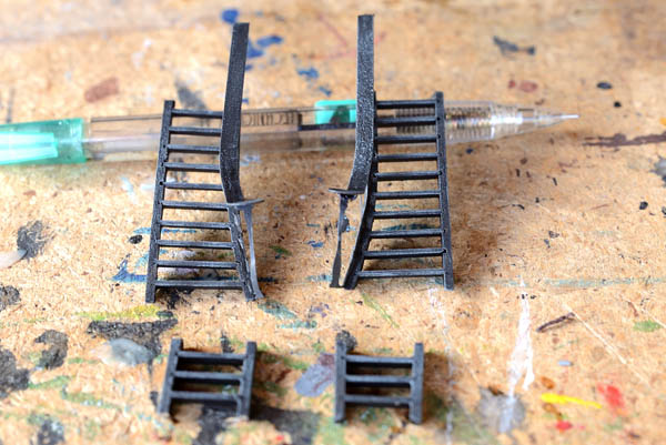

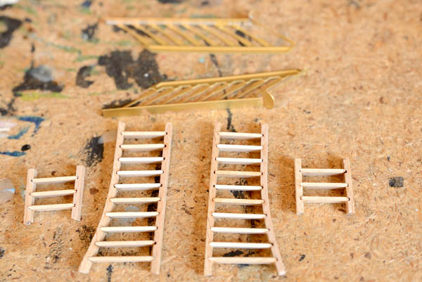

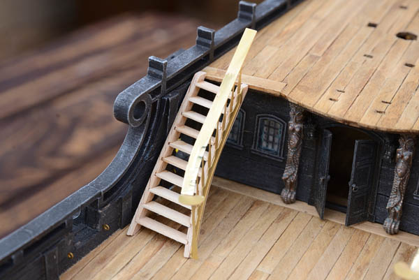

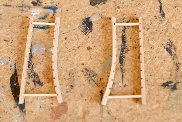

Assembled the main staircase this weekend. The parts provided are to make a straight stair, whereas the Pearls banister is curved inwards. I didn’t feel like remaking the entire stair so following some other build diaries, I modified the existing.
My basic process was to cut the upper stair to 15mm as indicated in the instructions and the lower one to 20mm. I bent the inner channels slightly and then cut every step to match the gap.
The forecastle stairs are as per the instructions.
I soldered the banister together and then made some perpendicular cuts with a Zona saw to facilitate the bends. Once bent I filled the gaps with GW Liquid Green Stuff.
It’s a pity the kit has not included any loose belaying pins. Cursing Fortunately, our suppliers here in South Africa still have some back issues of the HMS Victory in stock, so I bought two extra Issue 55’s, 90 and 94. (90 and 94 are for the rigging to still come).
Once assembled I followed my basic paint schedule, Matt Black followed by a Grey and then white dry brushing.

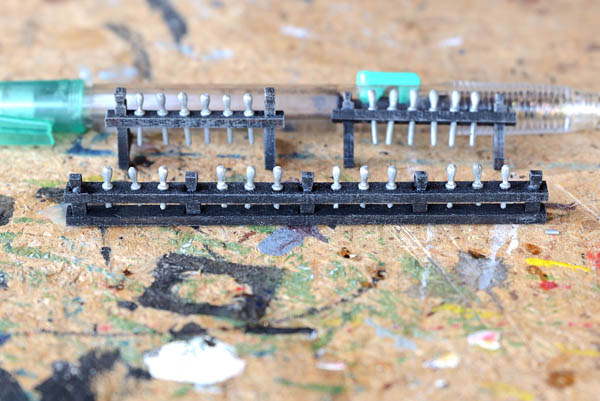

To maintain consistency on the belaying pins I dry brushed them with the same brown to match the others.
Apologies again for the bad pics. I find myself building all over the yard as I follow my daughter around. She’s getting a bit too old to keep her cooped up in the garage with me.
