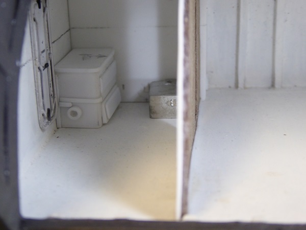

Quick mock up, so i could take further measurements. Unfinished cooker, sink and dividing bulkhead in place.
#502 Posted : 30 April 2021 16:35:50

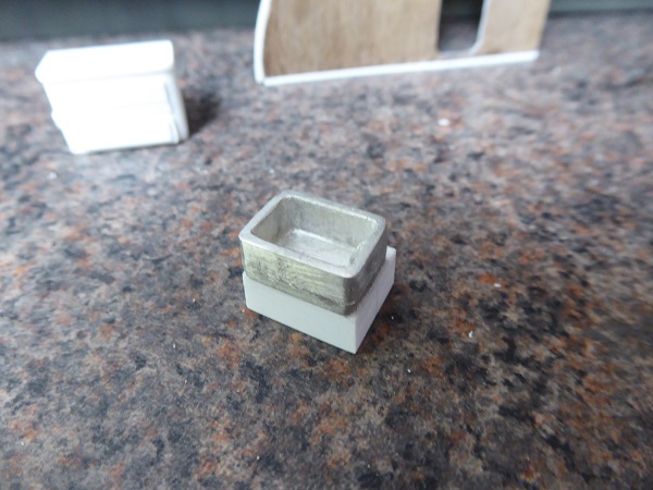

Sink built up to the correct height. I will also finish this item during the weekend.

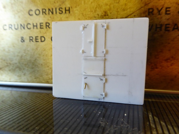

#503 Posted : 30 April 2021 16:36:57
Scratch-built provisions lockers.
#504 Posted : 30 April 2021 16:46:14

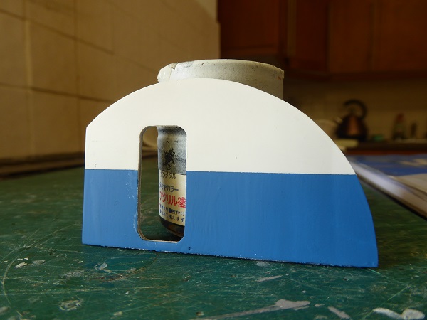

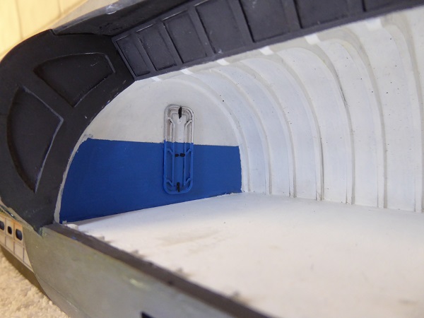

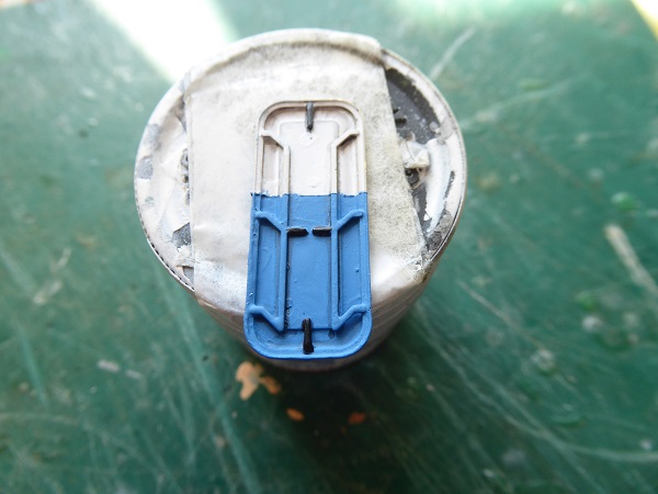

It was at this point i made a creative decision based on the colour scheme of U995. That is, the Galley has its lower half painted in blue. Whether this was true for other U-boats, i don't know. But i like the colour scheme and will use the term 'artistic license' if i'm ever questioned on it.
So a pencil was clamped to an engineers square and the height set. The dividing bulkhead and provisions lockers were temporarily installed while i ran a pencil line around them, as well as the bulkhead that separates the Galley from the Engine Room.
The bulkhead door was then removed and painted in the same colour scheme, as seen in the attached photo.

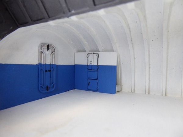

#505 Posted : 30 April 2021 16:47:43
Bulkhead door fitted, with the bulkhead painted also.
#506 Posted : 30 April 2021 16:48:28
Provisions lockers painted.
#507 Posted : 30 April 2021 16:50:14
Lockers fitted. I spent a bit of time when masking, so that the blue paint line matched for alignment against the main bulkhead.
#508 Posted : 30 April 2021 16:50:55
Dividing bulkhead painted in the same way.

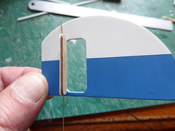

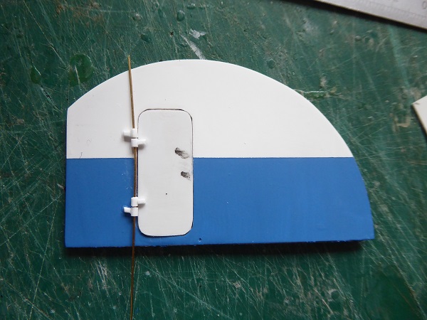

#512 Posted : 06 May 2021 18:53:41
So more progress made on scratch-building different items to fit out the Galley.
The attached photo shows the bulkhead door, that divides the Galley from the Junior Rates Accommodation Space, fitted with working hinges. The brass wire is 0.5mm diameter and is not cut to length, merely acting to align the hinges.

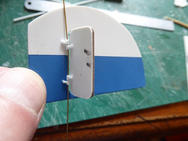

#513 Posted : 06 May 2021 18:54:31
Door opened to check hinges.
#514 Posted : 06 May 2021 18:55:33
Looking from another angle.
#515 Posted : 06 May 2021 18:56:23
The opened bulkhead door viewed from the Accommodation Space side.

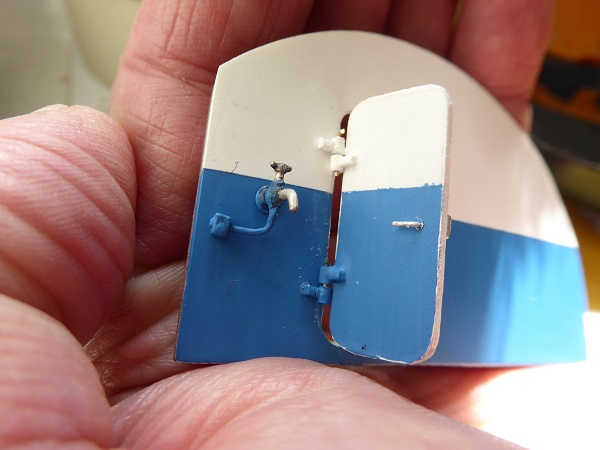

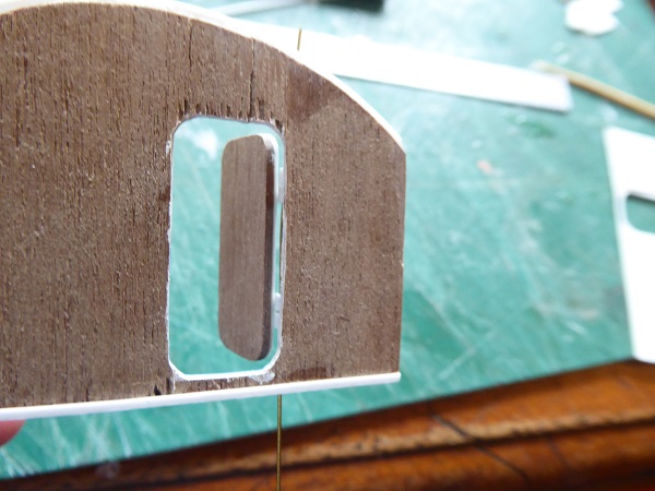

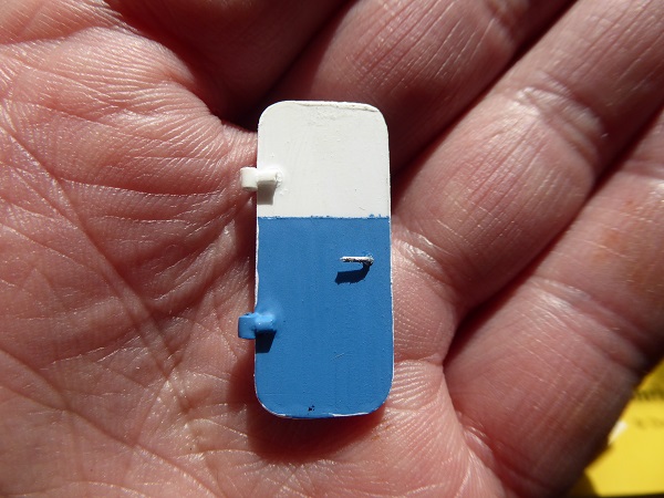

#516 Posted : 06 May 2021 18:56:56
Bulkhead door painted and handle fitted.

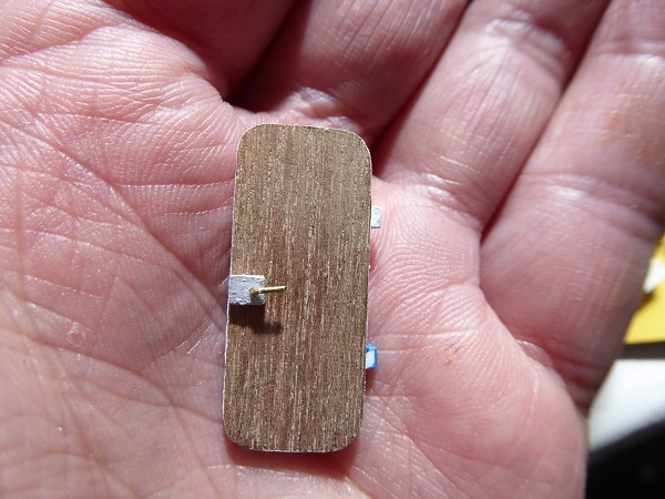

#517 Posted : 06 May 2021 18:57:45
Other side of the bulkhead door showing the handle and lock on the walnut veneer.

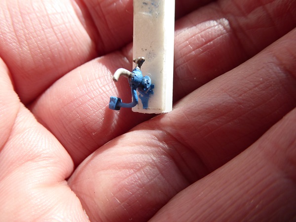

#518 Posted : 06 May 2021 18:58:21
Pewter casting of a tap, painted and pin washed.
#519 Posted : 06 May 2021 18:59:33
Tap fitted to bulkhead and door refitted with hinges trimmed to length.
#520 Posted : 06 May 2021 19:00:42
Door opened.
