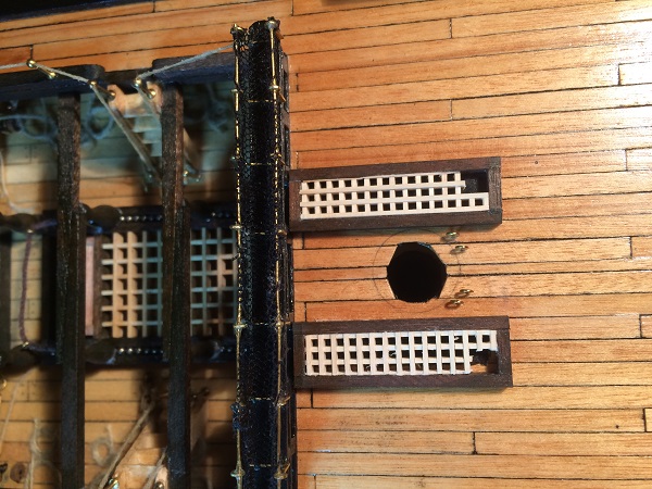

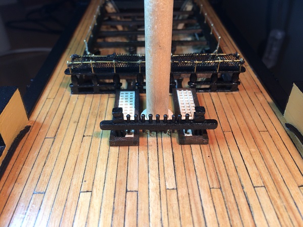

Thanks again for the encouraging comments, guys!
I added the pin rails at the foremast - the problem was that with building the gratings more narrow than in the instructions - the pinrails were shorter and so i had not very much space for the Pins.
I hope this won`t haunt me once the rigging comes up.
Also i attached the two cannons to the deck - didn`t want them just standing there - so i added some securing ropes - don`t know if that`s correct - but it would make sense.

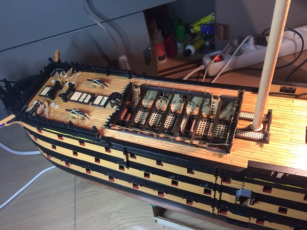

#505 Posted : 13 November 2017 11:04:53

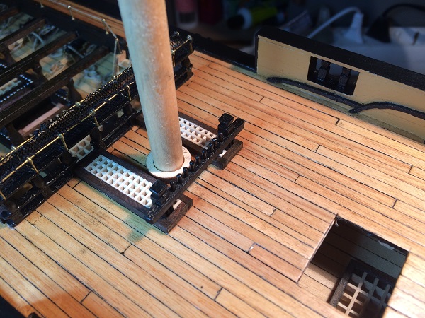

Next up was the gratings and pin rail around the main mast.

The last four of the cannons were attached.

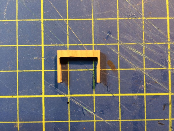

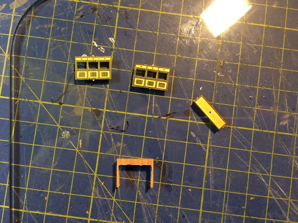

I invested much thought in how to make the binnacle.
I used Mike`s enhancement parts - but wanted to enhance them further.
As you can see i first cut out the middle part so that only the frame remained.

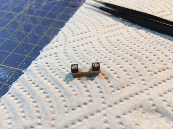

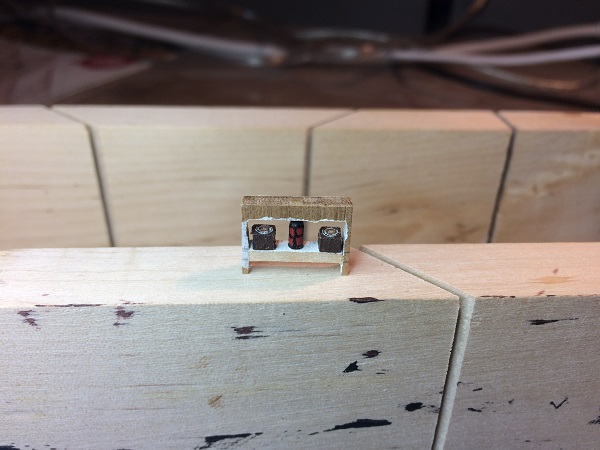

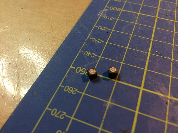

#513 Posted : 20 November 2017 09:51:02
Then i produced the two compasses out of 3x3mm wood. I decreased the picture of a compass-rose in size, printed it and glued in on top.
The lantern i made out of a toothpick.
The three part were glued on a piece of wood and inserted into the frame.

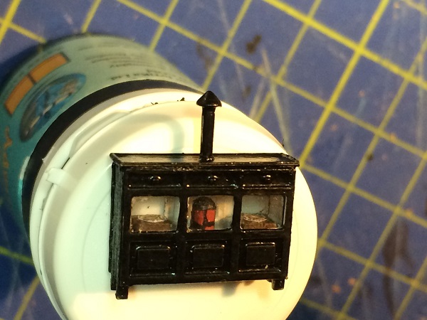

#514 Posted : 20 November 2017 09:52:58
At last i added the PE-parts and the windows.
