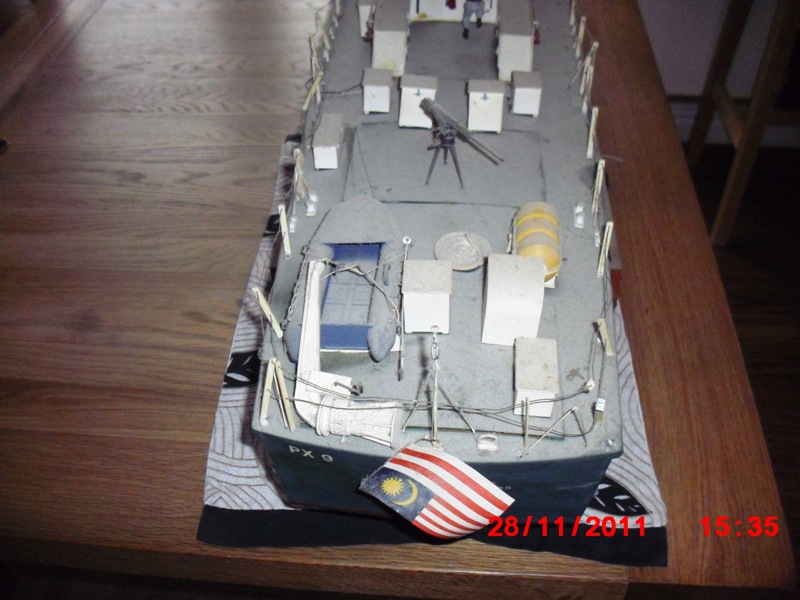

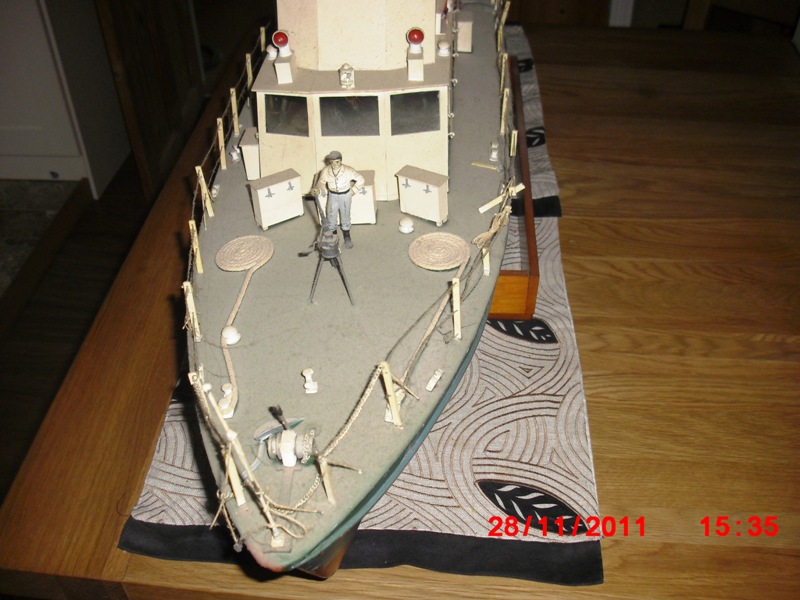

Hi Ian, I think the ship will develope into a stand alone static modelBigGrin with all the fragile parts,BigGrin there is a danger they could break offBigGrin
I have also been given the Malaysian police launch complete with RC which has meant I have no need for twoBigGrin Best regards MikeBigGrin
#508 Posted : 24 February 2012 14:43:53
I Know what you men mike, you end up with loads of radio bits to have to store away, boats and helecopters.
Launch looks nice have you tried her yet Ian Cool
#509 Posted : 24 February 2012 15:04:18
Hi Ian I want to do some work on her for the summerBigGrin So I can take my grandchildren boatingBigGrin should be fun !!!!Regards MikeCool

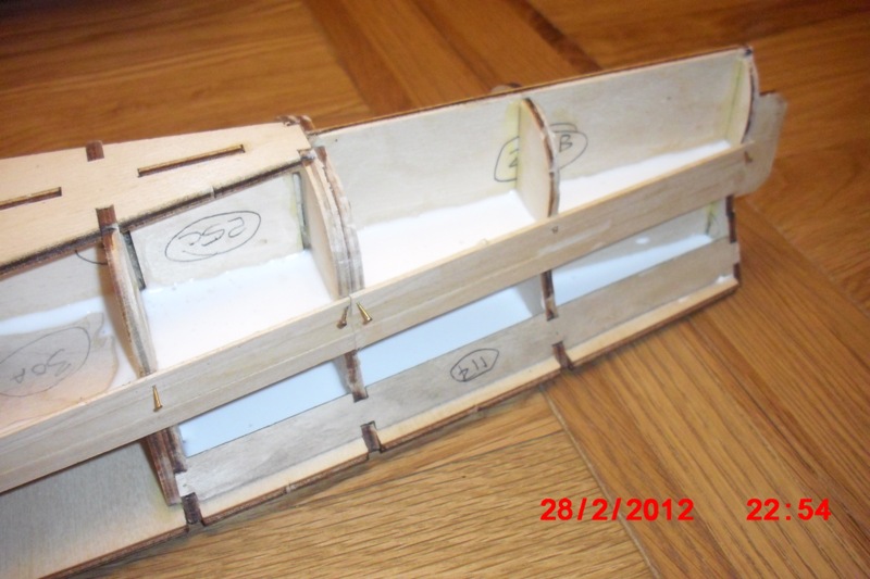

ISSUES 24, 25 and 26
Hi Team I am going to try and explain with pictures, for the new people,
How I have Tapered and bevelled planks, and how I have faired the Hull ribs.
Ok, it is my opinion there are short comings in the instructions of this build. The ribs in the photos have certainly been faired but the instructions do not explain how.Blink
I know you experienced modellers do it automatically, and your are saying to yourself "whats he talking about its easy"? Its not easy to a new person,Confused so here goes!!!!
First photo:-In this one you will see I have filed the edge of each rib ,which is the nearest to the leading edge of the bow. Pay particular attention to the rib which is fitted with part 110,it gives a thickness which is the equivelent to 2 ribs this must be filed untill you can not feel the join and angled to the shape of the finished planked hull.
In this photo you will see the white between the ribs, this is wet PVA I have just applied for extra south
#520 Posted : 03 March 2012 21:42:13
Where ever you have the double rib pay particular attention to making sure you cannot feel the join these are 3b/8b/11/37 and 40 (plus the one I have allready shown you) you can not spend to much time fairing the Hull it will pay you dividends later when you start planking.
