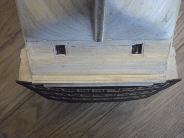

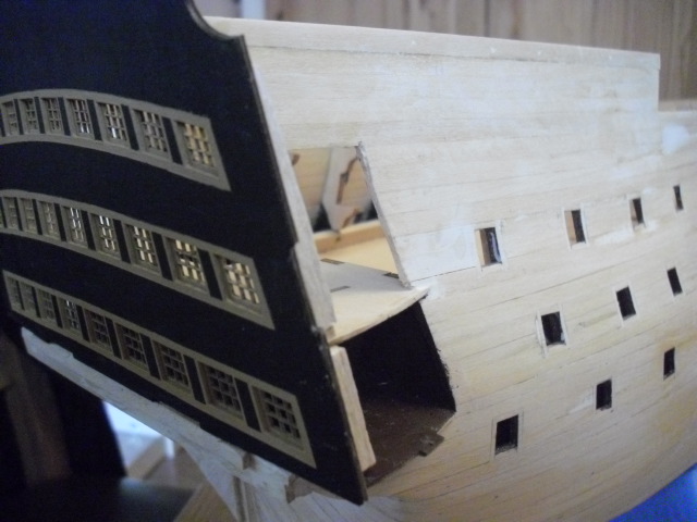

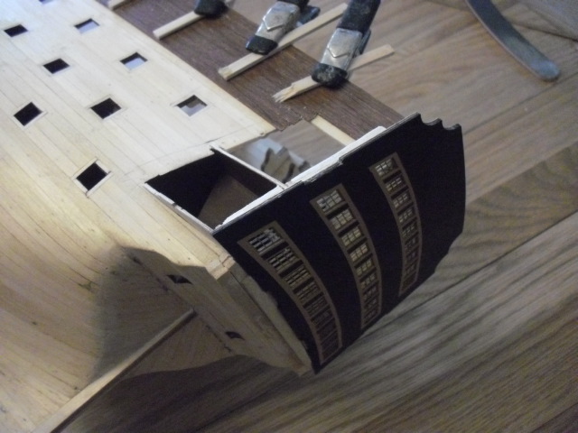

FITTING THE GALLERY STERN PANEL
Welcome back Team, when I fitted this Stern Panel to my ship I felt very emotionalCrying maybe its the months of work on the Gallery enhancement, or my Victory receiving its identity, any way who knows how or why but it was a great feeling.Blushing
this time we are fitting the stern panel the side panels come later.
STAGE ONE
Please take your time, and make sure you achieve the fit that is acceptable to you.
Please make sure you can clamp the panel easily without stress or damage.
I have used Aliphatic glue, but allow it to cure for 8 to 18 hours (24 for good measure) it is twice as strong as ordinary PVA.

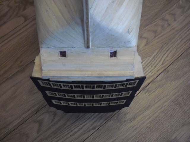

Spread adhesive on the 2 rear deck pieces and slot the panel onto these decks(as in the photos)remember there are 2 slots at the point where the bottem of the panel comes in contact with the bottem deck, locate the panel in these.
I hope the photos tell the story:-

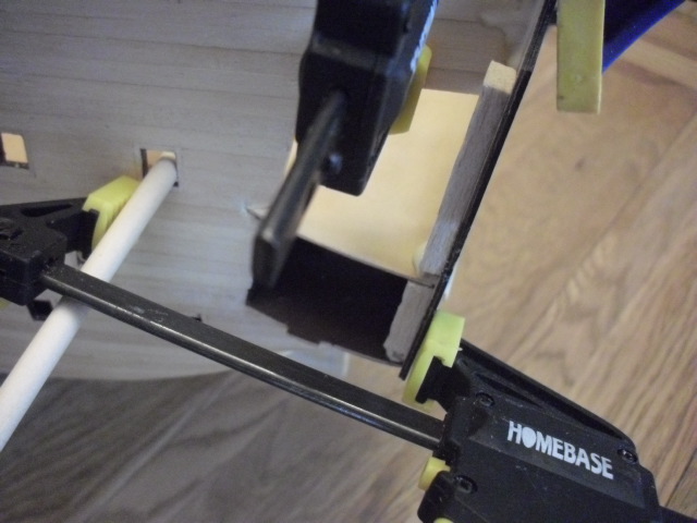

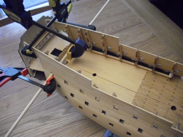

#504 Posted : 16 March 2013 16:30:59

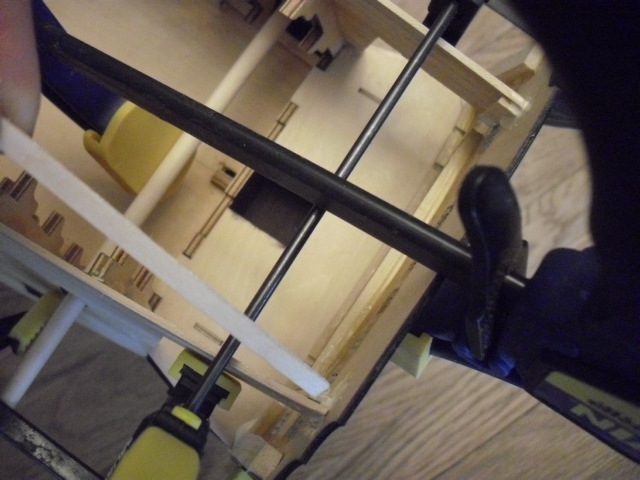

STAGE TWO

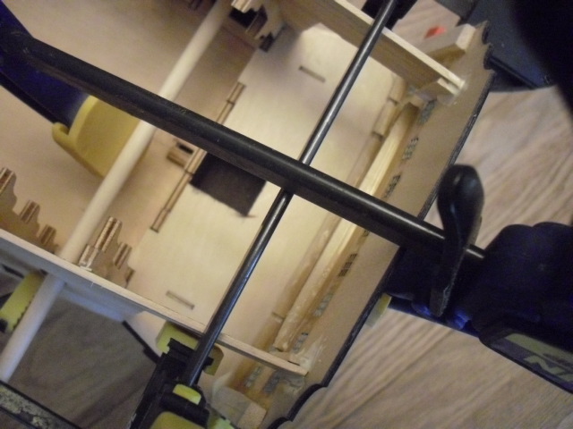

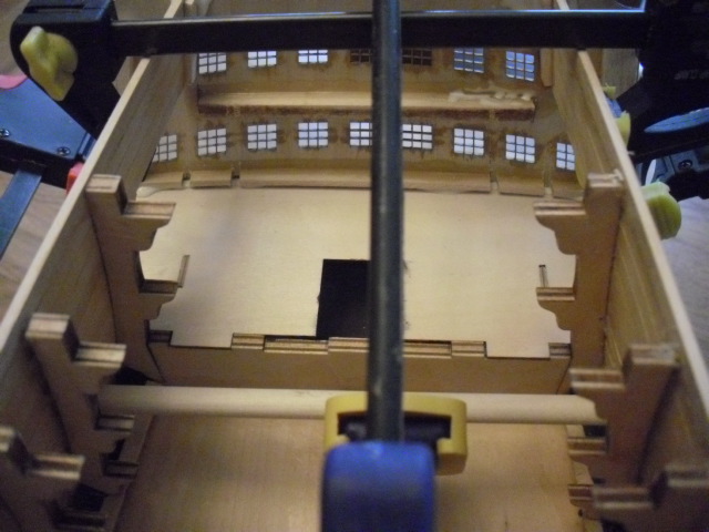

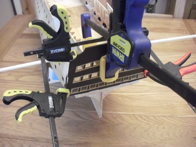

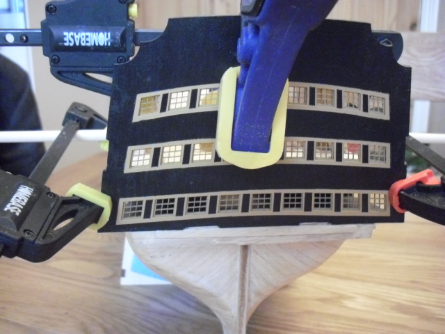

I have used short bars and long bars as clamps, a piece of dowel provided an anchor point.
You will need to pull the corners of the panel to the shape of the decks, this is why we cut the two sets of slots, and I used 2 short bars for this job, the courners came in with no problem
Next use a long bar to apply the tension to fix the panel to the sides of the ship ( you will see I added 2 pieces of wood to give a better area for fixing);-
Please make sure the sides are located between the windows, I used a short bar to assist in this.
STAGE THREE
after 24 hours remove all clamps and review your work.

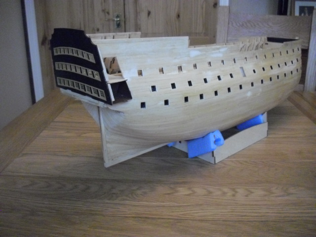

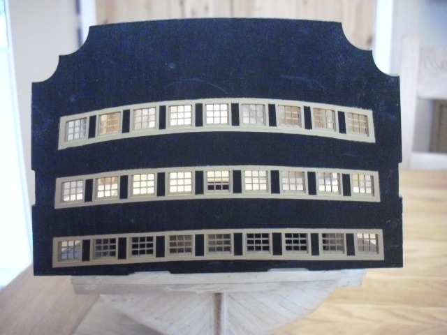

I have included lots of photos of my ship proudly showing off her Stern Gallery panel:-

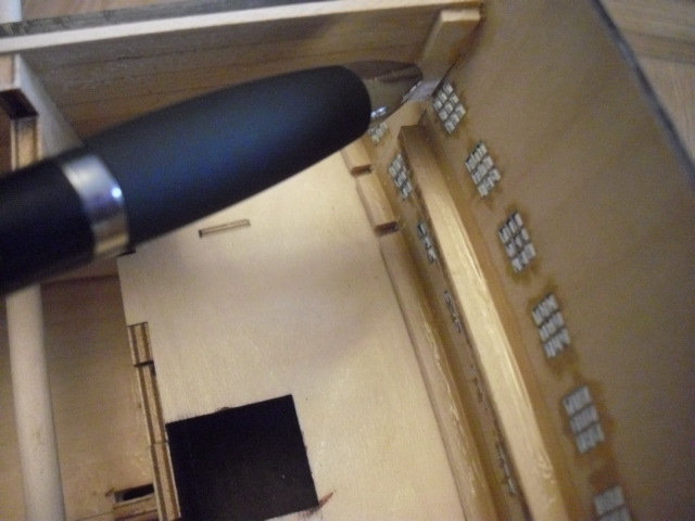

#505 Posted : 16 March 2013 16:39:35

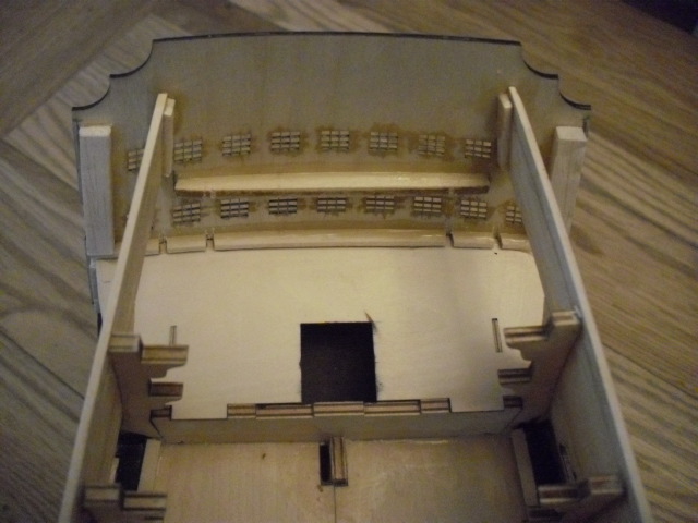

Here are the photos, with the clamps off:-

Well Team thats all for this session, thank you for looking in, as usual questions and comments are welcome.
I will leave you with my favourite photos of this session.

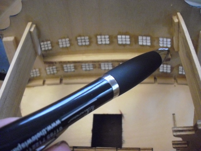

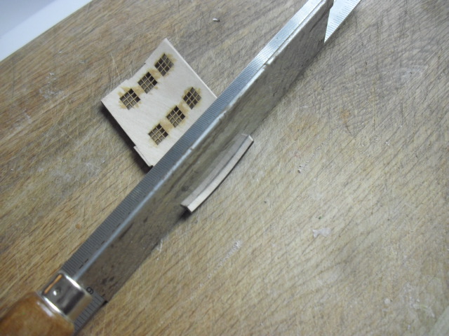

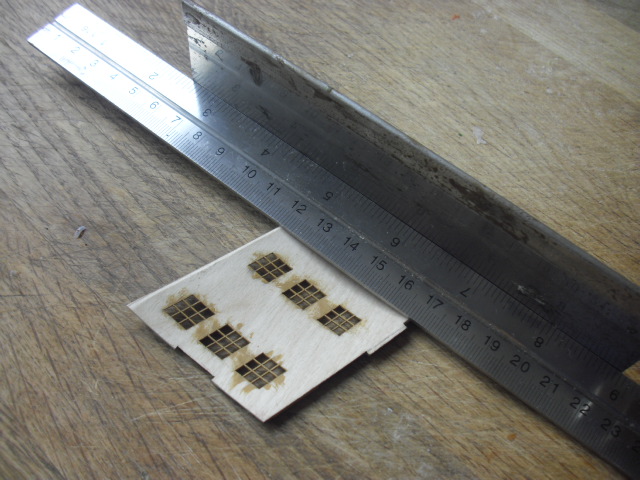

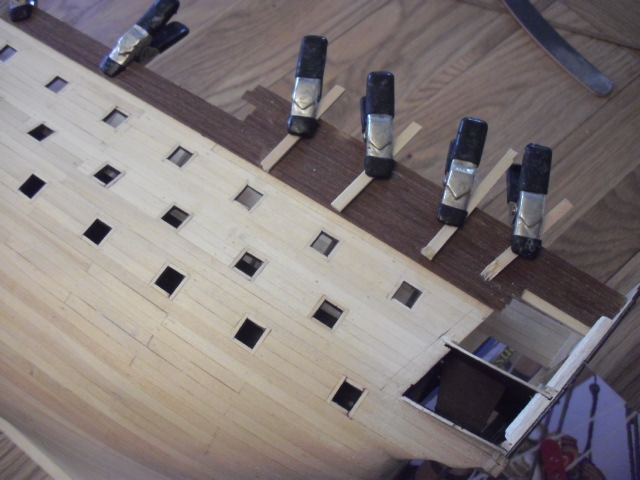

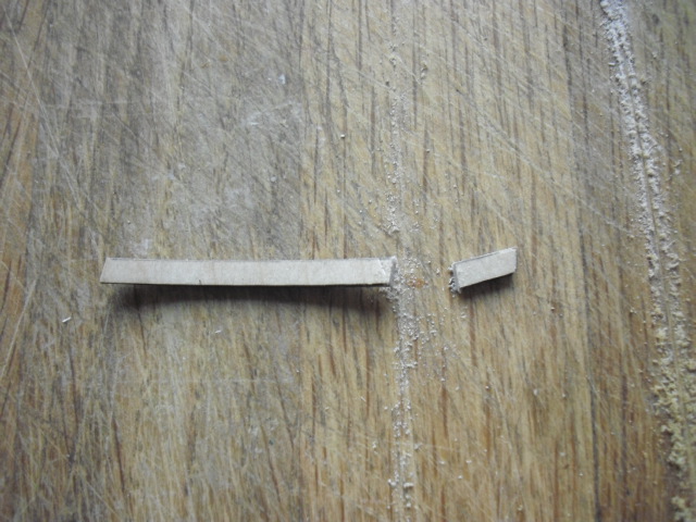

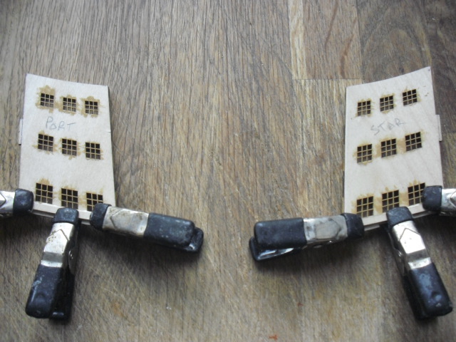

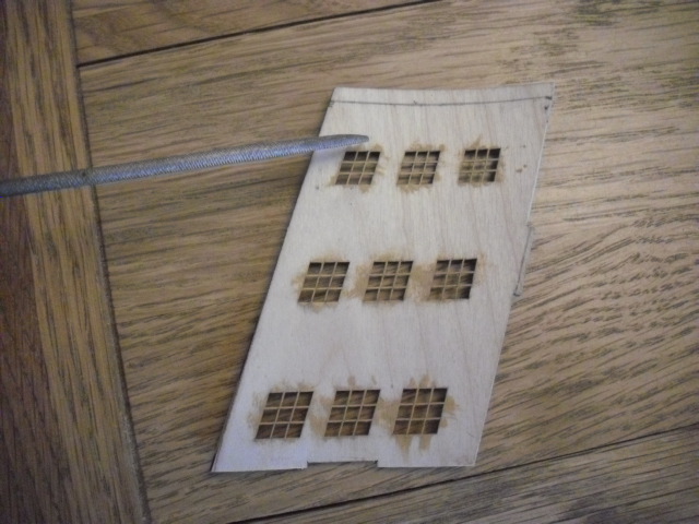

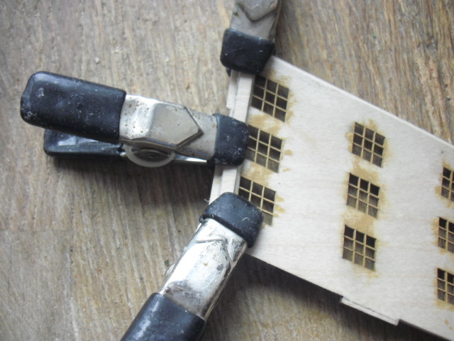

FITTING THE GALLERY SIDE PANELS
Well here we are with the next session,this is where I have fitted the gallery side panels.

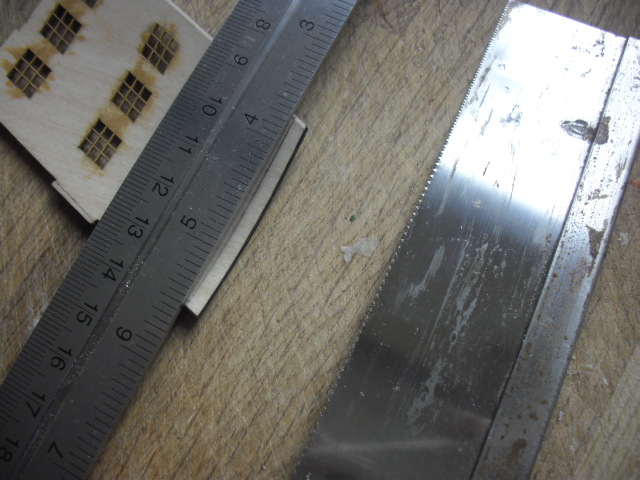

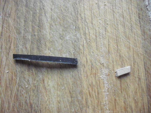

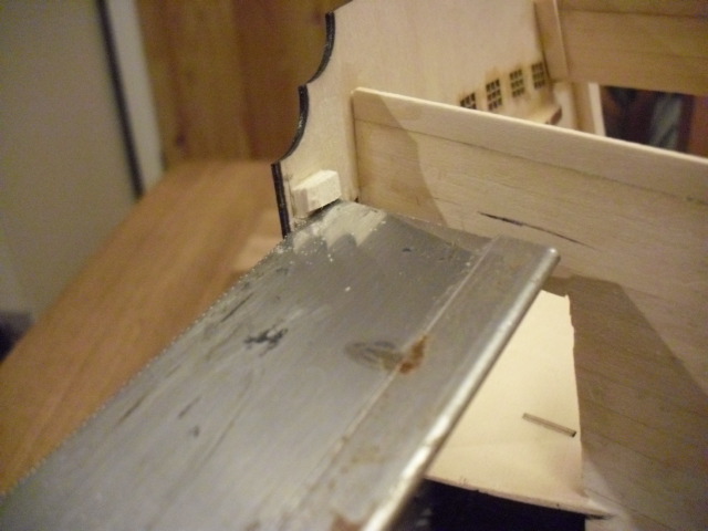

The first job was to take off 4mm from the top of the panels (every build will be different and will require + or - off the panels) the piece that I cut off I used as a fixing baton---I hope the photos tell the story:-

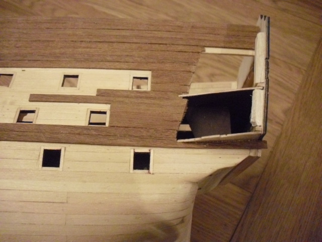

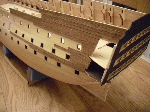

#519 Posted : 18 March 2013 22:32:40

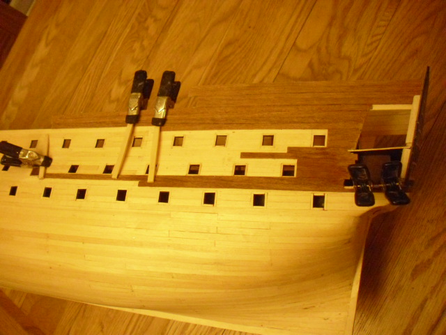

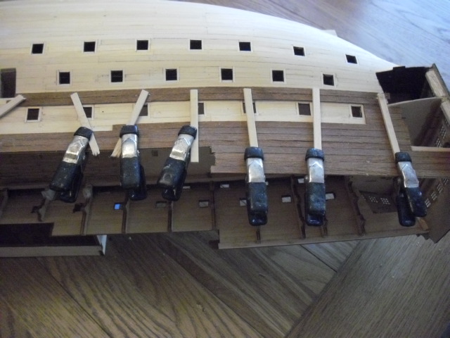

Before I could fit the panels I had to second plank the area to be covered, in a way it would be easier to carry on later.
I am second planking my Victory because I want to recreate the gun port recesses plus when using walnut planking( 5mm x 1mm )the grain is as close to oak you are going to get at this scale (I am still going to paint her.)
What follows are photos of this second planking process:-
