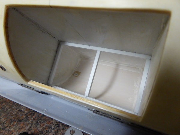

From another angle.
#502 Posted : 20 April 2017 18:48:27

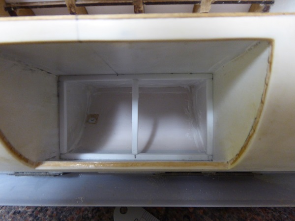

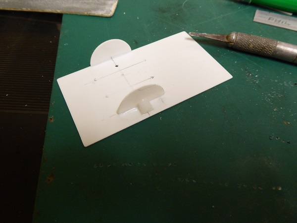

One more photo showing the frame work. I then proceeded to cut out a piece of 0.5mm plastic sheet to fit this area. This blanking sheet is what I will then build all the details on. At this stage is was just a dry fit and thus removable while I worked on it separately.
#503 Posted : 20 April 2017 18:55:19

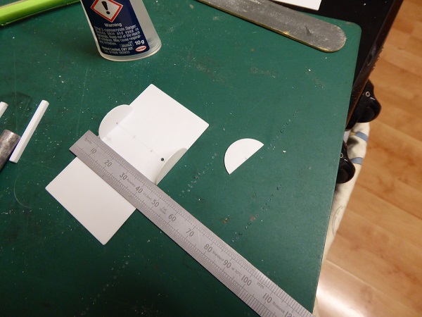

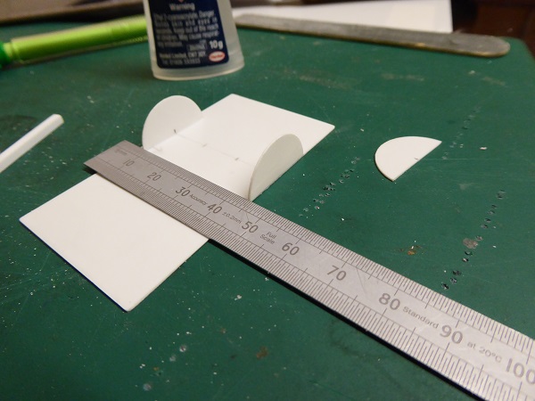

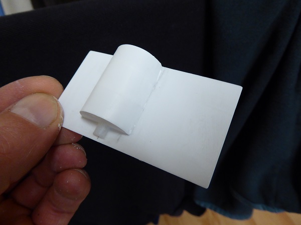

With the blanking piece removed I could mark out the centre line position of the mast well. From here it was a case of building up semi-circular shapes to represent the mast well formers. For this I started by cutting out two 22mm diameter discs from 0.5mm plastic sheet. I used a compass cutter for this job. When they were both complete I marked out the centre line of each then marked out a cut line 0.5mm on each side of the centre line to allow for the thickness of the blanking piece. By this process I produced 4 partially semi-circular discs which are to be used as formers for the mast well.
The attached photo shows the first two formers glued in place along the pre-marked mast well centre line.

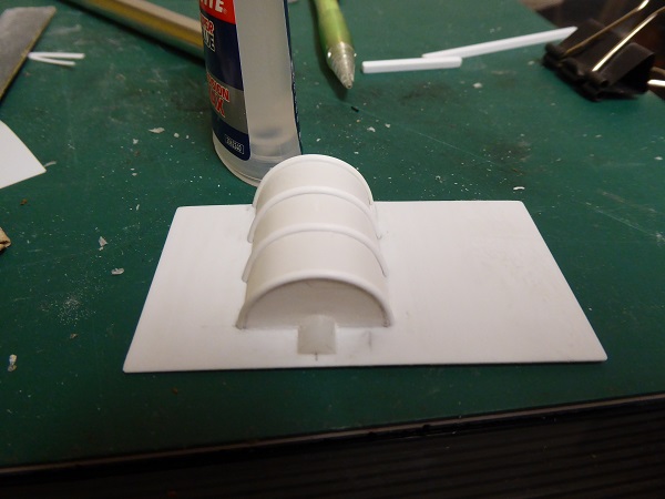

#504 Posted : 20 April 2017 18:56:35
Another photo of the first two formers in place with the third former alongside ready for fitting.
#505 Posted : 20 April 2017 18:58:59
The photo shows some detail added to the lower former. This detail would in fact be a mast well drain where the water ingress from the periscope being lowered would collect and then pumped out later.
#506 Posted : 20 April 2017 19:00:21
All four formers fixed in place.
#507 Posted : 20 April 2017 19:01:18
Another photo showing all four formers fitted.

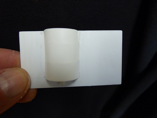

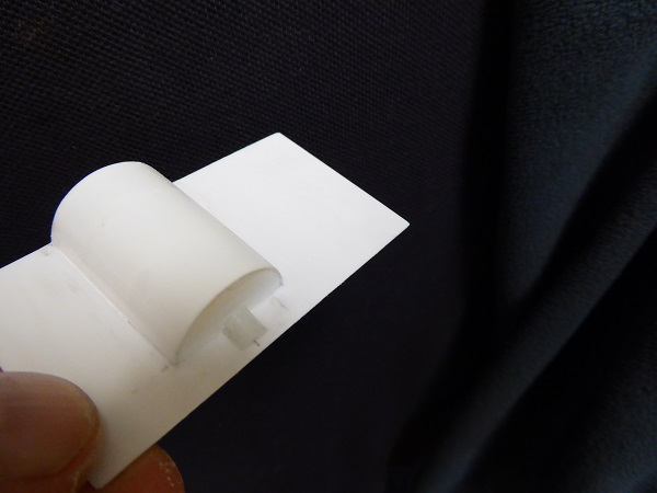

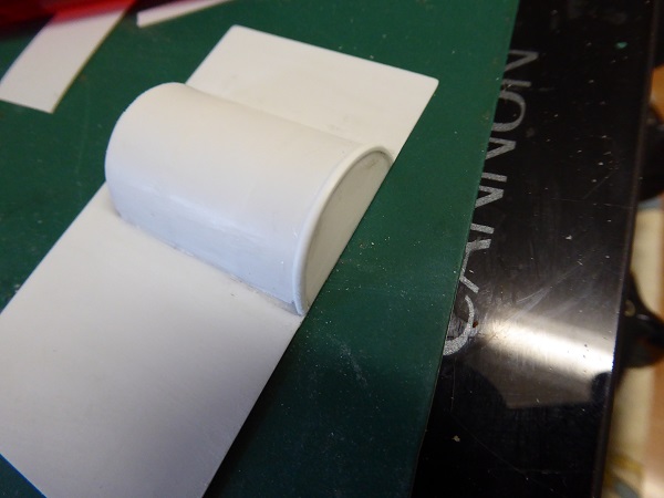

I then cut out a piece of 0.25mm thick, plastic sheet to wrap around the formers to make the mast well housing. The attached photo shows the 0.25mm thick sheet, cut and fixed in place.
#510 Posted : 20 April 2017 19:45:38
birdaj2 wrote:
Another really interesting update and some very precise work being carried out.
Thank you Tony. Much appreciated!
#511 Posted : 20 April 2017 19:47:17
Another photo showing the sheet wrapped around the formers.
#512 Posted : 20 April 2017 19:48:43
Showing from a different angle.

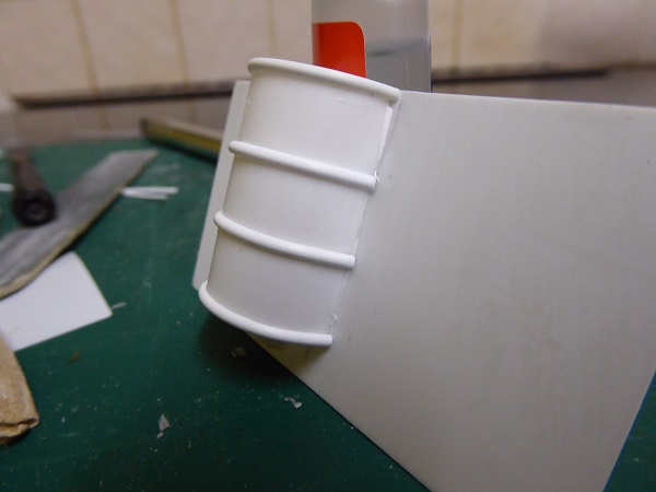

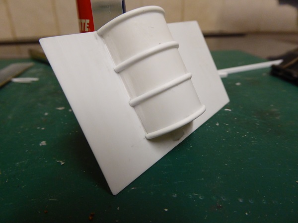

#513 Posted : 20 April 2017 19:52:54
To represent the seams on the housing, I cut and glued four equally spaced 1.5mm half round strips around it's diameter. This photo shows the first seam in place.

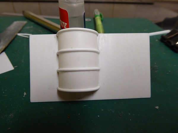

#514 Posted : 20 April 2017 19:53:54
All four seams in place.
#515 Posted : 20 April 2017 19:55:17
From another angle. At this point it's really starting to take shape.

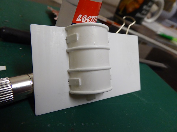

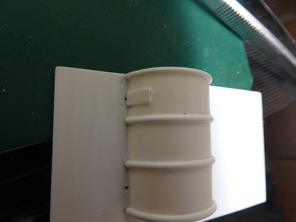

I then added some detail; four panels, two top and two bottom. These would of probably been access panels when the U-Boat was being built in dock.

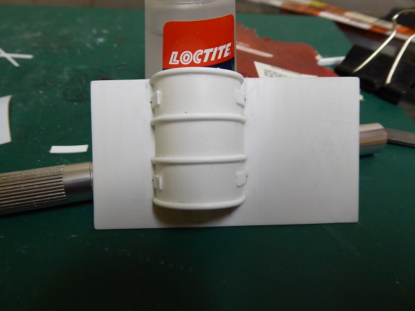

#519 Posted : 20 April 2017 20:03:25
All four panels in place. These were made from 0.5mm thick plastic sheet, cut to size and then bent to match the curve of the mast well before fixing.
#520 Posted : 20 April 2017 20:04:39
This photo shows the panels from one side.
