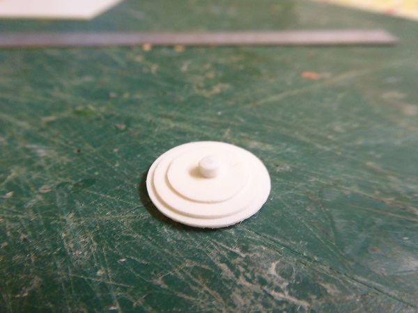

So i made a start on the Galley/Junior Rates Mess which involved lots of time staring at photos, making mental notes of positions of key items.

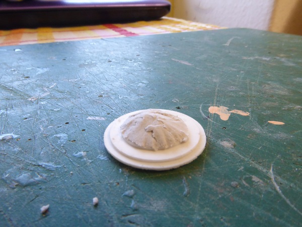

I then made a start and fabricated the water-tight hatch that is located on the forward bulkhead of the Junior Rates Mess and connects it to the Control Room.
The attached photo shows different diameters of 0.5mm thick acrylic sheet, cut out with a compass cutter and glued together.

Polyfilla applied, so that i can file it into a dome shape once dry.

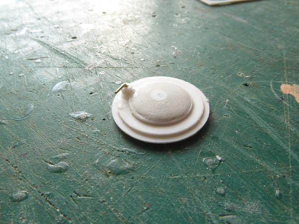

Polyfilla shaped and locking handle fitted.

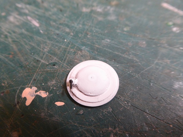

#490 Posted : 22 April 2021 21:07:07

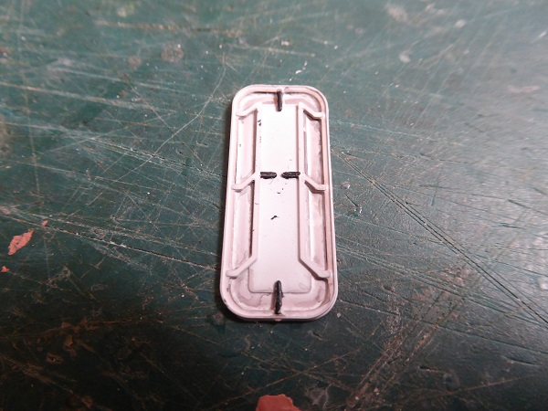

So the kit provided bulkhead door, which i didn't use, as i scratch-built an open version connecting the Engine Room to the Motor Room/Aft Torpedo Compartment, meant i could use it for the Galley! Ace!BigGrin
The attached photo shows it painted, varnished, pin-washed and ready for fitting.

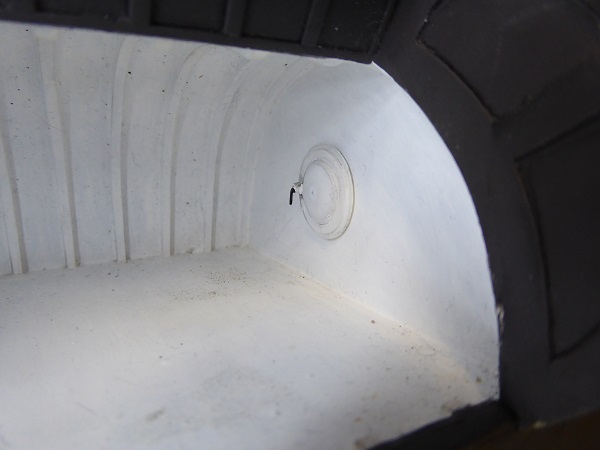

#492 Posted : 22 April 2021 21:11:34

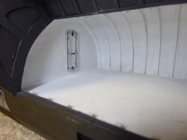

The attached photo shows the Junior Rates Mess bulkhead door fitted. It was only later i realised i had positioned it slightly too high and i also forgot to add the hinge!Blushing So, this will come off next week so i can add the hinge and then reposition it a little lower.

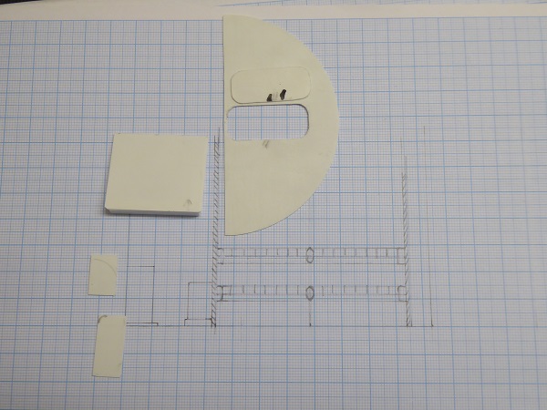

The attached photo shows the scale plans i drew up. I also fabricated the dividing bulkhead which will separate the Galley from the Junior Rates Mess, including the cut-out and the door. Also in the photo are the basic shapes of what will be stores lockers and the base and one side only of the cooker, both for the Galley.

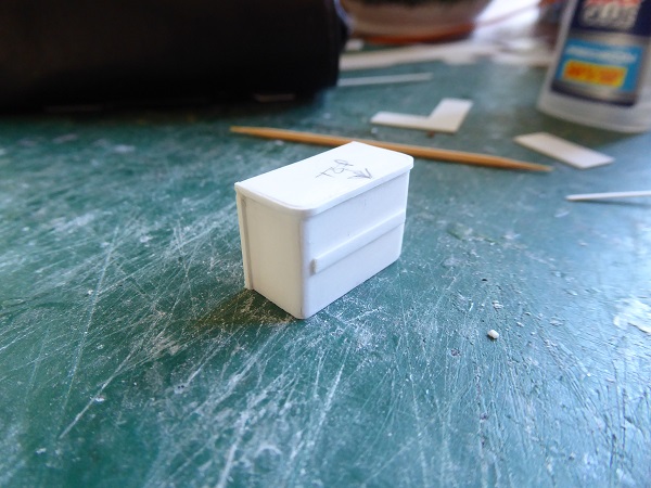

Progress has been made on fitting out the Galley this week.
I started off by scratch-building the cooker. See attached photo. It's not quite complete, that's a job for this weekend. I just wanted to gauge length, depth and width, as space is at a premium in this small space.

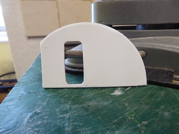

When i came to test fit the sink, i realised the door way, in the dividing bulkhead between the Galley and Junior Rates Mess, was in the wrong place and needed to be off-centre. So i made another!Blink
#499 Posted : 30 April 2021 16:32:18

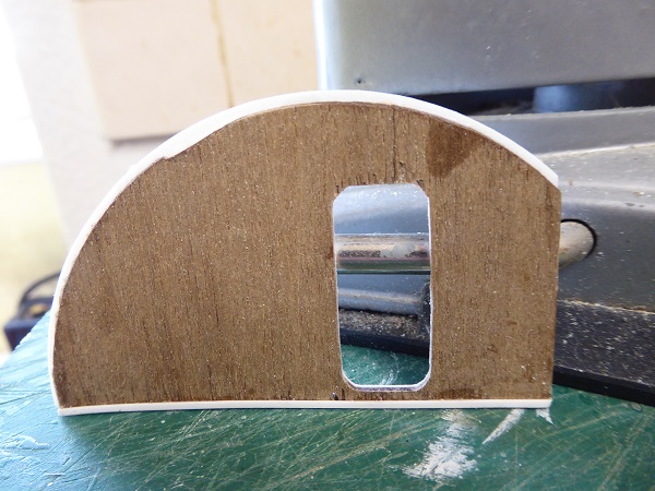

The Junior Rates Mess is fitted out in wood, so rather than try and paint plastic to look like wood, which has mixed results, just fit the real thing instead!BigGrin So i ordered a strip of walnut veneer, 1.0mm thick, 100mm wide and 1 meter long. The dividing bulkhead between the Galley and Junior Rates Mess, is wood covered on the accommodation side.
After quite a long time spent cutting and shaping the veneer, i glued it with PVA to the acetal template i had made, the one with the off-centre door way. As soon as the PVA soaked into the walnut, the veneer started to twist and warp!Blink
Plenty of bulldog clips were used and also clamping the acetal/walnut sandwich in a vice. I managed to straighten the piece, apart from a couple of small waves, which i bent out by hand. A couple of hairline cracks formed in the walnut as i relieved the stress in it, but these aren't noticeable and the whole thing is pretty flat now. Next time i'll use superglue, as this sets the veneer hard in seconds, as it soaks in and prevents warping!BigGrin

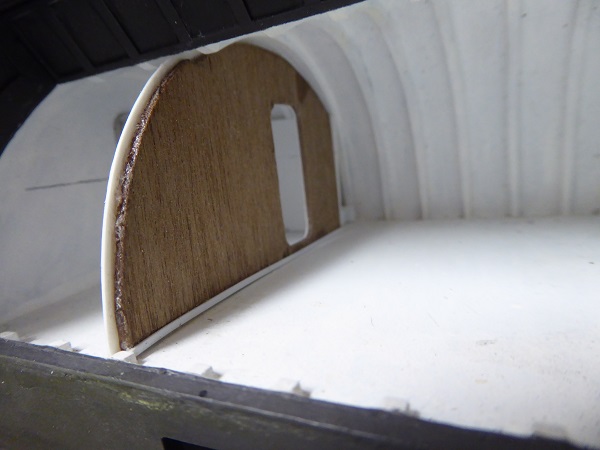

#500 Posted : 30 April 2021 16:33:06
Test fit of dividing bulkhead.
