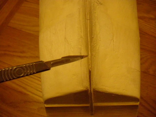

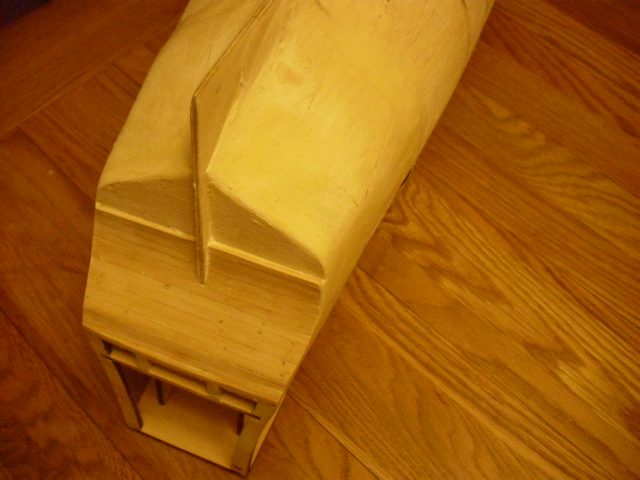

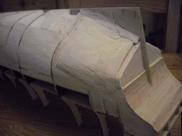

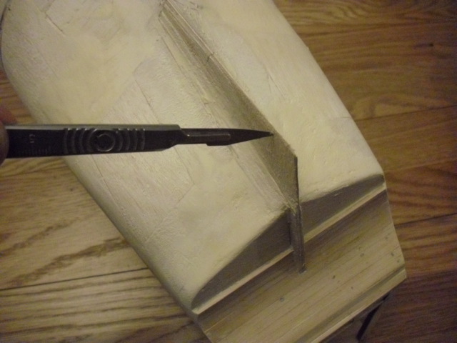

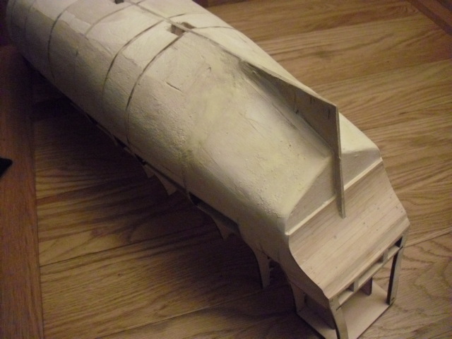

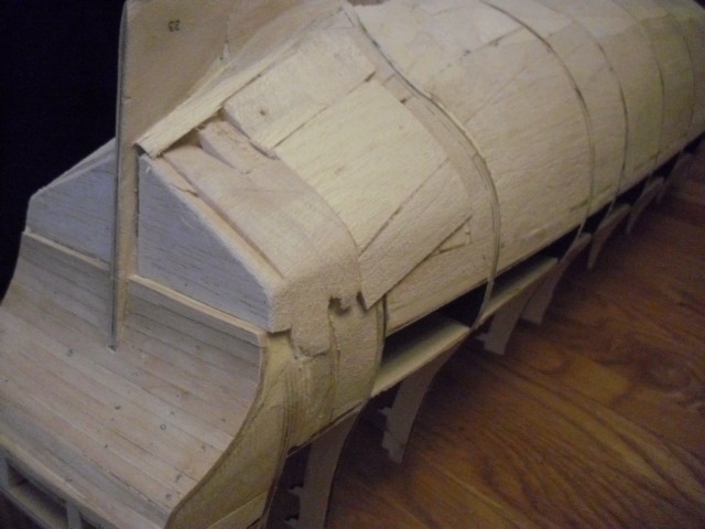

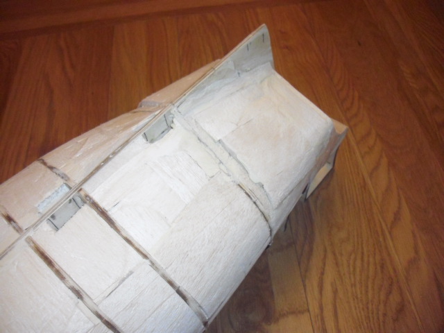

THE HULL STERN MODIFICATION
Well Team, I have finished the modification, having fitted the to piecs of wood last time, I now fill in the space with more balsa the photos tell the story:-

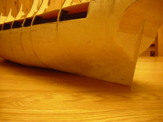

#469 Posted: : 21 January 2013 21:13:56

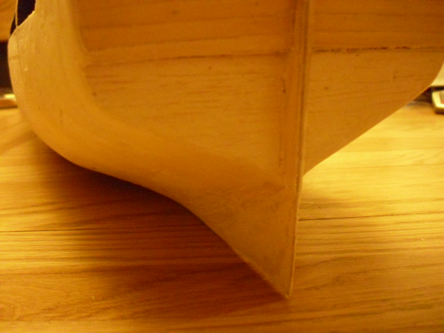

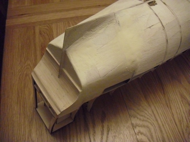

The next job was to get a really smooth finish, I did this by sanding and filling, sanding and filling untill I had the required shape and finish I was looking for, :-
#470 Posted: : 21 January 2013 21:21:17

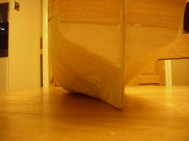

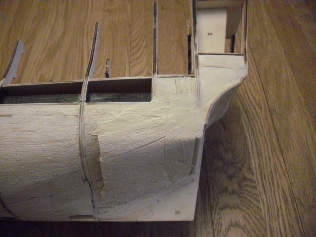

The last thing to do was to thin down the Keel to 1mm as this is essential to fit the planks to the correct thickness at the stern (I was very surprised this very important job was not covered in the instructions):-

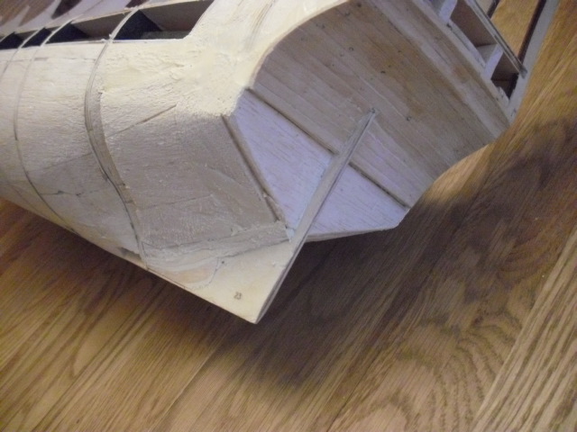

And here is how she looks now, thank you for looking in, Questions ans comments are welcomeBigGrin
Next time I will cover how to postion and fit the planks on this now modified stern Kind regards Mike
#472 Posted : 21 January 2013 21:49:55
Beautiful piece of work Mike, can now see what you were getting at..... thanks for sharing....

That looks so much better Mike,definitely a mod I think I will do when my time comes.
