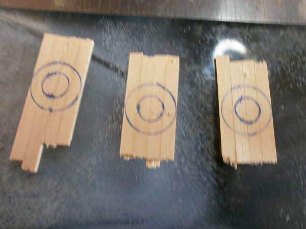

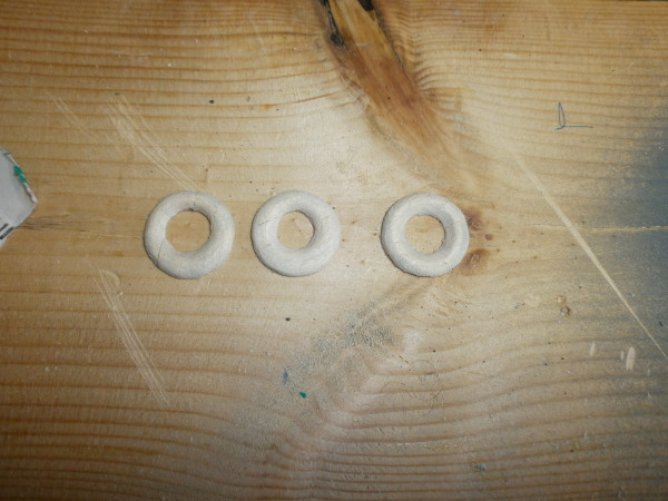

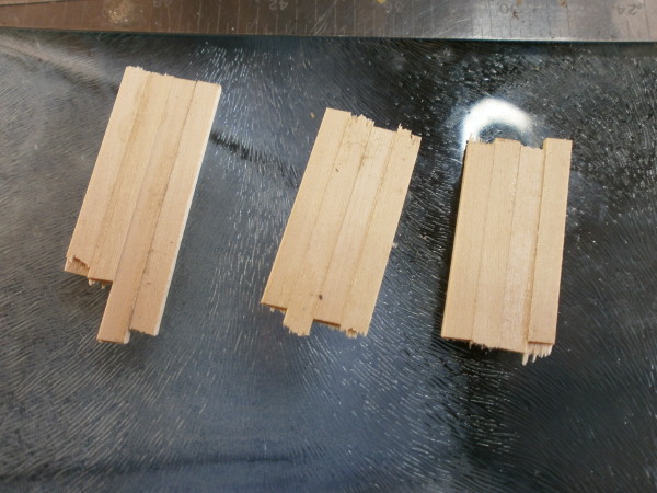

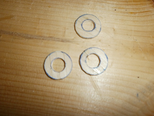

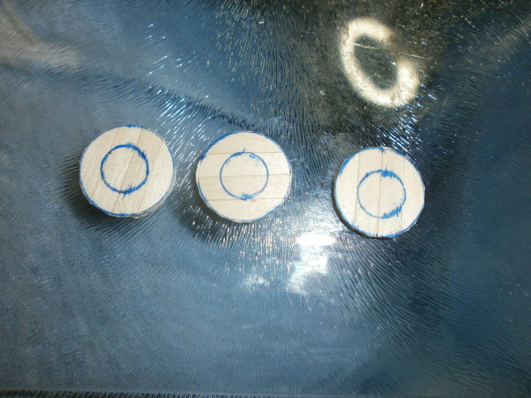

On both the Yamato and Akagi models wire is bent around a piece of dowel to get the rings needed for them but I never liked this method as they just look wrong and made my own out of left over strake strip or you can use sheet to make them up.
This is my method to make them , firstly laminate the strips together then when dry cut into the size needed to make the Hawsers, after marking the inner and outer rings they are ready to be cut out. After they are cut out they will require some carving/whitling to a rough shape then sanding down .The last pic shows the hawsers ready for sealing and painting but the stern one will need some soaking and shaping to fit properly. Hope this is of help

Andy just out of interest what are the dimensions of your scratch built rings?
#469 Posted : 01 September 2013 00:48:23
High calibre work again Andy, can see you always know how to get the best out of a bad situation..... Very nice indeed.... Cool Cool
#470 Posted : 01 September 2013 01:51:31
BigGrin Hi Jase
As you probably know the Akagi was built in the 1930's from a converted battleship hull after an international naval treaty agreament and as such would have had the overlarge fittings of the period so i started at 18mm max width but after carving this is slightly smaller. In the raw before painting they look massive but after painting blend in quite well. Hope this helps
