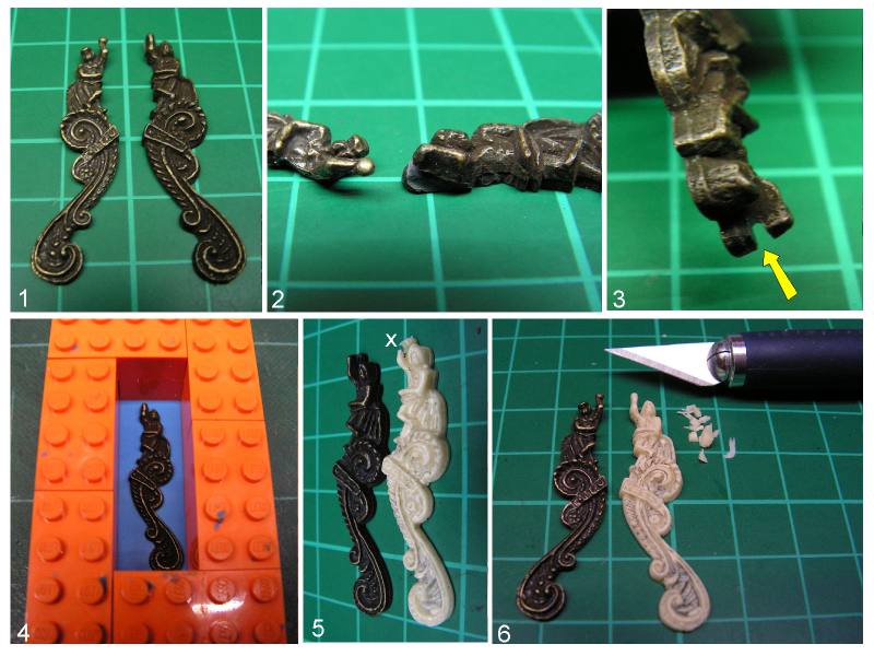

Well, she’s back! The last posting for this poor old girl was seventeen months ago, and the last time I worked on her was even longer than that, first the Messines diorama, then the Scramble, then Frederick in his armour and finally the Pups – all of them meant I’d very little time and even less working space to get on with my DelPrado Victory. Until now though, a partial re-working of my attic workroom with some extra work top space means I can now rotate the Victory in and out of the work area which she is now sharing with the Chindit bust scratch build. I should really be continuing on with the chainwales but first I wanted to try and do some alterations to the figure head for reasons shown below.
Photo 1 shows the two cast side sections of the DelPrado kit figure head (I’ve already done the central coat of arms section shown earlier in the diary). The part on the left which is the starboard section isn’t too bad but the opposite port piece (although you can’t tell in this shot) is awful!Crying Photos 2 and 3 illustrates the problem – the upraised arm supposedly holding the coat of arms on the starboard cherub is ok, the port one however is mounted on a slab of extra metal with the upraised arm attached to it (his arm therefore is about three feet wide!) As you can see in Photo 3, I’d begun to try and file the extra metal away (started before the last post in fact and shown by the yellow arrow) but although this casting metal is brittle at times, it’s as tough as hell when you’re trying to file it down, even with powered diamond dust grinders! Anyhow, after all the newly learnt resin casting skills acquired with the Pups I thought – why not make a mould of this ‘orrible thing and cast it in resin. Then I could cut away the excess parts far easier than in metal. The titchy little mould is shown in Photo 4, the metal casting is simply pushed onto the soft plasticene base and a basic wall of lego pushed down around it. A couple teaspoons of silicone rubber later and I had an open ended mould to pour a little resin into. The first result was as shown in Photo 5, almost a perfect casting except for a single air bubble – marked by the ‘x’ and right on the very arm I was trying to create!Cursing Typical! On the second attempt I moved the resin around in the arm space with a cocktail stick and the result is shown in Photo 6 along with the paper/card modelling knife and the resin waste, which was carved away to create the ‘proper’ shaped arm.
Unfortunately for Victory this isn’t the end of the re-construction work. When I glued on the decorative mouldings onto her curved beakhead (again, metal castings) I didn’t glue the outer one right out to the edge of the beakhead as there are holes that needed to go in there for part of the bowsprit rigging. As a result, there isn’t enough space for the figurehead side panels to fit flush against the wood. To be honest, looking at the area at the bow, even if I had fitted the moulding further forward I still don’t think the side panels will fit in there. Consequently I am currently planning out an additional section of wood to move the coat of arms forward allowing the cherubs to fit in behind it. I did think about snapping off the mouldings (a la Gibbo) but I’ve already built in the anchor rope re-enforcement timbers to fit the existing shape of the moulding (plus I haven’t got Gibbo’s guts!)Blushing So in the next instalment, re-shaping that beakhead and hopefully completing the figurehead!
Until then, Happy (Re)Modelling to you All!

#444 Posted : 14 January 2018 18:04:23
BigGrin wonderful job on the upgrades Robin Cool Looking forward to seeing your next instalment ThumpUp
Martyn
#445 Posted : 14 January 2018 22:38:09
Very neat Robin.
I really do like how you cast these resin replacements.
#446 Posted : 14 January 2018 23:46:36
Great to see you back working on this one Robin, look forward to seeing her progress.... All looking good....Cool Cool
Gibbo

Great to see you back on the "ol girl" Robin and a lovely job on the casting, i'll have to check mine tomorrow now to make sure i haven't got the same problem, if anybody can make this work it's you mate, looking forward to seeing how it all works out.

Great to see you back on her Robin. Look forward to seeing your progress.
Ian BigGrin

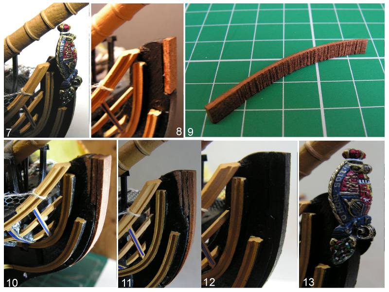

In the end I decided to go the whole hog NO! I didn't rip everything off!Blink I went and cast the other 'better' cherub as well to even everything up. In this installment, before painting up the castings and fitting them in I've had to re-model the top of the beakhead to allow enough space for the resins to fit....
Photo 7 illustrates the position of the coat of arms centre piece of the figurehead before the problems were found. Note the forward decorative curved strip, it terminates right under the scroll-work of the coat of arms. The side pieces with the cherubs is supposed to fit between the centre piece and the upper most curved beam (with the netting attached) – well it won’t!Blink
Without ripping all the bow decoration off (faint) the other solution is to move the centre piece forward creating more space for the cherubs. The first task therefore was to fill in the cut out on the top of the beakhead where the coat of arms fitted onto. The metal centre piece came off very easily (which didn’t bode well for other parts super glued on!) I then cut a section of the thick sapele wood planking which came with my old Constructo Grimsby kit and glued that into the space as shown in Photo 8. Then, with another length of that same plank (you can see how thick that stuff was) I cut a section to run from the top of the beakhead about halfway down to the waterline. This was given the necessary curve with my Amati plank nipper as shown in Photo 9. This tool is years old now, bought to build the Grimsby with decades ago. Back then it came with just the blade in the jaws, not with a selection AND a brass bending gizmo too! Once there was a slight curve, I then sanded the plank down on the outer face, reducing the thickness to a razor edge at the bottom and then re-nipped the plank over and over again until the curvature matched the profile of the bow. The formed plank was then glued to the beakhead with Gorilla wood glue (I didn’t want that piece going anywhere!) This is shown in Photo 10. I then carefully sanded down the sides of the add-ons until they were flush with the existing wood and re-sanded the front edge to fair the join together (Photo 11). When satisfied with the finish the new wood was painted with Admiralty Dull Black to match the old as in Photo 12 and once dry the centre piece was super glued back in position. If you compare Photo 13 with Photo 7, you can see how the coat of arms has now moved forward with the bottom scroll now further to the bow, allowing the side pieces to fit in place.
In the next installment, once I’ve bought some more gold acrylic to replace the Citadel Shining Gold which I’ve just discovered has dried out on me, the cherubs and scrolls can get painted up and fitted in place.
Robin.

Nicely done Robin, i had to do something similar to mine,how are getting on with the mast plans ?
#451 Posted : 20 January 2018 00:18:59
Very nice work as usual Robin, looks fab....Cool Cool .. I like using the plank nipper for putting curves on wood, especially hard wood. As long as you can't see the inside of the piece then its an ideal tool....Cool Cool

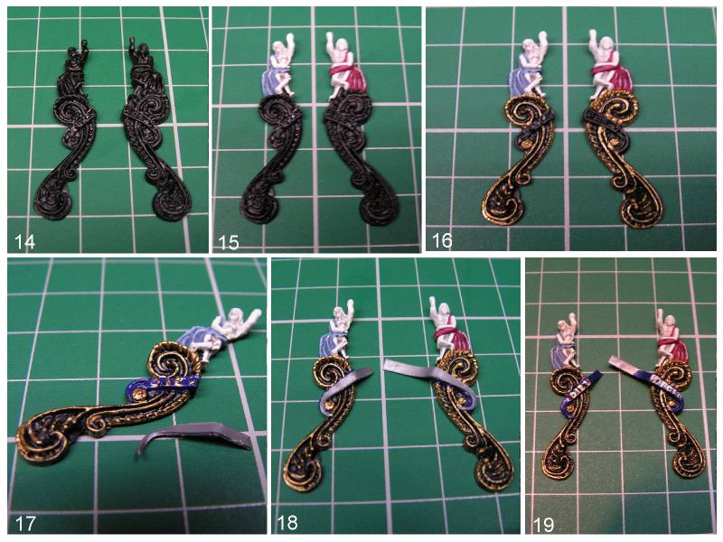

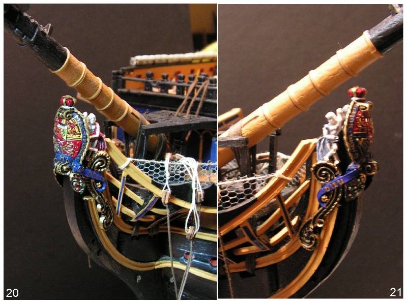

Many thanks to Paul and Alan! My first resin upgrade has gone pretty well overall - crew figures a definite possibility now!BigGrin
As you can see from Photo 14, in the end I decided to go the whole hog and replaced both of the cast metal side pieces with resin copies, in this photo they have been sprayed with Poundland Matt Black Car Primer as an undercoat. The painting then followed in the sequence shown here – Photo 15: The Cherubs were painted white with Revell Aqua Colour (Color) White Matt with the blue robe painted with Vallejo 70.943 Grey Blue and the red robe in Vallejo 70.926 Red. Both robes were then highlighted with a dry brushing of the base colour mixed with a drop of white and once dry the robes and the cherubs were given a thinned down wash of Citadel Shadow Black Ink. Next the golden decoration on the scrolls and swirls was picked out in Revell Aqua Colour Gold Metallic, (Photo 16). The next task was to try and paint the blue motto ribbon “DIEU ET MON DROIT”, (God is My Right). This was of course in three parts – DIEU on the starboard side, DROIT on the port and the ET MON already painted on the coat of arms centre piece. Now the ET MON was moulded fairly well under the coat of arms and I’d managed to paint that to an acceptable standard, but try as I might, the two side sections just weren’t moulded cleanly enough on the metal originals which meant the resin copies couldn’t be any better either (as you can see in Photo 17). What I should have done was to fill in the moulded letters to a flat face before casting the part but I didn’t realise how bad the letters were until it was time to paint them! The easiest solution now was to replace the curled ribbons with a small section of the DecraLed strip, cut to shape with the tail curved around a suitable round spindle (one of my steel disc cutters I bought to cut out small holes in the paper Pups build). The first one is shown in Photo 17 whilst both of them are shown super glued in position in Photo 18. Once glued in place they were painted with Admiralty French Blue and once that was dry, DIEU and DROIT was duly painted on with the Revell Gold as illustrated in Photo 19. Finally, I could get the two side pieces glued into place on Victory’s bow. The Blue Cherub fitted on nice and easy but for some reason Red was a much tighter fit, in fact in the end I was forced to gently twist the top and bottom of the Cherub and scroll in opposite directions to get a slight rotation in the figurehead to allow it to fit in. Once they were in place, the excess lead strip on the ribbon was carefully trimmed off and the lead glued to the centre piece. Photos 20 and 21 illustrates the completed three section figurehead. Overall I’m quite pleased with the finished article, especially the lead ribbon replacement, much better than the original over thick part and also, if I’d tried to grind down the kit part to the right thickness, I still wouldn’t have been able to fit the red one in properly – the metal version wouldn’t have been able to twist into position!Cool
Now I suppose I’ll have to get back to those flipping chainwales!Blink
Robin.

A great job Robin, they look fantastic mate.
Paul
#454 Posted : 31 January 2018 12:47:10
Awesome painting skills! Looking fantastic!
#455 Posted : 31 January 2018 14:39:26
Great job on the painting, the figures and crest look superb.

#457 Posted : 15 February 2018 14:11:15
Hi Robin,
Congratulations on you paint job, especially the Figurehead. WOW!!!

Stunning! A build of the highest level.
AUTO FRUMP STOMPER
#459 Posted : 29 May 2018 13:21:41
Cool Fantastic job on the figure head.BigGrin
#460 Posted : 29 May 2018 13:23:02
