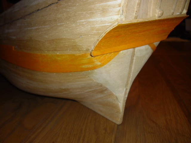

THE HULL STERN MODIFICATION
2) THE VICTORY
The planking also sweeps up to meet the stern crossplanking:-

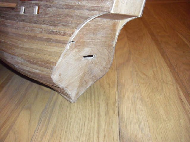

The final ship is the
3) SAN FRANCISCO 2
This is a ship that predates the SOTS, THE VICTORY and THE ENDEAVOUR, but it does not have a shallow stern hull, and you can see the side arch shape, which is shown on the poster of the SOTS, which I want to recreat

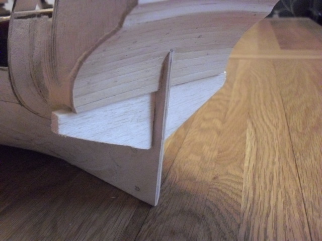

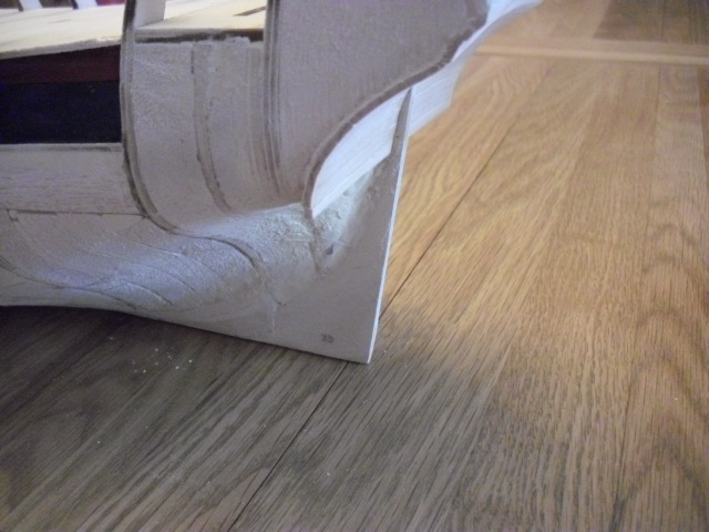

THE MODIFICATION OF THE HULL STERN
Hi Team the first thing I did was take measurements from my other models and came up with a size which I thought was acceptable.
The balance of the keel had to be my priority, I prepared 2 pieces of Balsa wood (6mm thick)in a triangle shape 6cm x 4cm x 1cm,and fitted them 3mm back from the stern cross section planking. These are the Photos of this Stage, more to come later Kind regards Mike

Hi Mike,
Look's good,nice work you can see the difference you got me thinking about mine.
kind regards Trev.

I agree, that looks better already. I've been troubled by that lower stern profile, plus the sweep that the planks would have to take, for some time. Your modification looks like it could well be the answer. Looking forward to moreThumpUp
