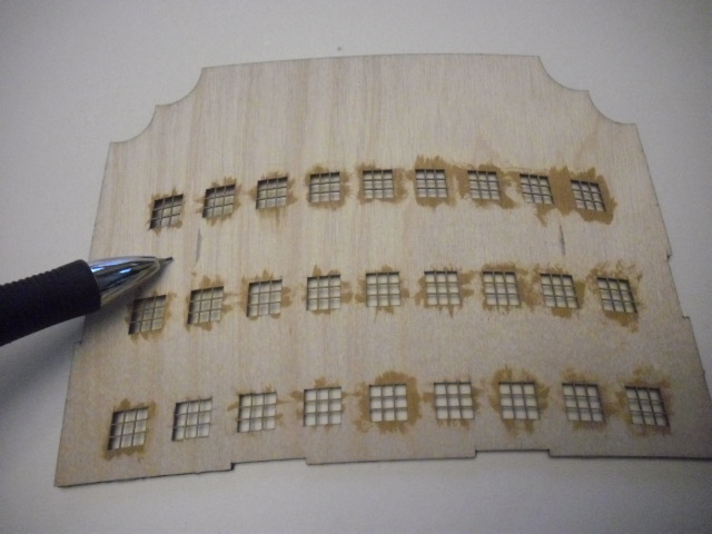

Hi Team, the painting is now finished. This session will cover the fixing together of the front ply and the rear ply in all cases ( rear Gallery and 2 side Galleries)and then to achieve the correct curvature on the three parts.
It is important during this process to take your time, "test and try" the parts as we go, this is not a race and we are not working to any time scale above all enjoy the build as I amBigGrin

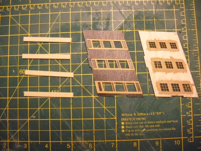

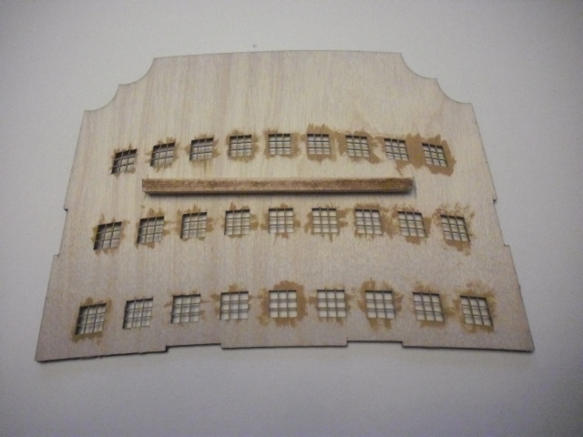

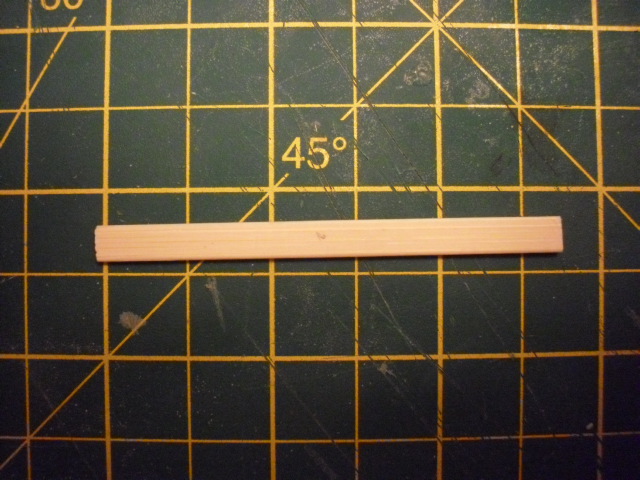

POINT 1)
Prepare 8x lengths of 5 x 2 timber (this will be used to protect the paint work on the front ply parts ) cut them just short of the width of the side Galleries:-

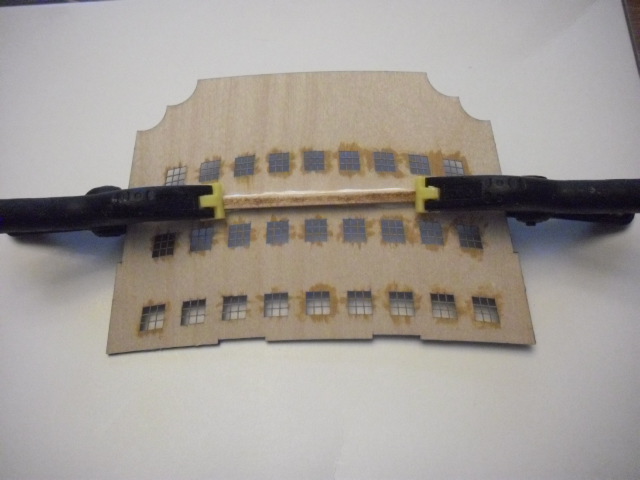

#443 Posted : 12 December 2012 11:34:17

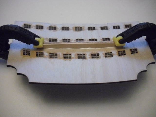

FITTING THE GALLERY ENHANCEMENT
POINT 2)

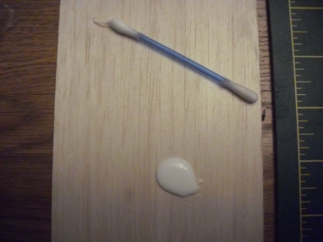

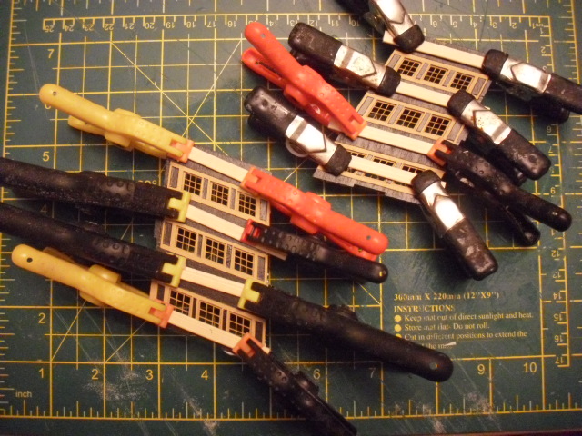

"IT IS ESSENTIAL YOU GLUE THE 2 HALVES OF THE PLY TOGETHER ON A FLAT SURFACE," (and not curved on the ship) this is to ensure the windows aline spot on.
POINT 3)
I have used PVA adhesive (wood Glue) and not Super glue, I find PVA works better for me.
Place a quantity of adhesive on some scrap wood and apply an even layer onto the part keeping the adhesive away from the windows.(I used a cotton bud for this purpose )
Then clamp the parts together as per the photos:-

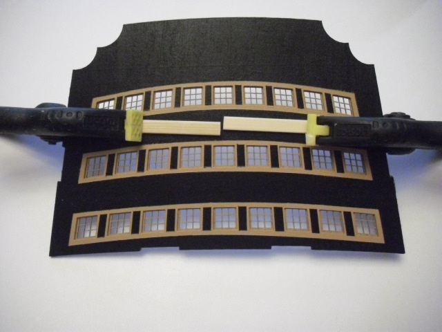

and now do the same to the rear Gallery parts:-

Please leave the parts to cure for 24 hours (we want a secure fix) and when you remove the clamps your parts should look like this:-

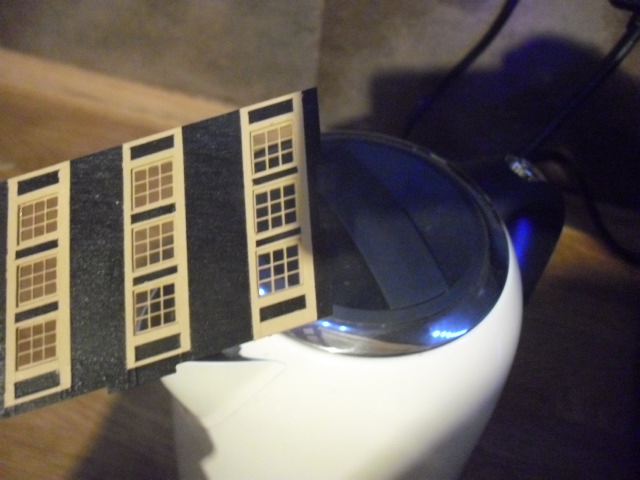

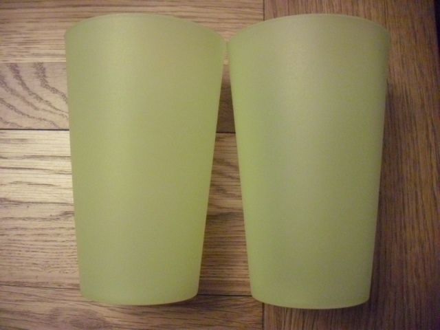

CURVING THE PARTS
POINT 6)
This is the most `tricky` part of the process, you really do need to be patiente all the way through TAKE YOUR TIME and "try and test"
I have never used plank benders ( some people get great results with these ) I prefer to use methods I have used from way back when, either steam, hot water or heat from a candle, and then a natural drying process, you will notice all the way through my builds I do not use any fancy tools.

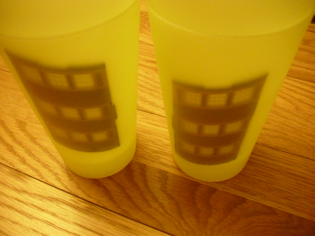

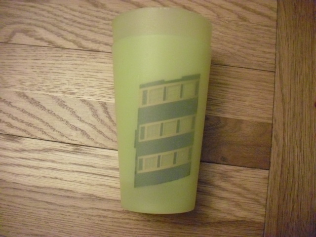

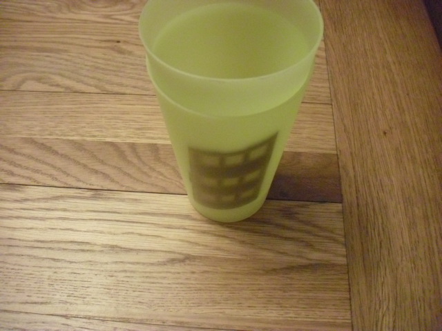

POINT 7)
Take 2 plastic cups or beakers
Then using the spout of a boiling kettle run the side gallery part through the steam,painted side up( mind your fingers) you can use a pair of tweezers.
Do this between 6 to 10 times (duration each time the kettle boils) when the part is moist and plyable, place it between the 2 cups (one inside the other) in the position shown in the photo:-

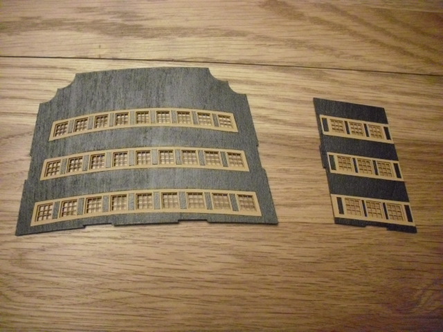

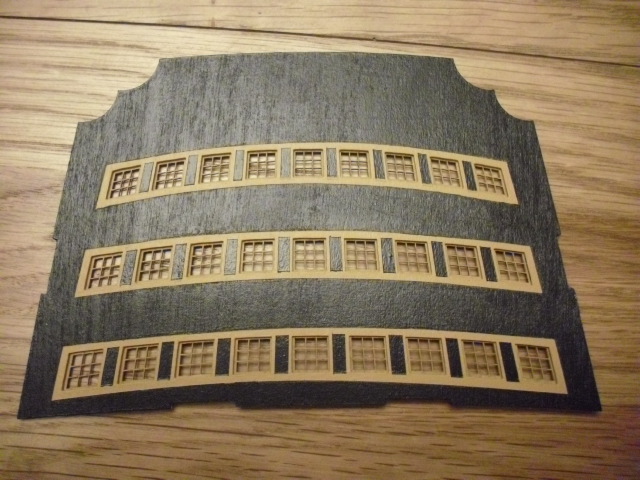

#447 Posted : 12 December 2012 12:07:33
CURVING THE PARTS

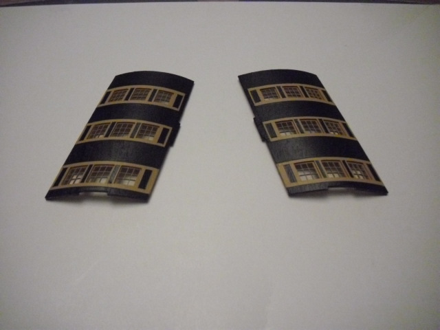

POINT 8)

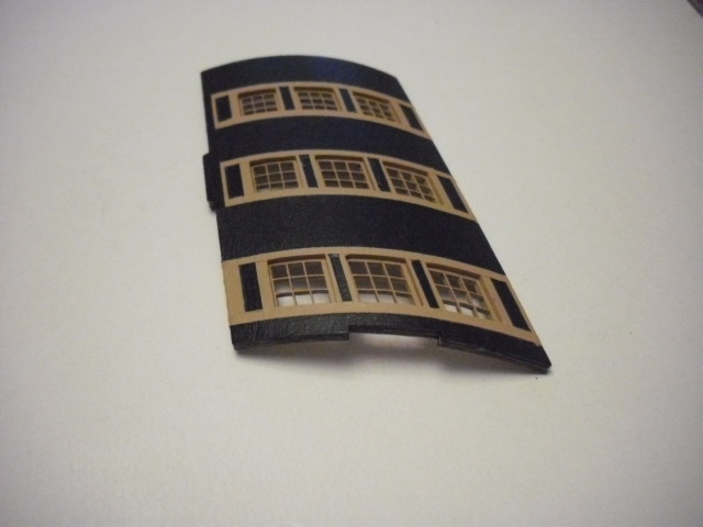

Ok Team leave the parts in the cups for two days to dry out thoroughly.
When you take them out they should look like this:- (PLEASE NOTE no cracking of the paint or splitting of the wood, if you use Admiralty paints you will be fine)

Thats all for this session Team, questions and comments are welcomeBigGrin I will leave you with how the parts look at this stage Happy building
Kind regards Mike
