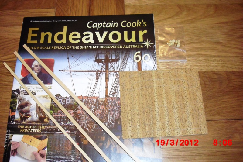

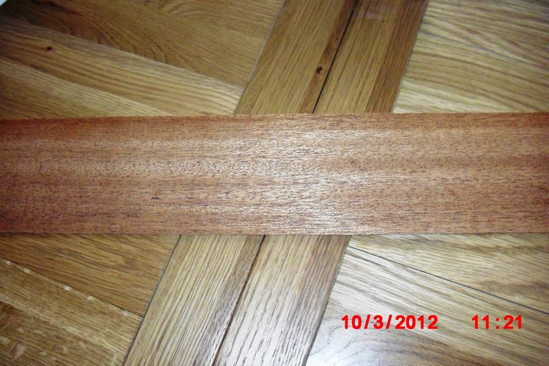

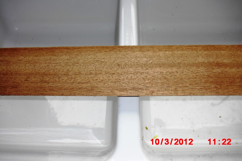

Hi Team,
I have purchased a lovely piece of Mahogany 1 metre long 2mm thick, I will be using this instead of the tacky ply to make the companion ways and covers on deckBigGrin Regards Mike

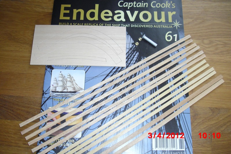

ISSUE 61
This week we received the following parts:-
An oven flu
Pulley wheels
Bow gunwale (three pieces)
300x5x1mm ayous strips x6
300x6x1mm ayous strips x2
300x5x2mm ayous strips x4
Mike

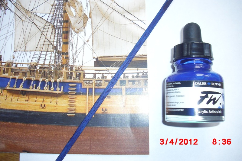

HULL COLOURS
As you all know from my previous posts I have been looking at a different medium to colour the second planking than paint and I chose ink,Ink in my opinion shows the grain much better than paint, I published the Orangy yellow colour some weeks ago, now I have found the blue for the planks below the gunwales.It is Rowney Acrylic Rowney Blue
For the Wales and anchor linings I will use black ink.
I may use ink for all the deck fittings, but I have not made up my mind yet.BigGrin comments and Questions welcome. Regards Mike

cheers mwg, will head to town for this colour of ink, it certainly gives a better finish than the paint option.

Thanks for your comment Alan, when you see the ink on the ayous wood the effect is outstandingBigGrin Regards Mike

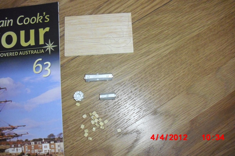

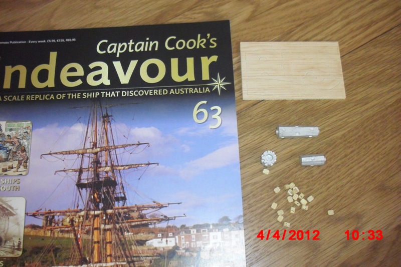

ISSUE 63
Hi Team this week we received Windlass gear (metal) Windlass large winch (metal) Windlass small winch (metal) these parts are better quality.
Also received Pulley blocks(4mm) Rigging blocks (4mm) and the Windlass, (six pieces in wood).
I will now be starting the second plankingBigGrin Comments welcome.
Regards MikeBigGrin

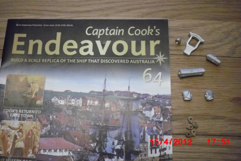

ISSUE 64
This week we received the following this week:-
The small Windlass winch cast alloy
The large Windlass winch cast alloy
The ships Bell brass
The Belfry cast alloy
The Windlass Figures and dead eye blocks (7mm)
Regards MikeBigGrin

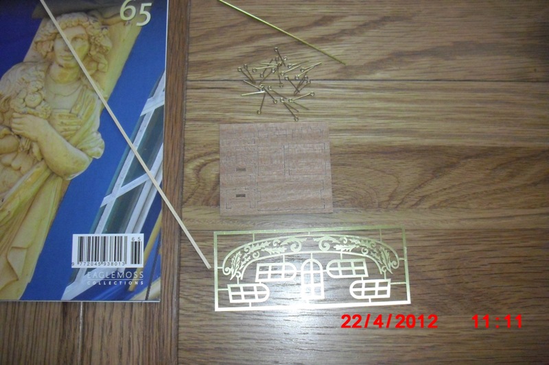

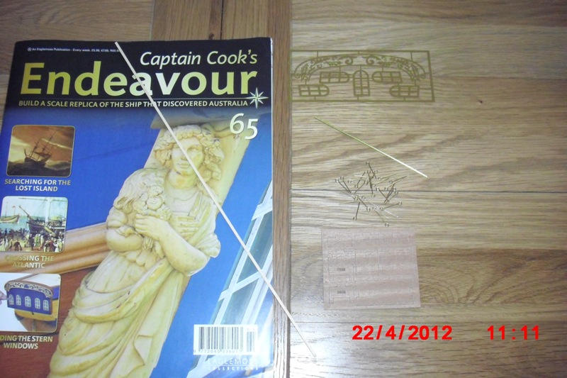

#450 Posted : 24 April 2012 14:51:07
ISSUE 65
Last week we received the following:-
Taffarel leaf decorations and stern windows.
Eyebolts
300x2x2mm ayous wood strip
Brass wire (1.5mm diameter)
Tiller bridge and hatch cap (nine pieces
Regards MikeBigGrin

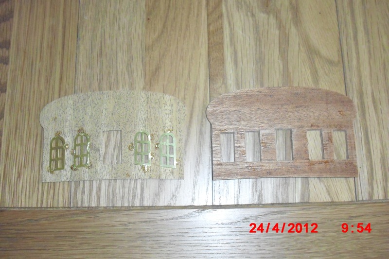

#451 Posted : 24 April 2012 15:03:41

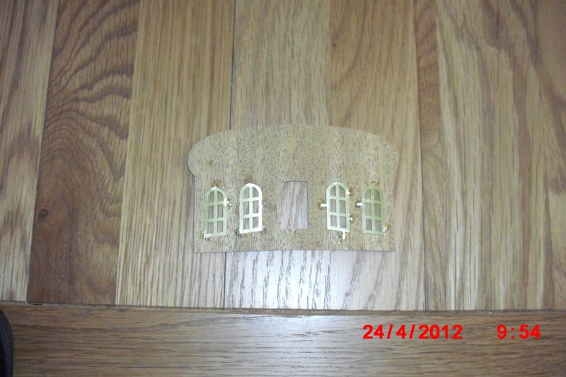

STERN MODIFICATION

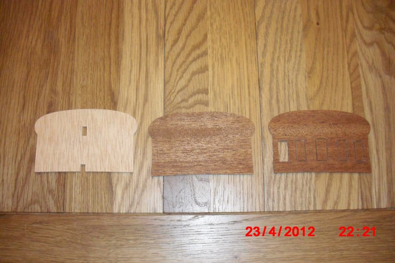

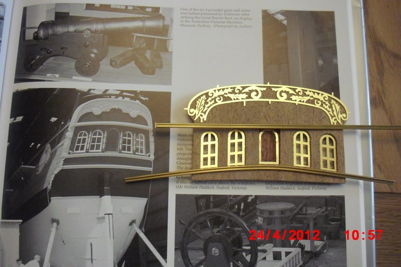

Hi Team I decided to change a few things with the stearn of the ship, as you know I have the Anatomy of the ship Endeavour, the vessal did not have 5 windows at the rear, only 4 windows,and the centre was covered by woodwork as it covered the Rudder Tunnel and was a sham.

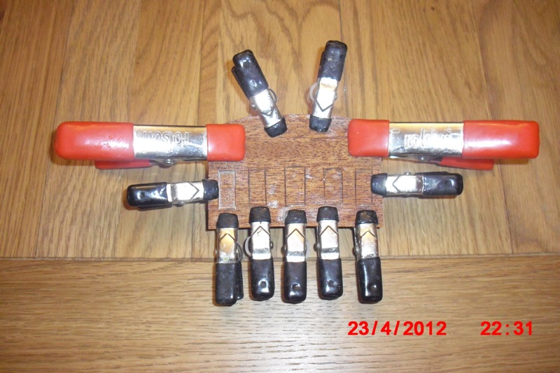

First up I made two new stern pieces from my Mahogany I had purchased and cut holes through the wood so that the windows when fitted would have depth:-
#452 Posted : 24 April 2012 15:10:59
STERN MODIFICATION

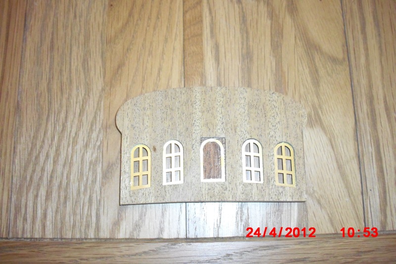

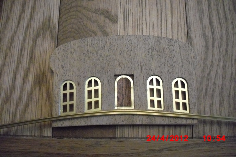

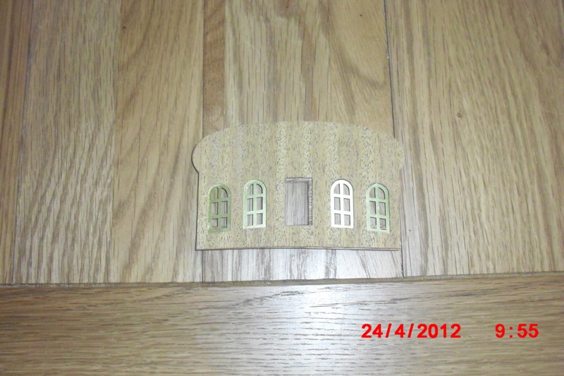

Next I retained the stern front plate and fitted the windows at the rear of this plate (It is a good idea to retain the brass lugs on the window frame for fixing on the plate, otherwise they may fall through):-

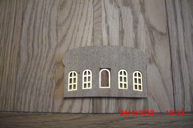

So now the windows from the front have depth.
Next we prepare the centre sham, I cut a piece of Mahogany and fixed it into the rear, and taking the centre window I cut out all the spars and fitted the remaining window frame in the centre:-

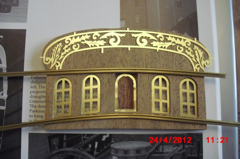

I had some brass beading and I decided to use this instead of wood battons,I think it looks better and more authentic:-

#456 Posted : 24 April 2012 15:28:18

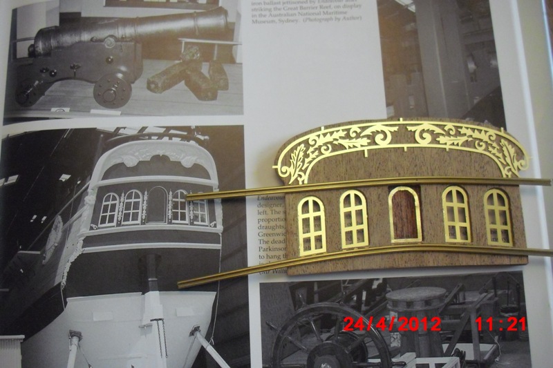

STERN MODIFICATION
Well Team here is the finished result,I do not know if I will use blue on the stern or just varnish it. The beading has to be trimmed and permanently fixed. also I will fit acetate behind the windows maybe yellow Thanks for looking Questions and comments welcomeBigGrin Regards Mike

#457 Posted : 24 April 2012 15:39:36
Excellant little tip that about keeping the lugs on. Good call.Love

alantait
#459 Posted : 24 April 2012 18:31:07
Joined: 17/03/2010
Posts: 301
Points: 941
Location: fife
Hi Mike, i think that this looks alot better, just what i was thinking about doing, as for the acetate i think that might work depending upon how transparent it is with no real interior.
no doubt i will find out when i finally get to doing this myself
