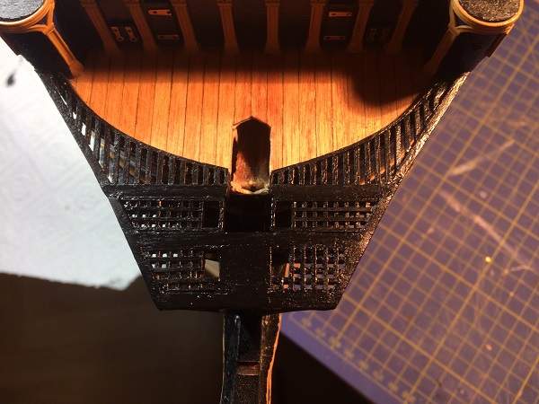

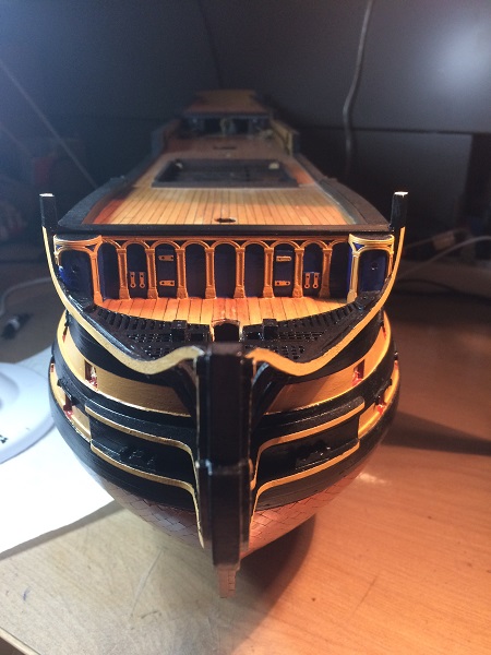

Thanks for your nice comments, guys!
I`ve been on a vacation last week so i couldn`t post an update.
So here`s my recent progress.

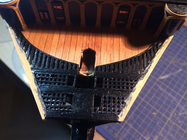

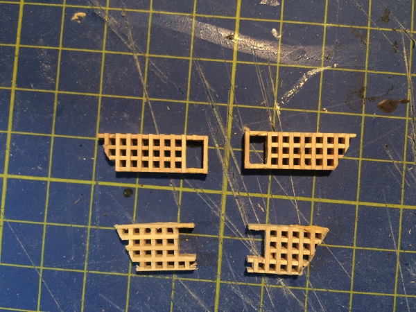

I completed the gratings of the beakhead - wanted to achieve a flat platform.
As there was some angle between the beakhead-frames i corrected that for the beakhead main rail to be able to run in the right straight angle.
Built the forward stools.

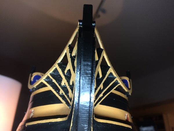

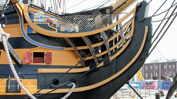

My next project was the completion of the bow rails.
What i wanted to achieve was the look as on the real ship, where the rails run "through" the beakhead frames.
#437 Posted : 15 September 2017 07:26:26

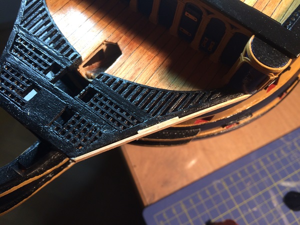

1.first step was to remove the lateral parts of the beakhead Frames - with that removing the preformed Slots - and being able to Position the rails in the right place. This i had done previously.
2. I attached the rails to the frames in the correct position.
#438 Posted : 15 September 2017 07:31:00

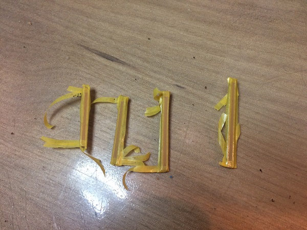

3. I prepared some 3x1mm wood strips. I tried to do the painting before attaching them - but somehow failed with the masking and it looked ugly.
4. I attached the strips over the rails - connecting the stem with the main rail.
5. The gaps between the strips and the frames were filled with wood filler, sanded and painted.

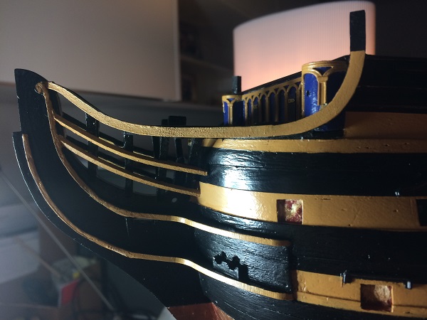

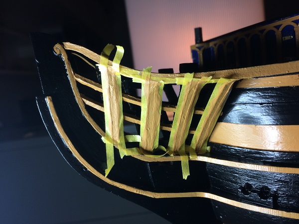

#439 Posted : 15 September 2017 07:35:17

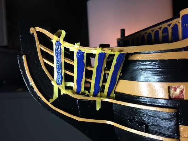

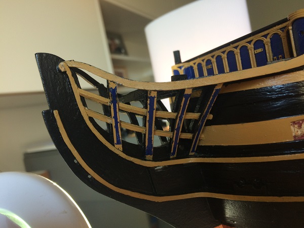

Finally i had to redo the blue fields.
This time - after masking - i applied a layer of yellow to seal the tape ( which was the step i forgot the first attempt - causing the blue paint to run under the tape).
Then applied the blue colour.
This time i was satisfied with the result ( still have to do the starboard side).
I think i could achieve the look i had in mind with the rails running through the frames.
#440 Posted : 15 September 2017 07:47:25
