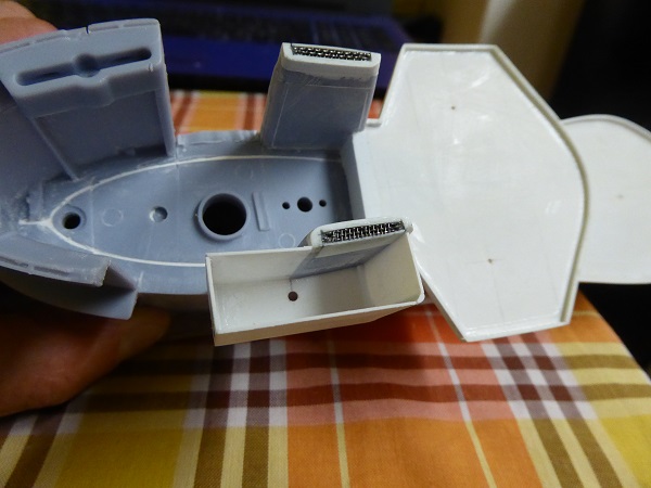

From another angle.
#422 Posted : 01 November 2018 23:25:22

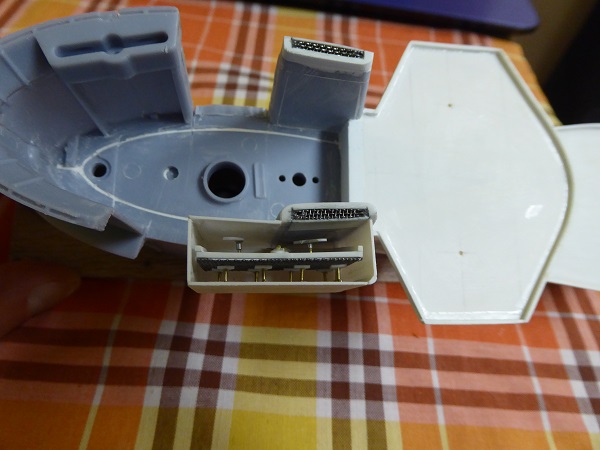

From this point on i proceeded to build up the box section that houses the radar antennae. As before, plenty of measuring to ensure all aligned and when completed, the addition of 1.0mm square strip, fitted internally to support the corners.
#423 Posted : 01 November 2018 23:25:59
Another very nice update, seriously impressive work you are doing on this build.

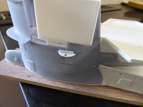

#424 Posted : 01 November 2018 23:27:18
From above.
#425 Posted : 01 November 2018 23:30:50
Thank you very much Graeme!Cool BigGrin The conning tower is a model in it's own right and i hope to have it completed in the new year [Jan].

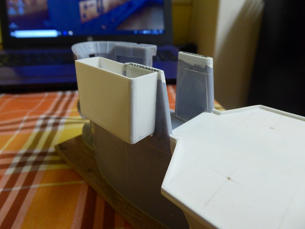

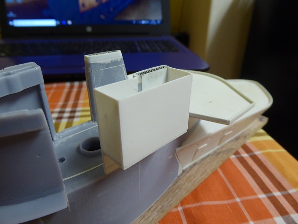

#426 Posted : 01 November 2018 23:32:26
From another angle.
#427 Posted : 01 November 2018 23:33:38

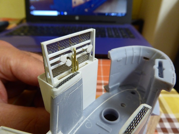

Radar antennae being checked for fit and alignment.
#428 Posted : 01 November 2018 23:36:11
Further checking of alignment. On the real U-boats this mast was raised and rotated manually by the radar operator in the Control Room, via leadscrew and handwheel.

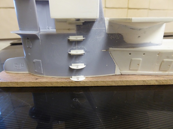

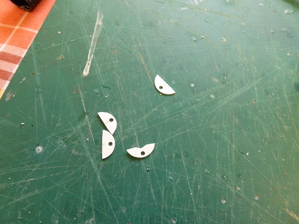

In this weeks update i scratch built the radar mast housing and started on the starboard armoured box.
The attached photo shows semi-circular profiles made from 0.5mm thick plastic sheet that will form the curved shape of the radar mast housing. The holes are 2.0mm diameter to locate the brass rod of the radar mast and keep it square and perpendicular.

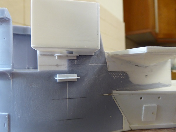

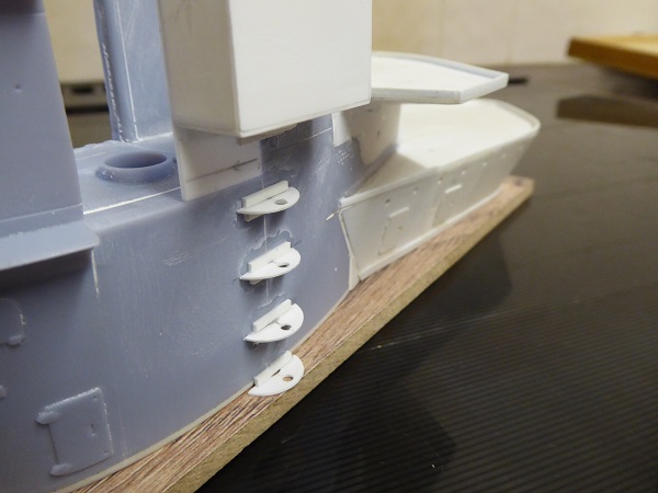

#435 Posted : 09 November 2018 08:58:43
The attached photo shows one of these semi-circular profiles fixed in place and strengthened either side by short lengths of 1.0mm square, plastic strip.
#436 Posted : 09 November 2018 08:59:29
From another angle showing two of the profiles in place.

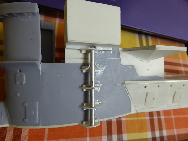

#437 Posted : 09 November 2018 09:00:42
All of the profiles fitted and the holes aligned whilst fitting using 2.0mm diameter brass rod.
#438 Posted : 09 November 2018 09:01:26
From another angle.
#439 Posted : 09 November 2018 09:04:15
I then inserted the brass rod of the radar mast through the holes and at the same time cut lengths of aluminium tube that slid over the rod and acted as supports for the profiled pieces.
The second profile piece [from top down], split, but fortunately it split in such a way that it still supports the aluminium tube.Blushing Blink

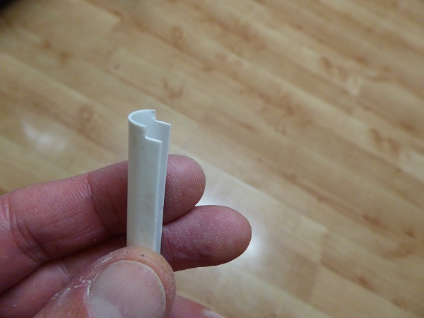

Now that everything was fitted and fully supported i fabricated the actual housing from 0.5mm thick plastic sheet. After cutting to size, then bending it around a marker pen and holding in place with bulldog clips, i left it in a mug of boiling water for 5mins for the plastic to form a natural curve. The attached photo shows the housing prior to fitting.
