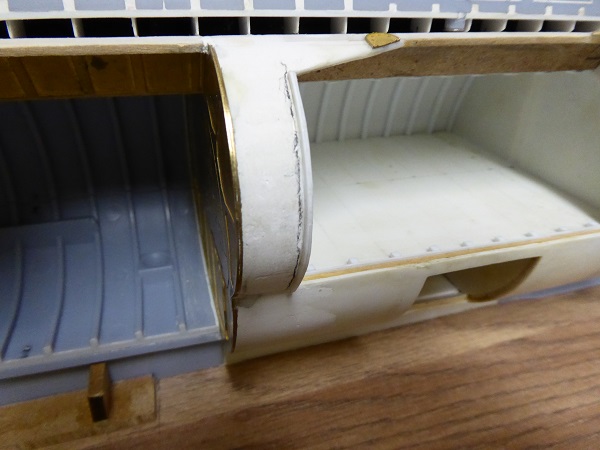

#422 Posted : 30 March 2017 19:04:24
This final photo shows a close up of the scalloped piece.

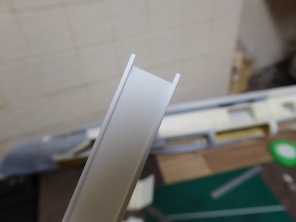

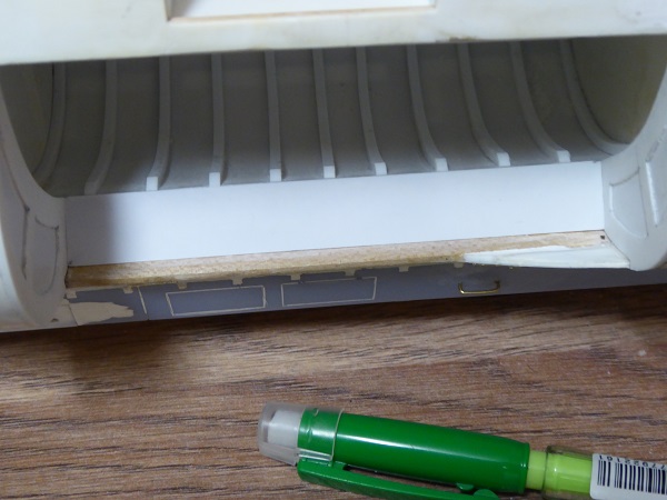

This part of my U230 u-boat log i'm building the 'panelling' that sits above the Junior Rate Mess & Galley representing the cut-away section of the top of the saddle tank. I wanted to continue this theme as there is part-works supplied photo-etched brass panelling for the Control Room and Engine Room saddle tank cut-aways.
I made the panelling from plastic sheet and strip.
The attached photo shows the base of the panelling cut to size. I used 0.25mm thick plastic sheet.
#431 Posted : 05 April 2017 07:05:41
This photo shows the base of the panelling being checked for fit.

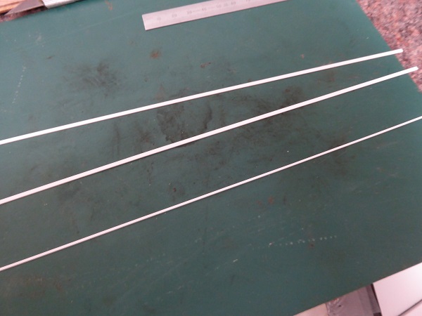

#432 Posted : 05 April 2017 07:08:18
This image shows the various sizes of plastic strip I used to make up the panels; 1.0mm [wide] x 0.5mm [thick] and 2.0mm [wide] x 0.5mm [thick].

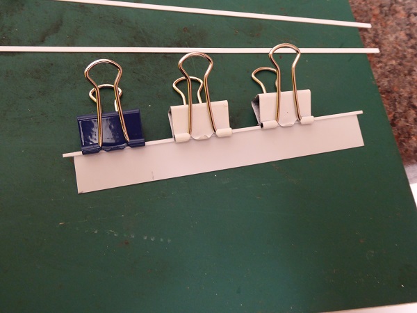

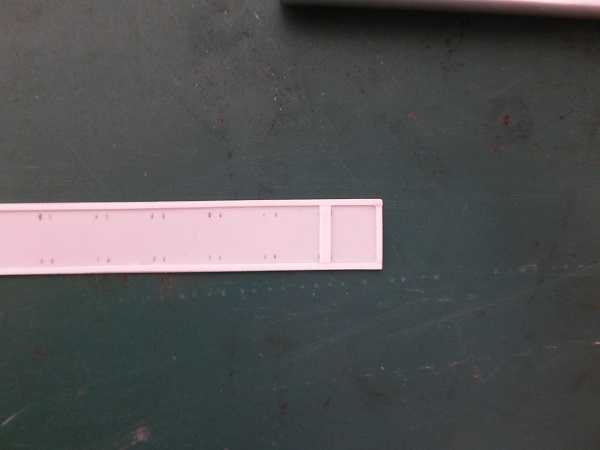

#433 Posted : 05 April 2017 07:11:38
This photo shows the making of the panelling border using 1.0mm x 0.5mm strip. I used bulldog clips to hold it in the correct position while I ran a bead of superglue along it's edge.
#434 Posted : 05 April 2017 07:14:48
I left the strip over-length to be cut to size after gluing. This photo shows the second border fixed in place using the same method as before.

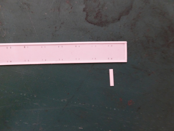

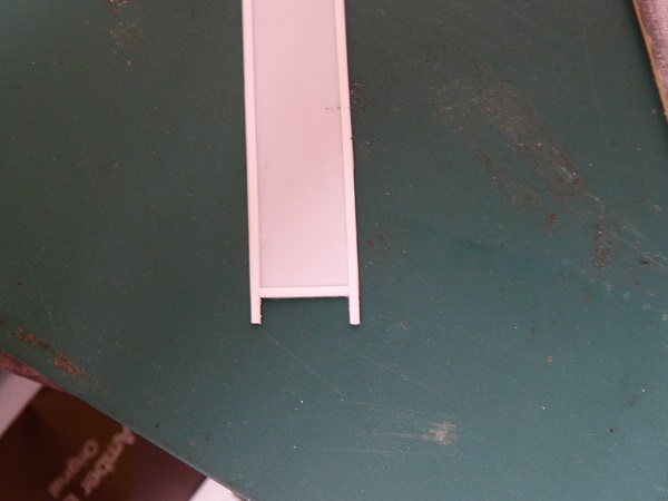

#435 Posted : 05 April 2017 07:16:40
In this photo the first rung of the panelling has been cut to size from 2.0mm x 0.5mm plastic strip.
#436 Posted : 05 April 2017 07:18:00
This photo shows the rung glued in place.

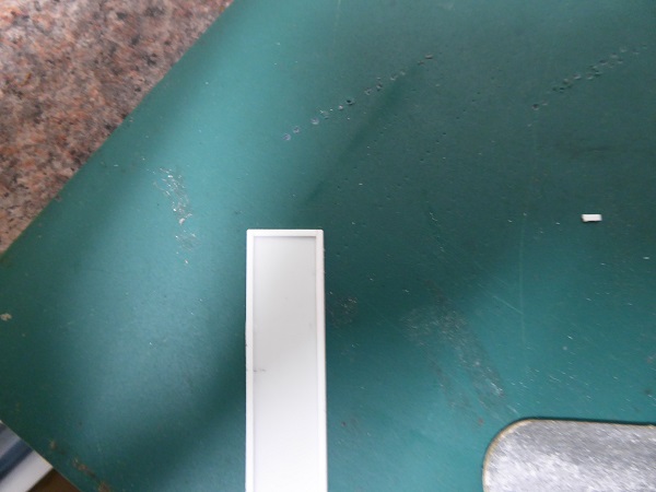

#437 Posted : 05 April 2017 07:19:49
This image shows the border strip filed flush.

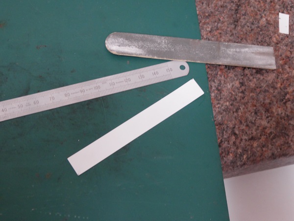

#438 Posted : 05 April 2017 07:23:41
This image shows the second rung cut to size. You can just make out the 8.5mm gaps marked out in pencil for each rung.

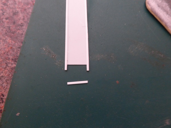

#439 Posted : 05 April 2017 07:24:35
The second rung fixed in place.

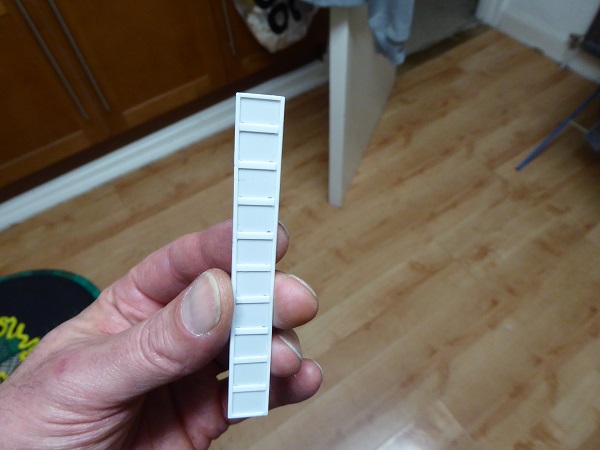

#440 Posted : 05 April 2017 07:25:40
This photo shows the completed panelling with all rungs glued in place.
