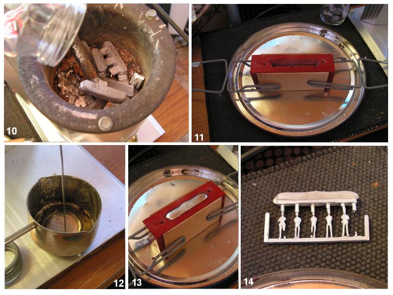

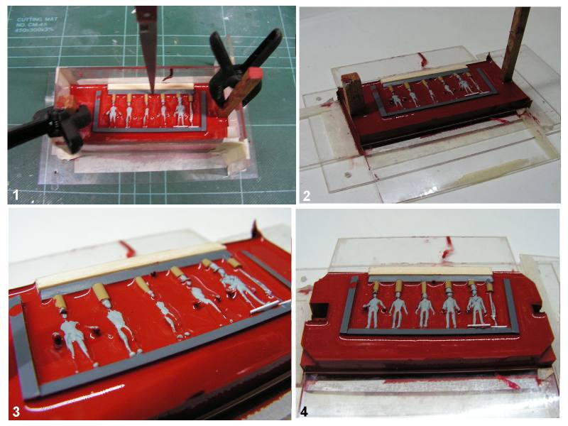

In the last crew instalment we finished up with the five initial figures glued to a long base composed of a length of model kit sprue (MkIV Battle Tank probably!) The first task after that was to take another three sections of that same sprue to produce the casting frame. Unlike my previous figure casting experiments I was turning this one literally on its head and gravity flowing the molten metal down through the figures rather than up through the base/legs. This entailed adding a series of round sprue pieces from the top of the head to the upper sprue and also adding two end uprights before finally gluing the plastic frame to a section of square wooden strip. You can see these parts in the various mould photos but most clearly at the end in the final comparison group photo.
Once the frame was complete I made up the pre-constructed Perspex mould box, all the four sides being held together and to the base with cheapo masking tape. In Photo 1 the first 100ml (or 100gm) of silicon moulding rubber has been mixed in with the seventy five drops of catalyst (should really be eighty drops but I found that five less gives me enough time to get everything in place before the rubber begins to cure – much longer in fact!) After pouring in the rubber, the figures on their frame were carefully lowered in by long nosed tweezers with the wooden block sliding down the face of the Perspex into the rubber solution. As the frame began to sink into the rubber the wood block was gripped tight against the far side using spring grip tweezers. Also visible here are the pair of plastic grips which are holding a further two sections of square wood strip in place against the end walls. You’ll see why in a moment!
Photo 2 was taken about 48 hours later after the rubber block had fully cured. The four sides of the box have been carefully folded flat after the corner bits of masking tape were removed. This is a fairly delicate operation with the Perspex sides being literally ‘peeled’ away from the grip of the cured rubber. The two end wood strips are still in position here.
As you can see in Photo 3, the liquid rubber has flowed over parts of the figures before curing. The excess rubber now needs to be trimmed back in order to provide a true ‘half mould’ before the second half can be added on top. This was done with the corner of a nice sharp safety razor blade and at the same time the corners were cut back to produce a ‘shelf’ in each one. This can be seen in Photo 4 along with the reason the wooden strips were also set in the rubber at the beginning! In this photo they have been removed to leave two rectangular spaces, one at each end of the block. When the second half of the mould is poured on top, it will flow into these two holes along with the corner shelves to make locating pegs, which will keep the two halves together in the right alignment during the casting. Without these pegs or lugs, the two halves could move out of position causing a misshaped casting. At this time, the ‘meniscus’ or raised lip around the edges of the block were trimmed away with a pair of sharp scissors. There was no actual need to do that, but it just looks neater!
The shot in Photo 5 looks almost identical, but if you look closely at the rubber block you can just make out a ‘greasy’ looking film over it. This is the mould release agent or “Silikonformen-Trenncreme" as the label describes it (guess where that is made!) Called a silicone separating paste in the GB part of the label, it is in fact a form of high grade Vaseline by the texture of it. This was applied with a cotton bud to leave a thin skin over the rubber face of the block, not forgetting the locating lug holes of course. The effect of the skin is to prevent the two halves of the rubber mould from bonding to each other. During one of the mould making sessions on Messines I forgot to add this on and only remembered it whilst watching the second half curing away! Fortunately, I did get the two halves apart with the help of a sharp craft knife! I think I might need to start making tick off box check lists!Blushing
There was no photo of the second half of the mould in the box, I was tempted but all you can see is a rust red rectangular block in a Perspex box! So in Photo 6 we have the two cured halves of the mould with the original plastic and wood former removed and in between the blocks. There is one final task to perform on the mould before the first casting attempt, which is shown in Photo 7. The dusty appearance of the casting face is caused by applying a thin coat of a special talcum powder which is designed to improve the flowing of the molten white metal into and through the mould. In the very early days of home casting the Prince August instructions said just to use common or garden talcum for this process but nowadays there is a special product just for the purpose (and much more expensive of course!)Blink

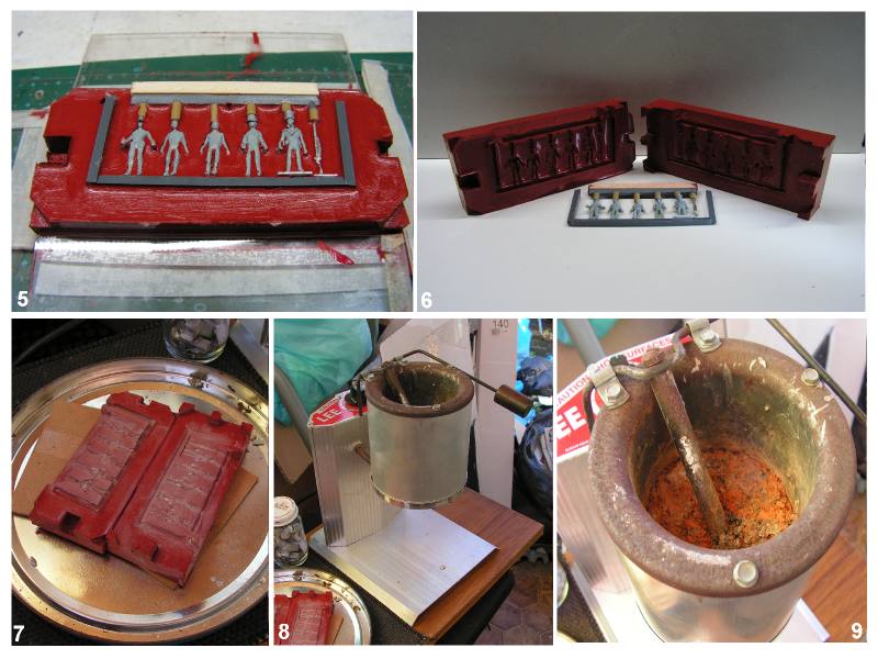

In Photo 8 you can finally see something that I left out of all the preceeding instalments on white metal casting – the Lee Melting Pot. This is the middle of the range version, which I bought from Hobby’s some years ago. It cost about £70 back then but is now over the £100 mark! I looked on the Hobby’s website a couple of days ago to find that out but they now have a smaller one on sale for about the same price I paid for this one. It’s no smaller in diameter though, if you imagine this one cut in half through the middle, that’s the smaller version! To be honest, I’ve hardly ever had mine anywhere near half full so the smaller one would be just as good and cheaper to run too! The actual heating element is built into the bottom of the pot and strangely there is no on-off switch, plug it in to the mains and its on! Just visible on the top of the metal box behind the pot is a black thermostat knob to control the temperature of the melted metal whilst the handle sticking out forwards with the thicker grip is the release to let the molten metal flow out of the ‘tap’ underneath the pot at the front. Lifting the handle simply raises the solid steel plug to allow the metal out.
Photo 9 illustrates what the inside of the melting pot looks like once it has cooled down after a few castings. The orange looking surface is composed of a powdery waste, which from the colour is something to do with the oxidisation that takes place during the heating process. This can be loosened with a penknife blade and shaken out. I found out recently that once the pot heats up, this ‘slag’ is another inch or so deep and can be carefully ‘shovelled out’ with an old teaspoon which is worth doing to remove as much of the contaminated waste as possible. Eventually, after dozens of castings the metal needs to be topped up with a new fresh supply. I think I’m getting near that time myself now so I’ll be saving up my pennies for another three bars from Hobby’s soon! Until then however we continue recycling as much as possible and in Photo 10 the last spares from the collection of re-useables is seen going back into the melting pot (literally in this case!) The ‘stepped’ blocks seen here are the runners from the Messines MkIV tank track Spuds.
In Photo 11, the mould is ready for the first pouring attempt. The two halves are held together by a couple of Prince August spring clips with two sections of hardboard placed in between the clips and the rubber to even out the gripping pressure, without those plates the mould could be squashed out of shape. The mould itself is resting on an upturned biscuit tin lid, any drips can be swept off back into the pot once solidified. Photo 12 is one I was quite pleased to get, my camera is right hand only and I had to operate that with my right hand and lift the pouring handle with my left so everything was a.. I mean back to front!Blushing The photo shows the molten white metal streaming out of the melting pot tap and into the Prince August ladle. Whilst a better quality of metal would flow into the mould if it came direct from the tap, it is simply not accurate enough to aim the stream into the narrow pouring trough. If a tiny bit of slag gets in the way the stream can shoot off at any angle so the metal is transferred from the ladle to the mould just as soon as there is enough in it.
The first pouring attempt is shown in Photo 13. As soon as I took this shot, I already knew that the casting would not be perfect. If you look at the rapidly cooling slab of white metal you can see that the ends are rounded as are the long side edges too. This indicates that the metal cooled down too quickly, this is often the case, especially on the first pouring, which is going into a cold block of rubber.
As you can see in Photo 14, the suspicion was right! The metal had flowed down through most of the mould but a couple had missing parts to their legs and none had any arms at all. The final large photo illustrates the results of the first three casts. As you can see, as the mould itself was warming up with each pouring, the metal was penetrating further and further into the recesses of the mould. This is especially noticeable on the musket casting on the right, from almost nothing, the second and third pourings each went further up the stock whilst the figures were beginning to get at least parts of their arms coming out. This was as far as I got on this occasion, white metal casting, to me at least, is still more of an art than a science and the relationship between the temperature of the metal and the mould and the actual condition of the metal mixture is critical to success.
I have since cut some small channels from the ends of the arms to the base bar with a little more success but it’s still those arms, which are proving the most difficult. Commercial white metal castings have the huge advantage of being cast in a centrifugal mould which forces the liquid metal down those pesky small bits whilst I’m relying on good old fashioned gravity. I’m toying with the idea now of maybe making a small mould with just a variety of separate arms, and design the next group of figures as armlessCrying . Anyhow, I’ve now added a couple of plastic arms onto one of the Marine figures just to try it out and I’ll get him painted up for the next instalment.

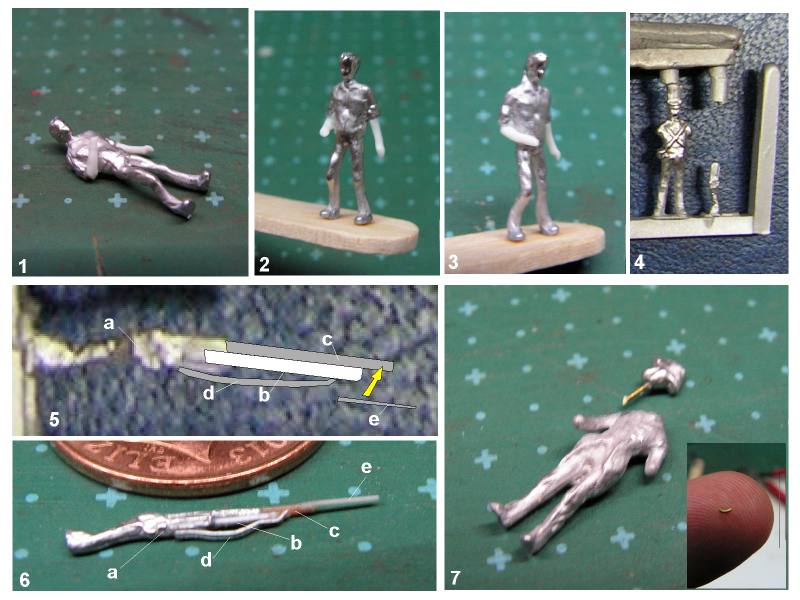

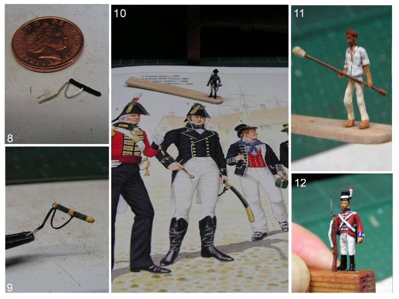

In Photo 1 you can see the first of the seamen figures laying on his back. As I’m still experimenting with this, I decided to make the first figure a casualty, if he didn’t turn out too well and looked a little odd – well he’s wounded dammit!BigGrin I bent the legs slightly to allow him to lie flatter and glued on two pared down plastic arms (this was the shirt sleeved one of the two seamen) putting them across his chest as though he was clutching at his wound. However, once I’d done all that I found he looked just as good standing up so this chap became an Able Seaman again (rather than a disabled one!)Flapper Photos 2 and 3 show him back on his feet and temporarily super glued to half a lollipop stick (actually a Poundland Plant Marker which is still actually a lollipop stick!)
Moving on to the Marine figure, the one I used isn’t the one shown in Photo 4. I used this shot to illustrate the musket, not the Marine! The figure I used had slightly better arms, or at least the right arm which was just over half formed. I cut off the remnant of the left arm at the shoulder and attached an entire plastic replacement, as you’ll see later. The right arm however I sliced off at the elbow at such an angle that I could add a half a plastic arm also at an angle to allow him to grip his musket. In cutting the Marine’s hat away from the moulding sprue and then filing the hat back to shape, the cockade was lost so this was replaced with a microscopic sliver cut from stretched plastic sprue. I’ll probably end up doing that for all the Marines in due course.Crying
In Photo 5 you can see how the Musket was rebuilt from the partial casting. In the upper diagram the white metal part (a) was filed down under the barrel so that a plasticard new stock (b) could be super glued into place. Once that was dry, a tiny length of stretched sprue was glued on to make up the missing barrel section (c). This was followed by a very thin strip of Mum’s eye ointment tube, (still got some left over from Messines before a load of it goes into Scramble!) to fabricate a new musket sling (d). Finally, an even thinner piece of sprue was attached to the right side of the barrel to produce the socket bayonet (e). All that was then required was to gently file down the original white metal barrel slightly to meet the plastic extension. The slight ‘hump’ where the two parts met made it look like a Nelsonian Marine with an Assault Rifle! Blink The final composite musket is seen under the famous Penny in Photo 6. Hopefully, as my metal casting technique gets better I won’t need to do this for all the Muskets – God I hope so!!Crying
In Photo 7, we come back to the very first figure I constructed, Lt Furstman. As you can see here, he didn’t do quite so bad in the arms department. He has all but the hand on his right and down to the elbow on his left. He also received a half plastic arm together with a severed right hand. During the attempt to file away the sprue from his Bicorne hat his head unfortunately err, fell off! In fact this was quite handy as I was intending to try and bend his head to one side anyway to improve the pose so I simply drilled both his head from below and the stump of his neck down into the body to glue in a thin bit of brass rod as you can see here (it was only half that length when I fitted it in though). Also seen, balanced on my fore finger tip is another bit of brass wire which became the hand guard of his sword (well, it saved having to paint it!)
Photo 8, another Penny shot, shows the test fitting of Furstman’s sword scabbard straps to the plasticard scabbard. In this picture the ointment tube strip has been bent into shape so that it meets up with the middle of the black painted scabbard where the brass fitting will be painted on later and the tip, which will also be brass painted. The actual sword is comprised of the brass wire hand guard which was just glued directly to the hand with a tiny piece of plasticard for the cross guard and then the curved blade, again plasticard, was glued to that, resting on the Lieutenant’s shoulder. Once the fit was good, the strap was painted in Admiralty Black and once dry, the excess was gripped in the spring tweezers, a drop of rapid super glue applied to the end and the ‘U’ before the scabbard was held in normal tweezers and offered up to the strap, a few seconds and it was glued in place. (Photo 9) After trimming the excess strap away, a drop of the same glue was applied to his left hand and the entire scabbard assembly was ‘handed over’ to the Lieutenant. (Sorry!)Blushing
In Photo 10 we have the completed figure stuck on his temporary base posed over the top of the inspiration for the figure itself. When DelPrado brought out their 54mm? Scale set of Napoleon at War collectables, I bought a few of the first ones including the Marine which came with this nice little booklet by Osprey Publishing. It’s only 15 pages long but has some lovely paintings of various “Nelson’s Navy: Sailors and Ships”. The Boatswain’s Mate, which I haven’t built up from the casts yet also came from here.
Photos 11 and 12 show the Seaman and Marine in isolation. All the figures were painted with Admiralty Flesh, White, Dull Black, and Walnut Wood, with Citadel Regal Blue for the Lieutenant’s uniform, Boltgun Metal and Mithril Silver with Black, Blue and Flesh Citadel Ink washes. The Seaman’s trousers were a mix of white and a touch of Yellow Ochre.

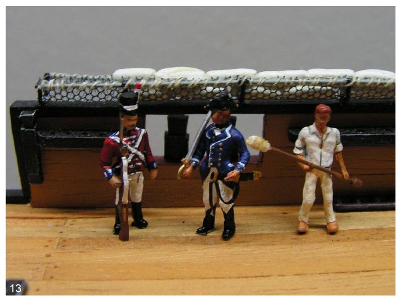

The final Photo 13 illustrates all three of the figures posed together on Victory’s Quarterdeck. The Marine, holding his musket will stand up anywhere but the other two are resting against the hull behind as they haven’t found their ‘sea-legs’ yet! Eventually all three will be stationed in the waist area and as I improve, those with the best poses will be placed on the top decks. As I mentioned, I’m quite pleased with the way these have turned out, it’s not quite the mass production method I hope to achieve later, but if I have to get a couple more packs of railway figures to lop off their arms – well, I can live with that!BigGrin

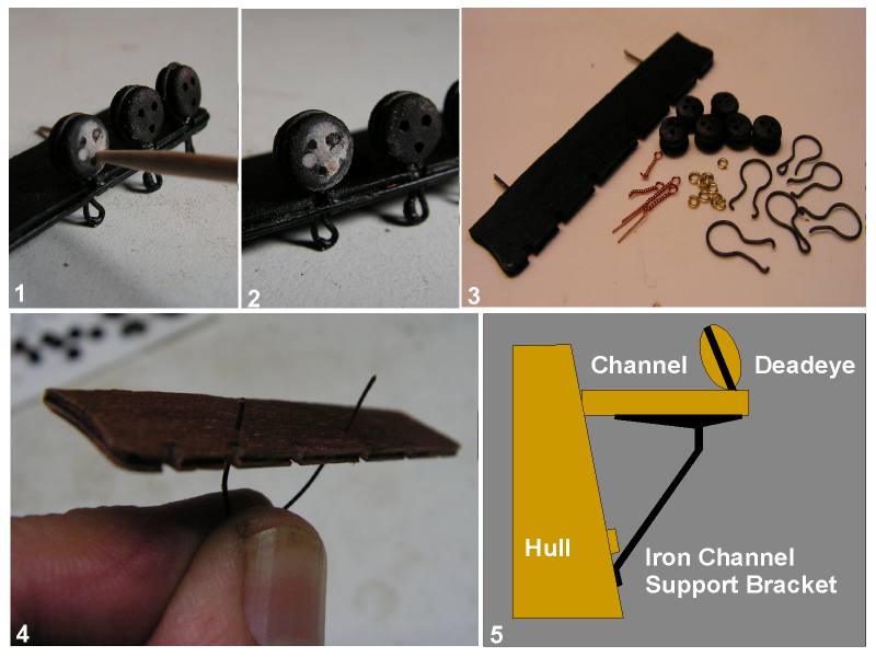

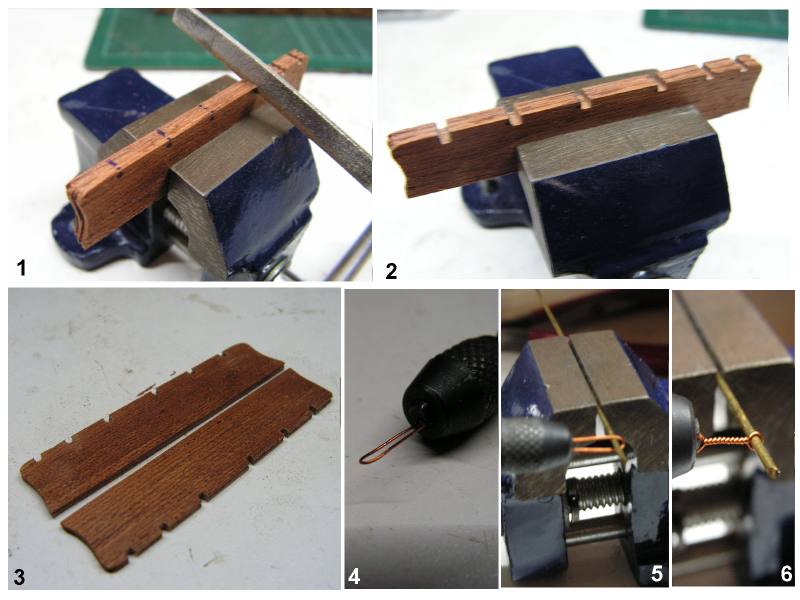

Anyway, here's the update on the Victory with the first part of the Mizzen Chainwales or Channels.
Using both the McKay and McGowan books for reference, the dimensions of the Mizzen Chainwales were worked out for 1/100 scale and came to 60mm by 12mm, which, for once did actually correspond exactly with the DelPrado parts supplied on the channel plywood fret! Two lengths of this size were then cut from the 1m length of 15mm by 2mm Sapele strip from CMB. As before on the little mini Mizzen chainwales, the ends of the ‘plank’ were shaped with a slight rounded indent using a sanding drum on the rotary tool as can be seen in Photo 1. The positions of the deadeyes were then marked onto one of the lengths and the two were then clamped together in the mini vice. The single marks were then extended across both pieces and the slots were filed out using the flat diamond dust rat tail file as also shown in this photo. Photos 2 and 3 illustrates the slots completed, both in the vice and separated out.

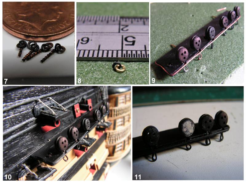

As well as the six deadeyes on each channel, there are also a set of four diminutive ring bolts and rings set into the top surface behind the deadeyes. Up to now, I have made the various ringbolts set into the hull sides out of 0.5mm brass wire but for these tiny little things, even that is too large a diameter! I eventually bought a reel of 0.3mm copper wire on Ebay to fashion these out of. This wire is almost ridiculously cheap - £1.75 for (I think) twenty five metres. The only problem which I found out later was that the copper is unaffected by the Blacken-it chemical bath so whilst the iron rings were done that way, the copper ring bolts had to be painted the old fashioned way with Admiralty Metal Black. The method for making up the ring bolts is really simple, the only tools required are a length of brass rod of the inside diameter of the ring, a mini vice (although you could just use pliers) and a smallish pin vice. With the brass rod clamped in the mini vice, bend a short length of the copper wire around it to form a loop and then clamp that loop in the chuck of the pin vice as shown in Photo 4. Then simply pass the loop over the brass rod in the vice as in Photo 5 and twist the pin vice around and around (either direction is fine) until the copper wire is tightened onto the rod as seen in Photo 6. The loop can then be slid off the rod to leave a perfect ringbolt. The ‘spiral’ part doesn’t matter as this is all hidden away inside the wood when it gets glued in place! Photo 7 illustrates the finished ringbolts, painted with the Admiralty Metal Black, each with a 0.5mm blackened brass ring inserted in through the ring and squeezed shut (see what I mean about the size up against the penny!Blink ) A bolt with a freshly formed brass ring is shown in Photo 8 before being dunked in the chemical bath.
Before the ringbolts and deadeyes could be glued in place, the edge of the channel had to be grooved in order to fit in the decorative beading as shown in Photo 9. The beading is formed with 0.5mm copper wire. On the mini channels I was able to create the grooves using the rotary tool with a diamond dust router bit by hand. On these longer channels however (and the even bigger mainmast and foremast channels to come) I needed a more controllable method. I’ll try and photograph the process when I get to the larger channels but essentially what I managed to do was to put the router bit in the rotary tool and then clamp the tool upside down in my old mini drill bench stand, setting the height of the drill so that the router bit was just proud of the stand base. Then with the tool running I was able to slowly pass the wooden channel past the router, allowing it to grind a shallow groove along the thickness of the wood to take the copper wire. It’s a sort of upside down mini router, still a little hit and miss with the control of the wood but I might try and make a ‘proper’ work surface to allow the work-piece to be fed along against a runner or something similar to improve the control (and stop it spinning away from my hands!) Anyway, it worked in the end!Cool In this photo the copper beading has been super glued in place, the excess at the ends snipped off and the ‘nub’ ground back flush with the wood using a diamond dust abrasive wheel in the rotary.
If you look closely at the deadeyes however, you might be able to see one slight mistake! The forth one in from the left had swivelled around in the strop as it was being super glued into place in the slot. Unfortunately, some glue had managed to wick it’s way into the strop and the deadeye was fixed firmly in place. Left like that it was going to completely muck up the rigging joining it to the deadeye above so something was going to have to be done. I tried using pliers to break the grip of the glue and rotate the deadeye around but no joy so the only alternative was to fill in the three original holes and try and re-drill another three in the correct orientation. Before I tried anything, I first did a test fit of the channel on the hull. Two tiny holes were drilled into the decorative square strip to match the twin brass rods and the channel, after painting the copper beading was gently push fitted into place as seen in Photo 10. It’s a really nice tight fit and after checking the position against the drawings I wriggled it out again to try and fix that deadeye. In Photo 11 the deadeye has been given a filling with some wood filler ready to be sanded down and re-drilled. In the next instalment you’ll be able to see how successful the attempt was and also find out that there was a much easier way to do it than the wood filler (courtesy of Gandale’s SOTS (or actually POTS)!BigGrin

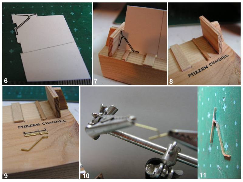

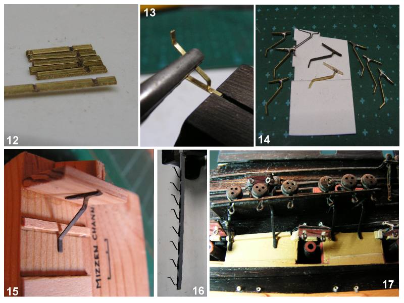

OK then, carrying on from the last pics, with the wood filler given overnight to dry, I tried to re-drill the deadeye holes in the correct orientation. This worked fine with the top two holes and sort of worked well with the bottom one. To be exact, the new hole was drilled through ok, but it was so close to the filled in one that the filler came away! This was where I remembered Gandales excellent section on his Sovereign of the Seas when for a short time she became the Porcupine of the Seas due to the hundreds of cocktail sticks glued into her hull for trenails! I suddenly realised that was what I should have done in the first place here – forget the wood filler, just bung in (sorry, carefully glue into place)Blushing a cocktail stick into the old hole in the deadeye – should have done all three that way, far easier as shown in Photo 1. In Photo 2 the glued stick has been snipped off and sanded down to the deadeye face. A coat of Admiralty Black and you wouldn’t even know it was there! I didn’t take a ‘family portrait’ of the port channel, but here’s its twin for the starboard side in Photo 3 showing everything required except the copper beading – wooden channel with brass rod locating pins, dyed black wooden deadeyes, copper eyebolts with brass rings and a set of brass deadeye strops already blackened. One handy technique which I didn’t mention earlier is to bend some thin wire (I used the 3mm copper here) and pass it up through two of the eyebolt holes to make a simple handle, this way you can paint both sides of the channel and the edges at the same time!Cool (Photo 4)

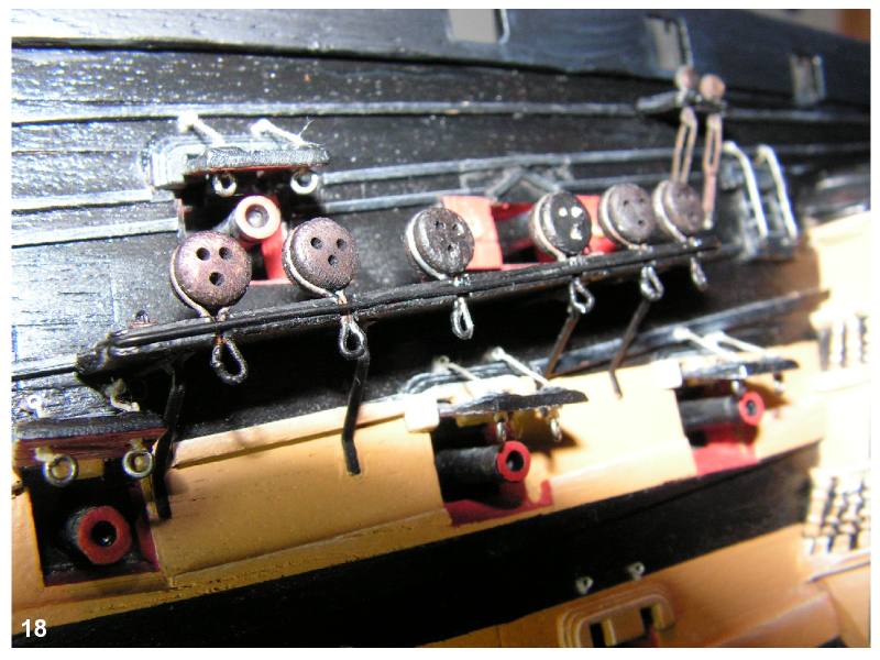

Once the channels had been painted and fitted into the hull it was time to look at another part of the channel, which doesn’t always appear in some manufacturers kits – the iron support brackets. The DelPrado basic kit doesn’t even mention them of course, even the Issue 1 publicity poster (which I use as a bookmark in the instructions folder) which shows far more bits and pieces on the prototype model than the kit ever had, doesn’t show them either! The basic plan of these brackets is shown in Diagram 5. I had thought that the main and fore channels had this type of bracket and the mizzen channel had a much simpler type, more like a modern shelf bracket but checking up on various sources revealed that all three sets of channels have the same type – a flat ‘Z’ shaped vertical support probably welded onto a horizontal bar which is chamfered off towards each end. I toyed with the idea of making these out of plasticard but decided in the end to go for brass strip, mainly because bending that ‘Z’ shape would be easier in the pliable brass. Unfortunately I had some strip that was too small and some more that was too thick so an order to Eileen’s Emporium for a length of 1.0 x 0.5mm x 25cm and two lengths of 1.0 x 0.3mm x 25cm had to go off. Brass strip was far cheaper in my youth I must say!Blink
The first task was to cut a thin strip of white card which was slid up tight against the hull, butting up against the end of the previously glued on channel. Using the underside of the channel a pencil line was drawn onto the card which gave the correct angle between the hull and the channel. Cutting off the top of the card at this angle and fitting the card back under the channel again, the positions of the decorative beading below and the raised wale below that were marked in and cut away with a sharp knife leaving a tight fitting guide or template. The outer edge of the channel was then added and the excess card beyond cut away to leave the final shape as shown in Photo 6. Onto this guide the shape of the bracket was drawn on as also seen here. Now it was time for another jiggy thing! Using the card template and scrap wood, a three dimensional copy of the hull and channel was glued together as depicted in Photos 7 and 8. With this I could now start to fashion the brackets out of the brass strip and test fit each one against the jig with a fair chance they would also fit straight onto the ship! In Photo 9 you can see the two parts of the first bracket alongside the measuring line drawn onto the jig base. The line in the middle designates where to file a groove in the base strip which you can just make out in the photo. The thinner ‘Z’ support ‘clicks’ into this groove prior to soldering. As you can see in Photo 10, the first bracket was held together in the helping hands crocodile clips (sorry about the focussing, all that shiny metal plays havoc with the auto setting!). This worked well on the first one which was obviously down to sheer luck as the remainder were so difficult to get into position that I developed a far easier method as you’ll see shortly! The first soldered bracket is shown in Photo 11 before I got to work on the chamfering of the base. In Photo 12, we’re into the mass production phase (well to be honest, eight is about as many as I can work on without going insane!)BigGrin Here we have six of the base plates underway, if you look at the one still on the strip you’ll see that I started placing a small groove on the end of the strip, as well as in the centre part, I found this made it much easier to cut the strips to the same length, all you have to do is slide the snips up until the jaws ‘click’ into the groove and then squeeze. In this scale, trying to position the jaws over a pencil line which is actually below the top of the jaw, is not easy!
Photo 13 illustrates that better method of gripping the two parts of the bracket for soldering. I’m now only using one of the crocodile clips on the helping hands, the base plate is now held lightly (but firmly) in the mini vice, this makes manoeuvring the support into place much easier. The only change I made to this shot was to grip the support from the other side which then made it easier to position the soldering iron under the joint to heat up the brass and then apply solder to the top either side of the joint. Photo 14 shows all eight of the supports soldered together with one of them having been given a bath in the Blacken-it. This one is also shown in Photo 15 having a test fit on the jig. The iron effect was very nice but I just couldn’t get the Blacken-it to work as well on the solder joints as you can probably see in this shot. In the end, after much deliberating (and after I’d blackened all eight of the things) I decided to scrape away the iron effect back to the bare brass, give them all a coat of grey primer and hand paint them with the Admiralty Metal Black instead as shown in Photo 16. Finally, in Photo 17 Ooops, AND 18 the port side mizzen channel is finally supported by it’s four brackets. I can only assume the two gun crews behind the channel were really careful where they aimed those cannon!Blink
In the next installment, adding the iron chains to the channel deadeyes.
