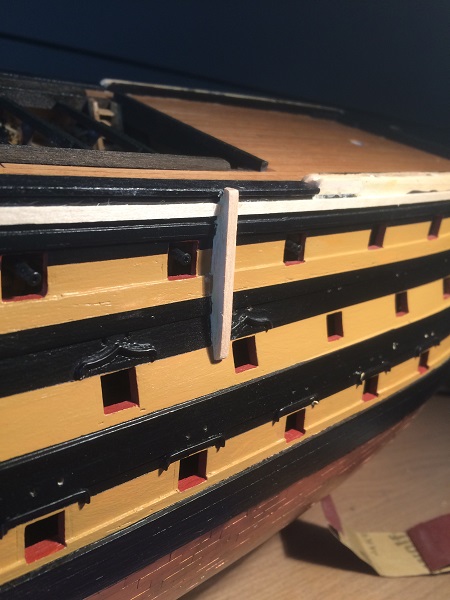

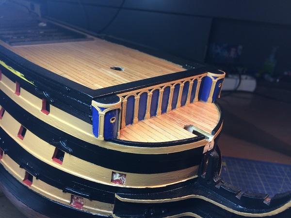

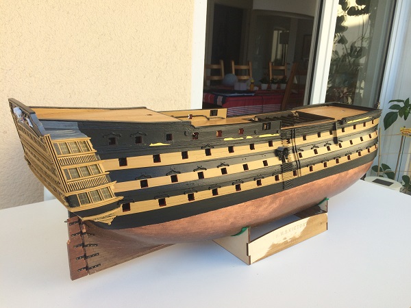

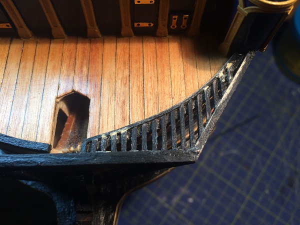

Next step were the fenders. I wanted to make them a little bit more descreet than the instructions suggest - also i wanted no gaps to the hull.
So i had to adjust some of the wriggles that were in the way. Used 2x1mm walnut fo the finish.
As often i was like - oh well i`ll just quickly make those fenders - which then turned out to be a 4h-job!!
Who needs sleep anyway? :)

Hi Walter,
The ladders and entrance looks fantastic.
#403 Posted : 12 July 2017 11:29:26
Hi Walter.
Cool looking fantastic. well done. Ian BigGrin

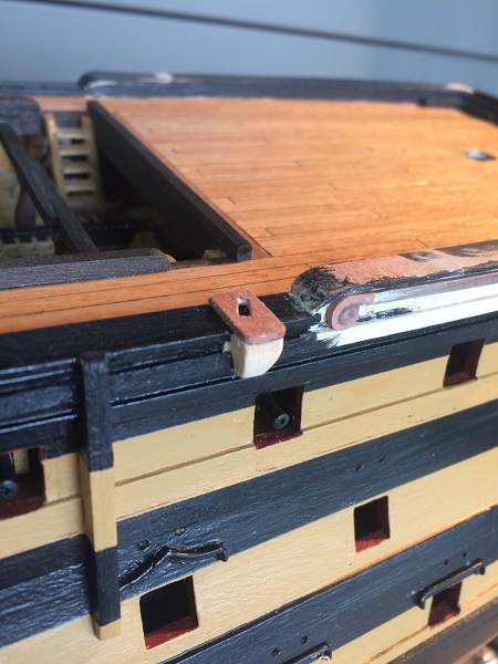

Thanks guys!

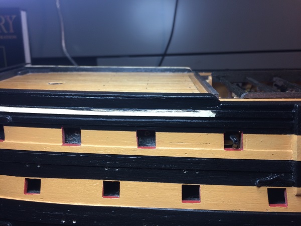

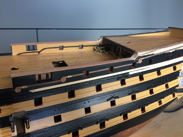

Again a small update as i completed all the fenders.
Again i deviated from the instructions regarding the front fenders and built them more straight and not running along the curve of the hull.

Yes, you're right, they should be straight. I wonder why they did it that way.
Nice work as ever.

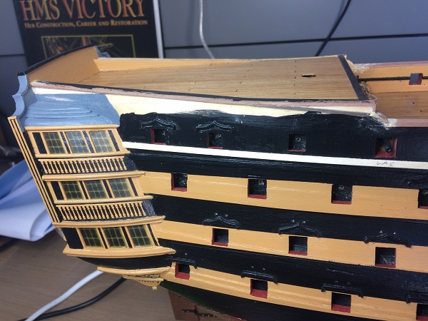

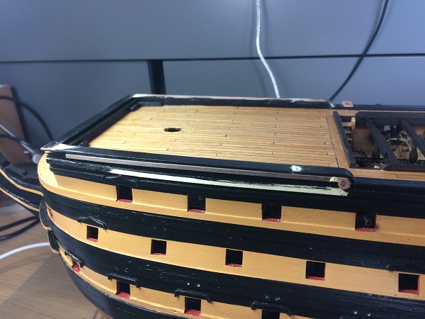

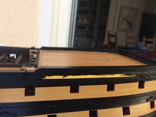

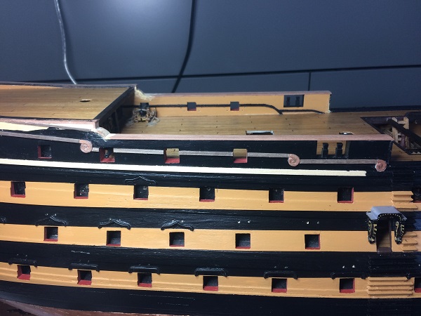

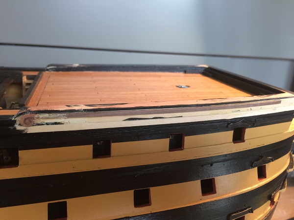

The wood for the cap strips finally arrived - so i gave it a go.
I started with the forcastle. As mentioned before i wanted the cap-strips to follow the curve of the hull (other than in the instructions)- also i used 8x1mm strips of pear-wood, as i want to achieve a more slim look.
Wasn`t easy to bend those strips but with hot water and a soldering iron i finally succeeded!
The painting will be finished after all the cap strips are mounted.
#410 Posted : 20 July 2017 13:05:45
Lovely work Walter, all looking great....Cool Cool
#411 Posted : 21 July 2017 08:37:59

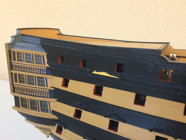

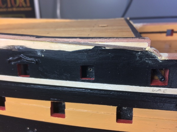

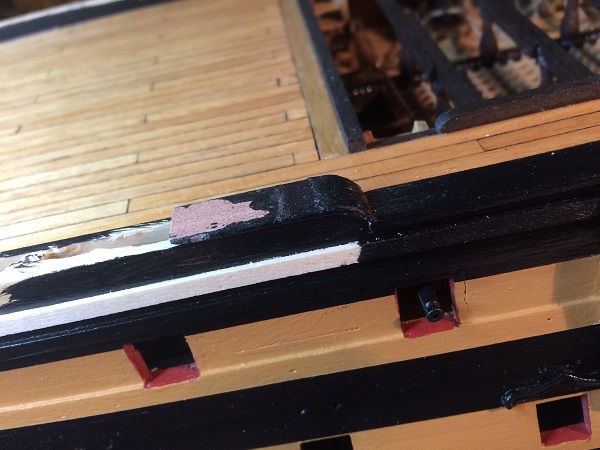

I finnished all the cap strips ( all with 8x1mm strips).
I´m especially pleased with the stern - as i could achieve the look of the orignial as i planned.
#412 Posted : 21 July 2017 09:41:14
Another very nice update Walter, looks great....Cool Cool

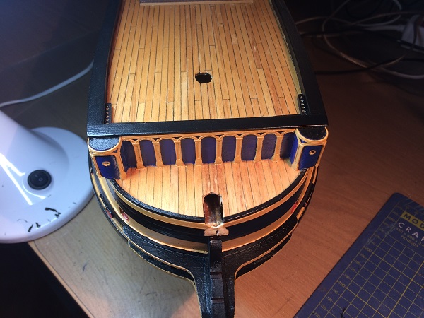

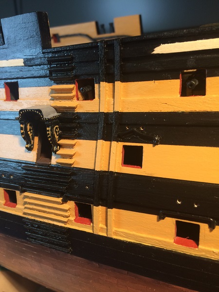

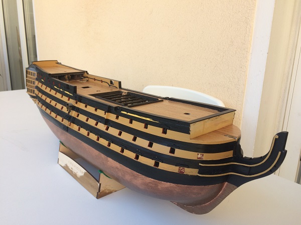

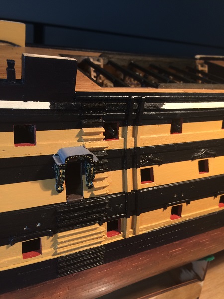

Next i used 2x1mm walnut for the moulding-strips and some pear-wood for the carvings - which i produced in different sizes.

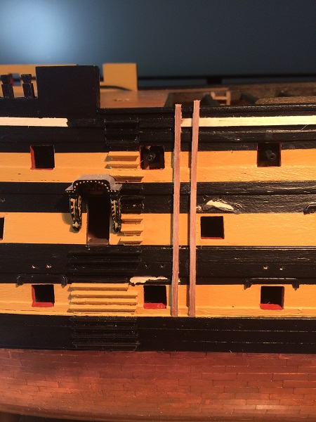

This is what she looks like after painting the hull and the cap strips ( i taped the areas for the chainwales).
#417 Posted : 25 July 2017 11:21:23
Great looking progress Walter, very nicely done....Drool Drool

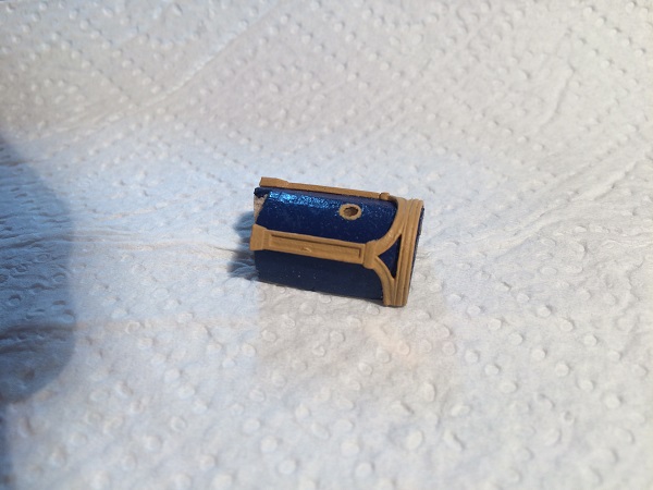

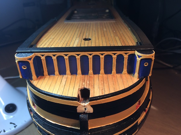

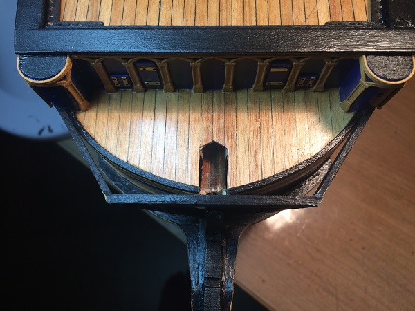

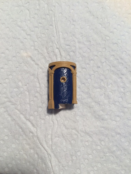

Next up was the beakhead bulkhead.
Because of the my modifications to the forecastle bulwarks my beakhead bulkhead was about 1 cm less high than in the instructions - so again i had to modify the parts.
Also i used 3D-printed parts for the decorations.
#419 Posted : 27 July 2017 07:59:27
Posts: 6,968
Points: 21,211
Very nice, love the detail.Drool

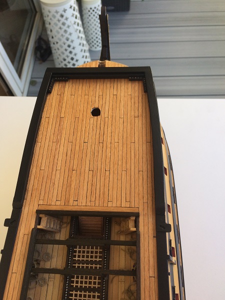

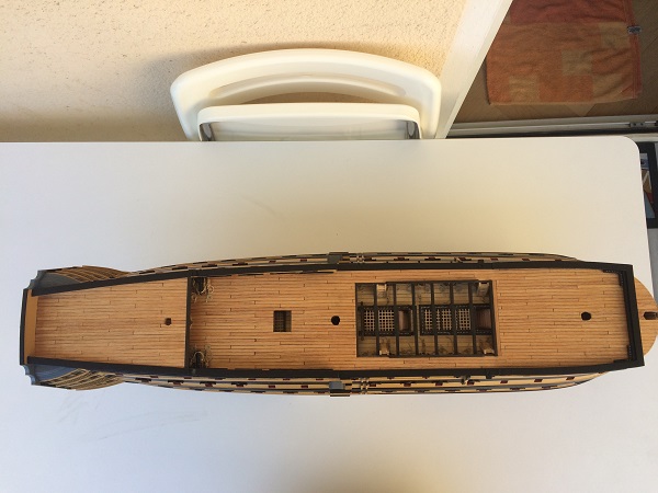

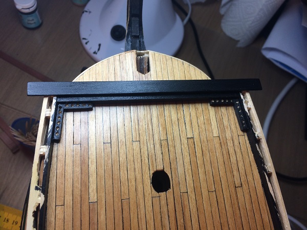

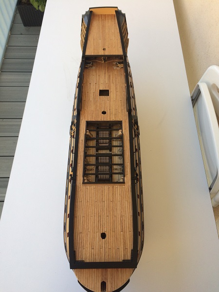

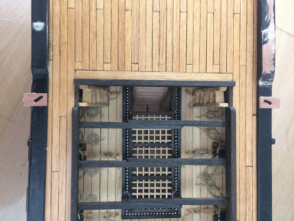

I built the first gratings - used 1x1mm strips.
