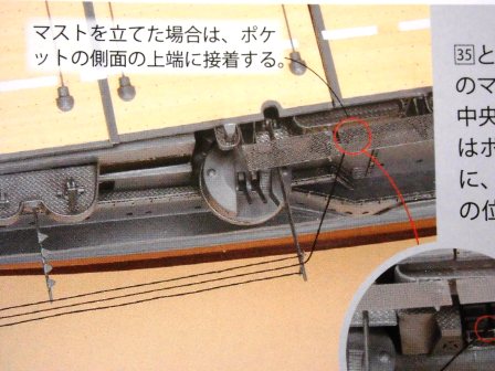

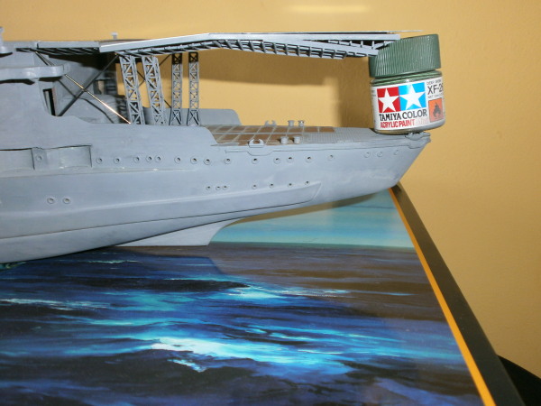

By the way, there is something that is bothering me in your last picture (pic #1).Confused

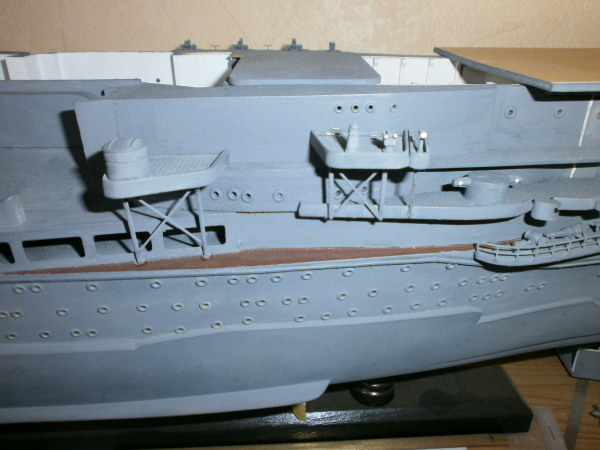

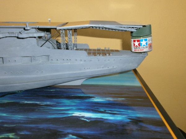

DeAGOSTINI Japan announced that they had provided a wrong metal part(pic #2) in the parts set of issue 39 when they provided issue 93. A lot of Japanese builders had to remove the wrong part and re-attach a new metal part in the last stage.Cursing
They showed us the picture of a wrong part(pic #2) then. The part on your Akagi is marked in the pic #1.

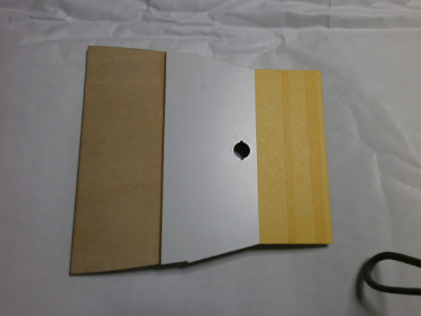

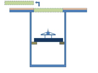

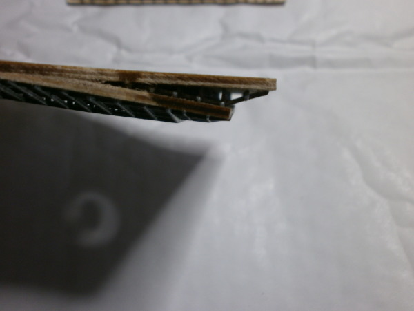

The right part(pic #3) was provided in the parts set of the issue 100 that was a last issue.
I am worried if your part is more resemble to the wrong part than the right one.Confused

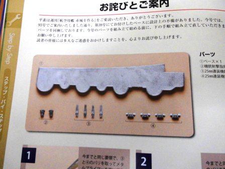

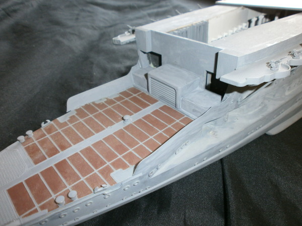

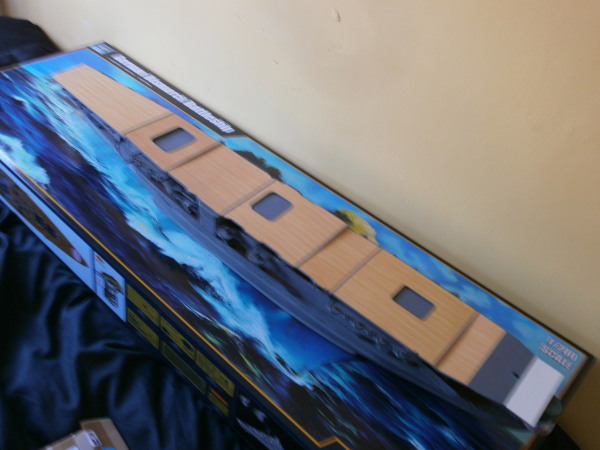

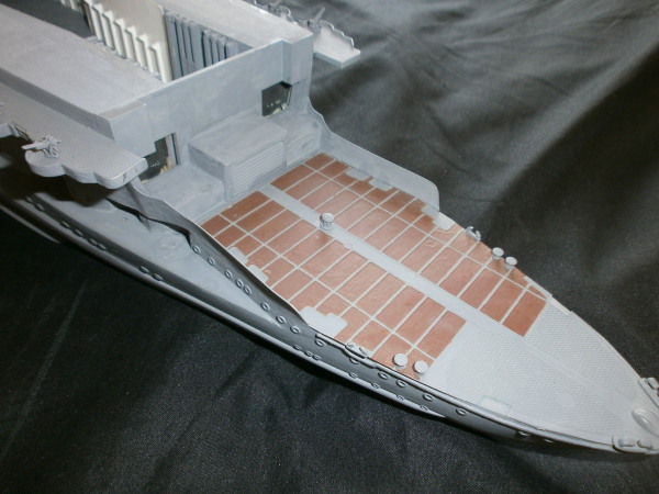

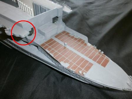

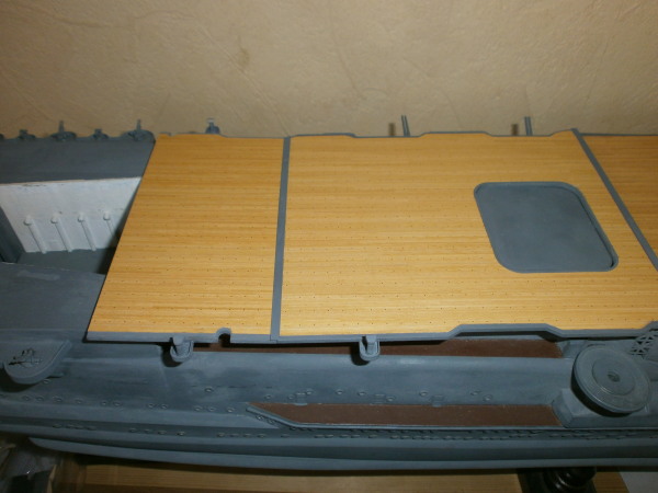

I guess you are close to the stage where antenna masts are attached. Although a mast is never located above the gun (pic#4), a right bow side mast is located on the gun in this model(pic#5).
Be careful.Cool

Yes I was aware about the missing projection at the end of the platform, im not sure if that part is to be reissued here though. As for the masts I had already noted that from one of your previous posts

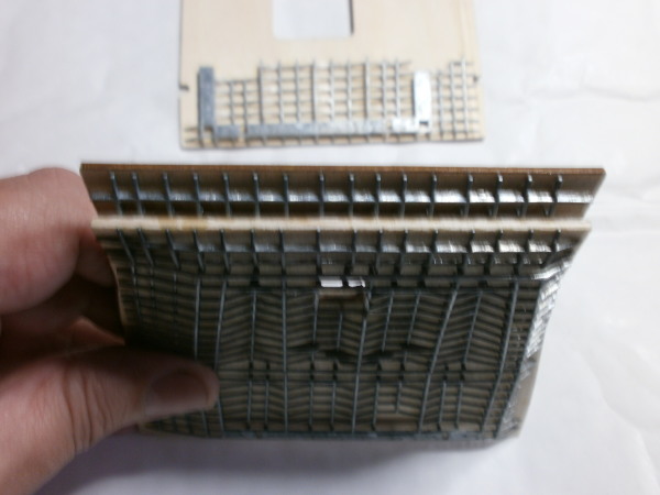

I think there may be The Third Way for this issue. I made the central lift be a double floor structure. (pic #1) Although the reason I did it was different from a measure against the warped flight deck panels, this method might be applicable.

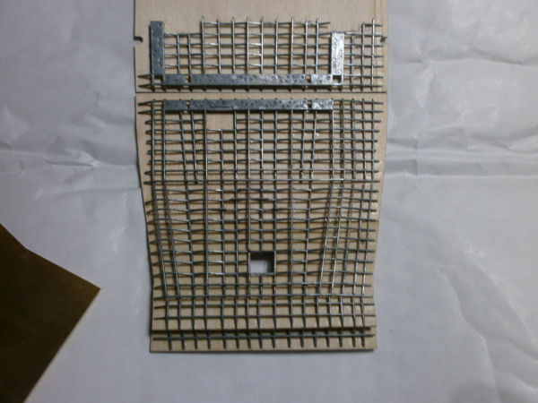

Making a removable lift floor, even if the panels were fixed, we can easily see the inside of the Akagi when it's necessary. (pic #2)
