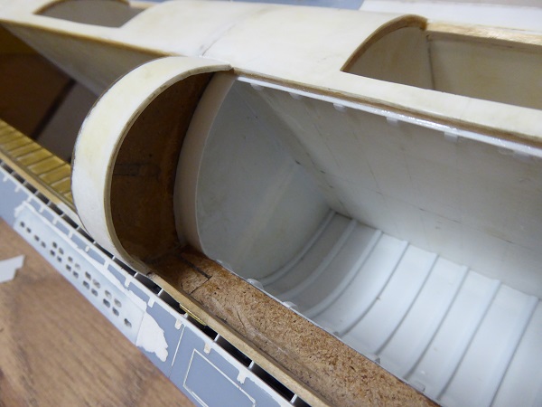

This photo shows the other end that has to be fitted with a profiled and scalloped end piece.

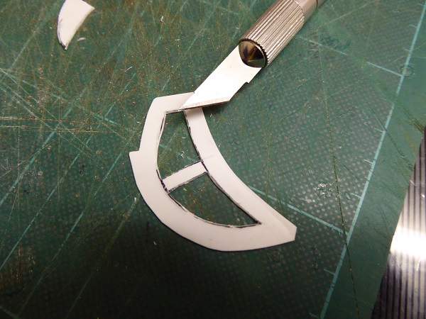

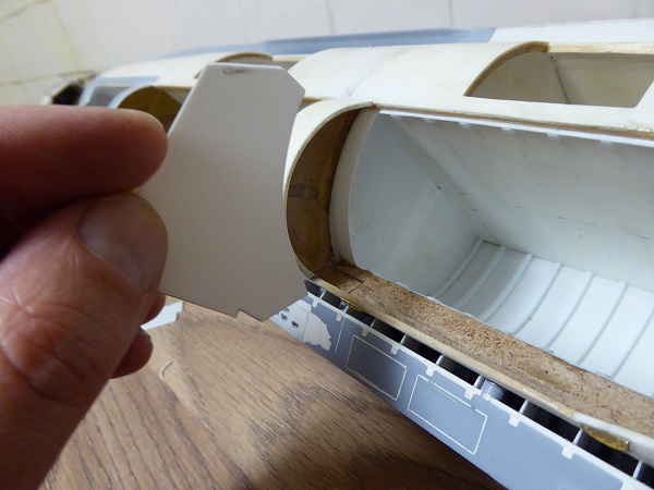

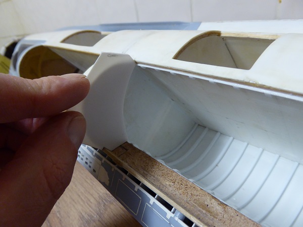

This picture shows the start of shaping and contouring a 0.5mm plastic sheet so that it fits the saddle tank. The uncut piece i'm holding will be removed later.
#403 Posted : 30 March 2017 18:24:29
This image shows the same piece being offered up to the saddle tank to check for fit.
#404 Posted : 30 March 2017 18:33:20

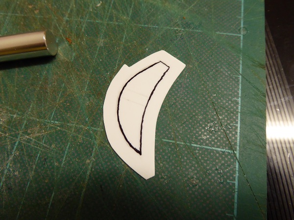

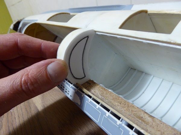

When I was happy with the fit of the profile I held it in place and drew around the outer shape of the saddle tank onto the excess plastic sheet I was holding. I carefully cut away the excess, checked it against the saddle tanks to make sure it was correct and then marked out, with a fine permanent pen, the area to remove internally. Removing an internal section gives the impression of depth to the tank ends matching the part-works supplied brass-etched parts for the Control Room and Engine Room.
The attached image shows the profiled piece cut to size and marked out.

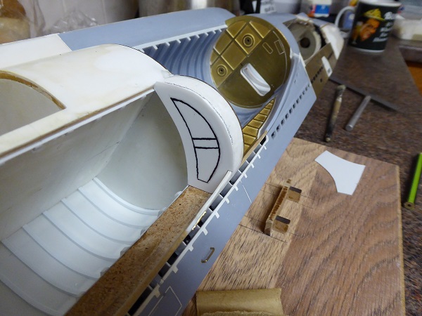

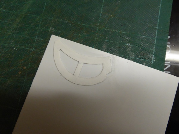

#405 Posted : 30 March 2017 18:34:49
This photo shows the piece being checked for fit against the saddle tank.

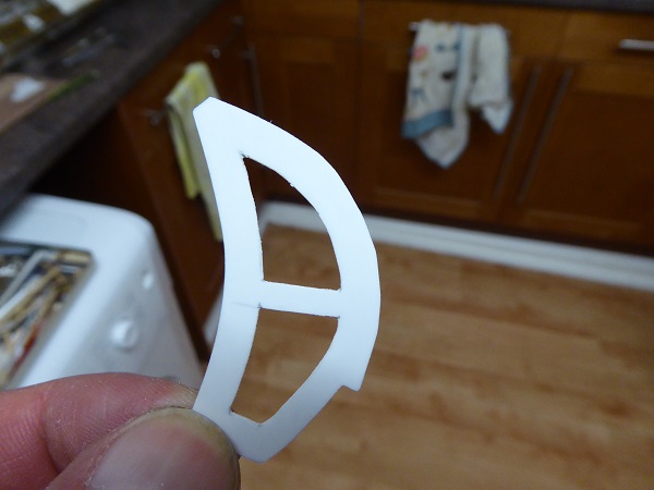

#406 Posted : 30 March 2017 18:36:05
Once happy, I proceeded to remove two internal sections. This picture shows them removed.

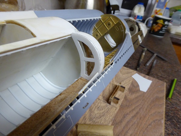

#407 Posted : 30 March 2017 18:37:48
This image shows another dry fit to make sure the centre section on the profiled piece was at the correct angle; towards the centre line of the hull.

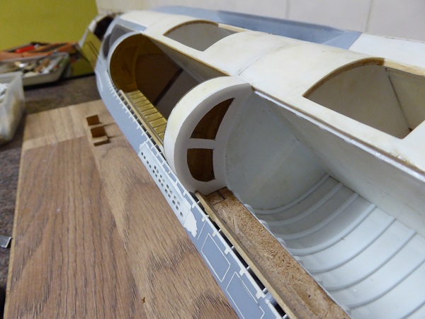

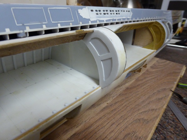

#410 Posted : 30 March 2017 18:43:10
This photo shows the completed scalloped and profiled tank end glued in place. I think it looks in keeping with the rest of the U-boat.

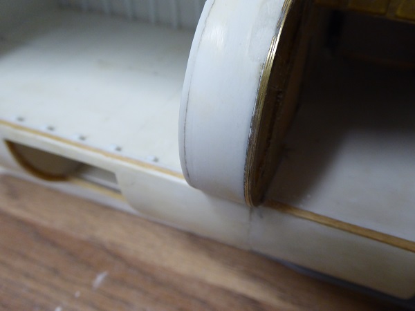

#411 Posted : 30 March 2017 18:44:17
This image shows a close up of the profiled edge against the saddle tank.
#412 Posted : 30 March 2017 18:45:18
Another close up showing the profile piece filed smooth and flush to match the saddle tank curve.

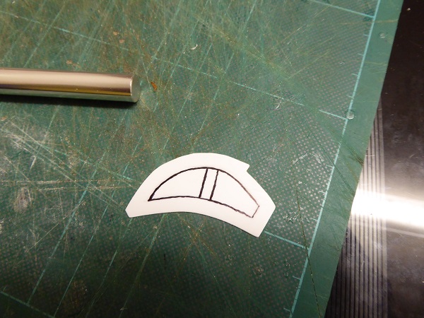

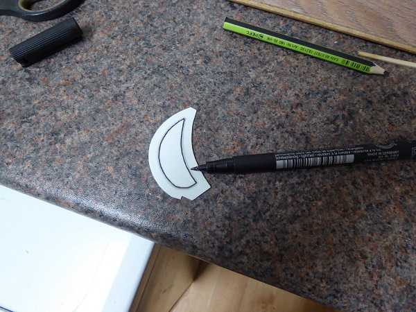

Time to start on the other end. LOL I followed the same procedure as before and this photo shows the profiled piece cut to shape and internals marked out.
#414 Posted : 30 March 2017 18:50:15
Another close up showing the marking out.

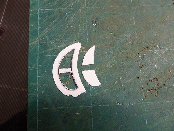

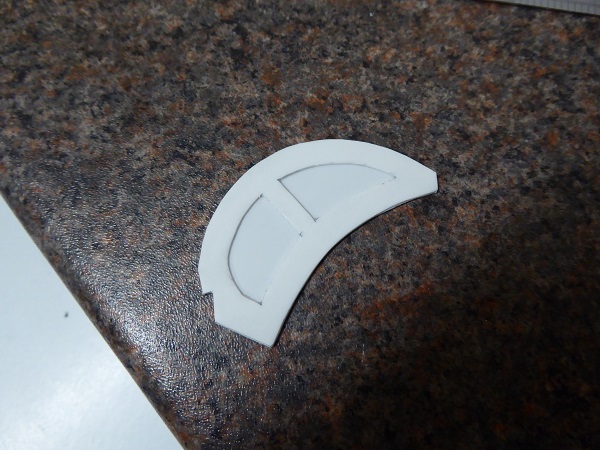

#416 Posted : 30 March 2017 18:53:10
This image shows the internal tank profile cut out.
#417 Posted : 30 March 2017 18:54:15
The completed profile piece filed smooth and ready for fitting.

#420 Posted : 30 March 2017 18:56:28
The completed profiled tank end fixed in place.
