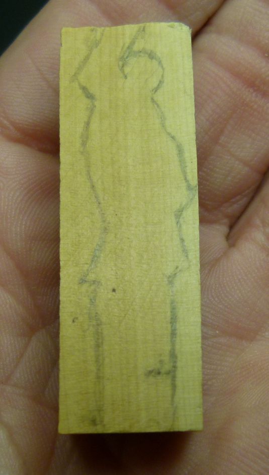

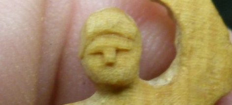

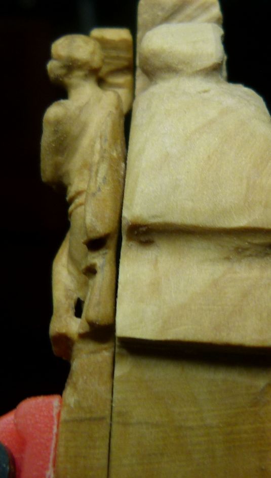

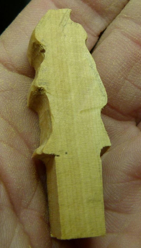

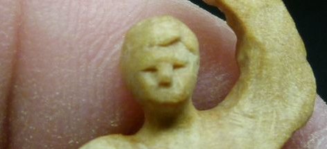

Started on the next guy on the figurehead, he`s basically a mirror image of the other one. He`s not finished at the mo and I`m running out of steam (think I`ll take a break) but I have done the head to acceptable level and here`s a small tutorial and how I did it. When doing a figure you must get the head right before anything else, its the first thing that people will notice, the next 5 photo`s show how to get to the stage before sculpting the head, the last photo is the point where I started to carve, at this stage the head is bigger than it needs to be to allow for the shaping

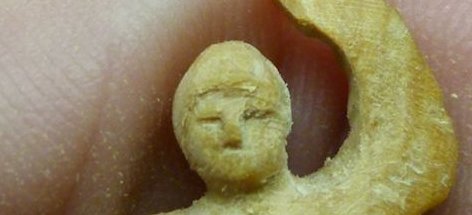

The next three photos show the basic face shape, this was done using a stanley blade, dig in to scrape a hair line and then scrape the eyes which at this stage are two simple right angles. Pic one, keep scraping and improving the shape pic 2, the last pic shows the head after more shaping and although in the face is not brilliant, to the naked eye it didn`t look too bad, however its around 5 mm wide and we need to get it down to the same size of the first figure (3.7 mm) this gives us scope to improve the shape, the problem being the smaller we go the harder it gets.

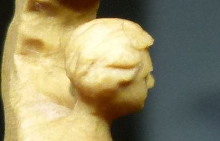

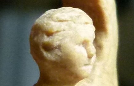

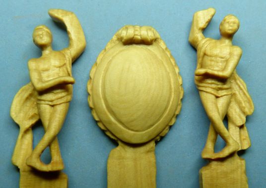

OK here were are after hours of gently scraping and shaping, the first two pics show the head at a stage where I was amazed at how it looked, but again it was too big for the scale (.4 mm too wide), so had to keep going and in doing so lost some of its beauty, the last pic shows the finished head, and after having it near perfect in the earlier stages I felt a little disappointed, the head is now 3.8 mm wide thats 0.1 mm wider that the other so could perhaps shape it a little more, but then you have to remind yourself that to the naked eye you wouldn't see any difference, time to quite before disaster strikes.

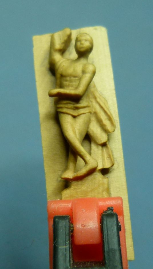

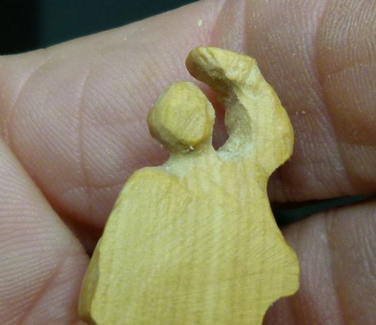

w.i.p. started to shape the other small guy, the only slight problem is the fact that he has to look similar to the other one, don't need a perfect mirror image but he does need to look like he belongs
willz
#393 Posted : 05 October 2013 03:08:33
Joined: 23/03/2010
Posts: 507
Points: 1,571
bit closer

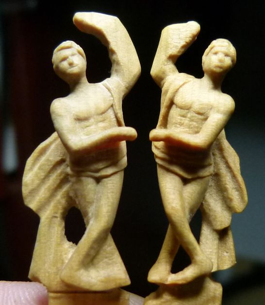

Willz, they could be twins, or at least brothers BigGrin
Great stuff Love

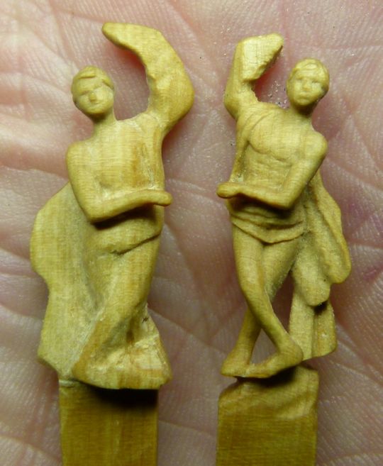

willz
#397 Posted : 06 October 2013 05:49:12
Joined: 23/03/2010
Posts: 507
Points: 1,571
cheers all for the kind comments, appreciated
got a bit carried away doing the other small guy, its almost 5 in the morning, time flies when your having fun ??????? !!!!!!!
anyhow here`s a pic of my progress, going to leave them both for now until a later stage for finishing, cheers lads (and lasses)

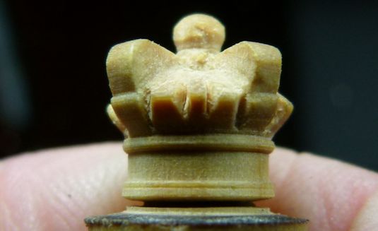

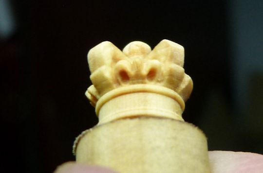

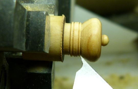

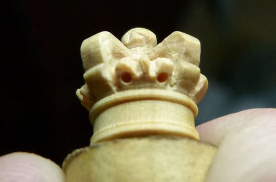

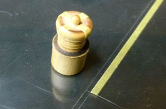

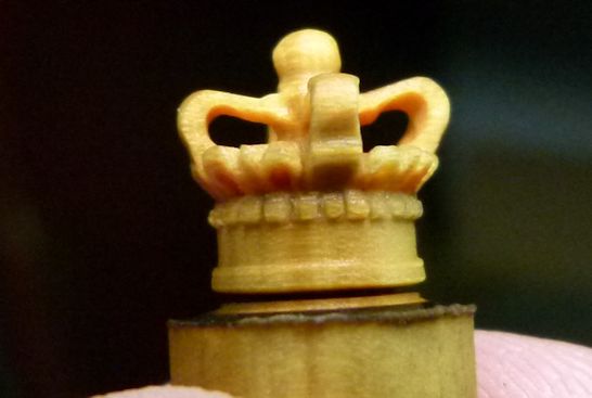

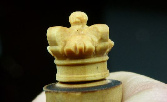

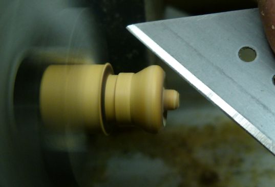

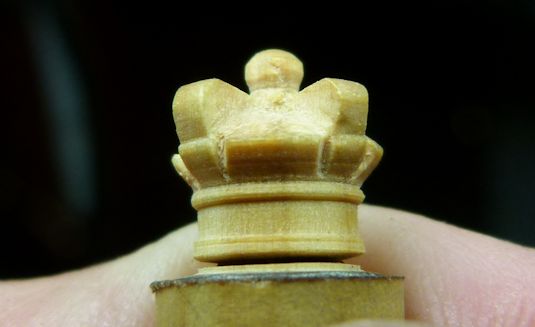

Next up for the figurehead is the crown, first I shaped it in the lathe, the lathe I use is a metal working lathe, so I dont have a tool steady, so I gently shaped it using stanley blades. Next I cut some tamiya masking tape to the desired thickness and stuck it on the top to act as a guide for cutting. Then having the basic shape I just carried on with stanley blades and my dremel to get the the stage shown in the last photo, still work in progress but no need to go mad at this scale

Hi Willz
Thank you for posting your update,I just love work to your standard I think we are all learning from yourself well done Willz.
Regards Trev .
