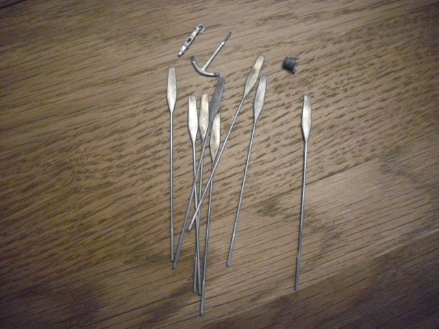

ISSUE 13 BUILD
Hi Team, this week we received wood and iron ware for the continuation of the launch.
As I have stated before I am building my own launch as an enhancement, which I will continue building later, This is what we received:-
Kind regards MikeBigGrin

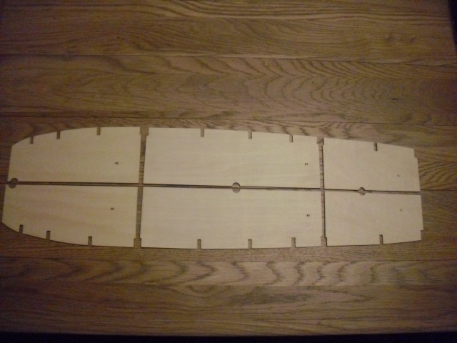

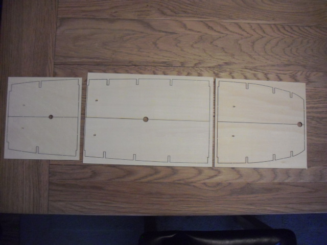

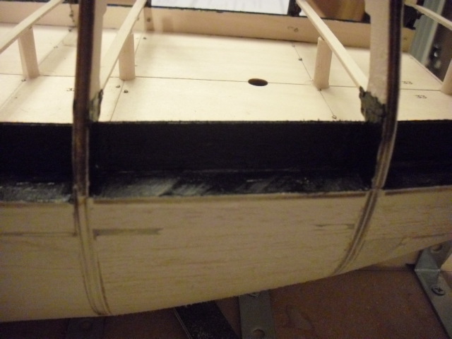

#390 Posted : 07 December 2012 09:55:11

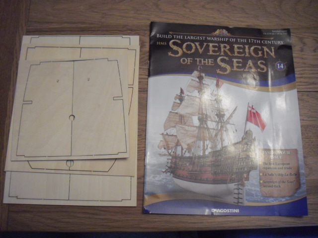

ISSUE 14 BUILD
Hi Team, well here we are and already over 3months have past (how time flys when you are having fun)
This week we receive the parts for the second deck:-
#391 Posted : 07 December 2012 10:00:27

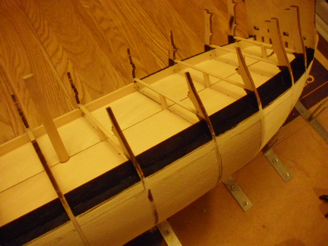

ISSUE 14 BUILD
I chose to paint all the dummy gun batterns black as my first task, taking care not to get paint all over the place, I used the Dull black that comes in the De Ag paint set:-

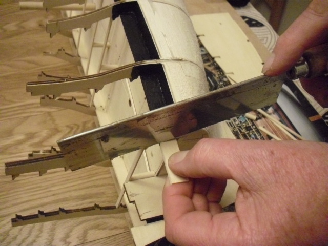

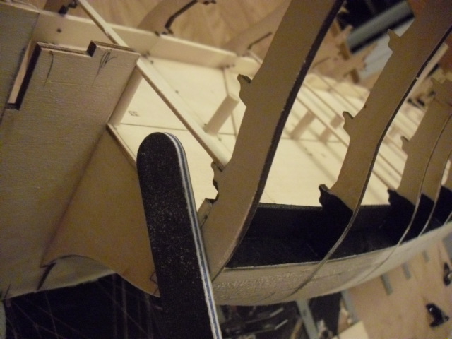

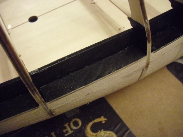

#392 Posted : 07 December 2012 10:04:13
ISSUE 14 BUILD
My next task was to cut off the excess dummy gun beams with a razor saw, and sand the cut areas with a ladies nail shaper:-
#393 Posted : 07 December 2012 10:12:19
ISSUE 14 BUILD

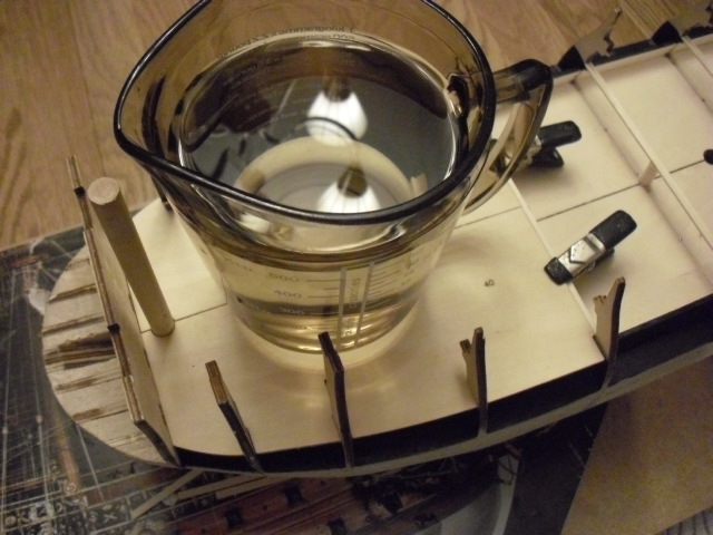

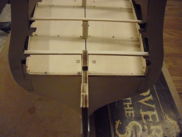

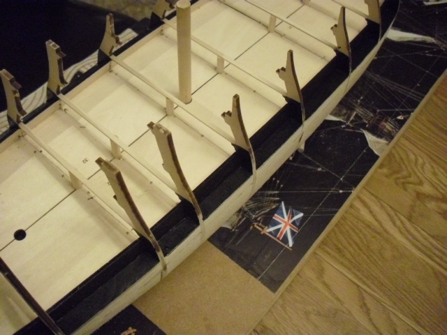

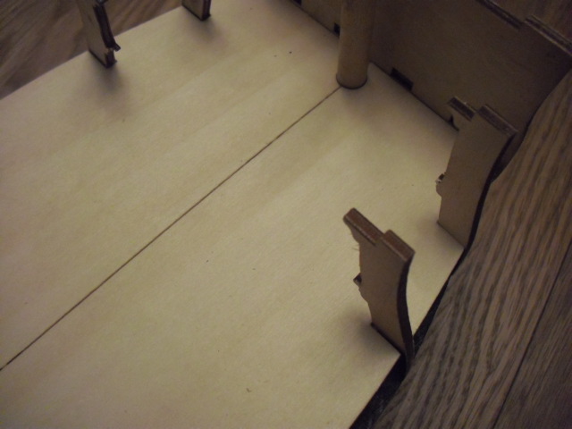

Last but by no means least I fitted the deck pieces, starting at the Bow (front)I used water jugs filled with water to give weight to help press the decks to the beams (that is why I fitted supports to the beams in build 13)
The decks slotted in to place with no adjustments, by just following the instructions:-
#394 Posted : 07 December 2012 10:16:47
ISSUE 14 BUILD

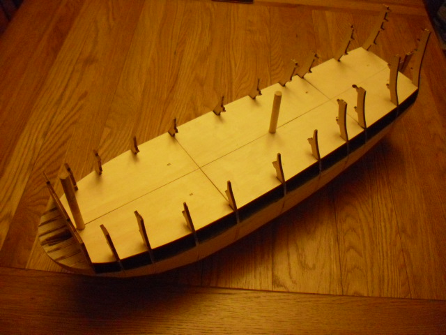

Thats all for this session Team. As usual questions and comments welcomeBigGrin I will leave you with a photo of how she looks after Build 14 Kind regards Mike
