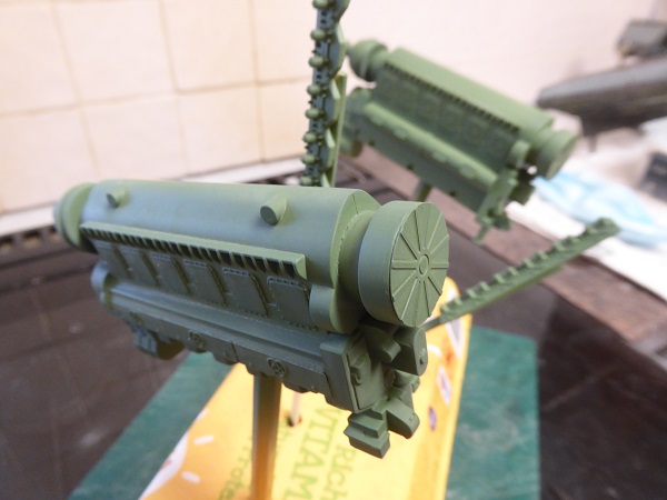

#382 Posted : 18 February 2021 19:13:50

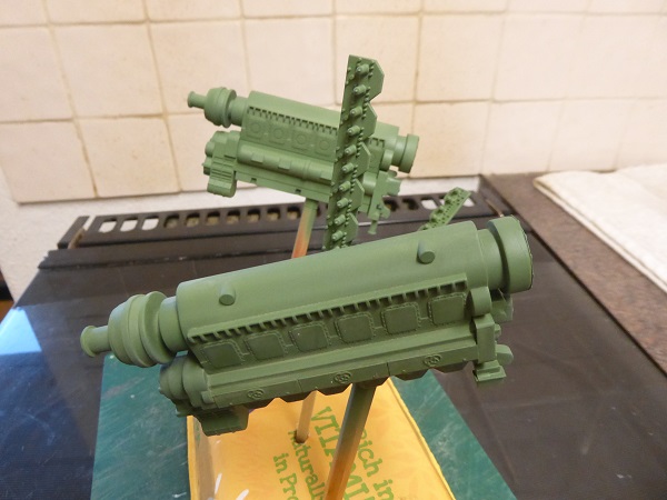

I then concentrated on the main diesel engine blocks and cylinder head tops. Good old pencils wrapped in double-sided tape and an eggbox as a support to hold everything!LOL
#383 Posted : 18 February 2021 19:26:21
I'm very happy with this particular shade of green. The parts were then clear coated with matt acrylic varnish. I've only just finished that job, so next week i'll apply a pin wash to all these parts to pick out the details. Only when the engines are complete will i then use oils to add patches, streaks and runs to them. It won't be too over the top though, as these engines were kept surprisingly clean when in service; the reason being that it is easier to spot and locate an oil leak. Take it from me, being on watch in an Engine Room on a Diesel submarine, between noting down pressure readings and temperatures and there was a lot to jot down while on watch, i spent the rest of the time cleaning, cleaning and more cleaning. LOL

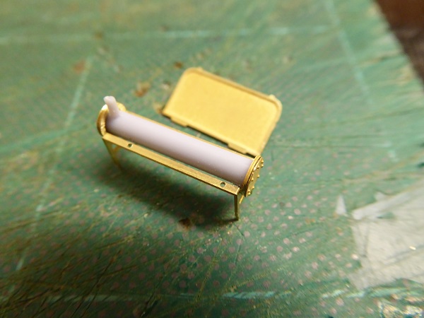

More progress made this week assembling parts for the Engine Room. However, i didn't get as much done as i would've liked due to an order of matt varnish not arriving until today when it was supposed to of arrived on Monday. Oh well, it's here now and that's the main thing.
So, i assembled an oil separator and tray. They will both be painted and fitted at a later date.

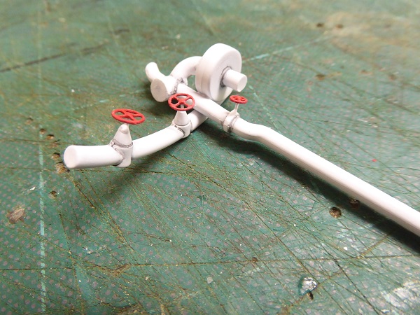

#387 Posted : 25 February 2021 21:56:50

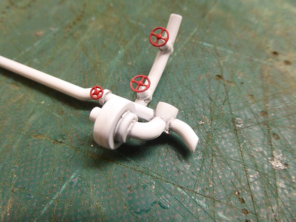

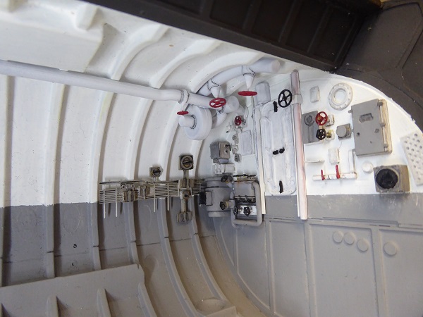

The next job was to assemble and paint the extractor fan unit and isolation valves. Due to the location of the pipework and where it connects to the bulkhead, i can only assume it's the extractor for the Galley, to clear the steam and smoke while the cook's busy boiling spuds and frying mince and onions!LOL
#388 Posted : 25 February 2021 21:58:04
I got this varnished, pin-washed and fitted, literally only a few minutes before i posted this update.
#389 Posted : 25 February 2021 21:59:05
Looking from another angle.
#390 Posted : 25 February 2021 22:00:06
Extractor and all associated pipework and valves fitted.

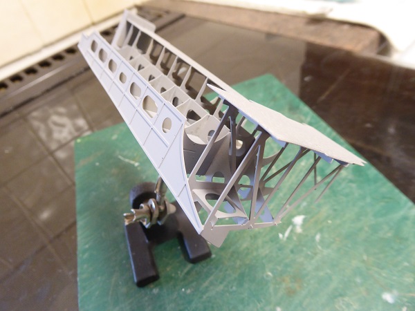

Thank you very much for the kind comments guys, much appreciated.Love

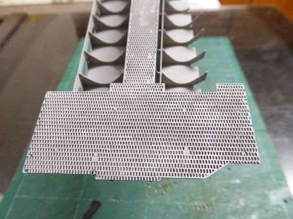

So this week was head down and push on with the Engine Room. The attached photo shows the walkway painted in flat aluminium, varnished with matt acrylic varnish and then pin washed with a thinned matt black, using the same colours and techniques i used for the Aft Torpedo Compartment.

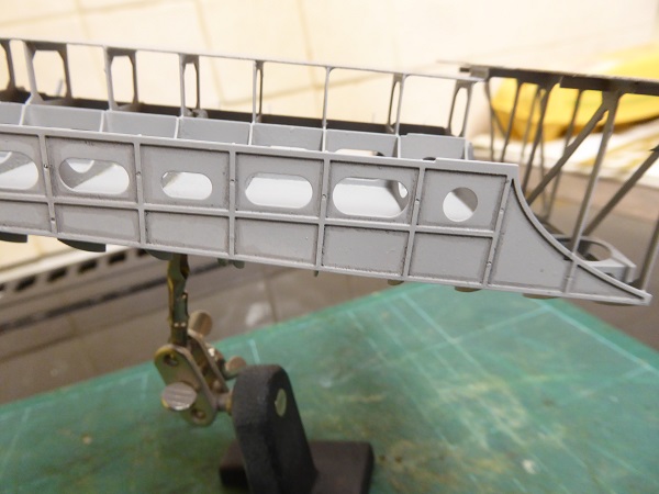

#395 Posted : 04 March 2021 21:26:42
I then pin washed the rest of this structure; not too over the top. I will add a couple of rust streaks when it's fitted, so i can better gauge the level of weathering required.

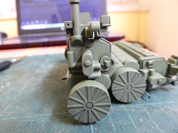

#396 Posted : 04 March 2021 21:30:38

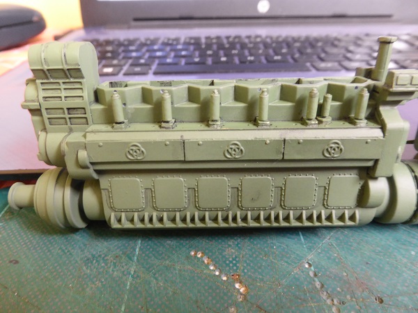

The attached photo shows the extent of pin wash applied to both diesel engines. Quite reserved as i don't want them to be completely covered in oil as they were never like that in real life. I can always add more pin wash/oil/pastels once they're fitted, when i can look at the compartment as a whole and see where areas would benefit from more application.

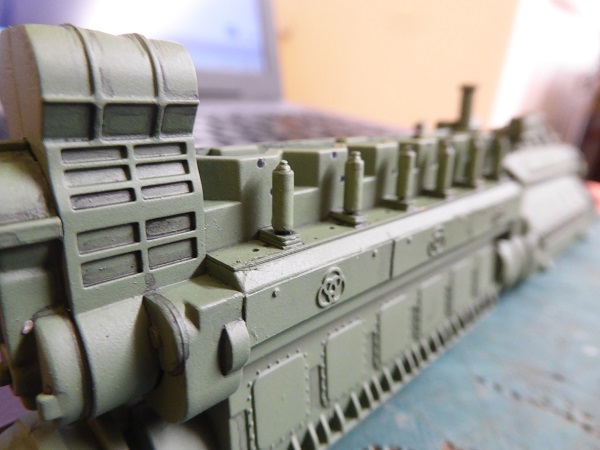

#397 Posted : 04 March 2021 21:31:45

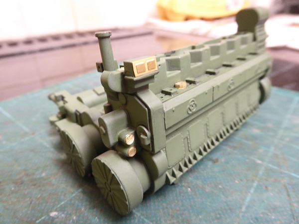

The etched brass parts in this photo show new pieces fitted. These were then painted, varnished and pin washed.
#398 Posted : 04 March 2021 21:32:46

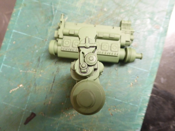

This photo shows several levers fitted. They have already been painted and pin washed.
#399 Posted : 04 March 2021 21:33:18
This photo shows the injectors fitted.
