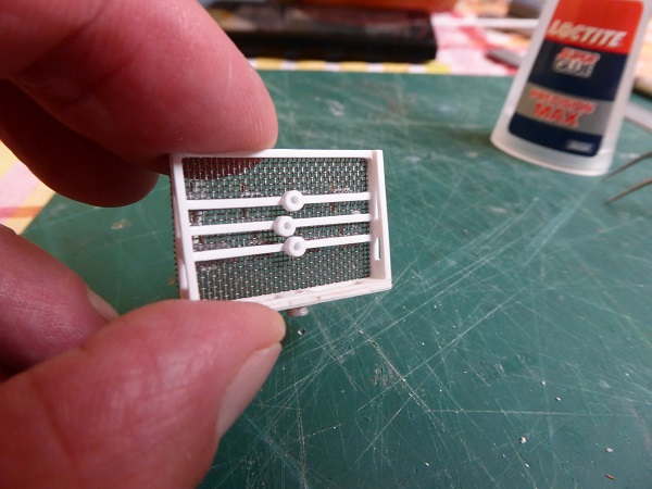

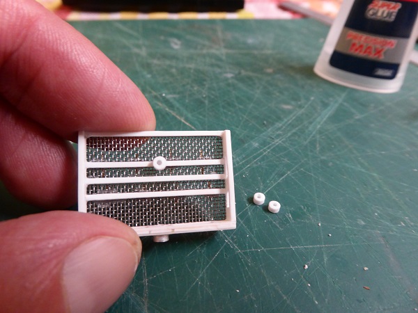

The attached photo shows the first of three terminals being fitted. Made from 2.5mm round plastic rod, cut and filed to length, with a 1.0mm hole drilled through the centre.
#391 Posted : 25 October 2018 19:42:42

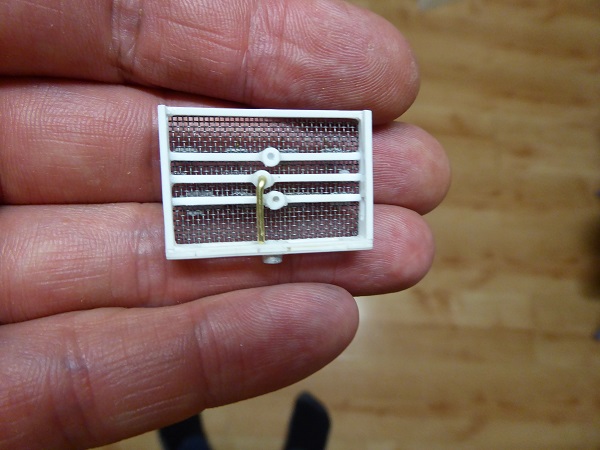

The three terminals fitted, with the central terminal slightly off centre to the top and bottom as per U995.

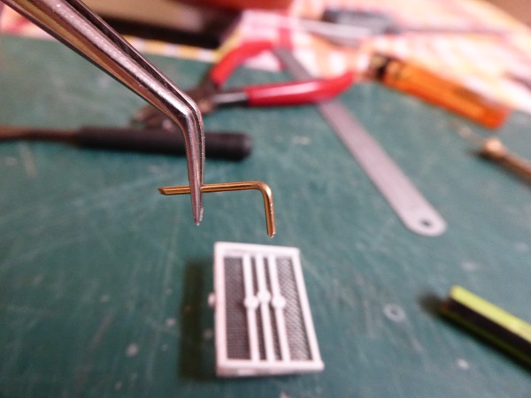

Earlier in the week I ordered some 1.0m diameter brass rod. In this photo, I've cut a small length and bent it to connect the central terminal to the wire antennae frame. In reality the signal would then be transmitted down the mast and onto the Radar Shack to be read by a radio operator.
#393 Posted : 25 October 2018 20:16:07

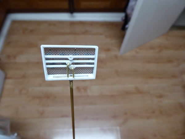

Brass rod bent and fitted.
#394 Posted : 25 October 2018 20:16:39
From another angle.
#395 Posted : 25 October 2018 20:18:43

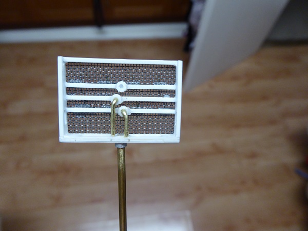

Second terminal connected to the wire mesh antennae frame via 1.0mm diameter brass rod.
#396 Posted : 25 October 2018 20:19:32
Close up.
#397 Posted : 25 October 2018 20:20:36

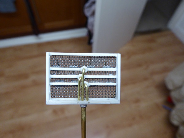

The third and final terminal connected with the brass rod.
#398 Posted : 25 October 2018 20:24:15

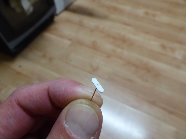

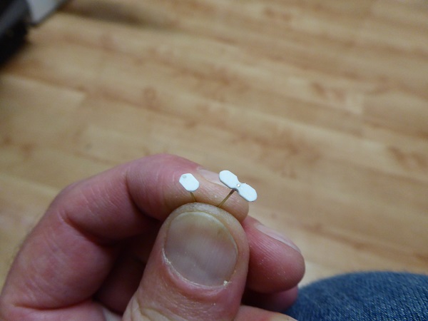

The attached photo shows the first of two paddle shaped receptors. Made from 0.5mm thick plastic sheet and drilled out to accept a length of 0.5mm diameter brass rod. This will then attach to the antennae frame. Very tiny!Blink
#399 Posted : 25 October 2018 20:24:46
The second of the receptors.
#400 Posted : 25 October 2018 20:26:23
I then filed each one to round off the corners as per U995. The attached photo shows both receptors shaped and contoured.
