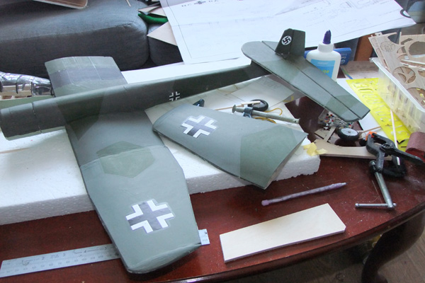

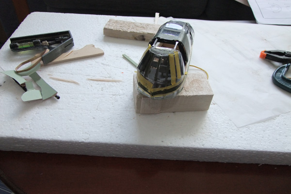

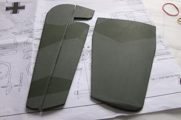

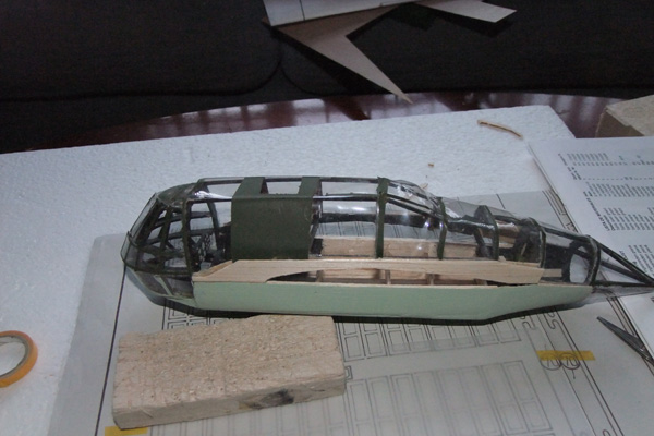

Hello All,
A lot of time has been spent on glazing the crew compartment, much wasted. The photo shows the current iteration which I am not satisfied with. I have started shaping a block of balsa to make a mold, when this is done I intend to place a sheet of transparency over it. I think the hot air from a hair drier should soften the plastic without destroying its transparency, and with luck that will be problem solved.
A coat of paint has been added to the stbd outer wing and the tailplane. I am using Revell paints No 59 sky for the lower surfaces, No67 grey green and No68 dark green for the upper surfaces. They will probably need another coat before finishing.
More next week all being well,
Regards, Tony.

#28 Posted : 28 February 2014 21:14:23
Hi Tony,
Looking at your build and plans it appears to be all ok it looks a lot of work and tricky to I'm not to sure what you mean about shaping a balsa mold and what it is for.As for the balsa covering on the wings,they look very neat and a great choice of colours to.
All the best
Trev.
#29 Posted : 01 March 2014 10:19:07
BigGrin Hi Tony
Looking great , I thought there may be problems with the greenhouse glazing as you need curves not flat pieces. The mould is a good idea but perhaps an electric paint stripper will be more powerful for your needs ,if used carefully

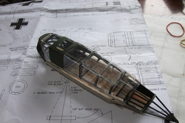

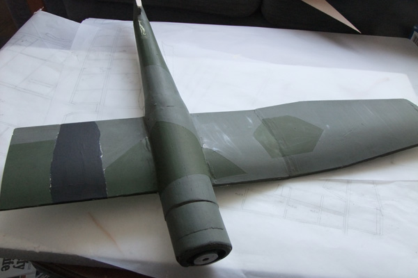

Hello all,
I tried doing the front glazing with a rented heat gun, and promptly wrecked the forward part of the main canopy. I need to get some more transparent material, hopefully the local Hobbycraft shop will have some, or I will have to send for some. I have resorted to cutting and fitting the front glazing as can be seen in one of the photos.
Everything with the exception of the crew compartment has been finish painted and decals have been applied. They are pretty glossy, so I have dulled them down with humbrol satin cote. I need to find some Arial letters, or else I will have to resort to hand painting which could spoil the model.
Hopefully I will have completed the crew compartment by next week.
Tony.

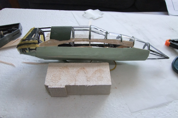

Hello all,

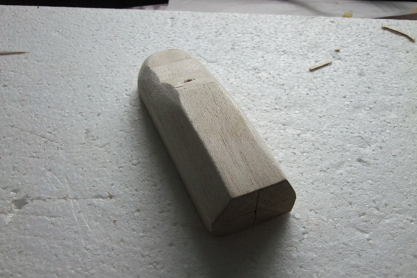

A follow up from yesterday, I bought some more transparent material and re-made the first section of canopy. I have fitted the above wing side pieces, and the whole assembly is now ready to be fitted to the wing. After fairing it to the wing a final coat of paint will be applied, and the stbd outer wing secured in place. I have included a photo of the mold I made for the canopy.
If everything goes well I should finish construction in the next week. The only outstanding problem is finding suitable lettering.
Tony.

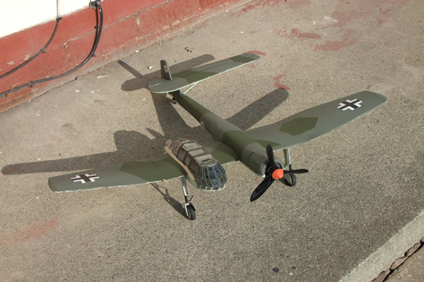

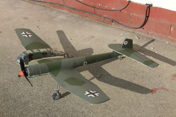

Hello all,
The crew compartment has been fitted to the wing and the stbd outer wing section glued in place. The propeller blades have been shortened by 50mm and re-shaped to look more like the original. A spinner and shaft was made and the propeller secured in place. The main undercarriage has been fitted and a tailwheel made and installed. Since the photos were taken, the crew compartment sides have been painted and a radio antenna and pitot tube made and fitted. Construction is now complete, I am having difficulty sourcing correct size and font lettering. I do not want to hand paint these as I am not 100% steady.
If anybody else fancies having a go, I have the drawings looking for a home. Send me a PM and we can see about coming to an arrangement.
Many thanks to all who took the time to look in and comment, and also all those who just looked in.
Regards to all,
Tony.
