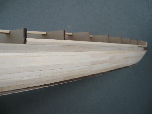

#21 Posted : 04 May 2010 10:54:15

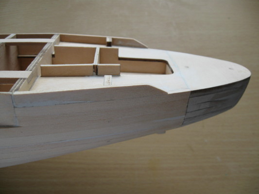

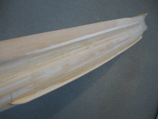

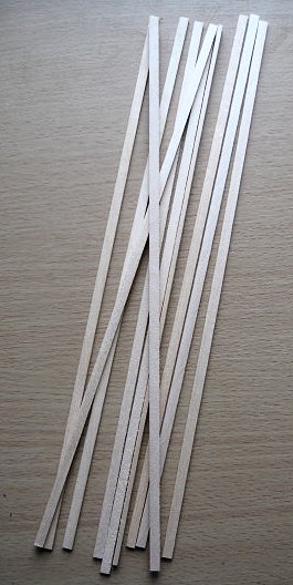

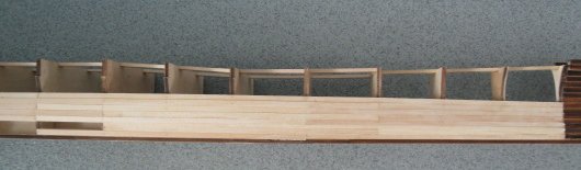

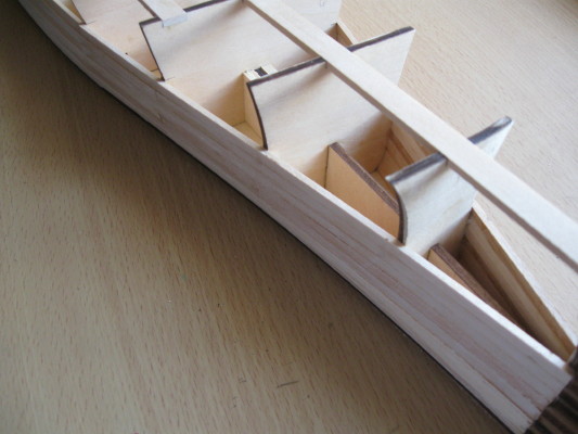

More bow planking, the entire hull is single plank skinned and no planking applied to the underside of the hull.
#22 Posted : 10 May 2010 13:05:38
Stern planking and the hull starting to be closed up!
#23 Posted : 17 May 2010 11:56:38
Closing up the Stern, which is straight forward enough.

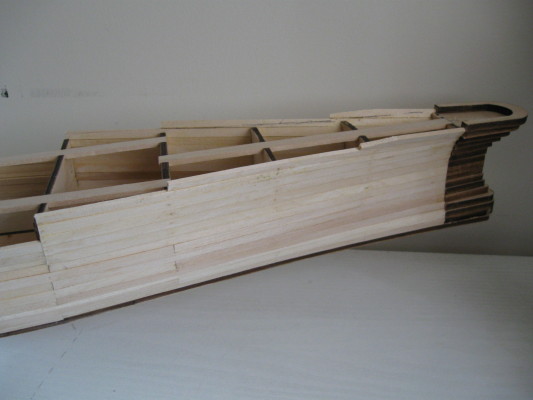

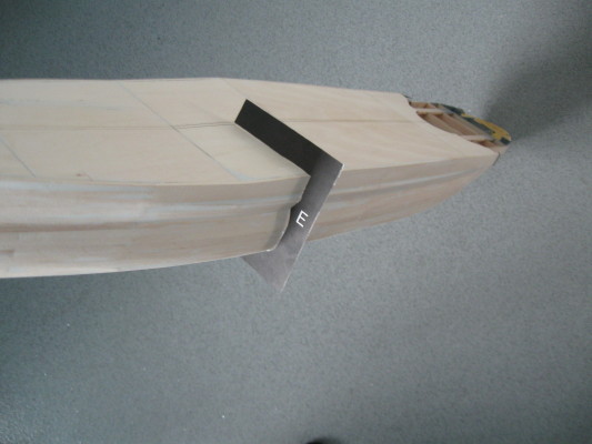

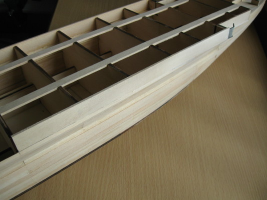

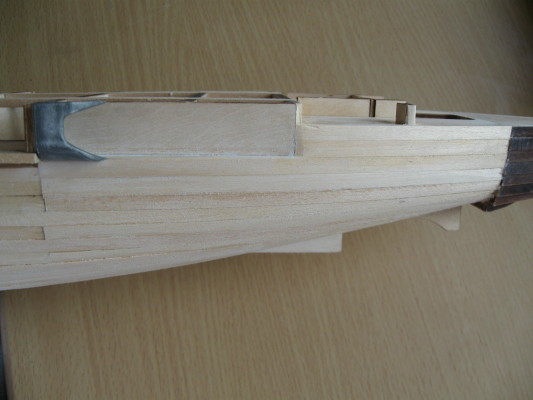

#24 Posted : 24 May 2010 11:08:04

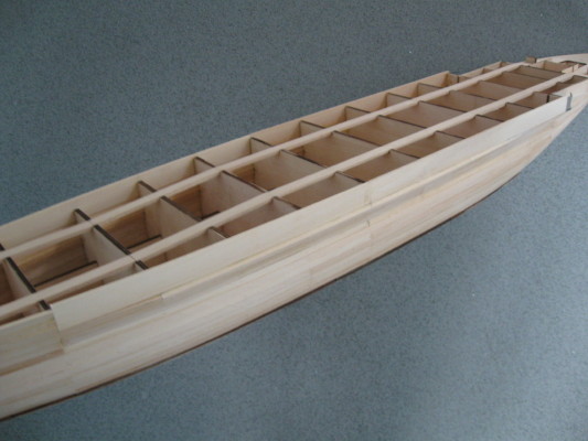

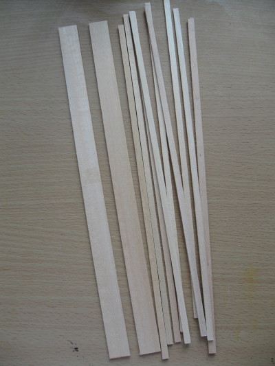

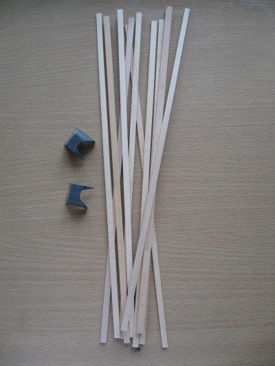

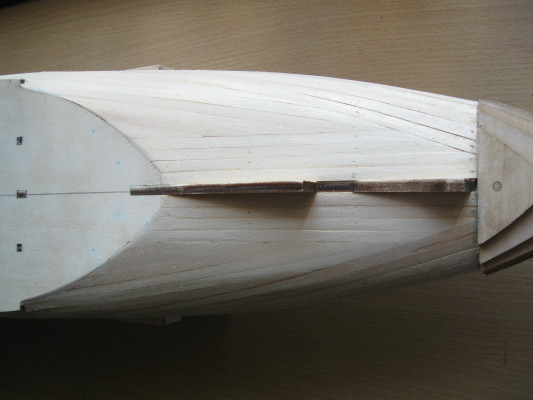

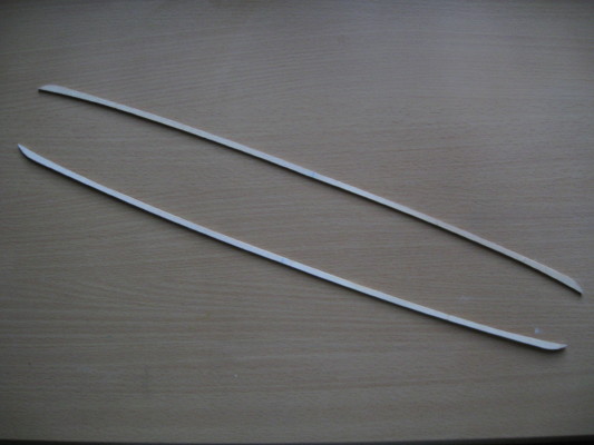

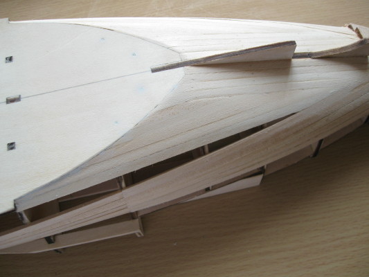

More planking for the hull and the bevelled armour belt strip applied.
Ensure the bevelled edge of the armour strips align with the stepped edge at the tops of the frames (not higher or lower), the strip will run F5-F13 where the bevel then fades out at both ends.

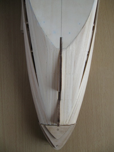

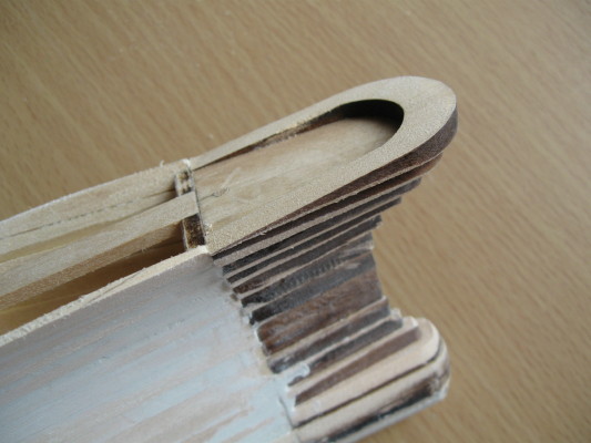

#25 Posted : 01 June 2010 12:21:30
The gradual closing up of the hull, fitting of the two boat hanger ports and the fitting of the deck level strips.
The tops of the two metal boat hanger ports need to be made flush with the tops of the stern frames, the aircraft deck will lie over the top.

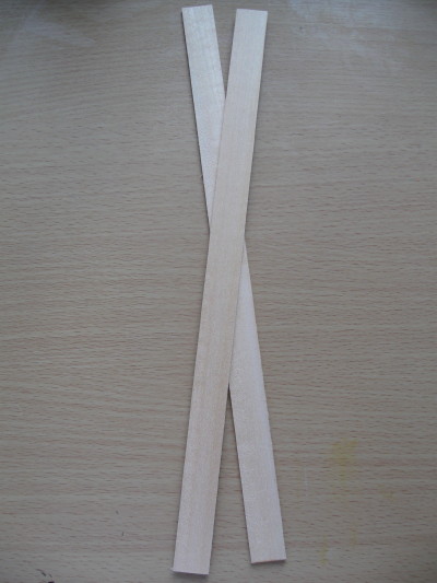

The bow planking is stepped back along the hull and will be shaped/angled to the correct height later on.
Don't level the 18mm wide side strips with the tops of the frames, (the decks drop into the hull rather than sit upon the side strips), when the decks are fitted the height of the side strips is then adjusted to suit.

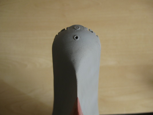

#26 Posted : 07 June 2010 10:33:21

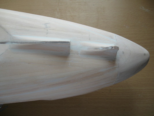

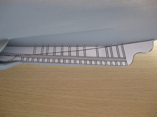

Angled fillet for the Keel added.
The hull is marked in readyness for use with hull profile templates, though its not possible to do the final profiling of the hull until the decks are in place where the deck line is then be profiled.

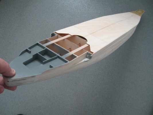

#27 Posted : 14 June 2010 11:52:16

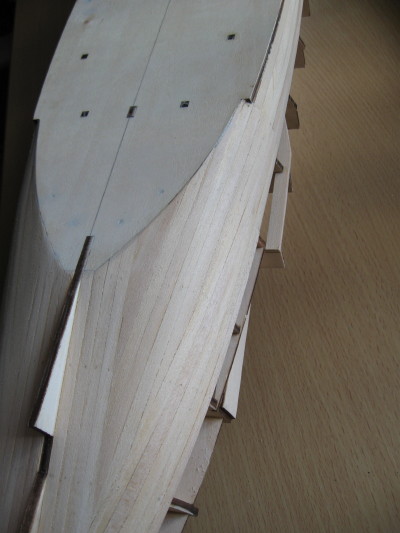

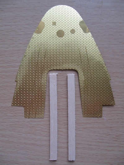

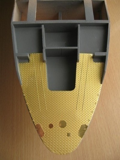

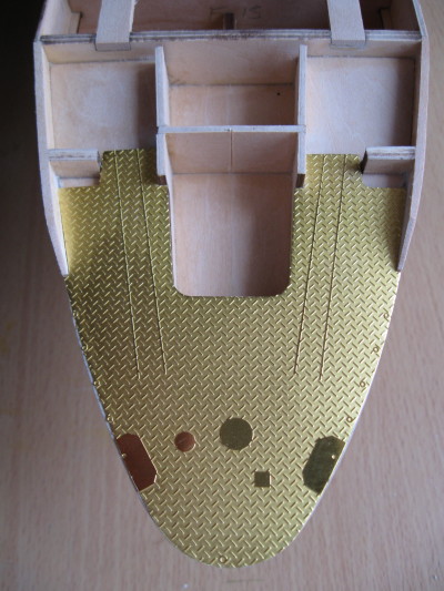

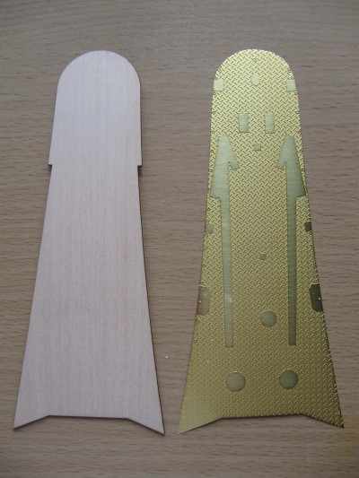

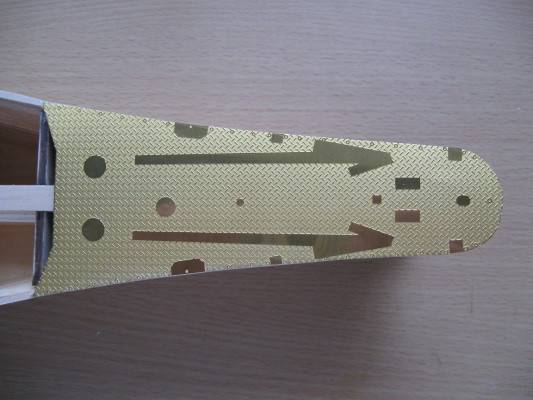

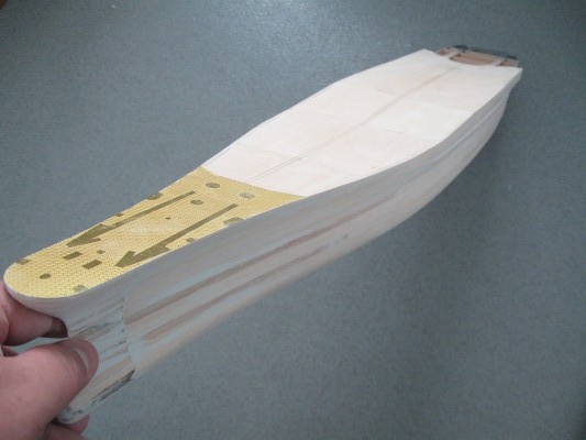

Fitting of the Bow and Stern deck plates.

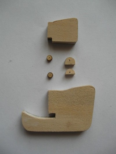

The bow deck plate sits on top of its ply base which in turn sits on top of the planked hull sides, though you'll need to mark the inside of hull sides with base and deck together to get the correct bow height/shape.
The bow block is tapered to follow the line of the deck slope backwards, later on the decks drop into the hull rather than sit upon the planked sides.
The Stern deck plate needs to be carefully trimmed to fit, and is easier to mark and trim if you do it before gluing the two wood side strips.

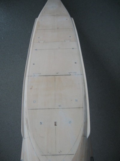

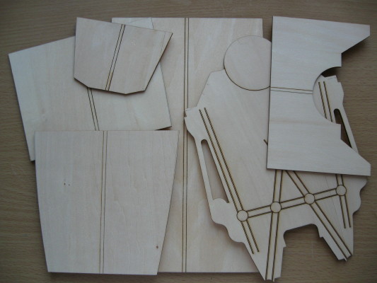

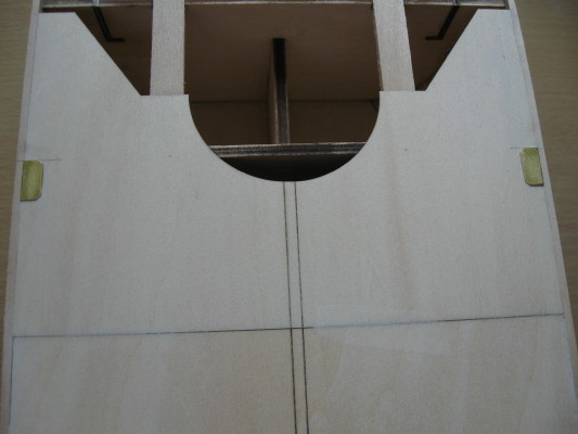

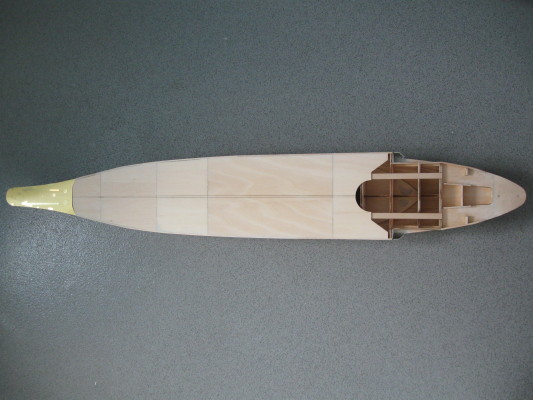

#28 Posted : 21 June 2010 12:09:57

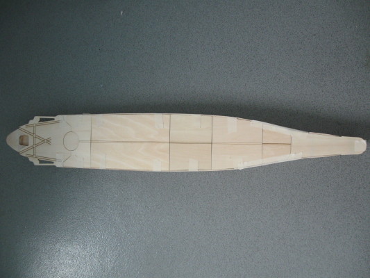

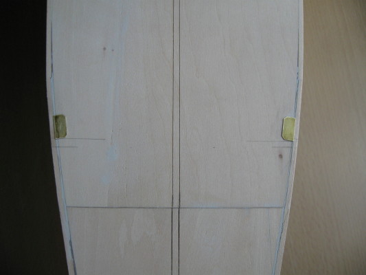

Fitting of the decks is straight forward, there is a central plank guide line which aids alignment, once the decks are in place the hull sides can then be adjusted to meet with the deck height of the deck.

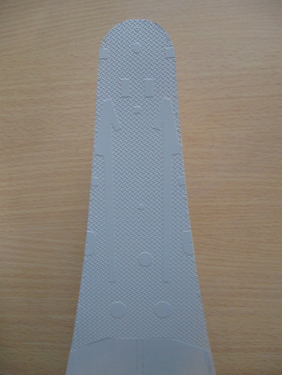

I left the stern aircraft deck off for now which will aid painting of the stern area, the forward deck was primed to prevent tarnish.
The hull is profiled to shape with the aid of the templates as a guide.

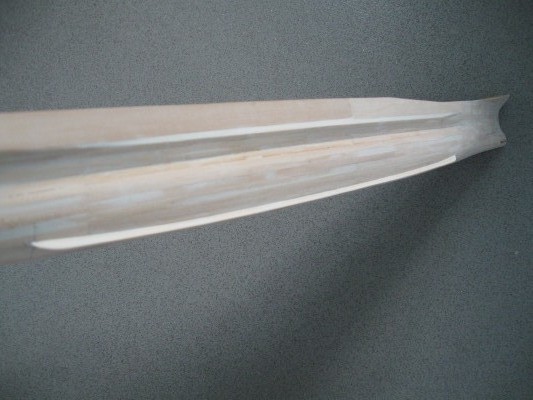

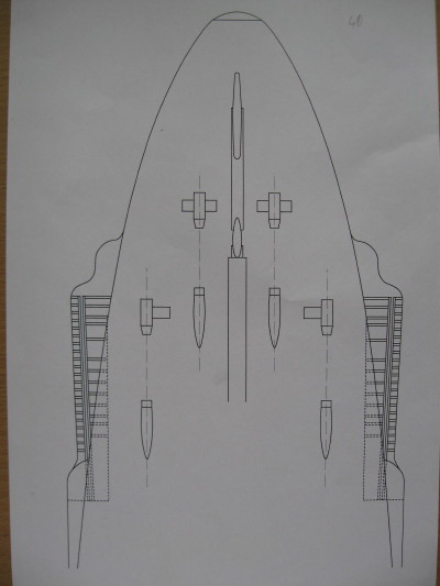

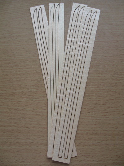

Laying of the Bilge Keels which are made up from thin laminated strips which are then shaped, port and starboard plans are provided for exact location.

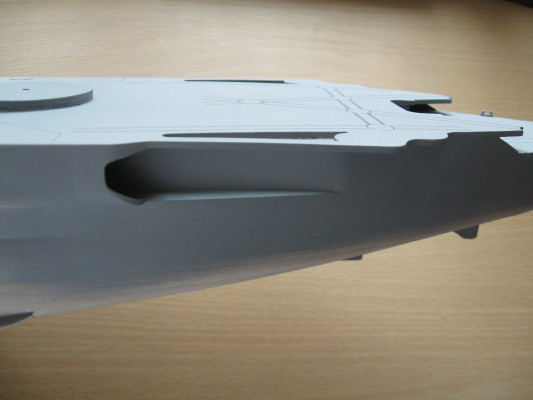

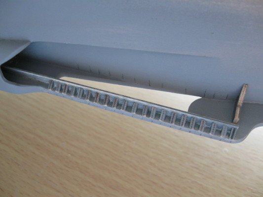

Interior of the stern hanger needs to be painted before the flight deck is installed.

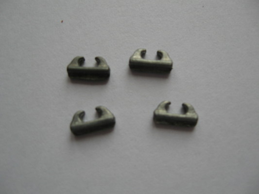

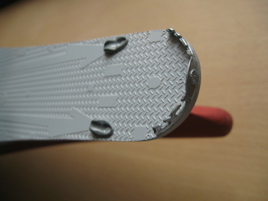

Stern deck plate secured and four Fairleads added.

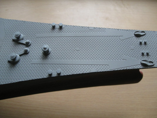

#32 Posted : 19 July 2010 12:50:44

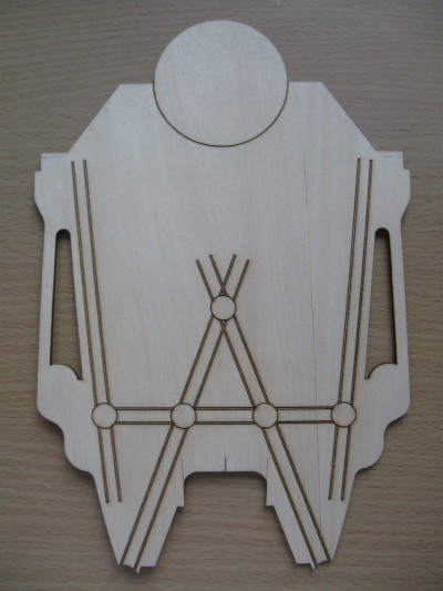

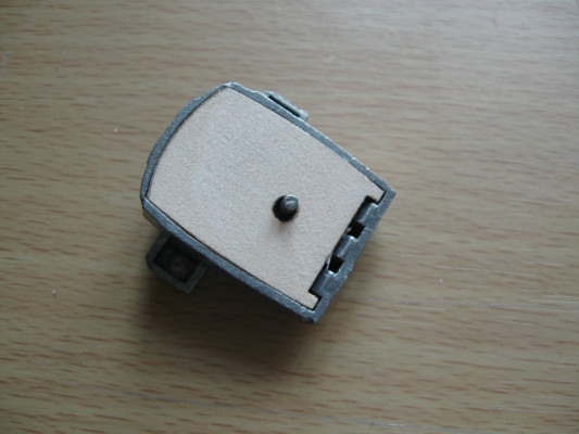

Aicraft deck set in place, crane bases added and the aft main turret base added.

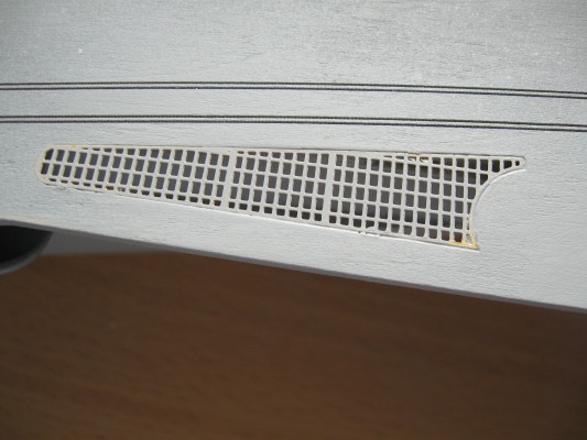

#33 Posted : 28 July 2010 10:23:34

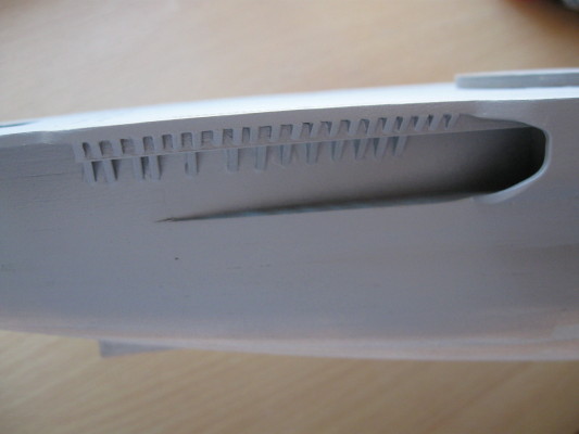

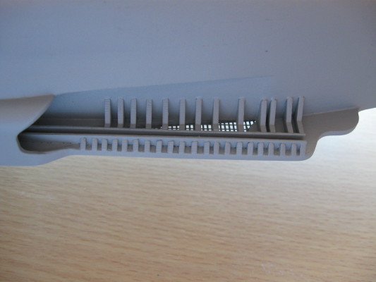

Boat hanger detail installed though no ships boats are included, its a straight forward task but needs patience, I plan to line the topside perimiter of both deck grates.
#34 Posted : 07 August 2010 13:36:36

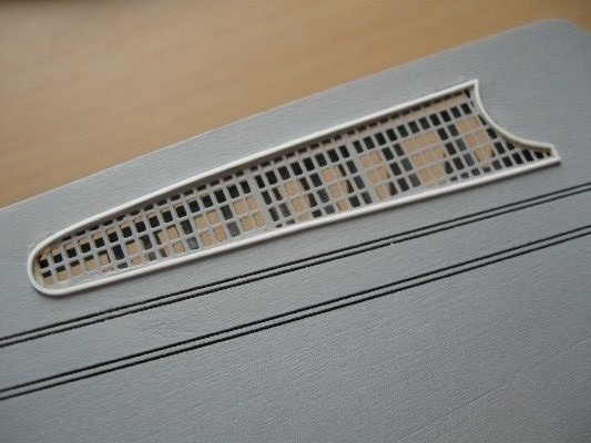

Aircraft deck rails added and I chose to add some edge lining around the two meshed sections.

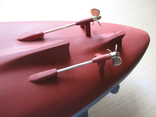

#35 Posted : 16 August 2010 12:54:53

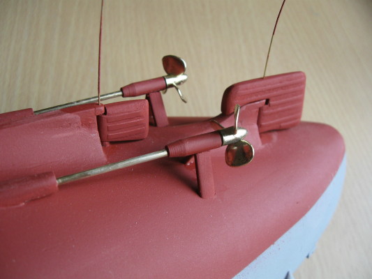

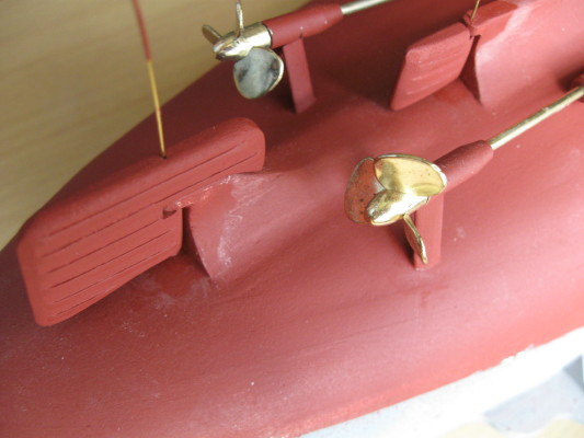

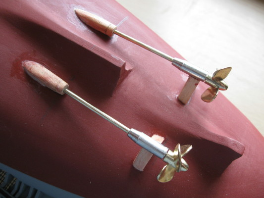

Inboard prop installation, will leave the outboard props until the two rudders have been placed.

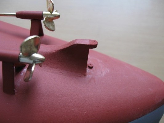

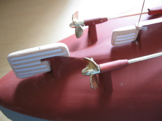

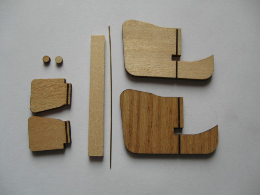

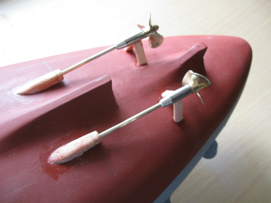

#36 Posted : 23 August 2010 13:35:37
Rudders formed from the ply blanks and vanes to the surfaces, will secure them permanently once the hull is finished.
#37 Posted : 31 August 2010 11:23:17

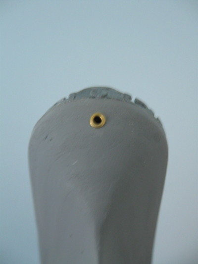

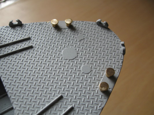

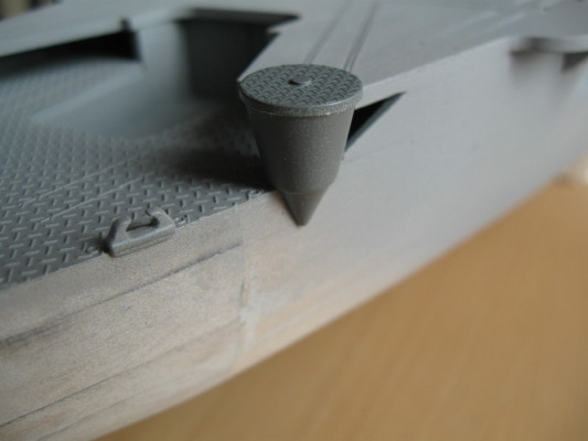

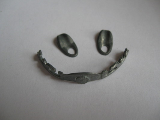

Bow details added, I found an eyelet better placed than using a wire ring.
#38 Posted : 06 September 2010 11:57:48

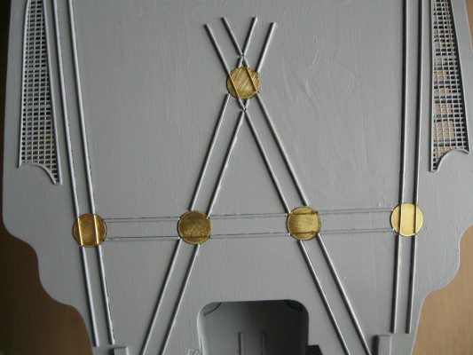

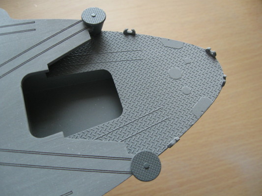

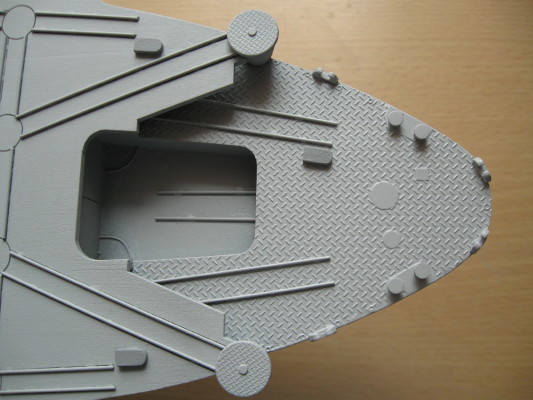

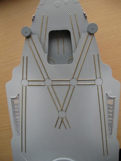

Placement of stern deck detail, bollards and airdeck turntables, wire track is cut and put onto the turntable plates.
#39 Posted : 13 September 2010 10:40:14

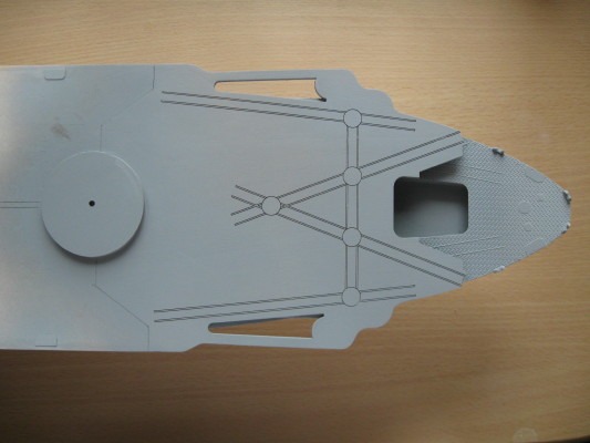

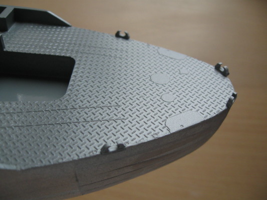

More bow deck detail added

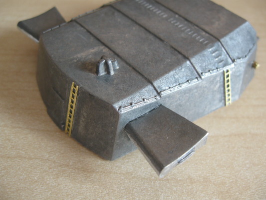

#40 Posted : 24 September 2010 15:07:30

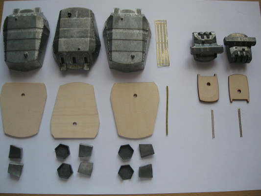

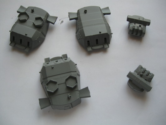

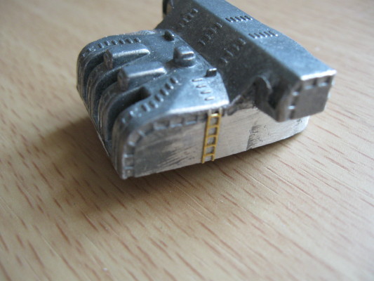

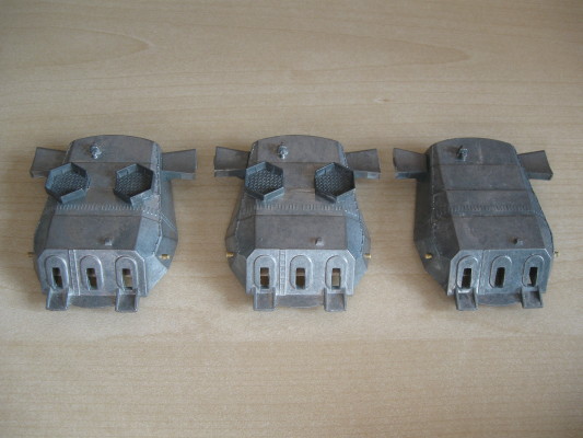

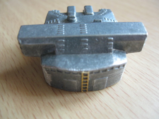

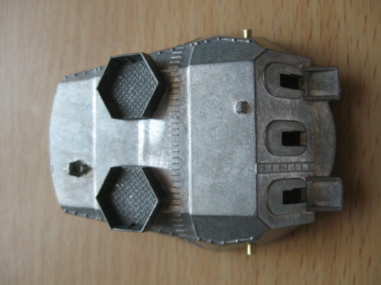

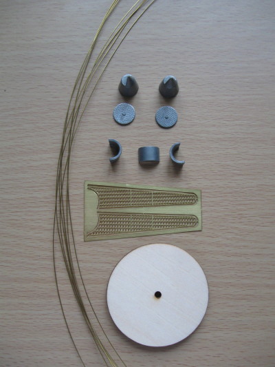

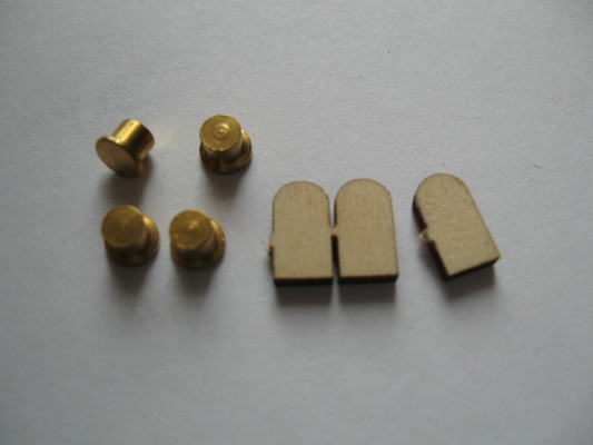

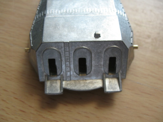

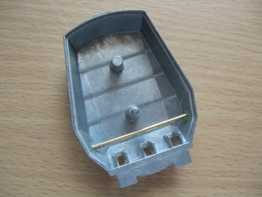

I little diversion from the Hull build to start with the build of the guns, two of the main gun turrets are identical, the third does not have gun positions on top of the turret.
I found it easier and better placement to use a full span of rod across each of main turets rather than locating bits of rod into the side holes.
The two smaller guns are identiacal, lateron all of these guns will have railings secured to there tops.
Photo-etched brass ladders are added for depth and all turrets primed ready for gun and railing placement later on.
