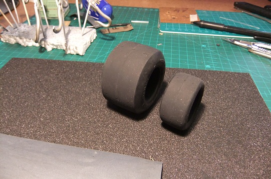

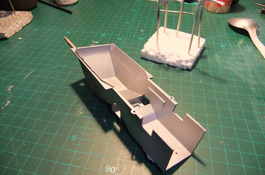

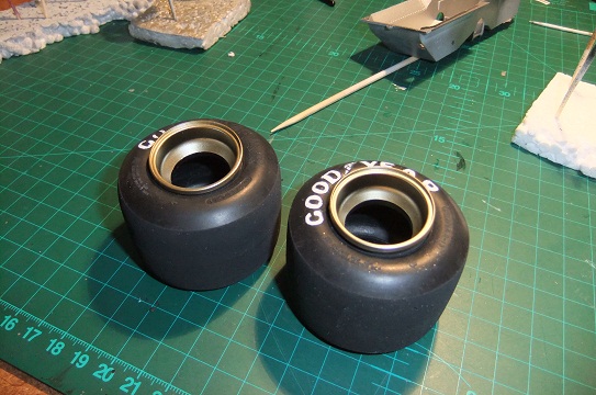

#21 Posted : 25 May 2014 16:21:48

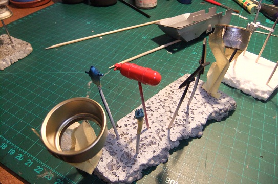

Making a start on the monocoque. Sprayed up a few parts.
Also steadied the hands for a bit of tyre painting !
#22 Posted : 25 May 2014 18:12:30
Looking good. Love those tyres, I take it they are rubber?
#23 Posted : 26 May 2014 17:21:29
Thanks for the comments. Yes they're the standard tyres that come with the kit.

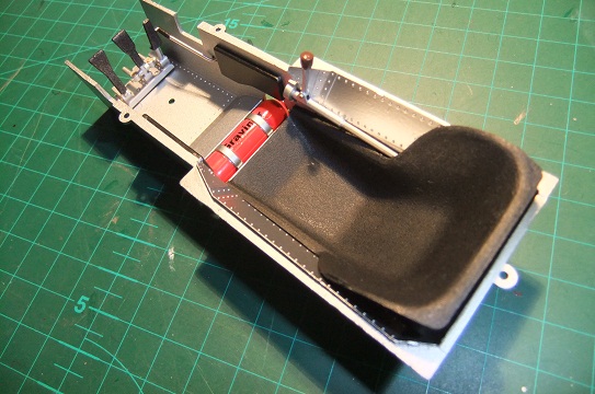

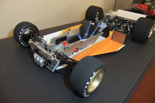

#24 Posted : 08 June 2014 16:54:12

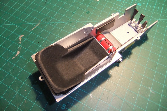

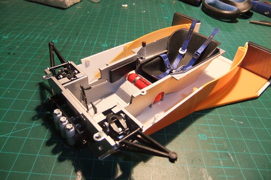

Managed to get some work done on the cockpit. I added branding to the fire extinguisher and a throttle cable (An old D string from my guitar )BigGrin

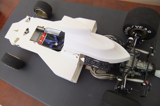

#25 Posted : 06 July 2014 13:26:21

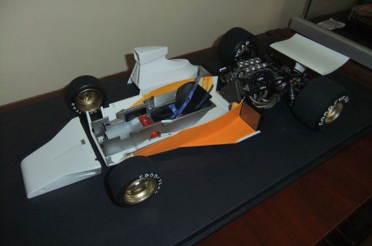

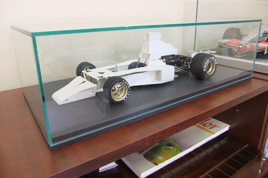

Got the display case organised and arranged the parts so far to make sure the fit is okBigGrin
#26 Posted : 06 July 2014 13:31:21

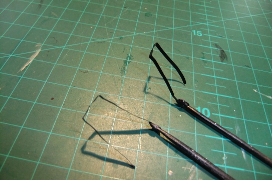

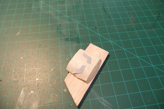

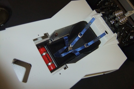

I've added the safety harness and decided to try and produce a couple of anchor points onto the body rather than just gluing to the top of the seat as it shows in the instructions.
Not sure how to do that yetMellow

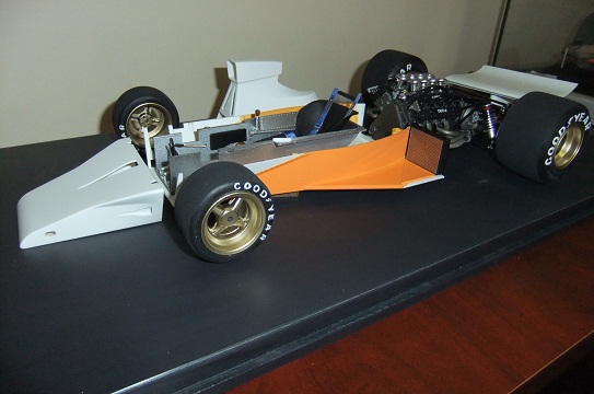

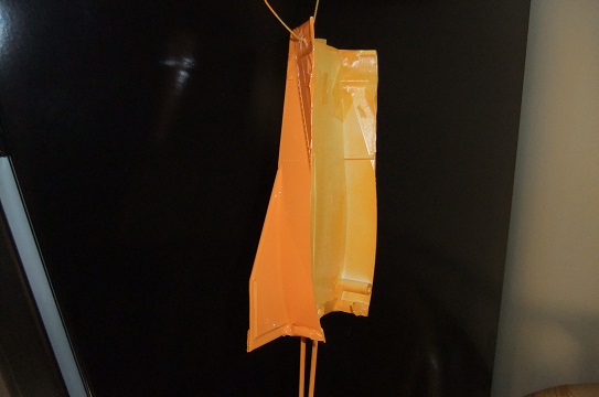

#27 Posted : 03 August 2014 17:03:04
Time to add a bit of colour to the lower body section.
Tamiya spray can and a lot of masking tape.
Happy with the resultBigGrin

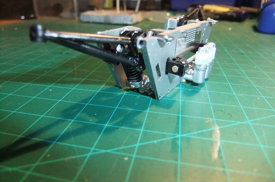

#33 Posted : 04 October 2014 20:02:18

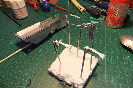

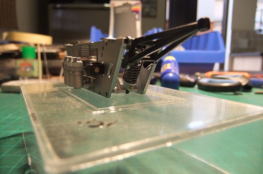

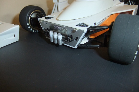

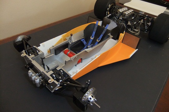

Got time to do some work on the front suspension. Used the same paint and decal treatment on the shocks as for the rear.
The fit of the complete unit into the underpan is not great and it looks like the thin upright body sections at the front will need a bit of bending when I finally bond the suspension unit in place.

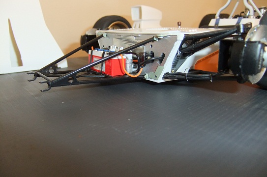

#34 Posted : 19 October 2014 14:57:05
Front hubs done and attachedBigGrin

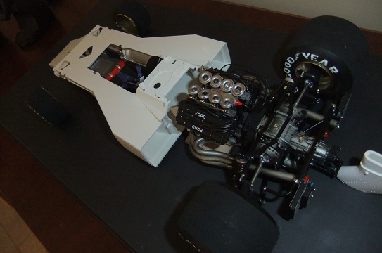

#35 Posted : 19 October 2014 16:23:40
I've used some thin electrical wire with the strands pulled out to add hose detail from the master cylinders to the front calipers and for the clutch.

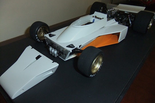

#38 Posted : 08 November 2014 14:48:01

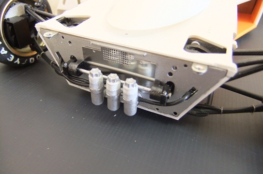

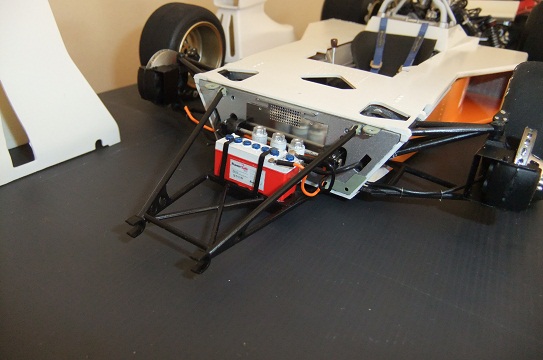

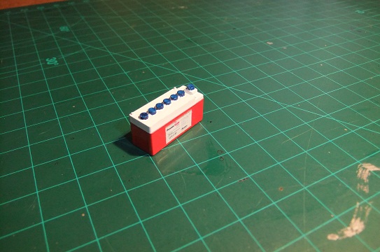

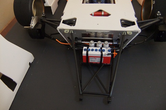

The battery that comes with the kit has a row of screw caps to top up the electrolyte. The only pictures I could find show a sealed type, which I guess is the more sensible option for racing. I'm not sure if they were available back in 1973.
Anyway I added some colour and made an "Enersys" decal to give some detail. BigGrin
The straps are cut from 80 micron steel. A little fiddly but it turned out ok.
The wiring is still in progress but I've taken some electrical wire and made a terminal connector. I'll finish that after I've attached the nose support frame.
#39 Posted : 08 November 2014 14:56:48

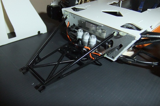

The body on the M23 is an Aluminium construction but contains a fair amount of steel fabrication around the front bulkhead. Images of the car show that the exposed steel parts were painted a greenish colour. Most likely for corrosion protection.
I cut a couple of steel plates and added them after painting with Tamiya XF 76, grey green. Also used it on the clevis mounts for the nose cone frame and the brackets that are provided to take the screws that hold the nose cone.BigGrin
