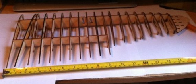

Anyway it`s update time as I received my second delivery today.
Cool Cool Cool Cool Cool Cool Cool Cool Cool
So here goes.

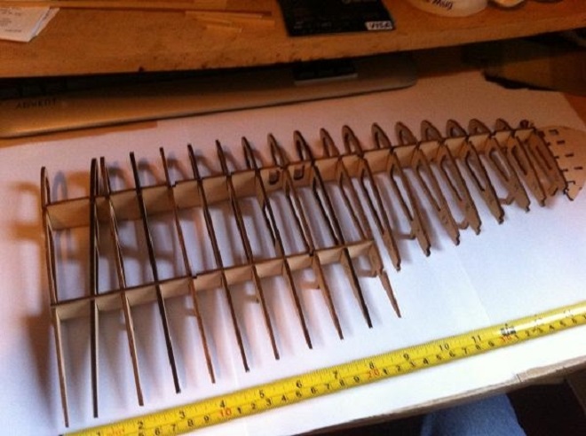

Received my freebie Messerschmitt Bf109 F4 (Pic 1)

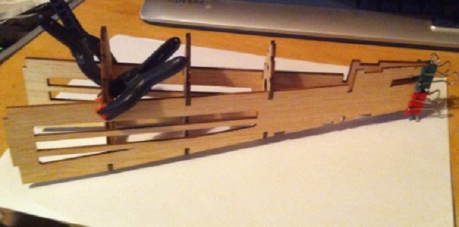

The previous issues left one end of the frame open awaiting an intermediary frame to be inserted and then the end frame needed closing.

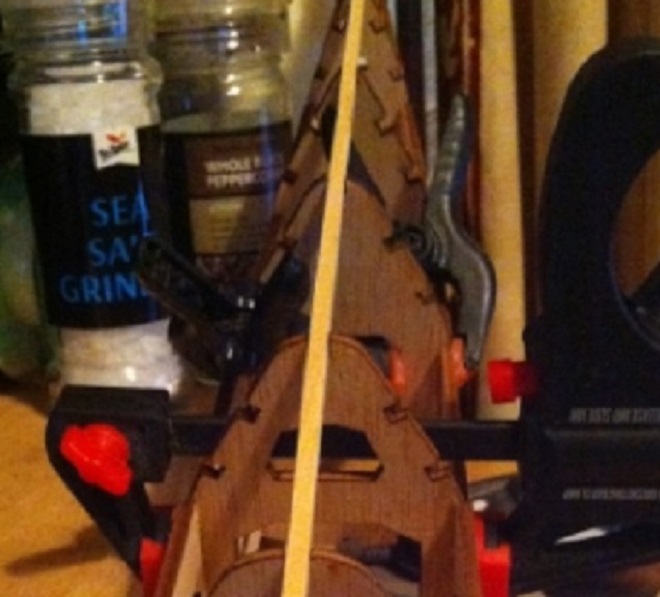

A further end frame is then inserted. (Pic 2)

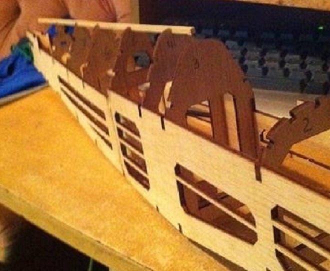

It was at this point, that while things were setting I had a thought.
(Rare, but they do happen LOL )
Bob`s build ended up with the tail end twisted (hope you`ve managed to sort it Bob), so before proceeding I went for a total dry fit of the tail end .
a: To see how things went together.
b: To work out the best method of clamping it all together.
c: To give a final check to see if the top stringer would fit in all the
relevant notches in the frames.

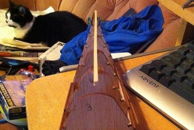

The dry fit:(Pic 3)

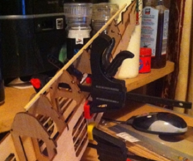

Then the check for straightness (all dry fit at moment)(Pic 4)
and it all appears straight Cool(Pic 5)
Well that`s all for today.
There`s more to follow when this lot is all finally glued together, so will update soon.

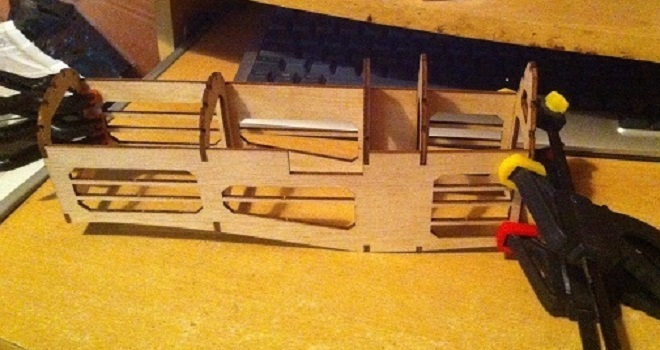

Hi All,BigGrin BigGrin
Well It`s been a little while for an update on this one.Crying
Hit a major snag or so I thought.Confused
At last look, I had a curve of sorts between the centre fuselage and tail section and a radial twist within the centre fuselage section.Cursing
I was looking at the time of the last post, that I would need a complete strip back to the beginning.Crying Crying Crying Crying
My decision to take a step away from this build for a time proved to be a blessing in disguise.
Having finished my cannon dio build a couple of days ago, I returned to the Spitfire.
The result was quick and well worth the delay.BigGrin BigGrin
I very carefully removed the centre fuselage from the tail section, then removed the frame number 5 at the point they joined together.
What I found next was a real eye opener.
The major side slots of frame 5 were not straight.
The solution turned out to be as follows:
Flatten the side slots of frame 5, little by little and clamp things back together as a dry fit.
To start with things didn`t seem to change, then suddenly hit a point where things took a change.
After several dry clampings I found that things seemed to have straightened out in both areas that I had a problem.
This is the end result after glueing and a final clamp session that was then given 36 hours to set.(See pics below)
This issue over I am now looking forward to getting back to this build.
The major thing I`ve learnt is that it sometimes pays to leave things for a while and come back to them later. Blushing

Blink Hi Del
Just an observation and it may just be the picture angle but on post 28 last picture it looks like formers 7/8 still have a slight twist to the right and back to the left. Maybe just the angle and I hope Im wrong
