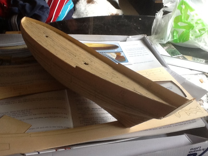

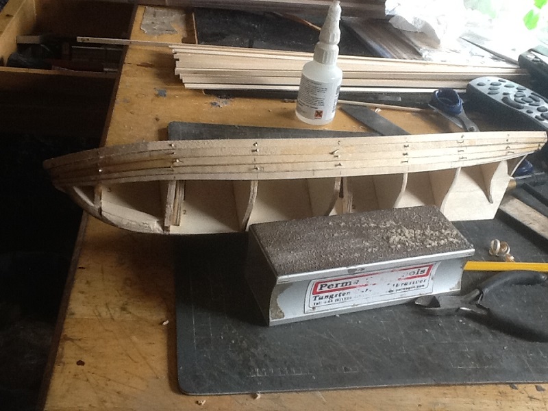

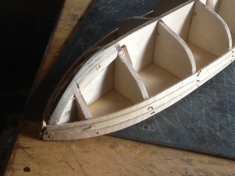

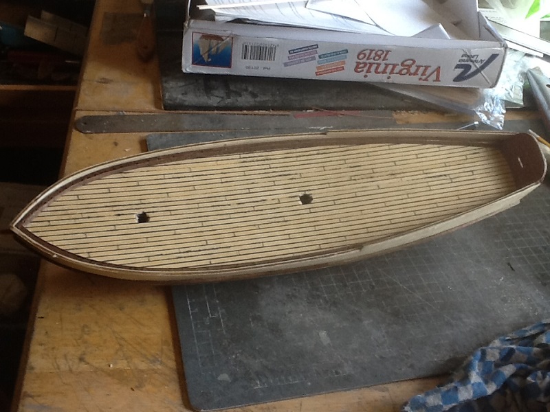

It sure does jase,so the planking has started,the first plank laid if for spacing only,the gunwales are fitted last to this gap after removing first plank.at this stage it's worth looking at the overall shape of the hull,the bow and stern sections have a smaller area then the centre of the hull so reducing the next lot of planks is nessessary.I have tapered the next plank 3 formers in at the bow,and 3 formers in at the stern.the amount of tapering is governed by the shipyards rules of 1/2 width tapering to nothing,so you don't get pointed bit of planking,so far no stealers have been used,but will say if I need to use them.

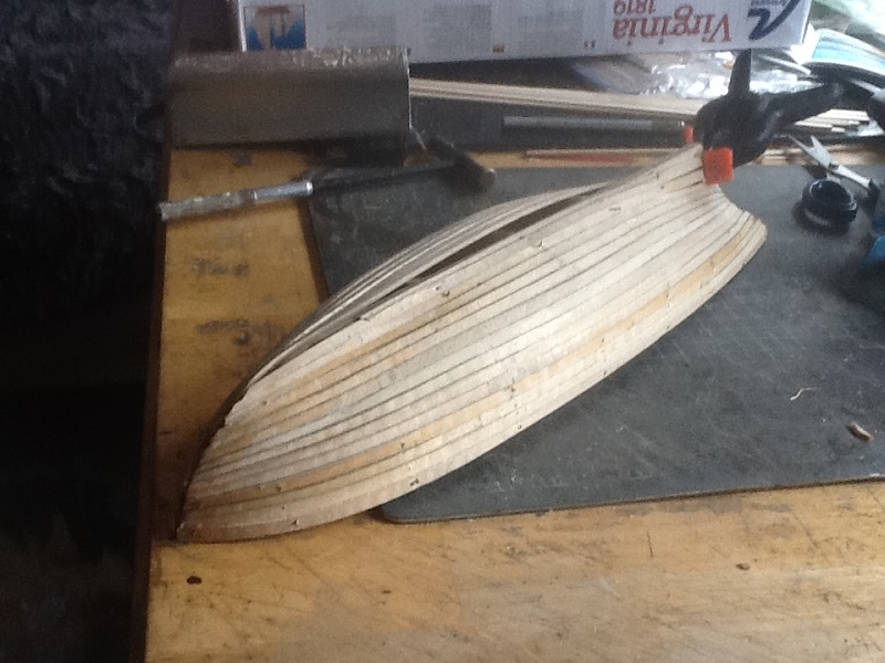

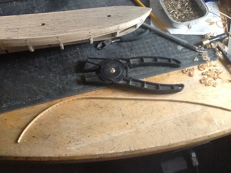

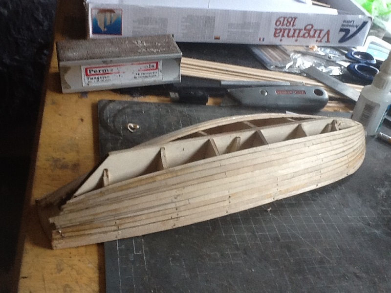

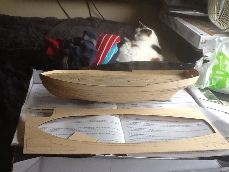

as you can see,I used the crimper type plank bender,and soaked each plank for 30 seconds,because this is a small boat,I have use medium superglue for the fixing agent.had it been a larger vessel,I would have use aliphatic glue.I also bevel each plank to get a nice tight fit,and having soaked the planks I can twist them to stop the clinkering effect.total build time to date 13 hours.

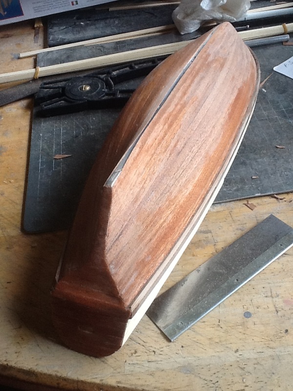

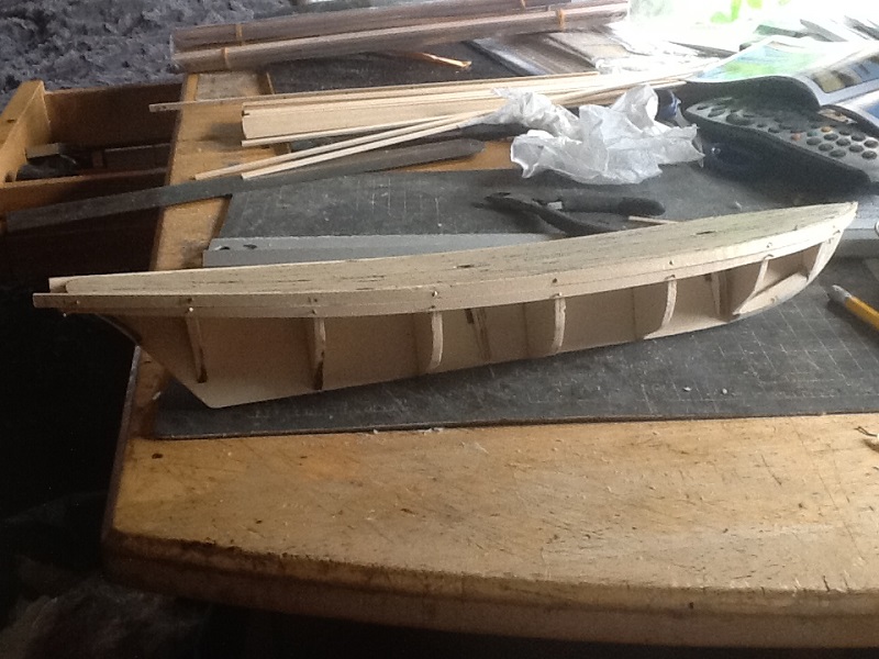

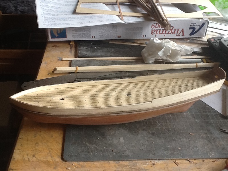

that's the first layer done,just the sanding down to do .before I start the second layer,I have to put a couple of coats of shellac sanding cleaner.

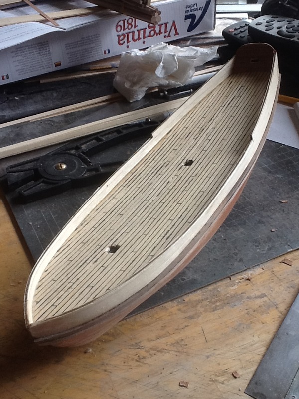

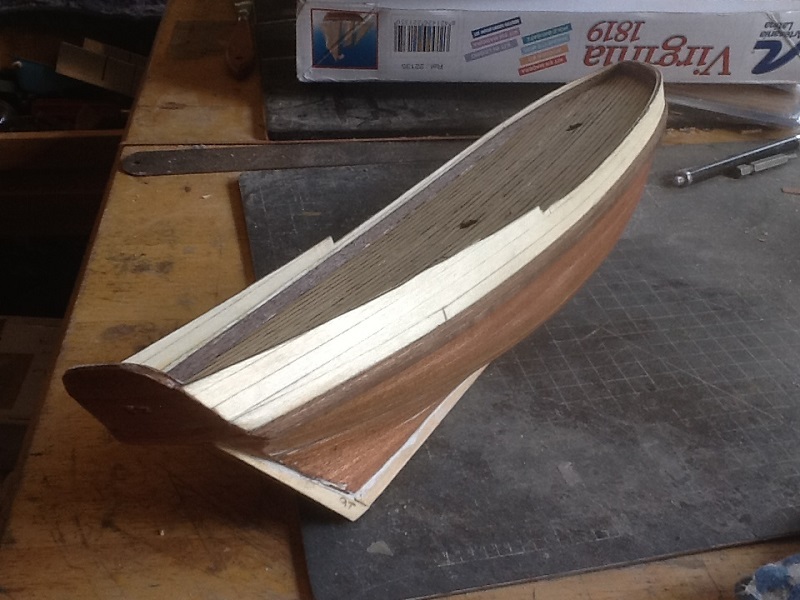

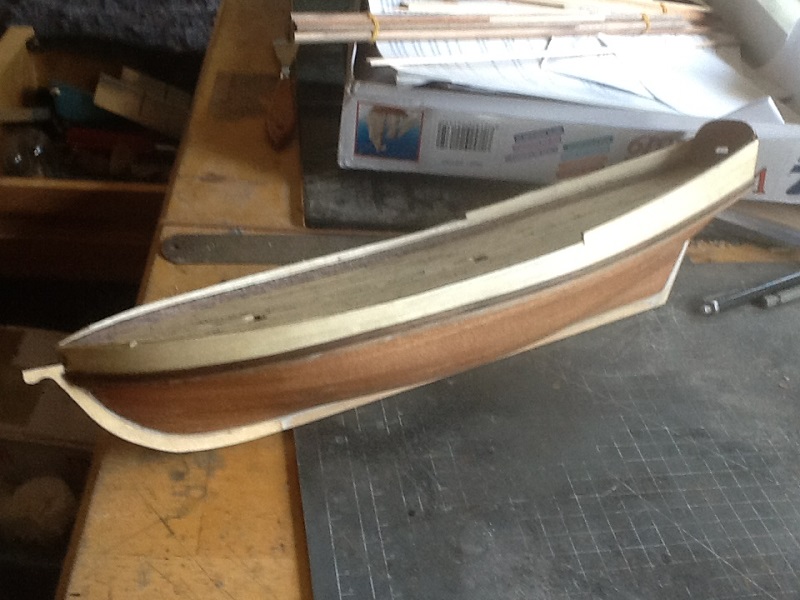

with the second layer of planking done,I then glued the wales.the rudder post,false keel and tiller to do next. 20 build hours to date.

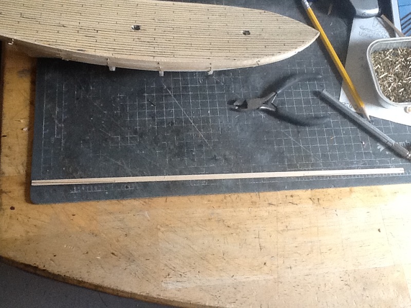

two coats of shellac sanding sealer, inner rail supports fitted,and false keels fitted.
