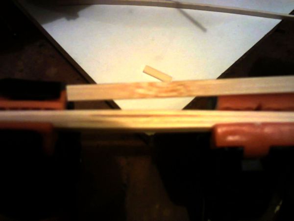

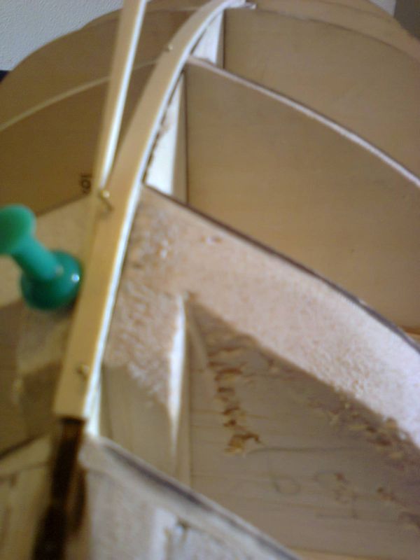

Its time to prep for the first layer of planking. This is a crucial stage that can effect the final look of your model.
Blink Been made aware of the flaws in Bamboo, I scrutinised my supplies of planking. Almost a quarter of one issue has flaws .
The pic highlight the flaws that the knots in bamboo causes.

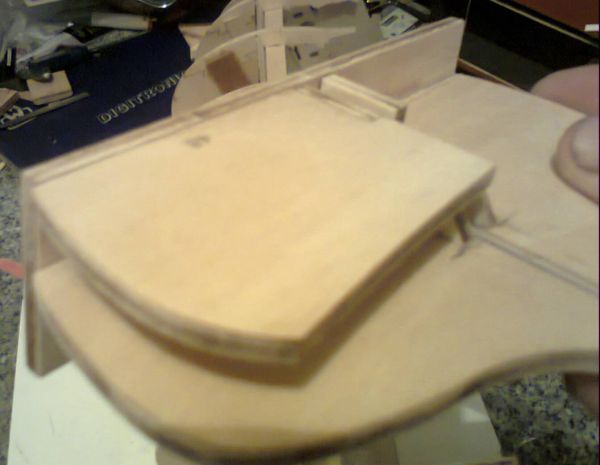

Part #24 filed down
Its a pain in the butt to get part #24 shamfered to specs. I used a fine rasp and file on this taking care not to damage the other parts.

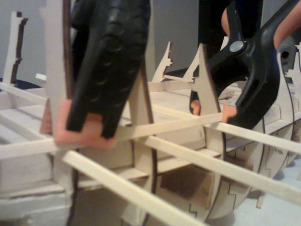

I left the 2nd deck for later to make it easier to fit clamps in those akward spaces. I want to achieve a mirror image on the Port-side, using spacers across.BigGrin
To get a clean line for the gun ports, I align the bow plank with my 1st deck plate. I hope it turns out well.Glare

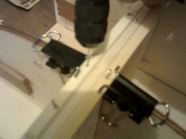

I fitted a 4mm guide to assit with the firt planks. After carefull measurement I laid the first 3 planks and set to dry.

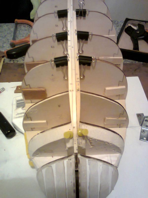

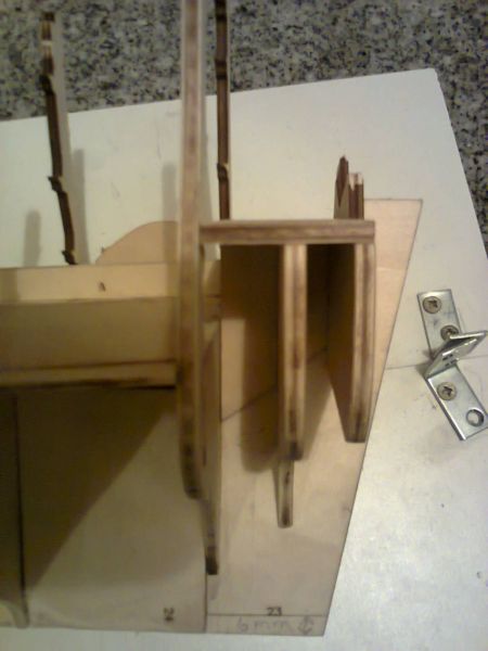

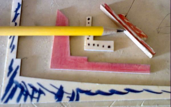

I have sorted out my problem with the ribs. I looked into the Italian forum (click to follw link) to get a better understanding of the gun ports location.
It make sense to make notes of the position of the ribs's upright position as you plank the bulk. This can help you to avoid cutting into the ribs when marking out the ports.
Its a good idea to draw the rib lines as you plank and write it down with a sketch of it. Cool If your ribs might be mis-aligned, you know exactly where they are. If you had to rely on guesswork of the rib's location, you are likely to cut into it.
Blink I took extra precaution and pinned the gunport planks for extra support (a tip I picked up from a build in this forum). The glue alone might not be strong enough when cutting out the ports. I sanded down the laser-ash for better bonding of the glue (PVA).
To get into those tight spots I made a small sanding block from the wood of the die. A handy 90 degree square-tool came out of the die. It helps to search your immediate surroundings to find solutions.

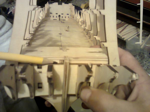

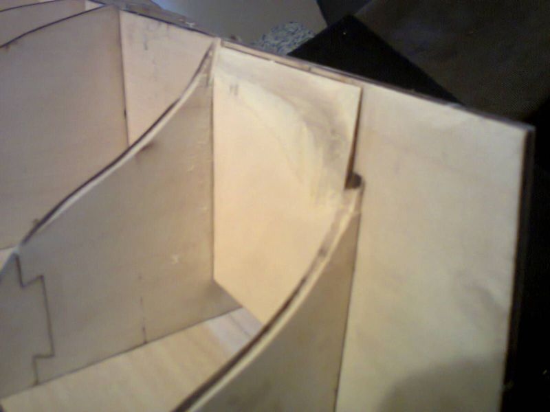

Another confusing step in Issue 15

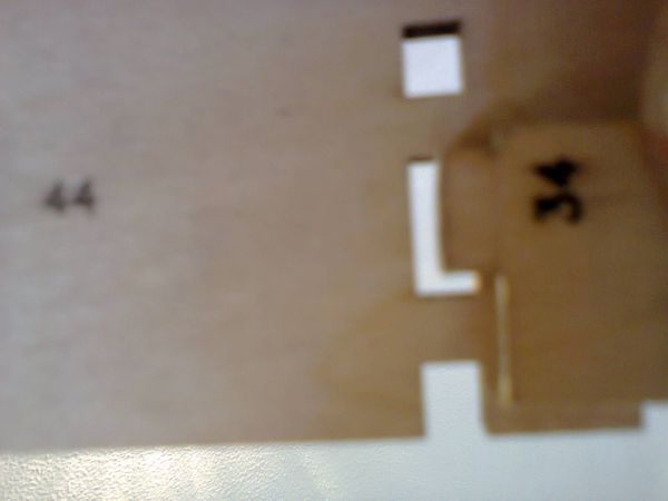

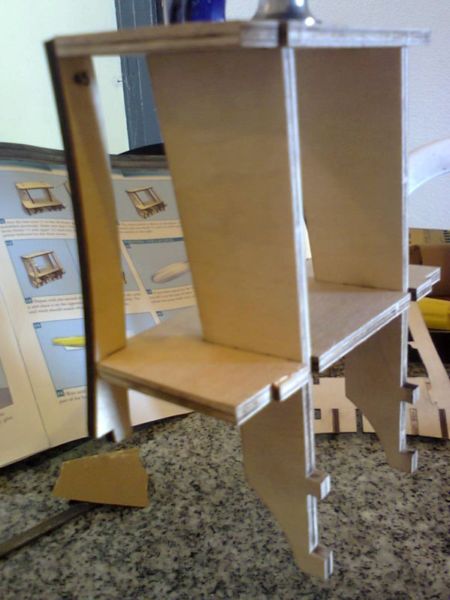

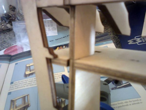

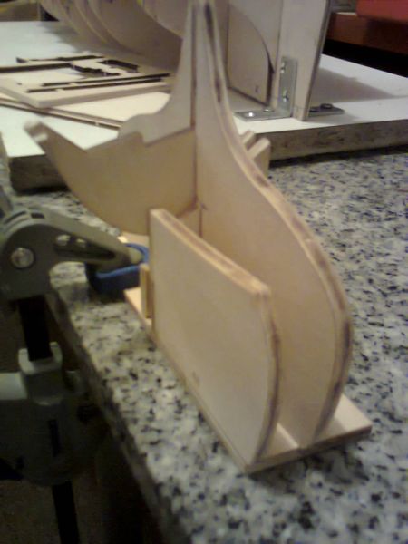

Confused Glue part #34 to part #44. The slots in 44, where 34 goes into, are wider than the struds (view attached picture).Blink
To solve this, I took all the parts and fitted them dry into place; marked the correct location and glued them together.

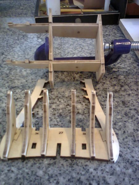

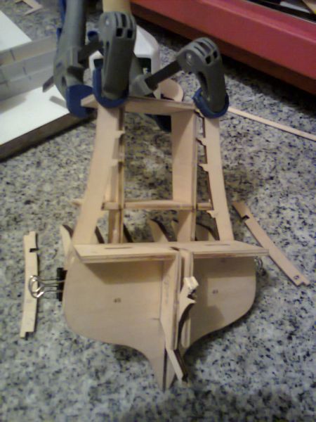

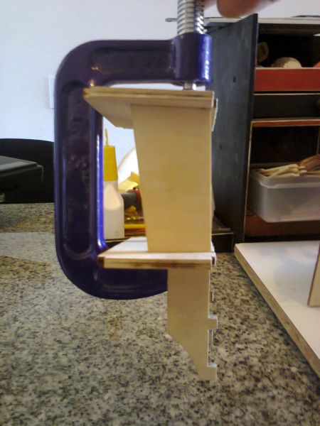

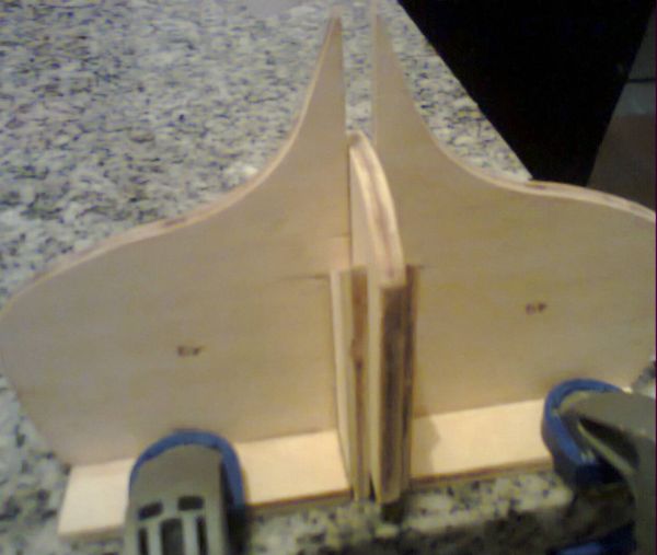

Assembling Stern set 27
Issue 15
Blink

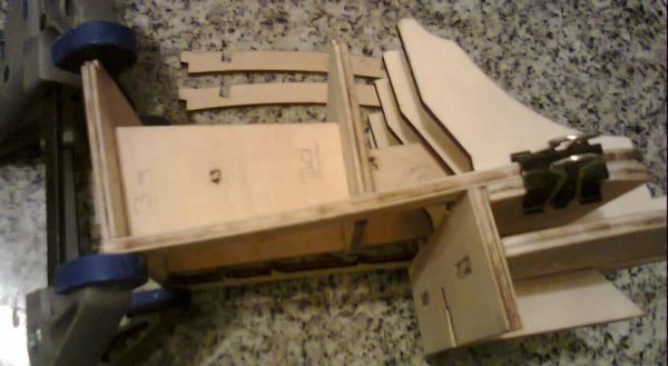

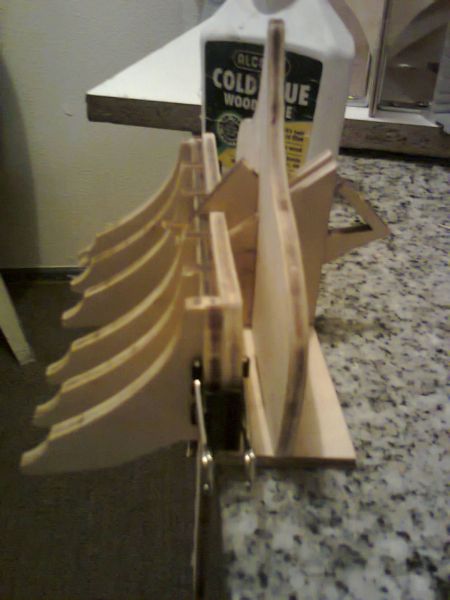

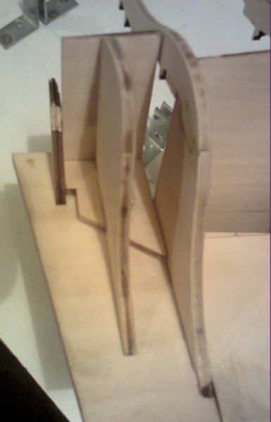

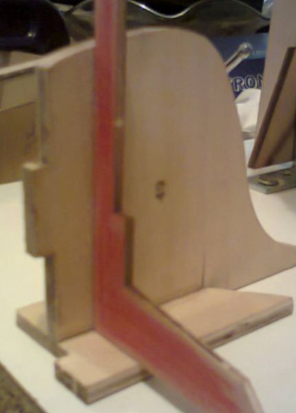

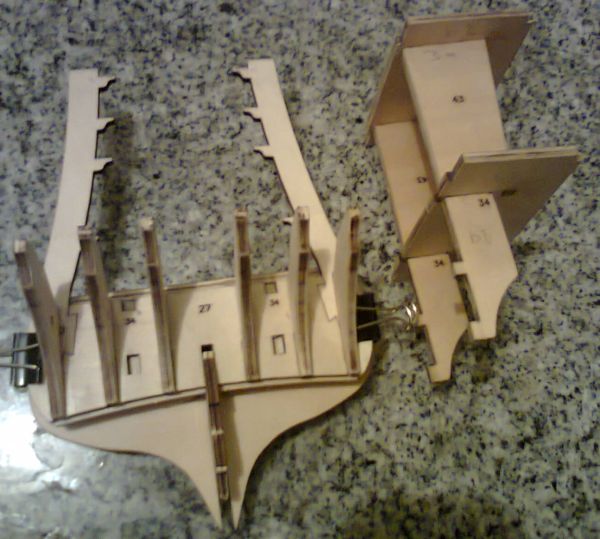

To ensure a snug fit of all the parts and proper alignment of rib #27, I went a total different route to finish the stern-set.
After I glued the two brackets #34 onto the stern lower deck #44 (instruction Step 1-2), I turned the lower deck around and glued struts #43 onto lower deck #44 using rib #27, previous assembled and set aside, as a guide.
Issue 16;
I took the supporting pieces #46 and glued it to the half frame #49 as indicated in step 5. After the glue dried, I glued the half frames onto the stern deck extension #47 after taking measurements dry-fitted to the keel. I took the brace pieces #48 and glued it, as indicated, to part #47 so that it sits flush with the end of the deck extension.
I have now 3 different assembled pieces, rib #27, stern extension #43 and the half frame #49. The next step is to glue rib #27 to the half frame #49 and set to dry. The stern extension #43 was now glued into place followed by the two rear struts #45. The notches had to be slightly chamfered for a snug fit.
