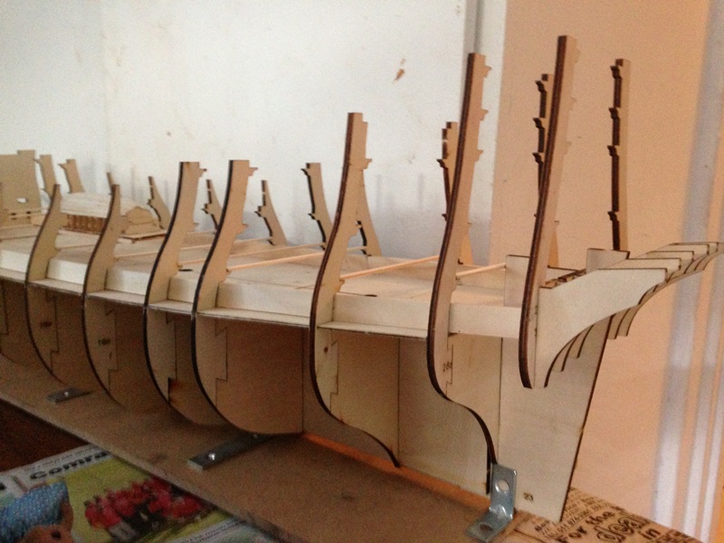

Below Pictures are for Marcel wanting the side views
I think this is best as I can get it..

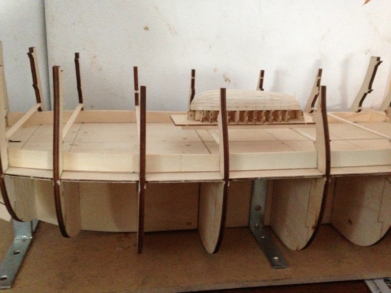

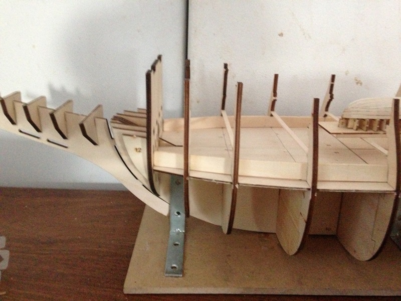

I am up to issue 12 so far and working on it. Here are a few pictures of the ship so far..
let me know your thoughts and more importantly, how are you coming along with the same parts...
1st pic: Top view of the ship
2nd pic: Started building the launch. this has proved to be very challenging because of the hull planking. This is the first time for me.
3rd pic: Adding in the sides on top of the lower deck. This was a challenge because of the bending required to get the side to fit into the ribs frames correctly.
4th pic: top view of the lower deck with sides
5th pic: Sides being clamped in. I left the clamps on for 2 days because of the bending required
I found steaming the side planks using the ketlle, while making a cup of coffee, softens the wood which I then set in position without glue to dry. This pre-form the shape of the plank and allowa it to sseat neat in place, taking out the strain of the plank.

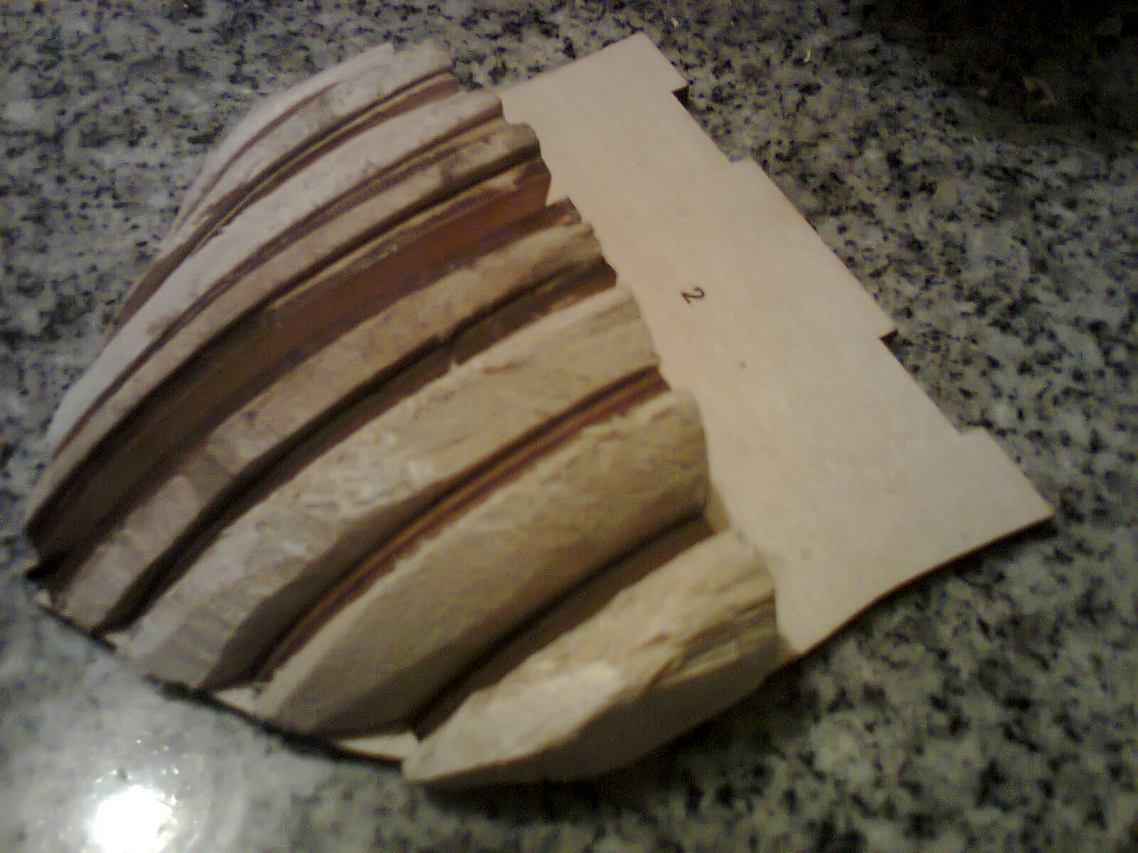

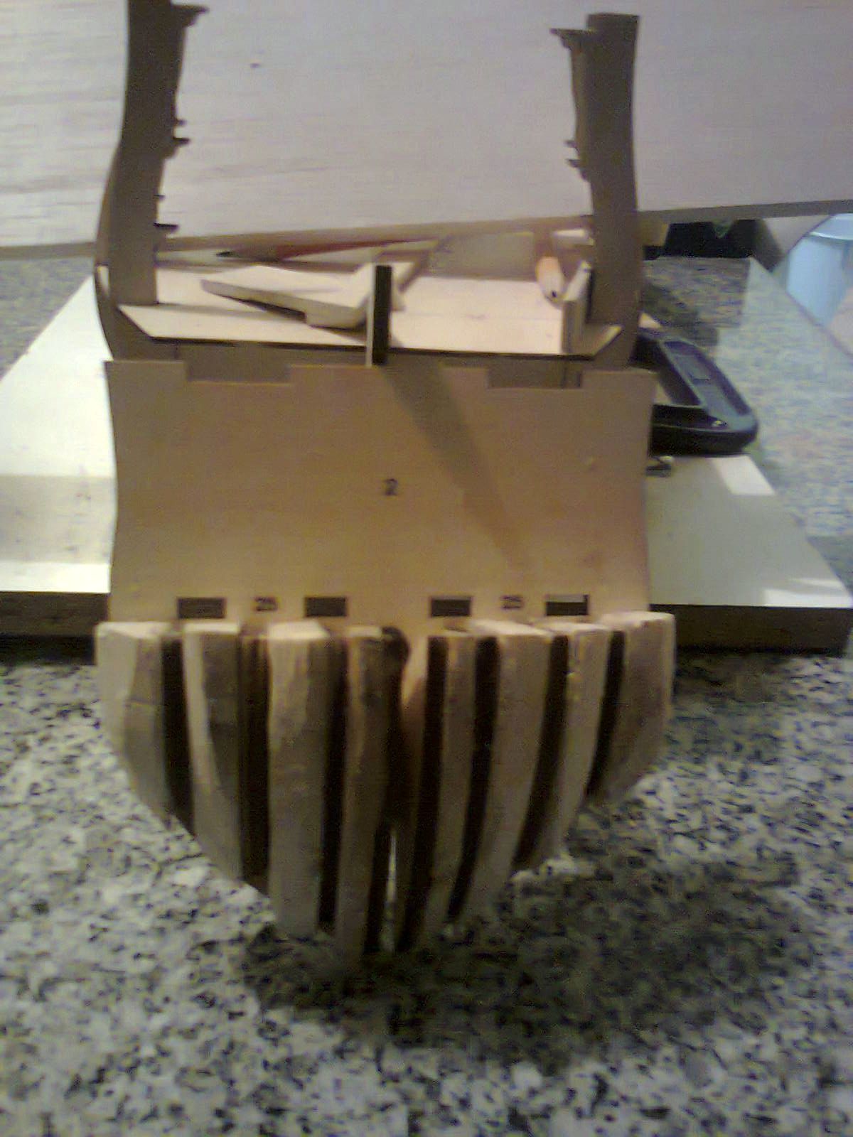

I will advise you to use the Balsa wood filler in the front of bow
Marcel attached the following image(s):

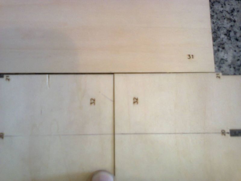

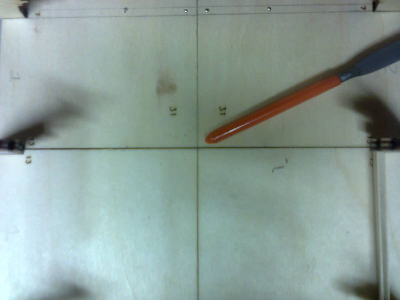

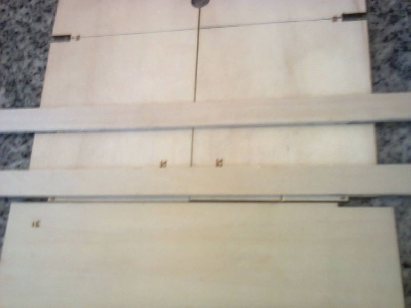

I noticed that the deck planks are not align with the rest of the deck planks. With a bit of tweaking with sand paper it was sorted.
This is a crucial stage to perferctly align and space the ribs to the false keel to avoid nasty gaps Cursing when start planking the hull.

Thanks for the pics. It solves a lot of my worries.
I can give you a tip... I also made the same "mistake" as you as to glue the deck planks wth the guide numbers facing up. Make sure to use the blank side up in the next deck layer to avoid it sticking out like a sore thumb.
