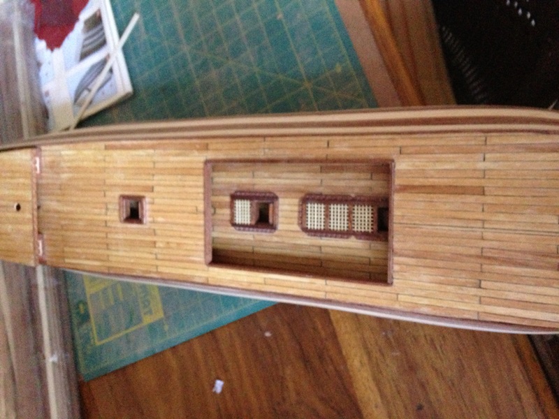

#32 Posted : 08 August 2013 14:18:50
Joined: 25/04/2013
Posts: 71
Points: 216
Location: Benoni, South Africa

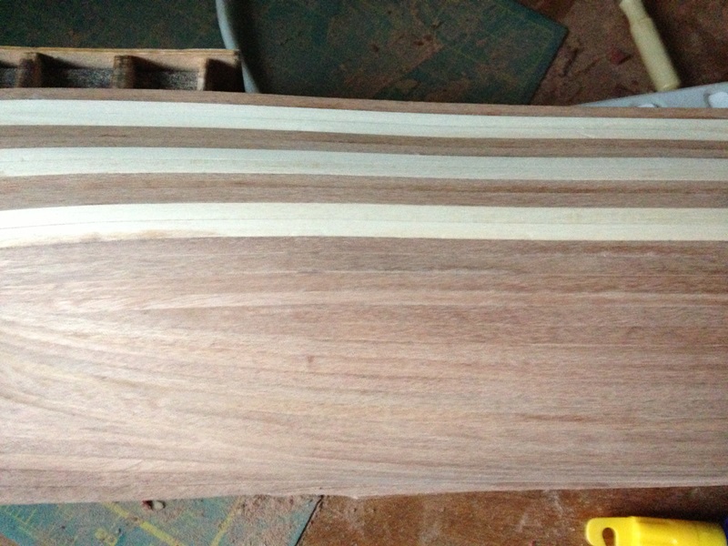

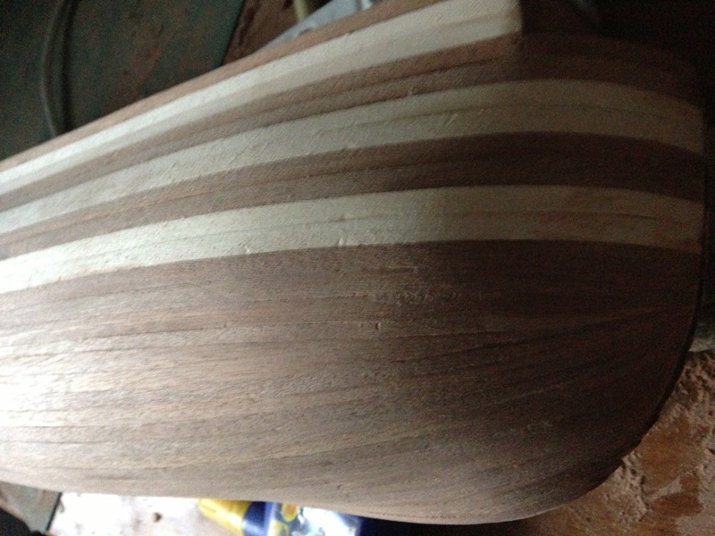

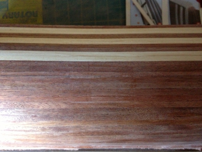

I have been extremely worried about the steps in the planks, but after the first rough sanding, they have gone.
Attached pics of the first sanding/filling with sawdust from the sand.
I have been using a mouse sander for most of the ship but the corners at the stern have proved difficult here, so its back to manual snading for this. Cursing
I want to try get most of the small dents out of the wood with this sand (used a 60/80 grit sandpaper).
Now its done to a 120/140 grit for a mid sanding and then finally onto a 200 grit paper.
Anyone have any ideas for this?

#33 Posted : 08 August 2013 18:22:55
Posts: 2,083
Points: 6,244
Hi Cuan.
See! Now that's a hull to be proud of! Well done! Cool
(These double-planked hull boys don't know what planking is until they've done a Constructo big-thick-planked job!) LOL BigGrin Flapper
Well done again!
Robin

#34 Posted : 08 August 2013 20:53:18
Joined: 25/04/2013
Posts: 71
Points: 216
BigGrin
serious stuff!BigGrin
I am looking forward to this coming out nicely now.
Robin, I am looking at keeping the wood natural. I am not keen to paint the ship as per the real VICTORY, but rather just light and darker wood variants.
What do you suggest?
Cheers

#35 Posted : 08 August 2013 22:11:42
Posts: 2,083
Points: 6,244
Hi Cuan.
As you can see from my own build diary, (DelPrado 1/100 Victory) my own personal taste is that you can't beat a Victory in her 'proper' colours! I must admit though that Bernd's 'natural wood' Vic is an absolute masterpiece to look at and my own Constructo "Grimsby" 12 Gun 'Frigate' was made up in her natural wood too.
In her case I used a clear sanding sealer on the deck veneer and the hull and masts were varnished with an acryllic semi-matt or eggshell finish clear varnish. Having gone to all that trouble with the light wood strips for the gun deck sides it would really be a shame to paint over it afterwards.
I would go with the clear varnish with possibly a woodstain to give the hull below the waterline a different shade to the main hull and also perhaps on the cannon carriages and other deck fittings to pick them out from the mass of the hull colour too.
Hope this helps, but I think she's going to look beautiful whichever way you go if the rest is built to the same standard as the hull!
Best of Luck
Robin

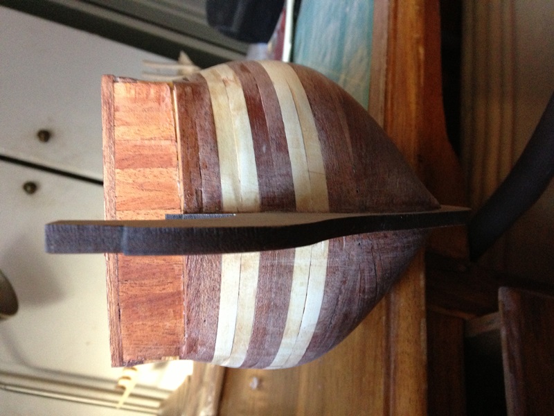

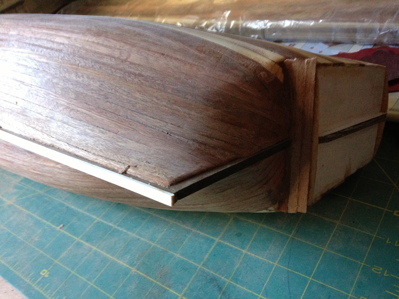

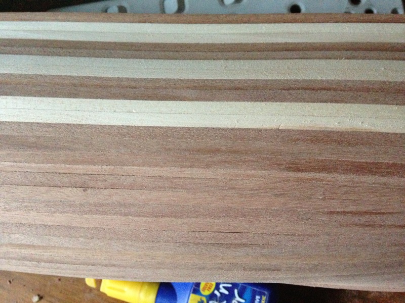

Still busy with the planking. There are a few fillings I still need to do, especially on the bow and stern areas, but its coming on.
I wanted to fit the Keel/false keel so I could fill the small gaps beneath them. This proved difficult because of the differences in planking compared to the standard fit of the parts. Had to do some pushing and shoving, squeezing and holding, but it seems to have come out alright Confused
At the back of the ship, I still need to do a lot of filling and corner sanding just to generally make everything look better. You will notice that there a few pieces still sticking out of the sides. I have just glued these in and now need to round off a little to make it look proper.
I have decided to keep the natural colours of the wood on this ship. Being my first build, I wasn't keen on painting the victory colours. I will probably do this on the HMS Surprise build. Problem with this is that the planking needs to be as perfect and gap-free as possible as these cannot be covered up by paint.
Will keep posting.
