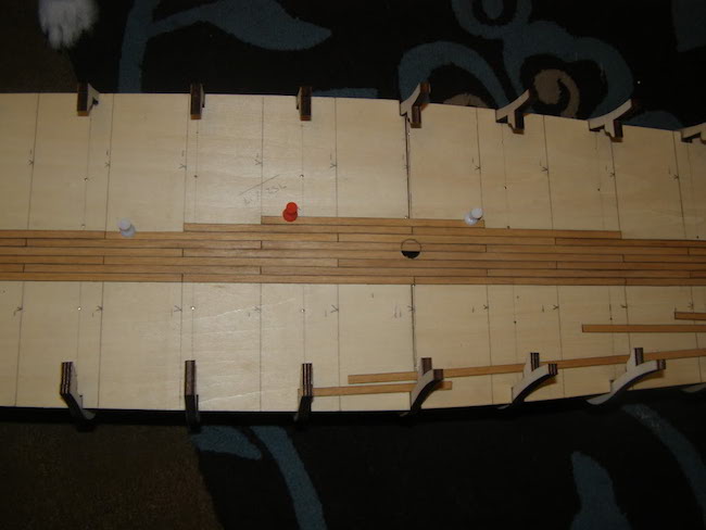

Hi Colin, Its magpie here.Flapper Flapper .lol... Iv'e Pinned and glued the decks down on the Surprise. I've just made a start on the planking now. I clamped a piece of balsa to the deck to get the first straight run.

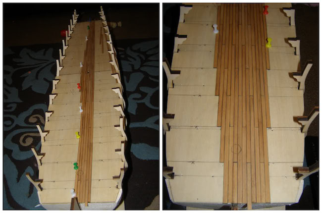

[Hi Again, I'm done with the deck planking for the night now but here is where Iam up to.BigGrin
Jack Sparrow
#24 Posted : 01 August 2010 00:44:51
Looking good!!!Drool Cool BigGrin

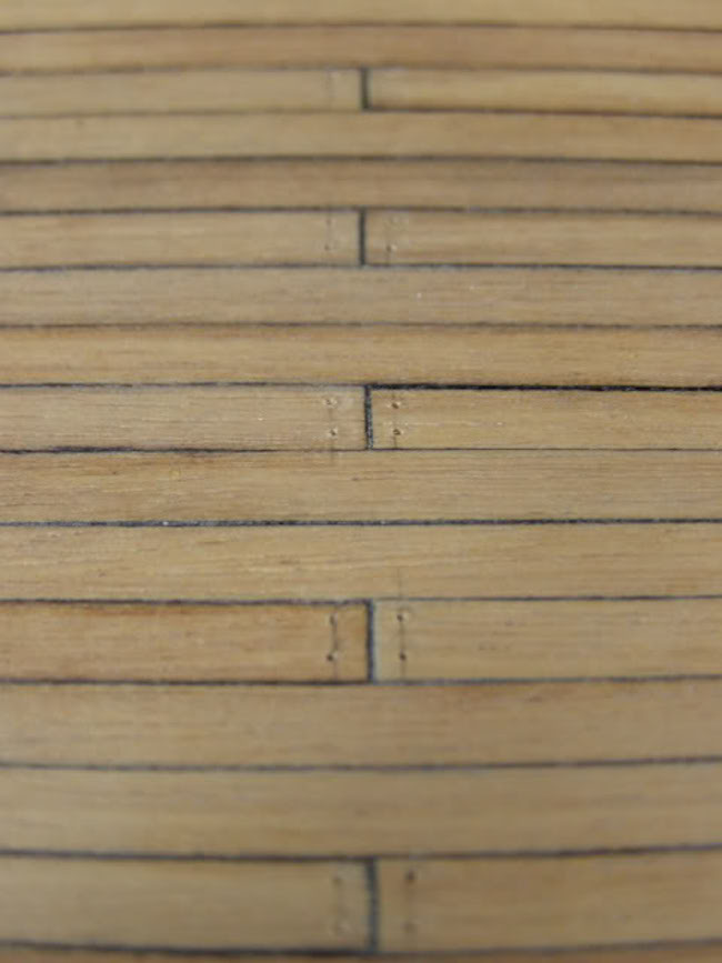

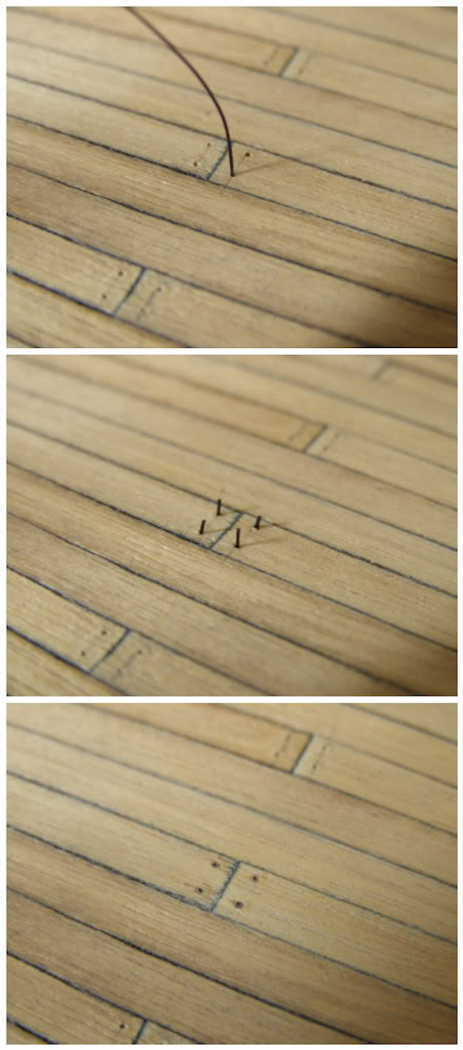

Here Is where I am upto at the moment on the deck planking. I also Tried out my way of Tre-nailing. I drill a 4mm hole and insert 0.25mm black fishing line into the hole with thin super glue.Then trim and sand. Looks Quite effective and not too big.

Hi, The Deck is now fully planked . Iv'e started to drill for the trenails now. Here is what I did in pictures. I used .25mm fishing line.
Jack Sparrow
#28 Posted : 04 August 2010 20:15:17
Oh I am soooooooo impressed!!!Drool Cool Drool Excellent idea with the fishing line, it doesnt look out of scale and no painting!!! BigGrin BigGrin And I have miles and miles of the stuff in most colours too!! It looks brilliant Magpie and If you dont mind i think I may use your idea?!?!?!BigGrin Cool BigGrin

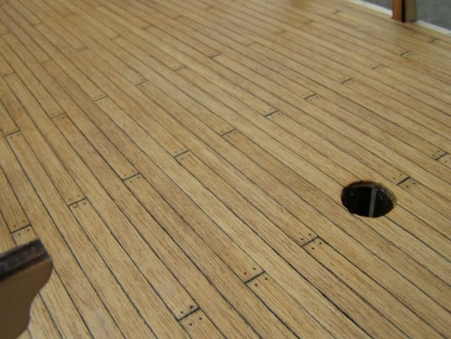

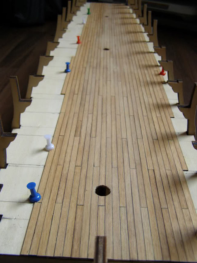

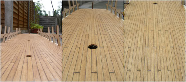

Here is my latest update. Iv'e completed the laying of the planks, and tre nailed the deck. Then used Antique oil on them. This is the result of all of that. Hope it looks fine and dandy. Still unsure as deck looks dark.
Thanks Chris...

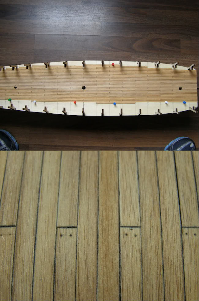

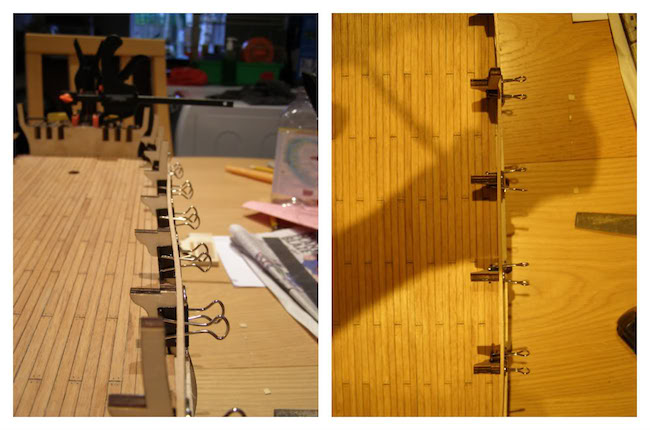

Just a quick question . I am at the planking the hull stage but... If I lay this plank out (in pic) I don't get smooth lines. The rib nearest the cam has been packed out. the worst is the last short rib which seems to sink inwards. Does yours (Surprise Builders) lay the same and would it be worthy of sanding and packing out the ribs to get the shape.
Thanks Chris
#33 Posted : 07 August 2010 22:18:23
hi magpie,I think you know what to do? the link you put up earlier of the other surprise build, shows that packing was required,so I won't teach grandmother to suck eggs lol.those pictures showed that the surprise kit has some flaws,so be prepared for more bits either missing or replaced with something else.

VERY NICE DECK WORK, Yes I had to sand and pack the offending ribs to get the planks to lye strait.

Thanks Rob for your Comment. Also thanks for your Answer to my question I will start sanding and packing later too try and make this kit better. (Doesn't take much too make it better though does it.)

Just wondering, I noticed you described how you stained the edges of the strips - is this so it looks a little darker between each plank when laid in to fit?

Chris, just wanted to say that I love the colour of your deck! Antique oil you say....I might just have to "borrow" that idea!

That decking is awesome....Drool Droolfantastic work there mate....BigGrin BigGrin BigGrin BigGrin BigGrin

Hi Tom.
All I did was get Kitchen Tissue soak a little of the stain onto it the ran it down the edge of the strips getting little on the face also once the tissue has dried a little smudge a little on the face again. Once dry give it a light rub the antique oil it. Leave to dry over night then you can use black marker on the edges to give the effect of the Caulking. The stain does give the effect you mentioned also the effect of different shades of the same wood.
Here in my pictures I have filled the front with Balsa and filed and smoothed it out. Then with planks (not the correct ones these are soft bendy planks) I test fitted it out to see how it all lay before getting the real planks going.
