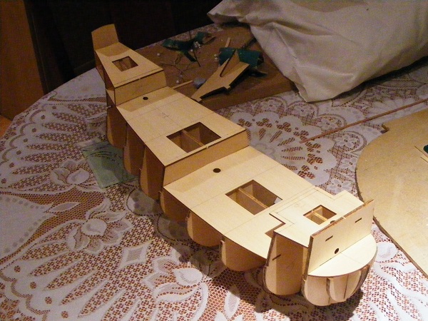

Blink bit concerned looking at frame 4 and deck at bow
The frame sticks out on 1 side of the deck, might just be the photograph
I have deviated from instructions and stuck the keel in a jig gluing in one frame at a time ensuring frames are square to the keel
#23 Posted : 25 March 2013 20:58:22
budgie wrote:
BigGrin Hi Gandale your zooming along nicely there
Blushing Hope you don't mind me saying...
Hi Budgie, thanks for being eagle eyed and noticing something I didn't... rib 4 has obviously moved position..Cursing Cursing . Corrective measures are being taken as a result....Thankfully no real damage done....Cool Cool Thanks again....

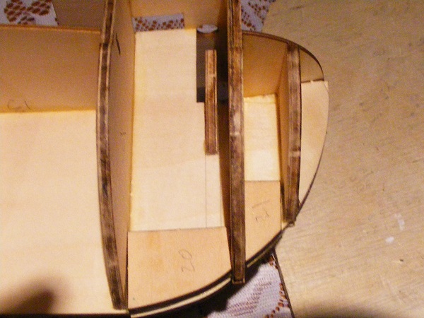

Well, first order of business tonight was to put right the foul up I made with rib 4, thanks to Budgie for pointing it out....Cool .. Managed to loosen off the rib with the use of some directed steam in short burts, this softened the PVA enough to move the rib... Slight damage to the top of the rib on one side Mad Mad so repaired that with an additional bracing piece. All glued back together and am now happy with the result...

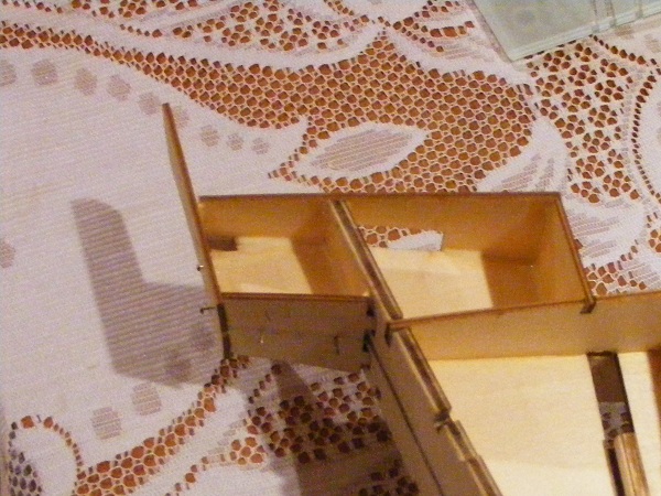

Continued by adding the bracing pieces between the ribs either side of the bow.. did this using PVA and clamping into place...

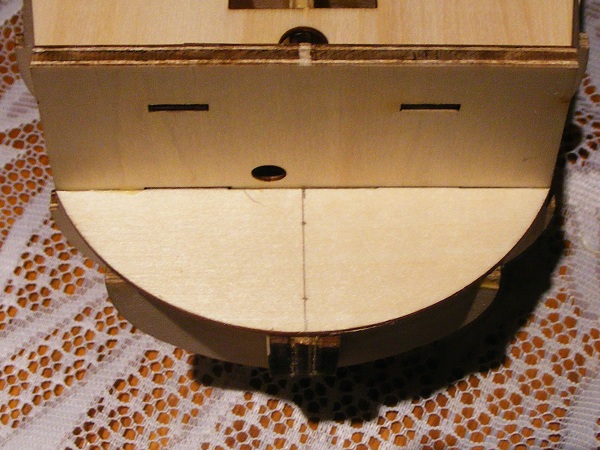

Finally this evening I glued and pinned into position the final pieces for the stern...Used a dowel to ensure the hole in the stern lined up with the corresponding support opening. Tomorrow, all going well I will make a start on fairing the hull unless I decide to infill with balsa which is looking favourite.... That decision will be made when I place her back in the dry dock jig and check everything over....Cool Cool

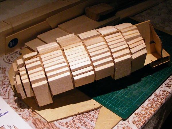

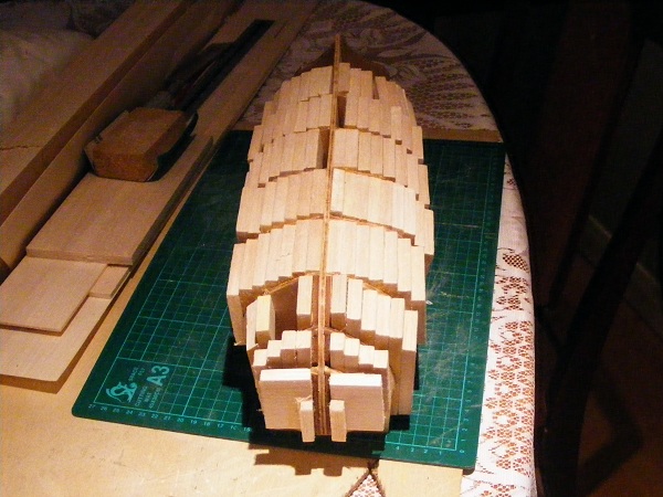

#36 Posted : 07 April 2013 21:32:41
Made progress on the hull infilling using balsa, each of the blocks you see is 30mm deep and happy to say the hull feels solid... Still have the stern section to complete plus a couple of small gaps, hopefully will get that done within the next couple of evenings....Cool Cool .. Then the sanding arm will get its exercise.....BigGrin BigGrin .. Slow progress but I'm in no rush.... thanks to all who look in...

#37 Posted : 08 April 2013 09:24:47
Joined: 30/03/2011
Posts: 1,344
Points: 4,079
Must admit, she looks real strange with those infills. Almost no shape at all, but hidden underneath.....................

#38 Posted : 08 April 2013 10:22:43
Hi Alan, looking greatBigGrin Thats the way to go in my opinionCool Kind regards Mike
Hi Hans, thanks for looking in.... Yes she does look a little strange as it is at present but am sure you will notice a big difference when the sanding and fairing session is complete.....Cool Cool Appreciate you looking in and commenting.....BigGrin BigGrin
Thanks for looking in Mike..... think you have converted me into believing in the merits of using balsa infills..BigGrin BigGrin .. Am sure the Vic will be getting the same treatment...Blink Blink .. Have now finished the infills and will hopefully be sanding tomorrow.... will post progress then.... BigGrin BigGrin
