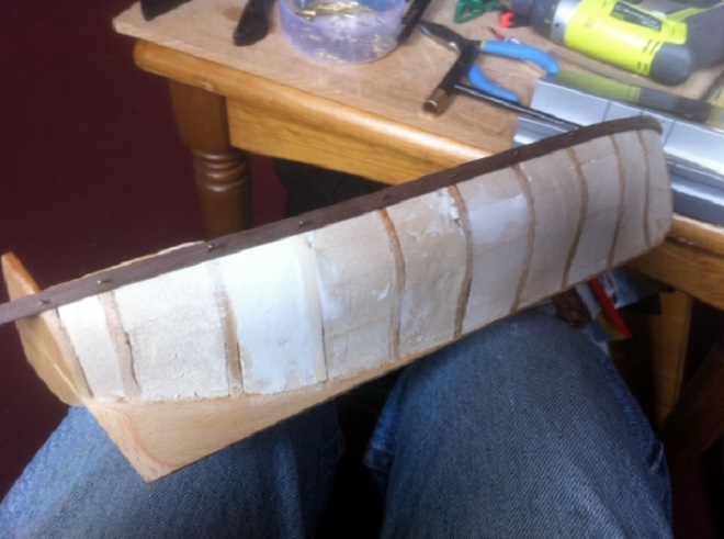

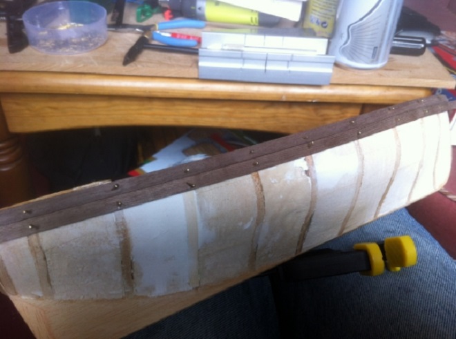

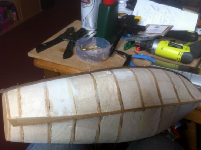

#23 Posted : 30 May 2013 20:39:48
Hi All, BigGrin BigGrin
This is a short, all be it an overdue update.
Work, back injury, holiday etc,etc, Oh and funds LOL LOL , but ordered complete supply of new wood strip for the hull planking from CMB yesterday and it arrived this morning. WOW Good Service Eh Cool .
Well steamed a couple of strips and pinned in place to see how good the hull shaping was and this is the results.
The first and second pics show how flat the first plank lays to the shape.
Now due to the size of this model, to get the planks to lay as near flat as possible to each other, a small chamfer is required on the top edge.
The third pic shows a second plank in place, both planks are only pinned at this point while I check for hull shape and plank fit.
Next step is to check other side for shape and fit.
If that goes to plan then it should be full steam ahead for a complete planking session.
