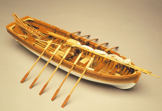

Hi Colin,
The info in this link notes two masts for the Launch amongst lots of other useful info http://www.sculptor-iangb.com/hms-victory.htm
However, Longridge's Launch shows no masts, Gowan shows two and the Anatomy book show's only a bow mast hole Crying
Keith Julier's book shows the build of the Panart 34ft Launch, which has a single mast though has central & bow mast holes, which have mast rests inserted for stowing the mast as per the photo below.
I've also read that on occasion a bow carronade was placed on a wooden structure attached to the first benches, which slid back and forth, recoiling on two slits made on the two carrying guides and was manoeuvred by two forward and aft placed tackles. The marksman occupied himself to raise the cannon while the helmsman was responsible to align the bow at the target, this can be seen in Panarts armed 34ft Launch in this link.
http://www.naturecoast.com/hobby/ma748.htm

Thanks for that Tomick, I guess it's down to interpritaion really, 2 mast's seems to be the way to go but on seeing some close up pictures of smaller craft the rigging could follow that method.
