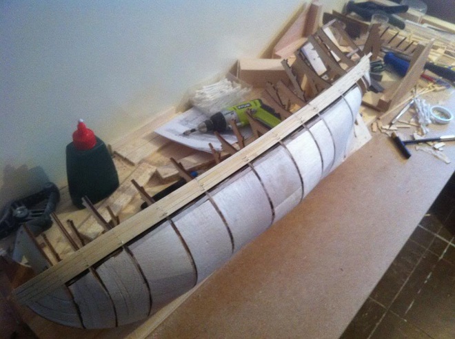

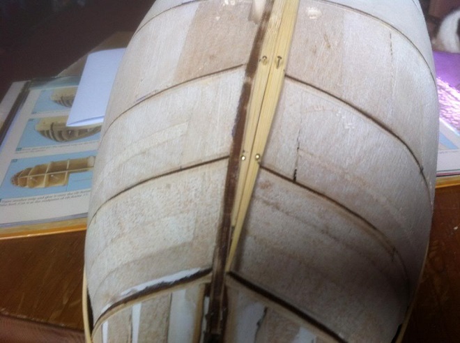

#24 Posted : 02 March 2013 21:18:25
Well here`s one of the interesting updates, Scared,PlankingLOL LOL
Just completed the first four upper rows, couple of broken planks even with a good hot soak (I blame the woodFlapper ).
Next job row 5 with tapered end and garboard Planks.Blink

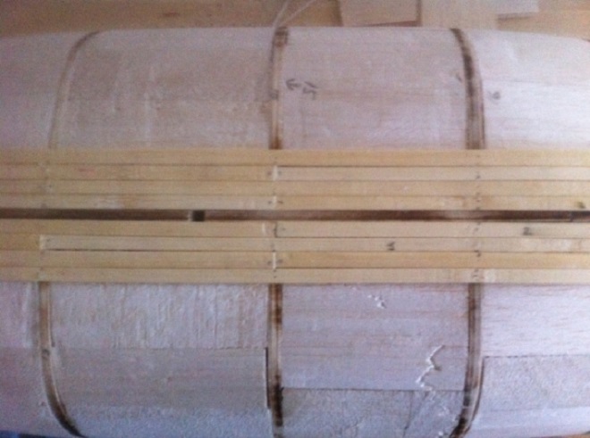

#29 Posted : 03 March 2013 18:08:33
Well Hi,
Planking 5th row, was a bit concerned about this one but took the bull by the horns and here`s the result:
Will update when a good bit of planking done BigGrin

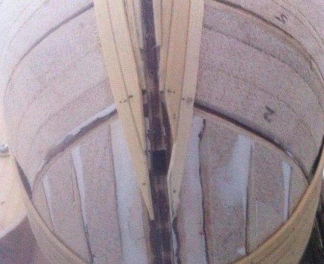

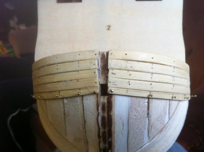

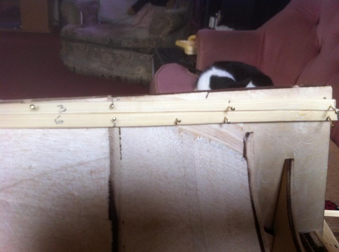

Hi All,
Was going to update a bit later, but thought I might post this to get ideas on the garboard planking.
The following pics are of a dry fit of two rows of planks ( Yep, know the ship has two sides LOL )so the very ends at the bow are not fully in place as will need to band them down with maybe tape and/or elastic bands till they set when glued.
Before I fit and glue, any ideas of anything wrong as don`t want to have to remove once stuck.
Admiral Anti Spiral
#31 Posted : 07 March 2013 15:29:42
Joined: 24/09/2012
Posts: 491
Points: 1,452
Location: London
Looking good derek, looks perfectly fine to me :)

#33 Posted : 07 March 2013 22:05:43
Derek, have to say that since the hull is going to have a second skin I didn't find any problems at all in using the supplied pins as long as I pre drilled the pin holes.... Pins are removed when everything is set so sanding shouldn't be a problem... Think I would only use map pins on single skinned hulls..... Am sure you will decide for yourself the best option.....
#34 Posted : 08 March 2013 15:10:05
Hi Alan,
I`m sticking with the supplied pins/ pre drilled holes it seems to be working ok.

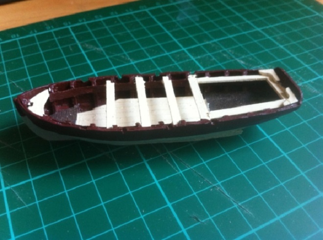

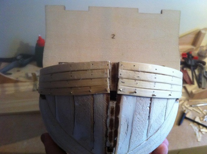

#35 Posted : 14 March 2013 12:53:53
Hi All,
Having had a dry run at the garboard planking I went for the real thing, bit of bending here ,bit of twisting there and that got me in the seatCrying Crying Crying .
Suffering with a back muscle spasm, so on the sick at the moment, may think I got lots of modelling time but can`t sit for long as I seize upCrying Crying Crying .
Well this is the progress all be it a bit on the slow side:
Pics 1-3

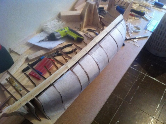

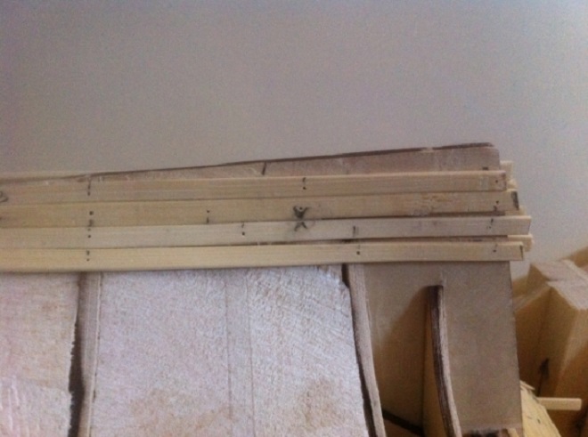

It was at this point that Cursing DISASTERCursing struck.
Went to move the model, back spasm`d, model moved and snapped the top off a rib. Don`t know what made me cry more "The Pain" or "The Breakage".
Having regained my composure, found damage not to bad and stuck offending piece back in place and clamped overnight.
Pic 4
May have to reinforce it a bit when i get to work in that area but will sort that when it comes along.

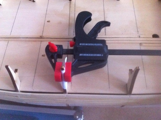

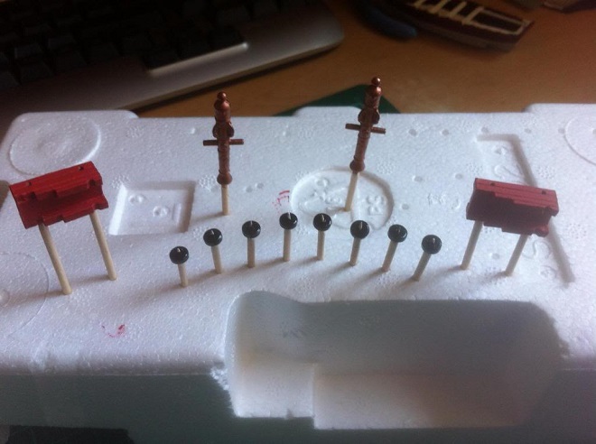

Decided to take on something a bit more leisurely, to that end done some of the Launch enhancements and painted some cannon parts.
Pic 5-6
Well that`s all for now, got to go take pills and potions, been sat here to long again Crying.
