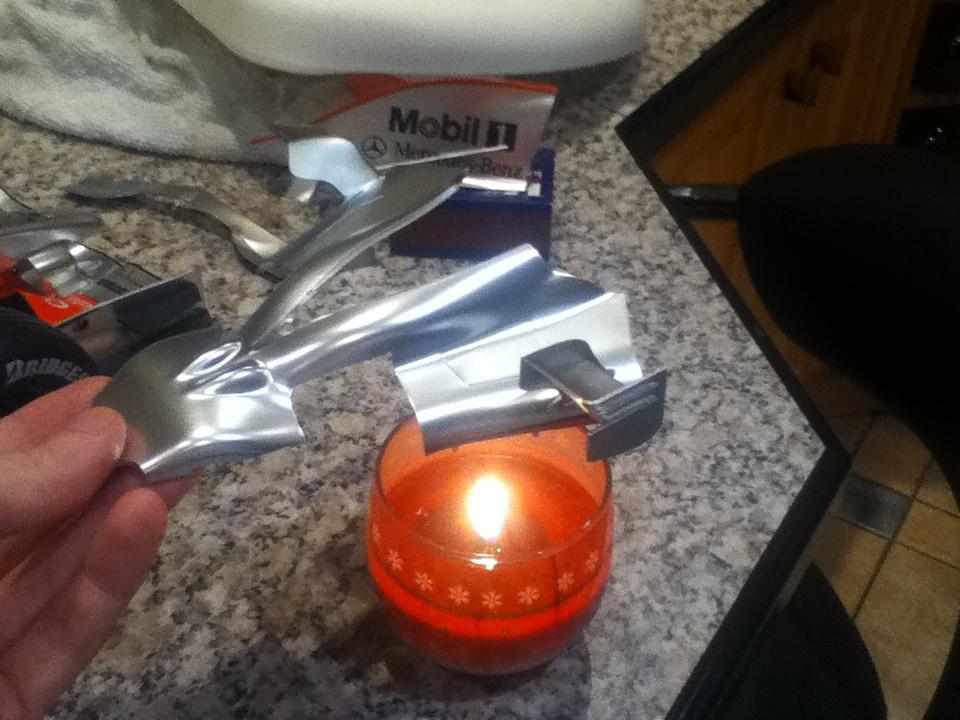

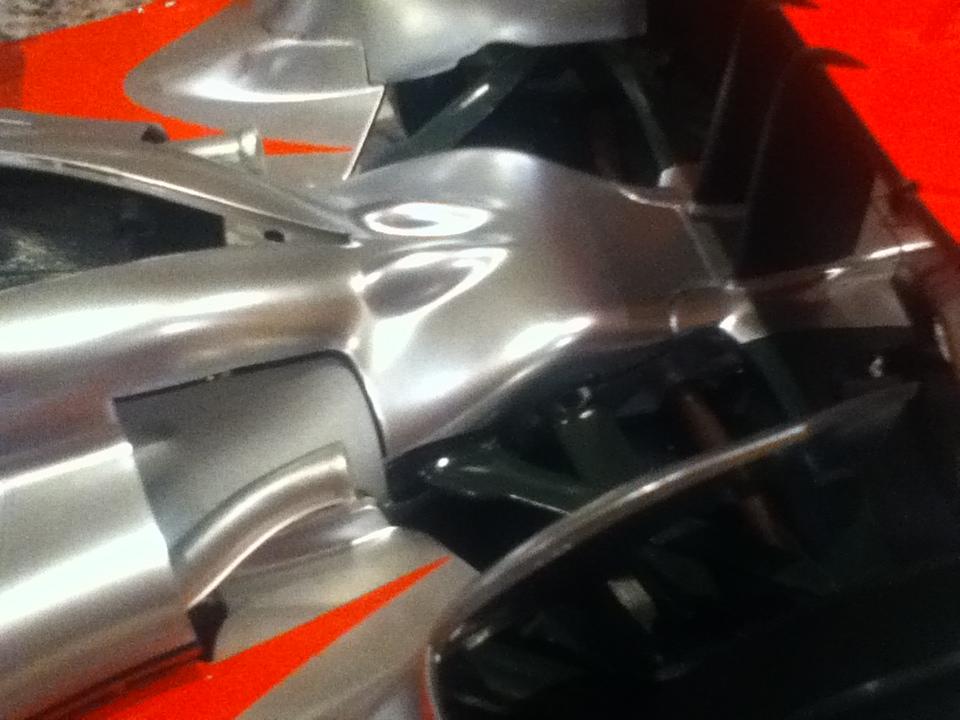

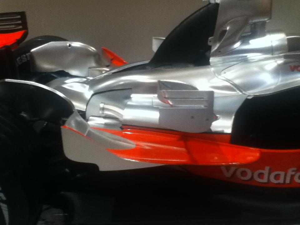

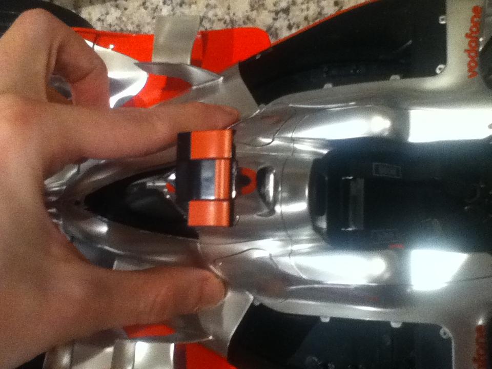

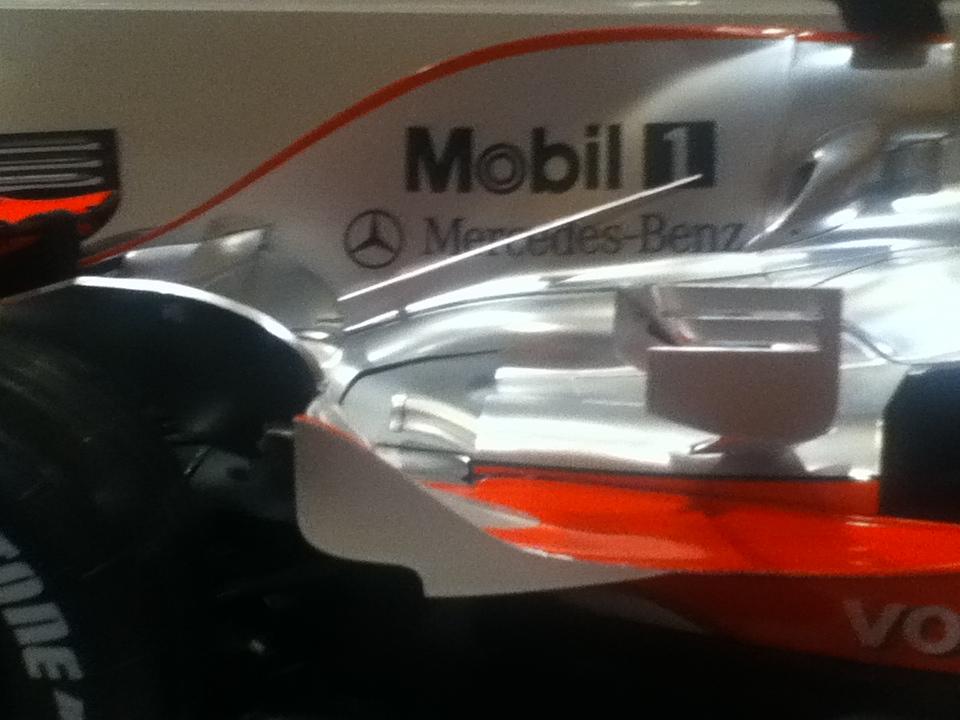

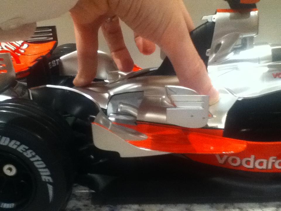

Before you start remove the upper part of the air intake cover from the engine cover, this helps with heating and re-shaping
Step 1. Hold the engine cover over a naked flame, not too close that it melts in your hand, just far enough so you can feel the piece "warming"
Don't hold it in one place either, keep the part moving giving an even coverage
With reshaping, a low heat and alot of patience is best
Step 2. With the part heated and you feel the part has a little flex, put it into position ensuring the pins towards the rear are in place holding down the rear wing
Step 3. Press the front ends in place, making sure correct allignment along both sides
Step 4. Keep held in place and apply enough pressure to keep shape until cooled
Step 5. Release pressure and make sure new shape has been kept and the part hasn't sprung back into its previous shape
These steps may need to be repeated a number of times until the part holds un-assisted
Step 6. Re-attach the air intake cover, admire your new gap free engine cover assembly Cool
I only done this because I am an impatient person!
I would only recommened doing this if you are the same BigGrin
No doubt the fix from Tomick/Admin will yield better results and be less of a fire hazard!
