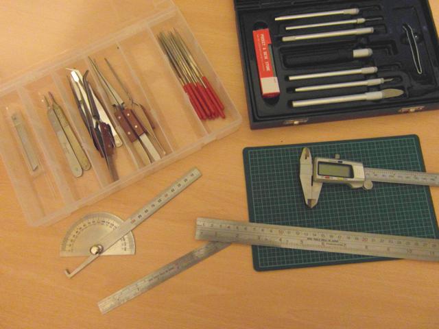

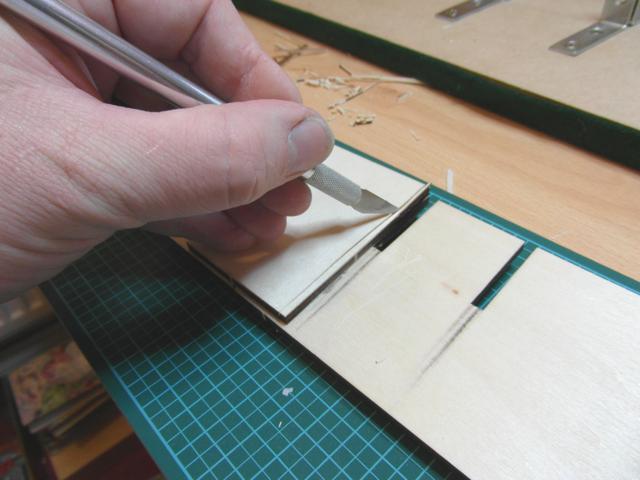

Photo 1 - I have a selection of different scalpels & blades, the calliper is a must have piece of kit, great for making sure everything is equal.

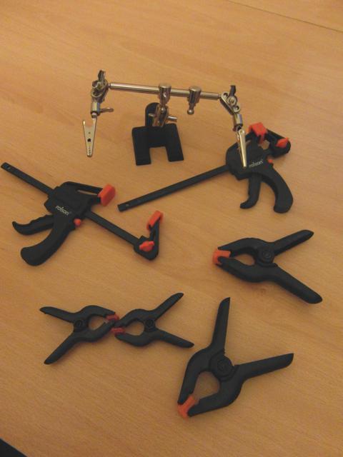

Photo 2 - A selection of the clamps I have, have a lot more of each of these, amazing how many you can use at one time.

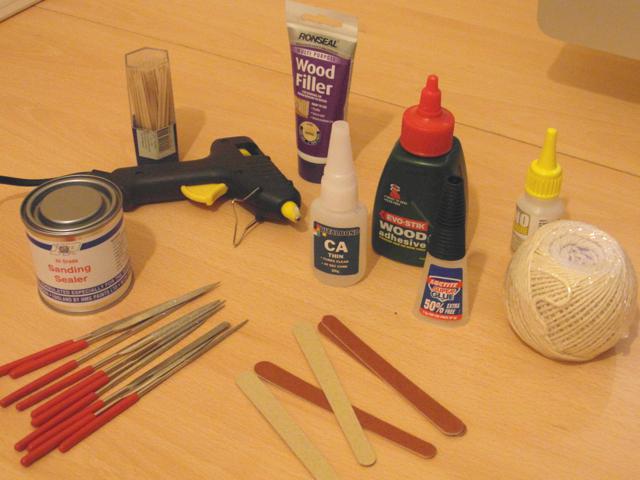

Photo 3 - Some of the different glues, fillers & sanding materials.

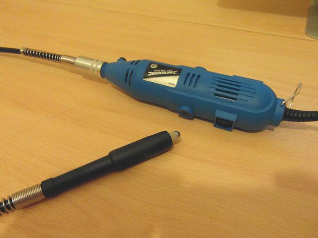

Photo 4 - The multi tool is a great piece of kit, can use for so many jobs, I've added a flexi shaft, will make it easier to use, rather than holding the much bigger tool.

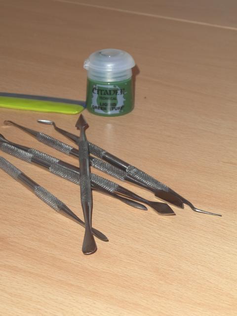

Photo 5 - After reading AK's build where he uses 'Green Stuff' to add extra detail, I felt these modelling tools would be a very good idea.

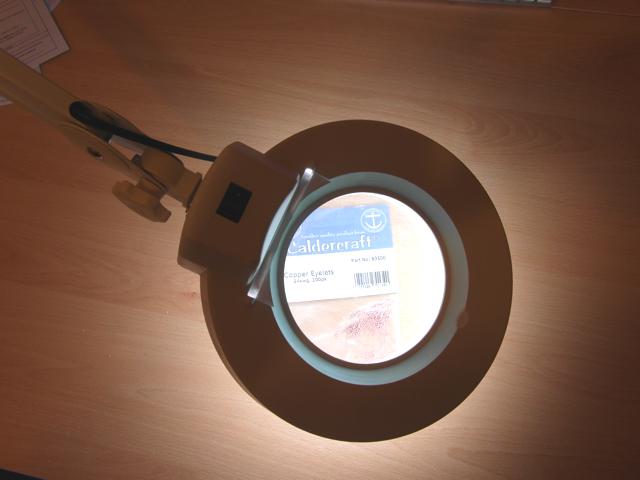

Photo 6 - Without this magnifying light I would be stuffed, eye sight isn't the best LOL parts are small enough without the bad eye sight, this will be invaluable to me.

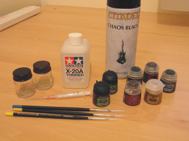

Photo 7 - The paints I have so far, some of these are for the cannons, again got the details from AK's build diary, his cannons are fantastic, the colour & detail is really inspiring.

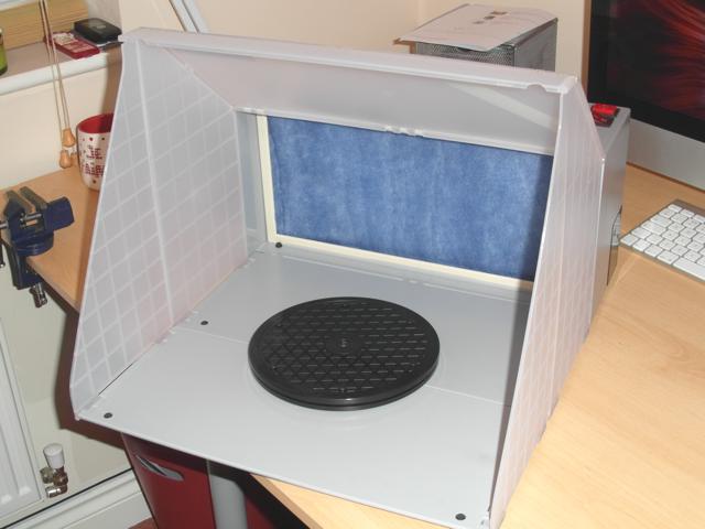

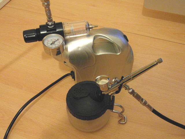

Photo 8 - I know you can paint the parts by hand but I have always wanted to be able to use an airbrush, not just for building this model. This is the reason I haven't started on the cannons, Im learning & practising with the airbrush.
Photo 9 - The only problem with using an airbrush is the spray, if your spraying outside, not a problem but with the temperature this time of year, I don't want to be out in the cold, plus the paint wouldn't dry very well.
There is a large extractor which pulls the spray into the large filter, stopping any spray ending up on other things within the room.
Photo 10 - Even folds away neatly for storage BigGrin

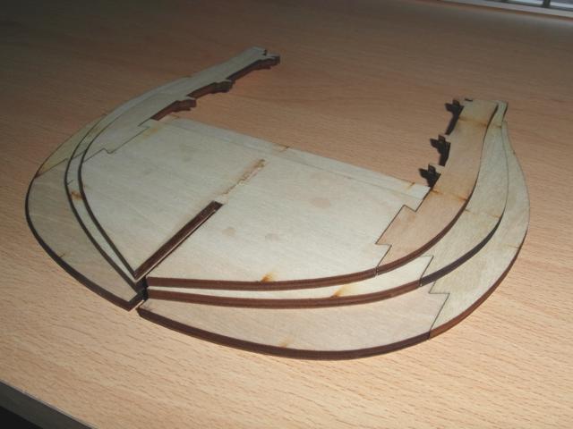

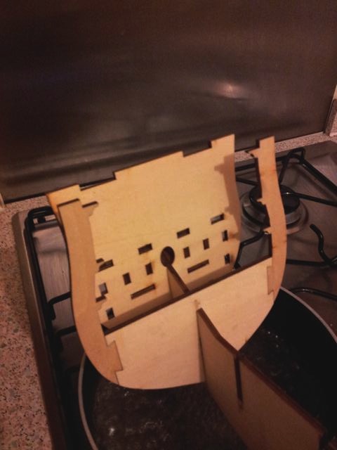

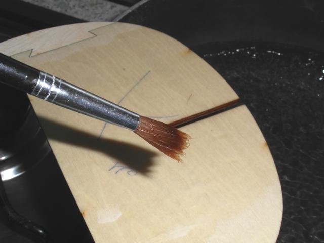

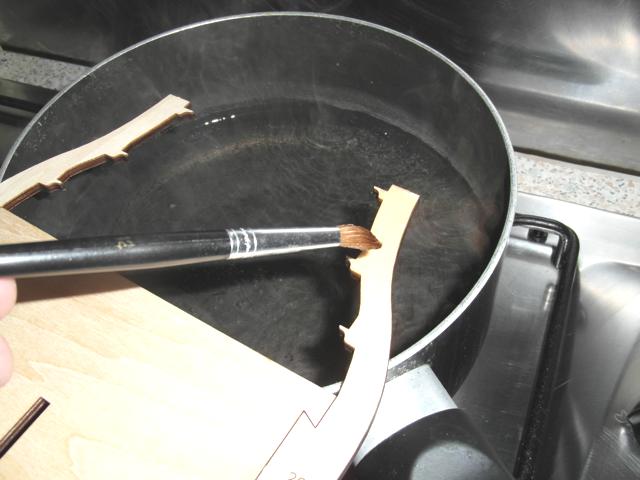

While I was waiting for these issue's to arrive I did try to steam the ribs off the keel.
Managed to get the ribs off with no problem, only problem was that they weren't totally flat, I did read that you can soak them in water, then put them in tile press.
Steaming didn't get the bow parts apart, think they needed soaking.
Is it OK to soak them or do you just get them slightly wet ?

I would recommend soaking in warm water to release the glued sections and making parts slightly damp in preparation to placing them in a form of press to remove any warps.

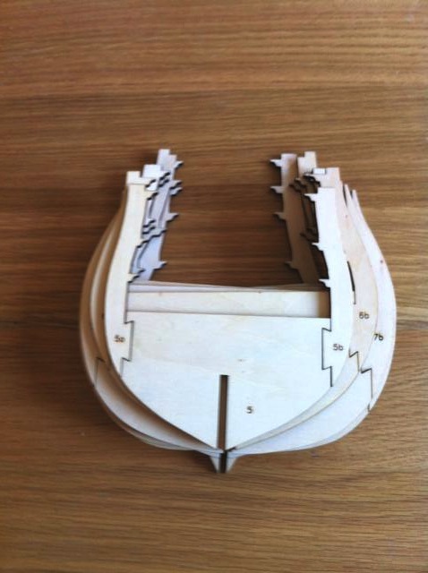

Now I have all the issue's, I can get started again, as I had problems with my first attempts with the early issue's I have built a new bulkhead.
This is now ready for balsa wood, will update pictures once this is complete

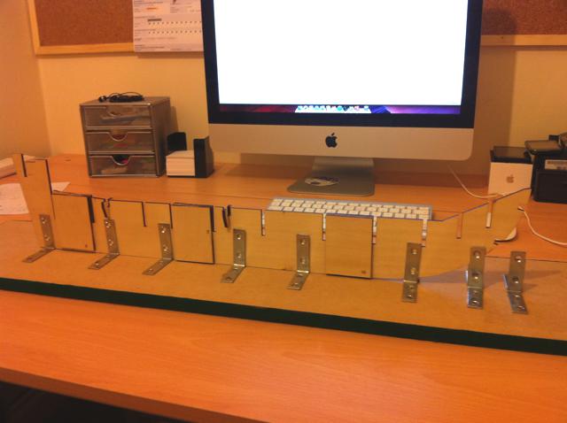

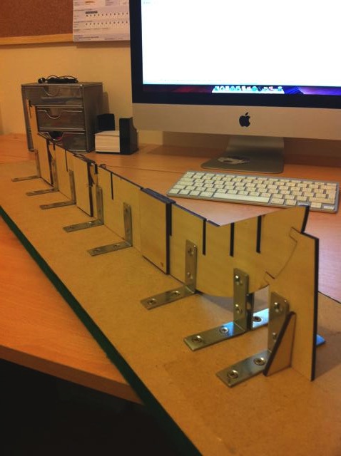

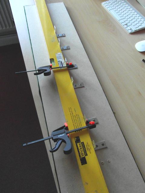

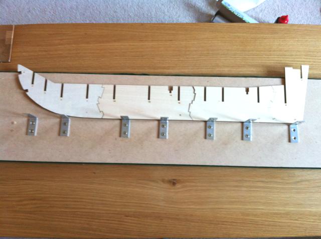

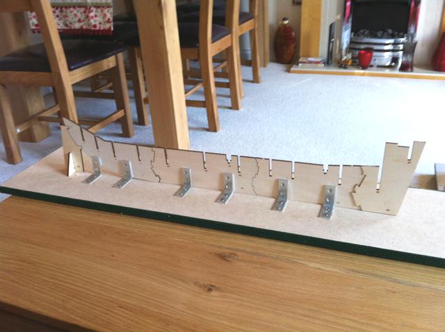

Photo 1 & 2 - Assembly jig, now that I had all the pieces of the keel I could work out where all the brackets needed to go, to ensure all the brackets were in a straight line, I used a spirit level.
Photo 3 - As you can see, when the keel is laid out next to the brackets, none of the brackets get in the way of where the ribs will fit, least I got them in the right place, no taking brackets off, then putting them back on in the correct place LOL
Photo 4 - Now with all the brackets in place, I have fitted the keel loosely to the jig, not glued yet.
Nice to see the whole keel together.
As usual will update as things take shape.
Would like to thank everyone for their build diaries, I have learnt so much, I hadn't realised what a motivation they would be, the quality of models already built & under way is amazing.

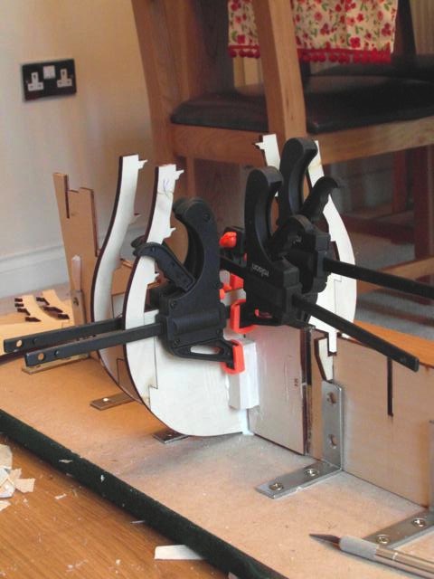

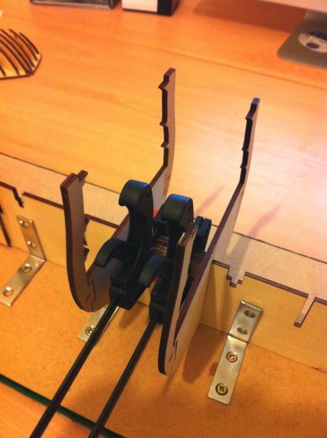

Now the jig is all set up, I can start joining the keel together BigGrin
Used a couple of the ribs put in (not glued) to ensure I dont overlap any of the slots.
Doesn't she look good, all the keel joined together. Gives an idea of the length of the ship.
Really pleased to be at this stage BigGrin BigGrin

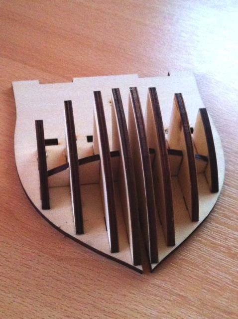

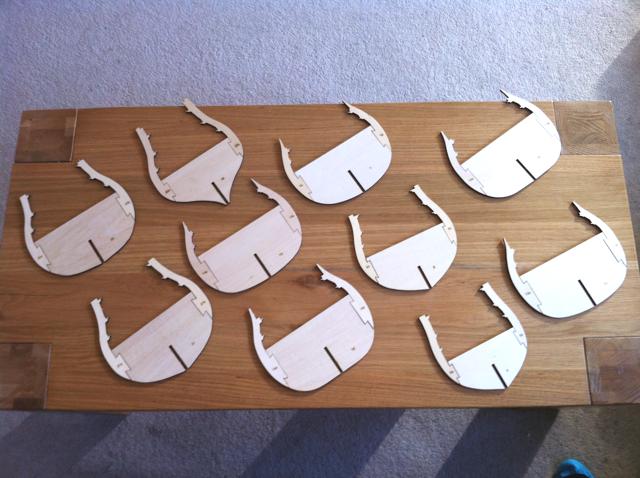

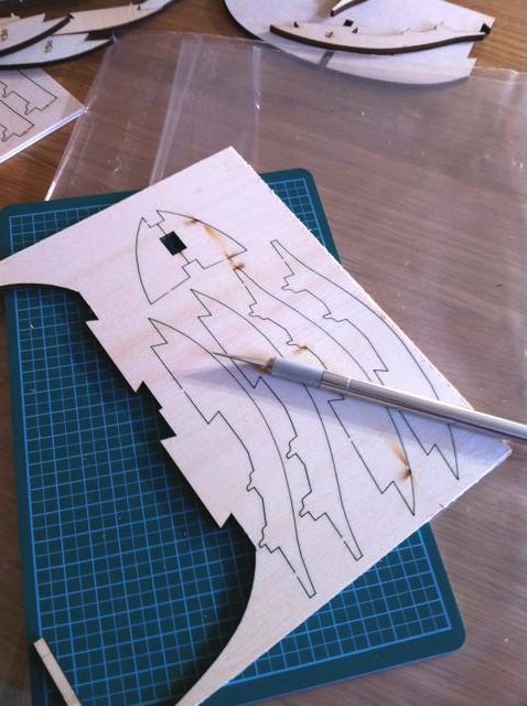

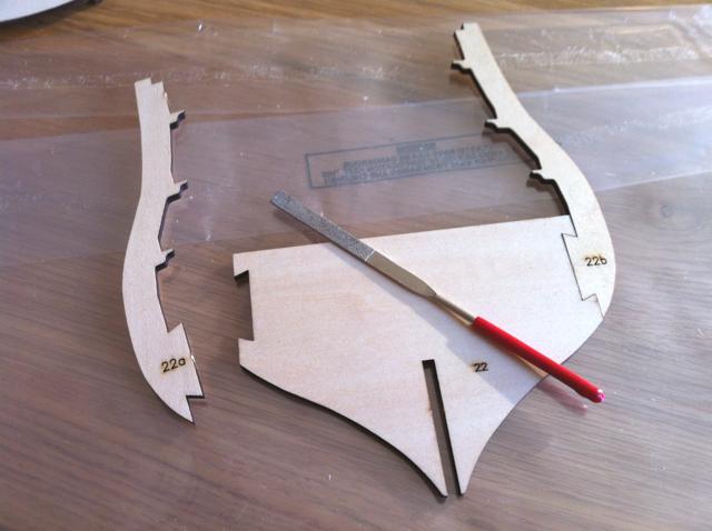

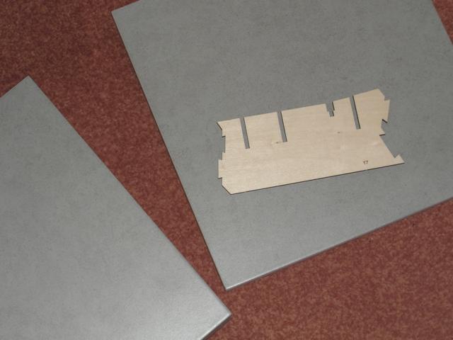

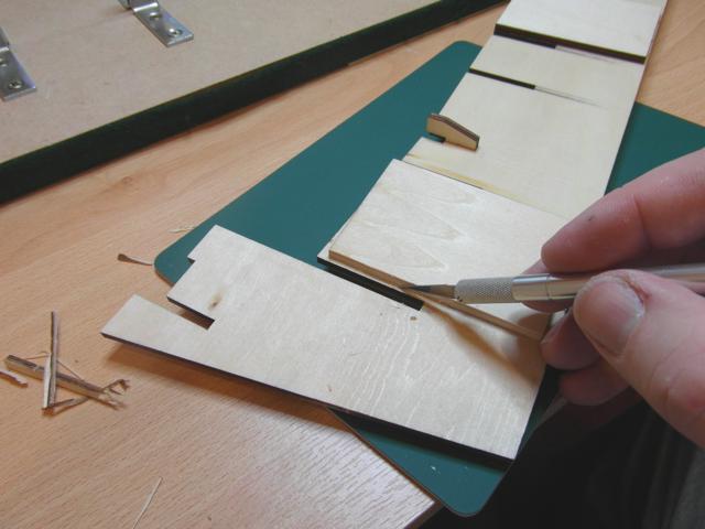

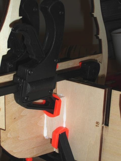

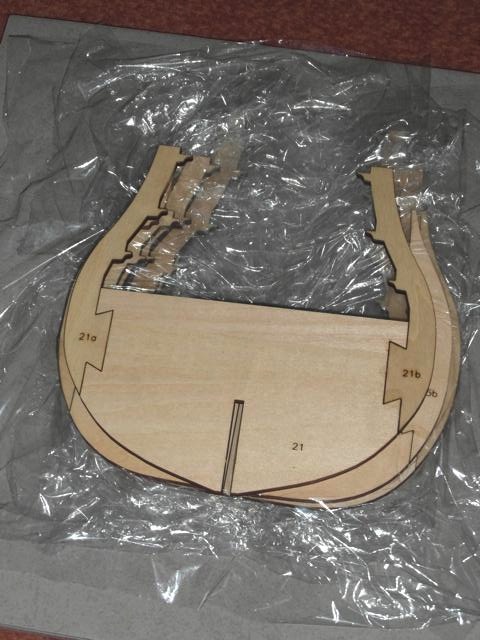

Photo 1 - 4 - Now we are getting somewhere, ribs all cut out , filed off any excess from where I have cut them from the frames & loosely put together to ensure they fit correctly.

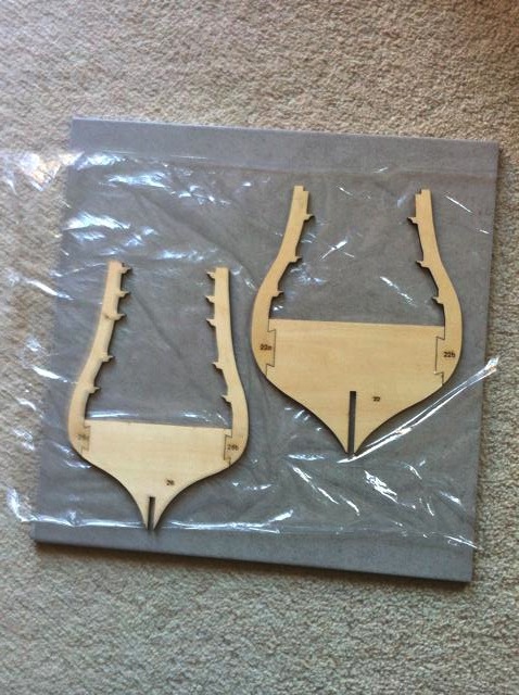

Photo 5 & 6 - Final stage is adding the glue, placed cling film on the tile to stop anything sticking, put cling film between all the layers of ribs.
Once all complete added another tile to the top & weighted down to keep them flat BigGrin

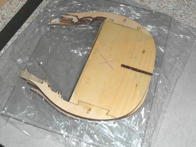

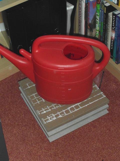

I'm learning all the time as my build progresses, having glued all my ribs, was time to add them to the keel.
Thought I would check them all before I started only to find out they weren't all flat Cursing
as I had put the in my tile press after glueing them I wondered why they weren't all flat ?
After checking the tiles realised they didn't have a totally flat surface Mad
I had already been reading about this issue other builders had, so went ahead with adding water to the affected area to soften it up, before putting them back in the tile press, this time with glass between the ribs & the tiles, totally flat BigGrin
Didn't have anything heavy to put on top of my tile press so I have been using a watering can full of water, fairly heavy & does the job. LOL

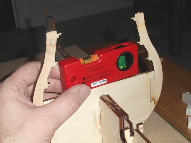

Been a while since I have updated my diary, so he is more about my build.

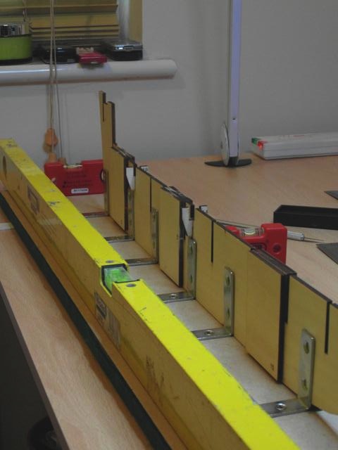

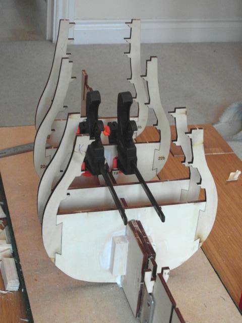

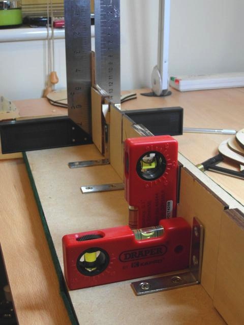

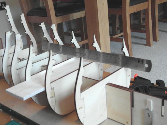

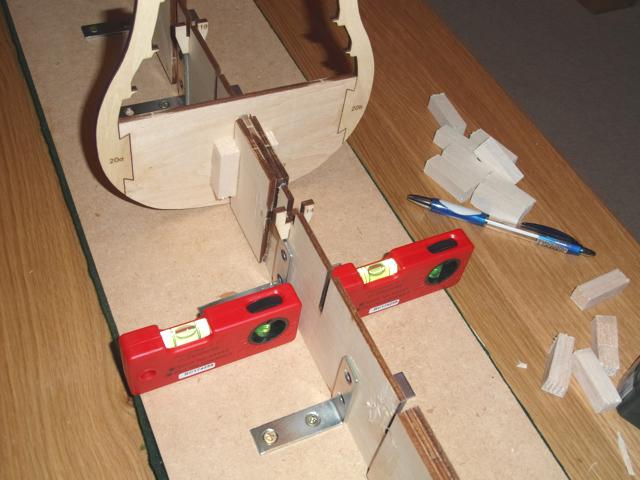

Started putting the ribs into the keel.

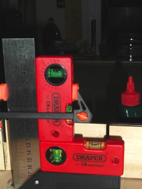

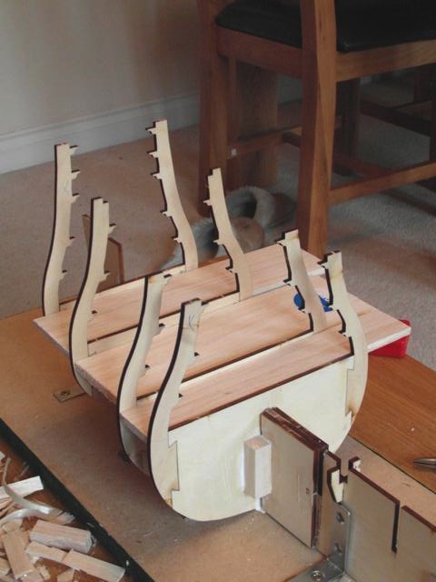

Photo 1 & 2 - Completed keel

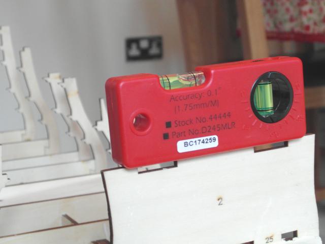

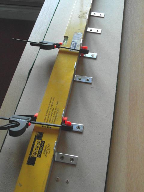

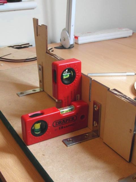

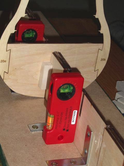

Photo 3 - To start with I had to make sure my levels were level BigGrin

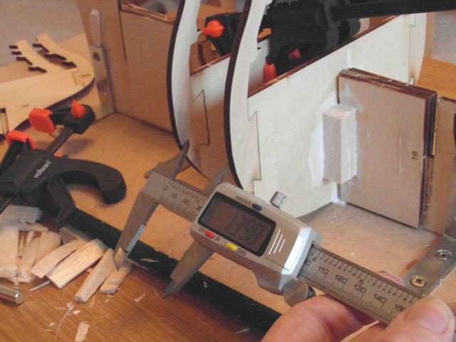

Photo 4 - 6 - There was more work involved in making sure everything was level than I expected, making sure jig was level, keel upright & level.
Photo 7 & 8 - While dry fitting the ribs I found out that they were tight fit, this was due to the joins in the keel, where the 2 pieces were glued either side of the keel joints.
I trimmed them down with a scalpel, this made it possible to adjust the ribs to ensure they were level & upright.
Photo 9 - All the time while fitting the ribs I was checking all the level, took ages to fit each rib BigGrin
Photo 10 - Even though I will be using balsa to infill the hull I still used blocks to hold the rib in place.
Photo 11 - 15 - One rib in place, plenty more to go LOL
Again more measuring & checking levels.
Photo 16 - Another way I used to check the distance between the ribs were all equal was to use the balsa infills, as well as measuring again.
Photo 17 & 18 - More checks to make sure everything was level, all the ribs the same height, apart from the last few at the back which rise gently.
Photo 19 - Well pleased, all the ribs in place, looking good Love

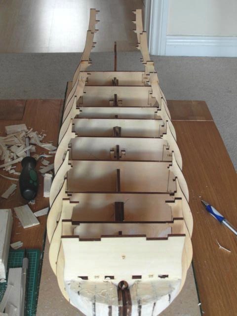

I know the work on the cannons is going to be hard work & will take some practice to get right, with that in mind I ordered 10 copies of issue 1, this will give me plenty to develop my skills on.
I have also brought a selection of wood stain, with so many cannons to build I can try he different stains to see which colour looks the best.
Hope to have some photos of my cannons soon, at the present time I am working on the balsa infills for the bulkhead & the hull.
I will be working behind the issue's as I have learned so much from the build diary's on here, excellent work from everyone, invaluable to all us newbies BigGrin
